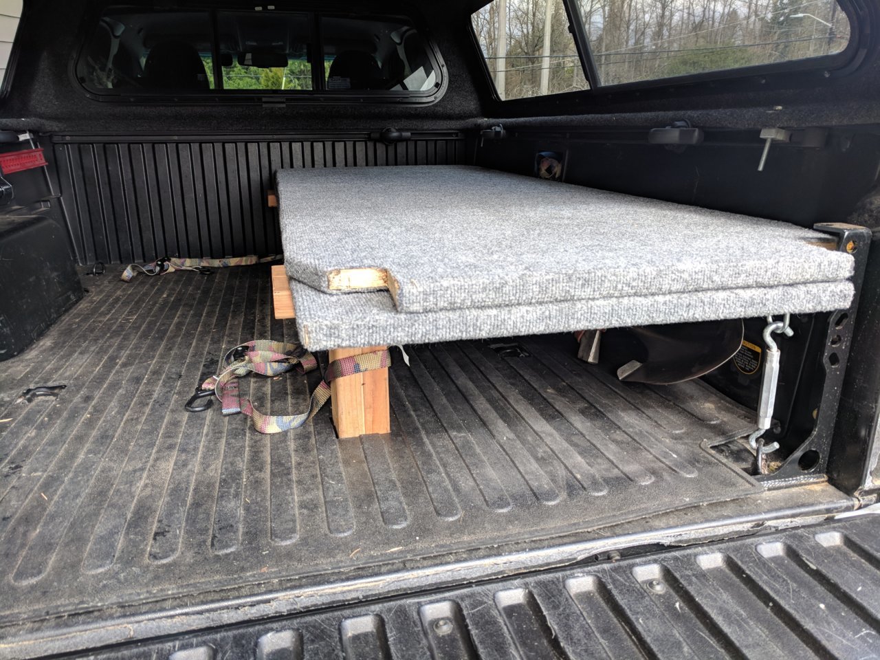

    Nice build! Any chance you have dimensions or a post about building it? I have a platform across the whole bed with 2x8s and 3/4” ply, but i think i want a bed on one half so that i can access underneath the platform without opening up the truck.

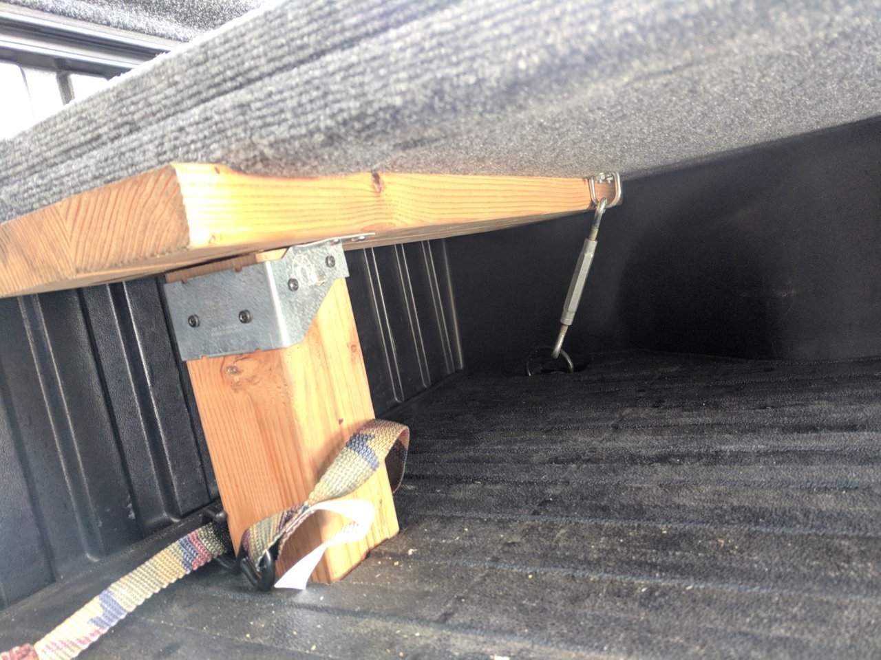

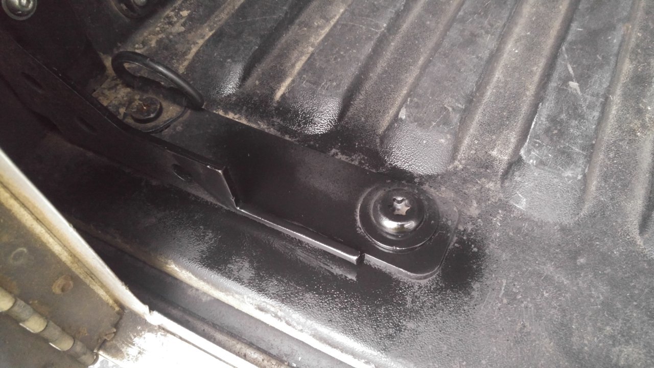

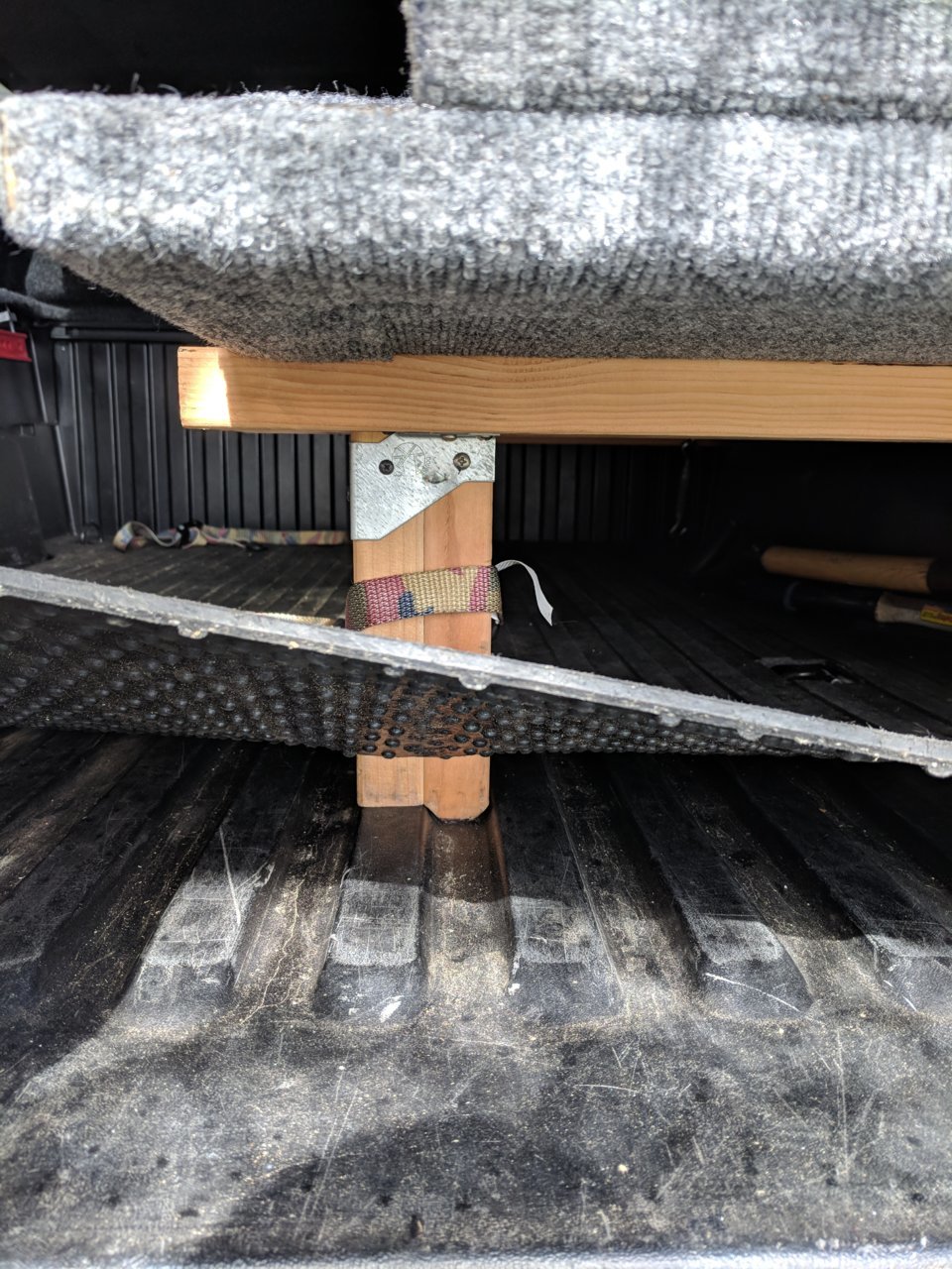

    Thanks!
    It's literally half of the bed width and I added 2x4s to make the feet with inside the grooves of the bed. It's also tied down underneath with turnbuckles. I no longer have the platform.

    Thanks for the description and pics! Can I ask what system you moved on to and why?

    I couldn't get the truck bed with canopy to seal up very well and got tired of sleeping in a dust filled bed. I installed a bed slide for cargo purposes and went with an RTT. The RTT is also gone because it was going to be a pain to remove when I needed the truck in the garage for maintenance. I use a ground tent for the time being until I figure out something new. Maybe a swag tent?

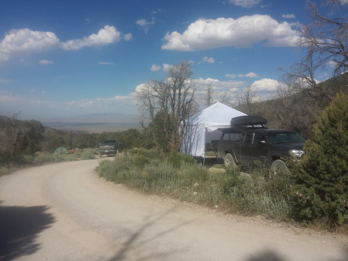

    I used my canopy I got at Costco. 10 x 10. Adjustable height. I can open or close the sides. Closed at night or in wind, open during the day. The zippered door wraps down the sides of the truck. It could be custom sewn to fit, but it works this way.
    Provides shade. I can drive away without removing from the truck.

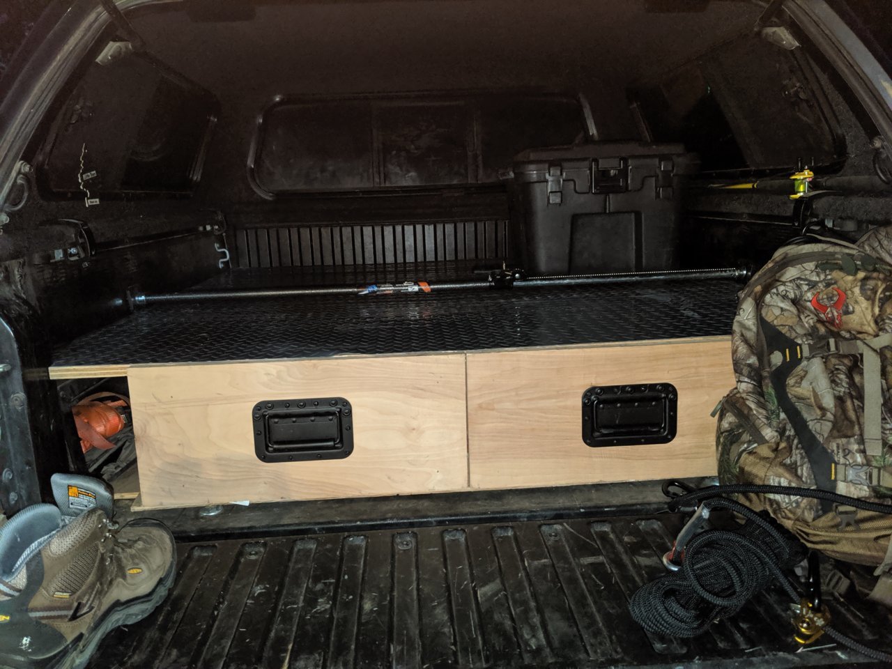

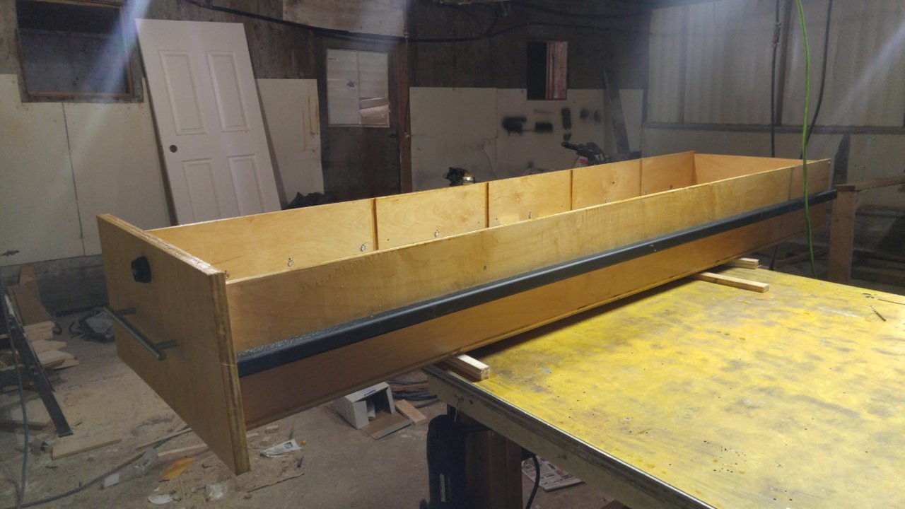

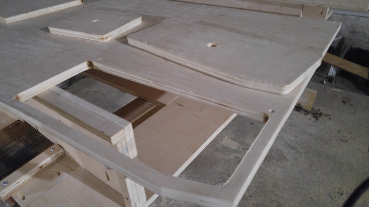

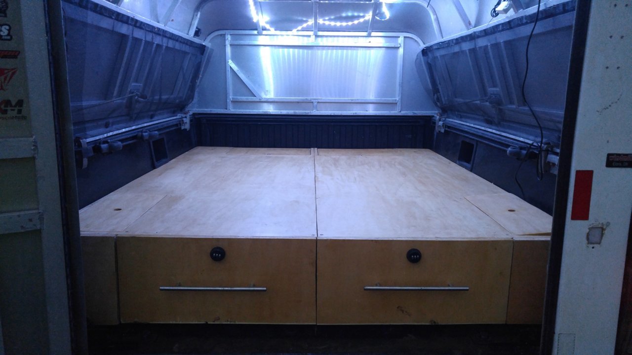

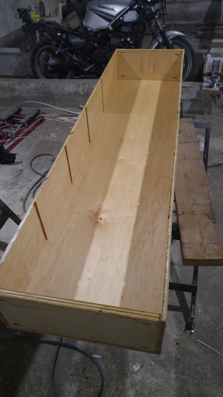

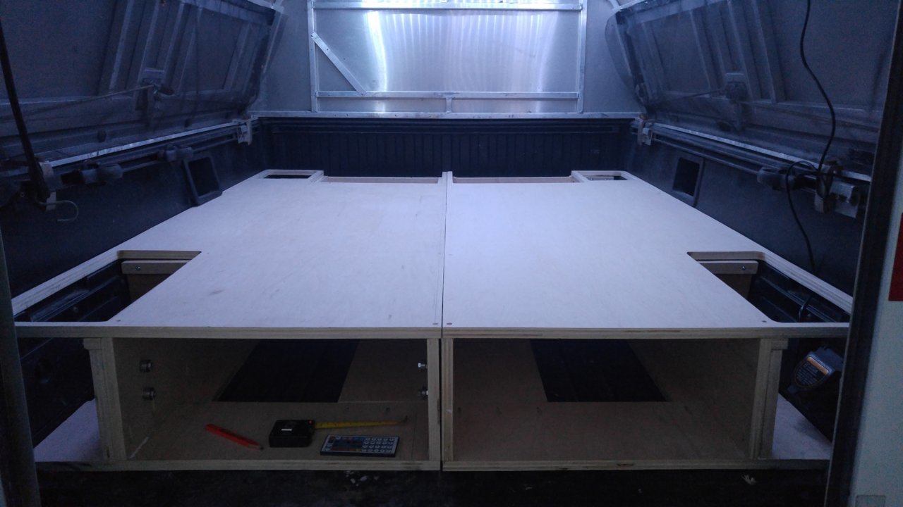

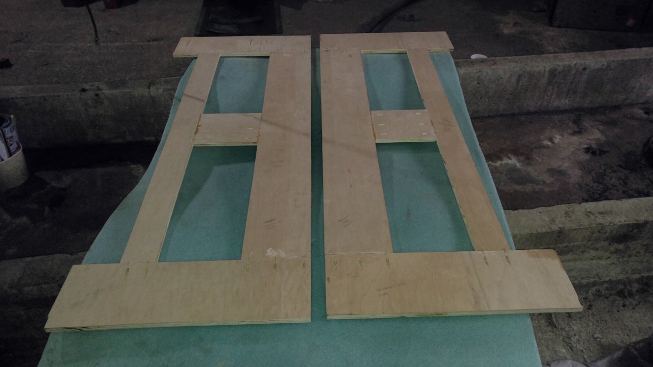

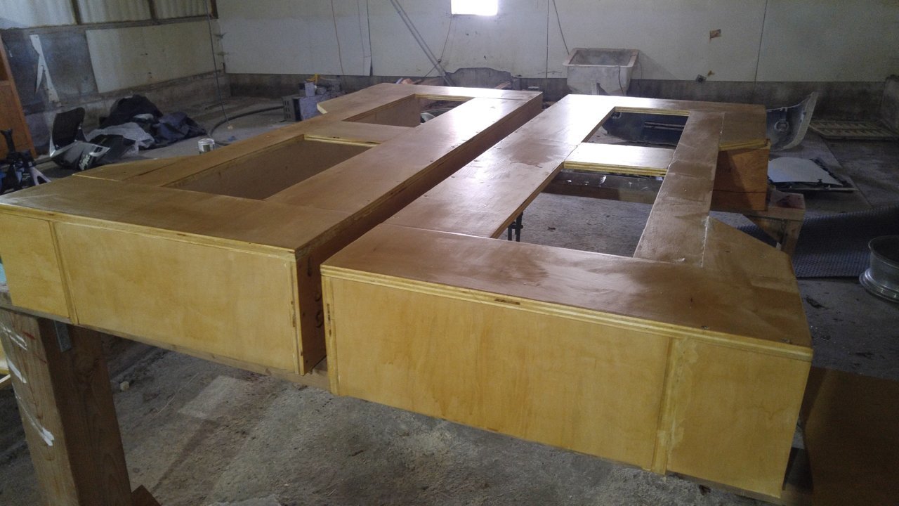

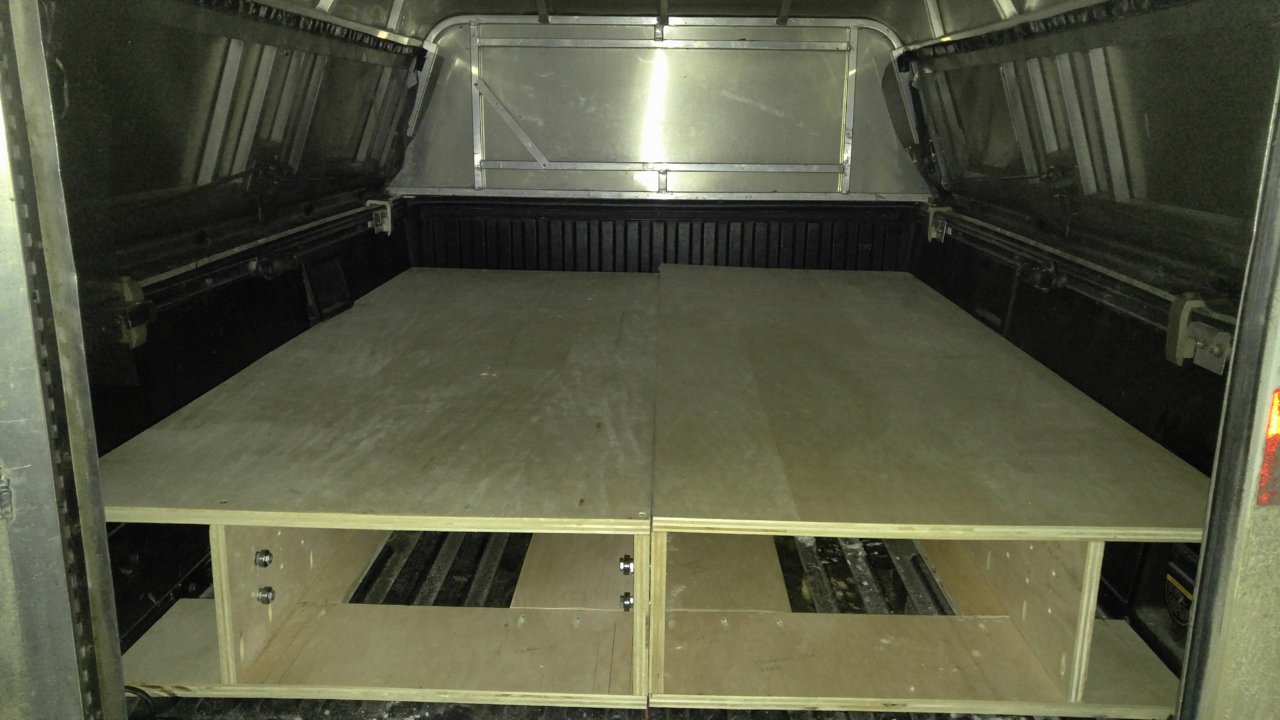

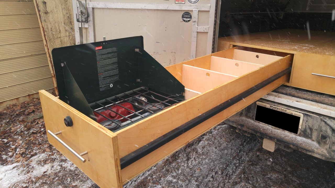

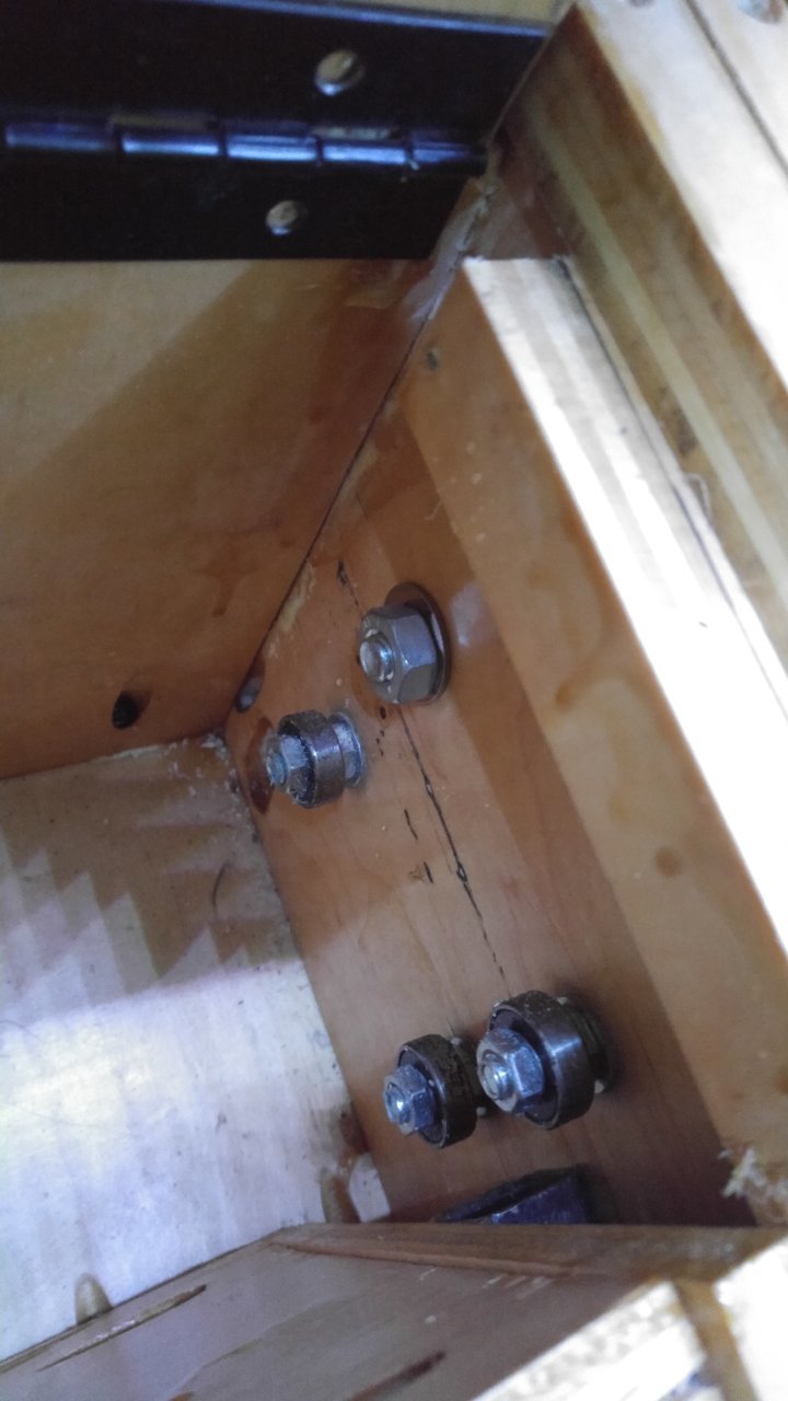

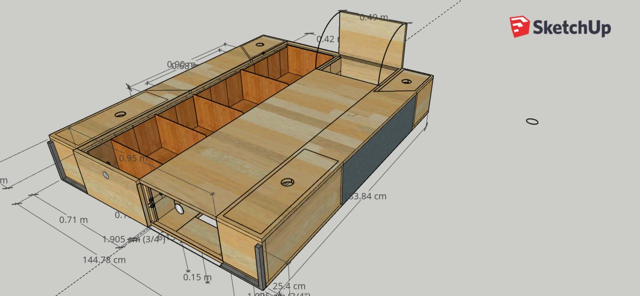

    WOW.....all I can say!

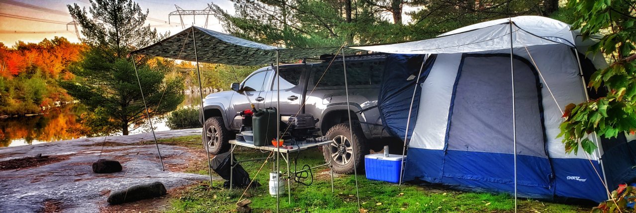

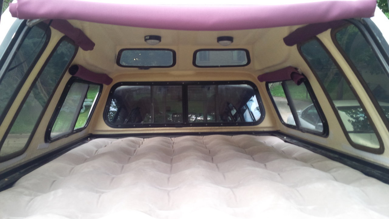

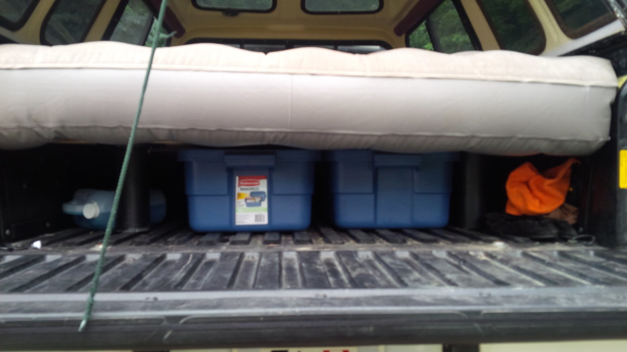

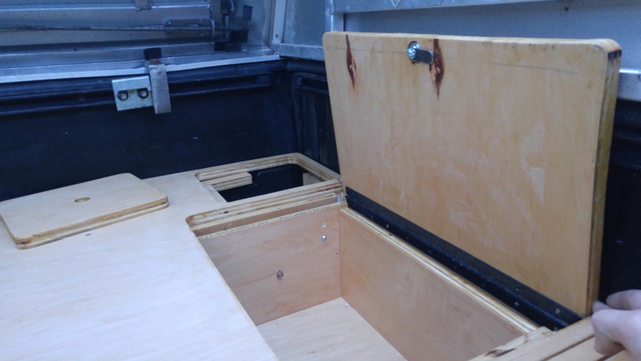

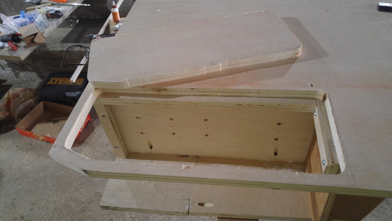

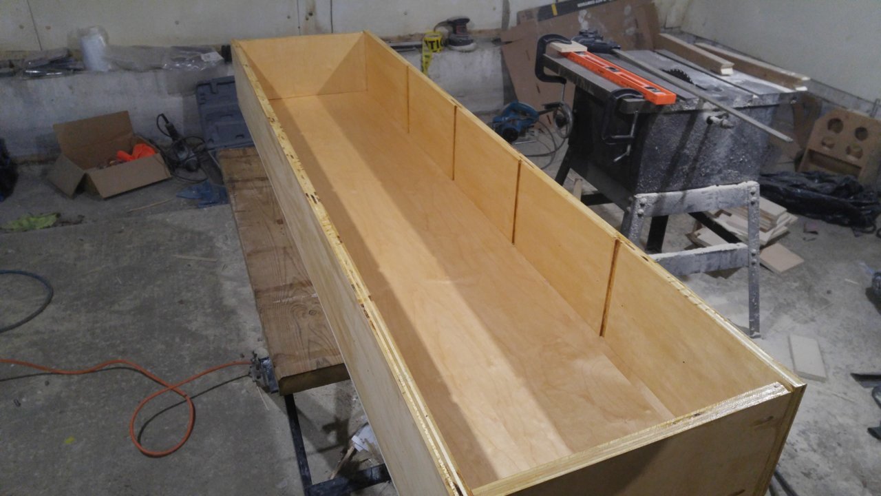

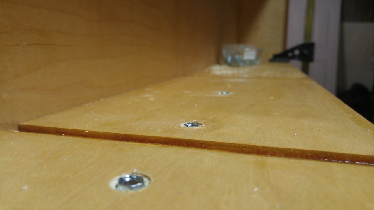

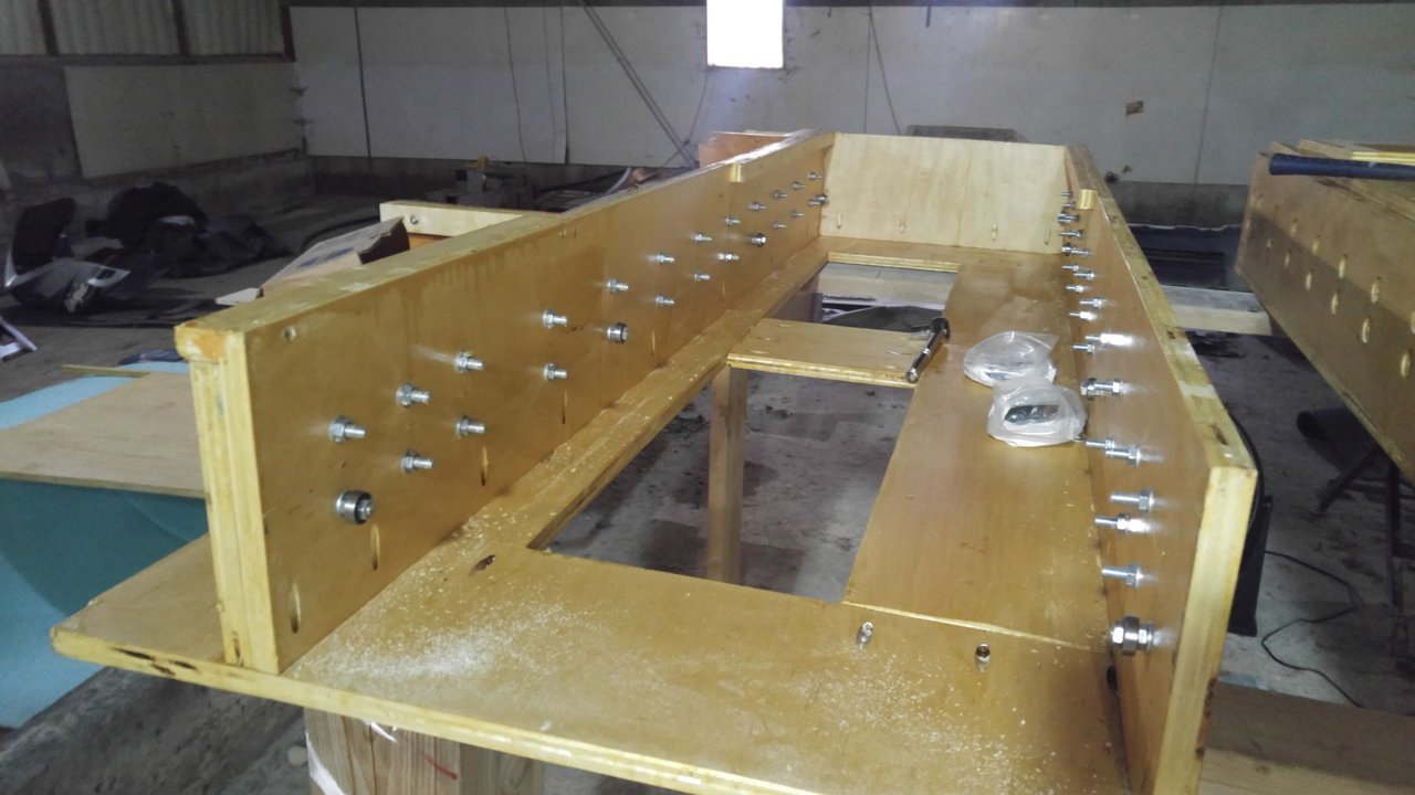

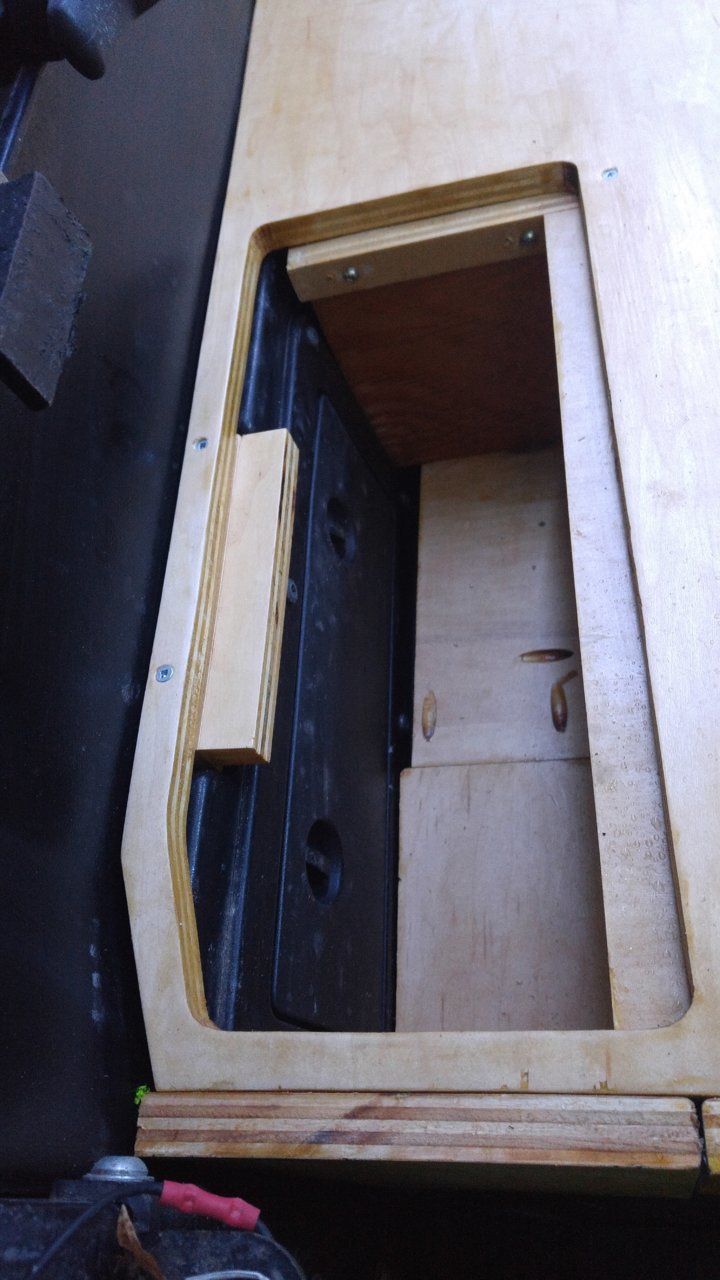

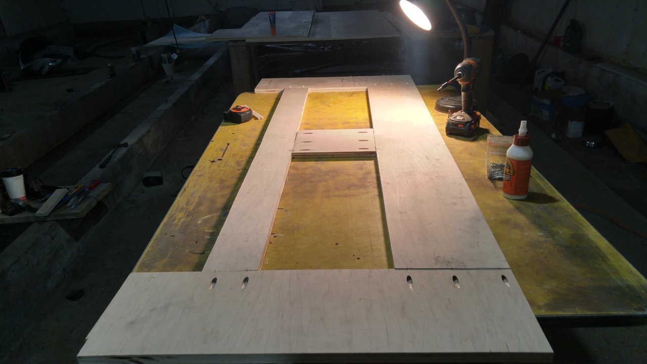

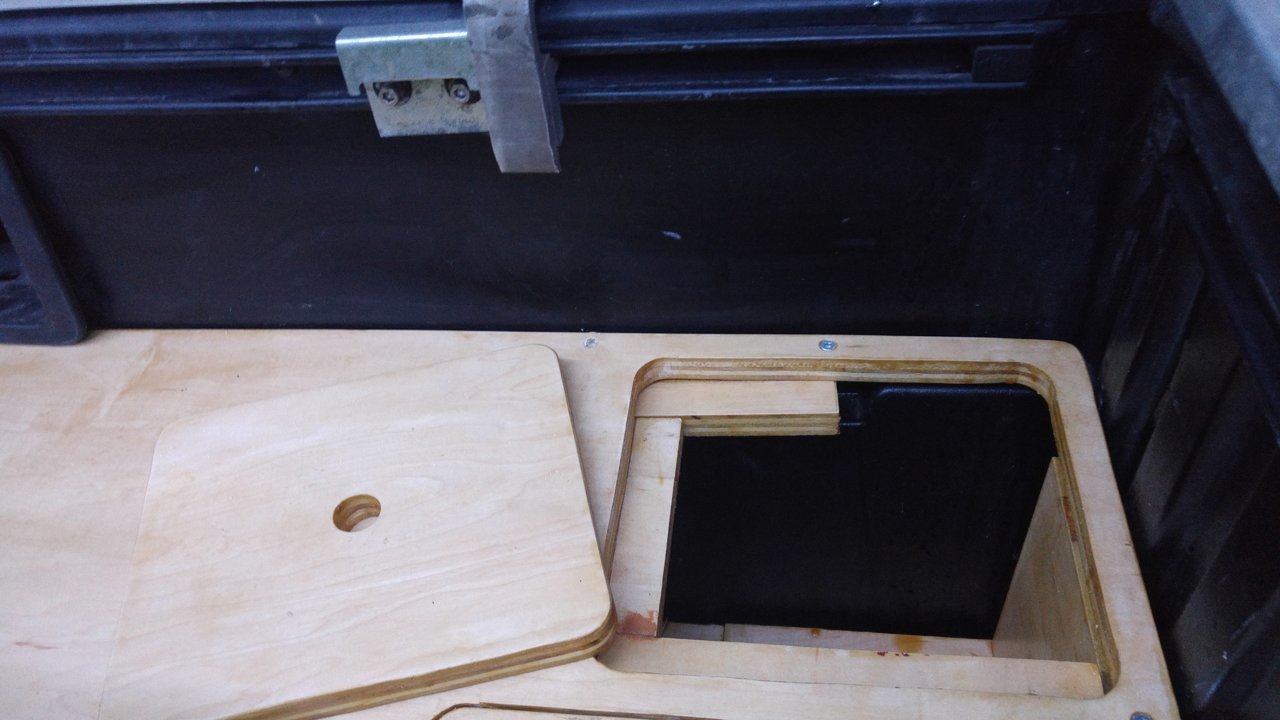

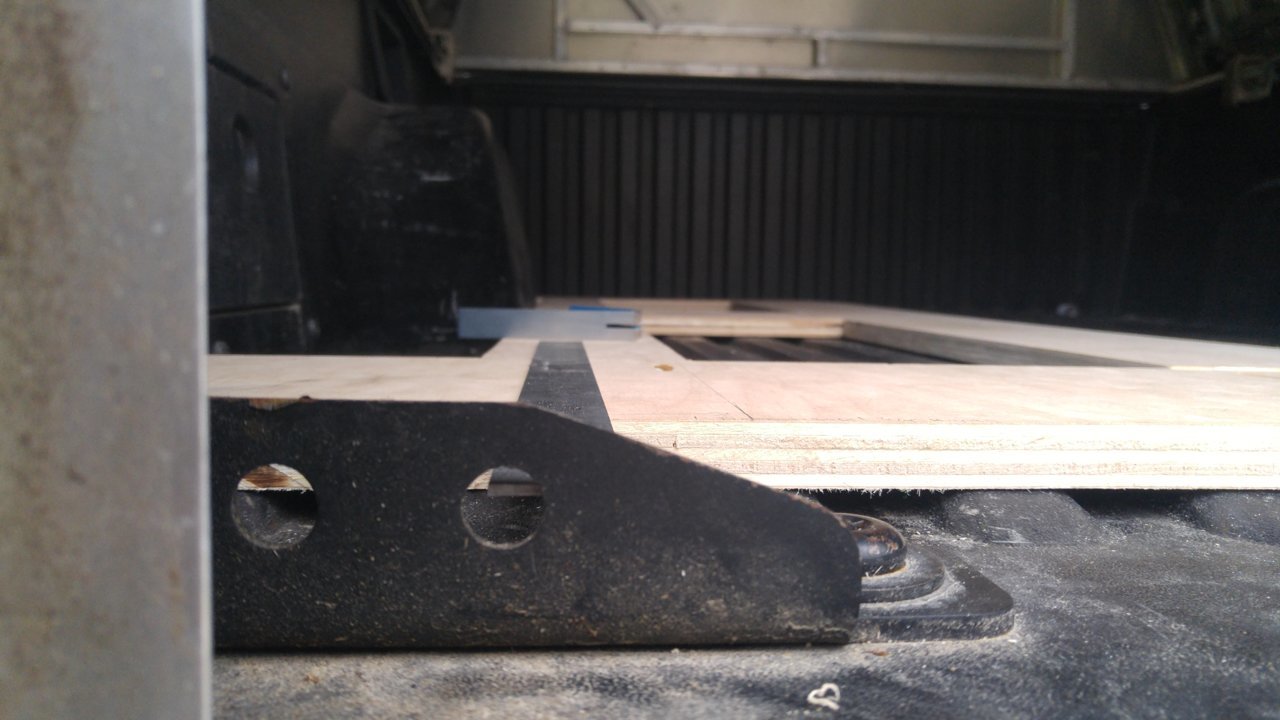

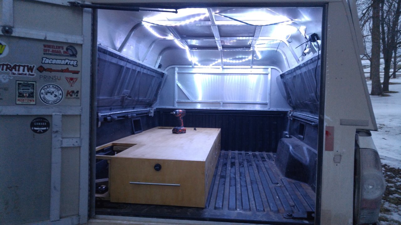

    Thanks bud :drunk:
    Couldnt have done it without the people on this ridiculous site, plus I wanted an upgrade from a piece 3/4" plywood with 2 x 4's on PVC cut offs lol
