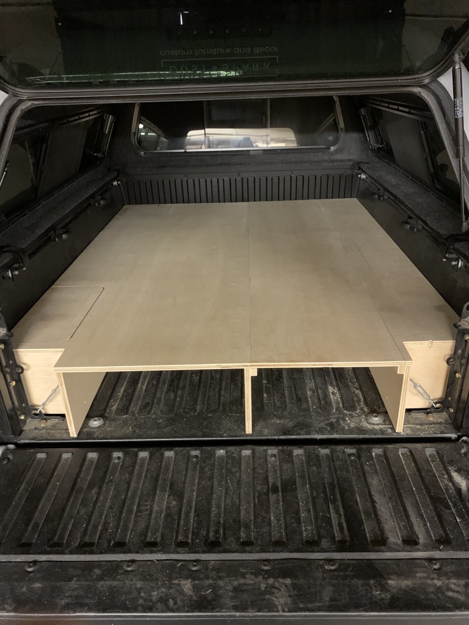

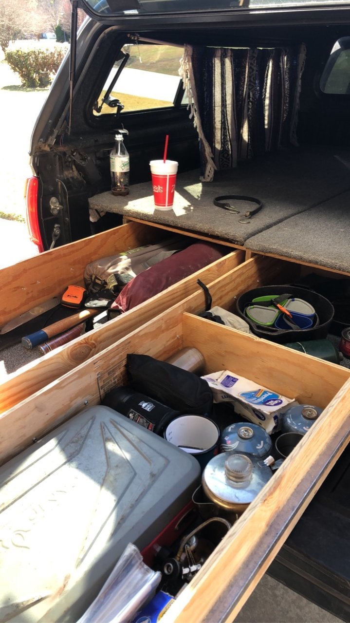

    Apologies if this isn't the right place. I have a drawer set up I'm looking to sell. Pretty cool set up carpeted drawers with a bottle opener on the end. Main compartment fits in bed and has tie downs I'll include. Side pieces come out, they sit on rails installed via molly bolts. Shoot an offer, it's currently in my garage. Inland Empire, CA

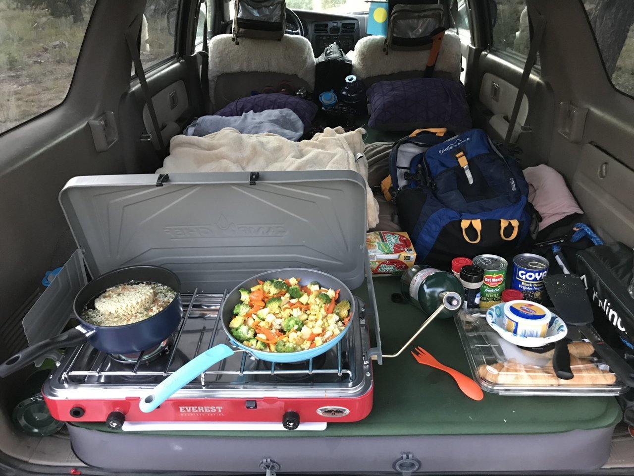

    Pretty simple. Kitchen goes in the back while we drive. Kitchen goes in the passenger seat while we sleep. Everything else stays in place. Lived out of this setup with zero complaints for 30 days and 6,500 miles straight last fall. Will be doing another 30 days this Spring with the exact same setup.

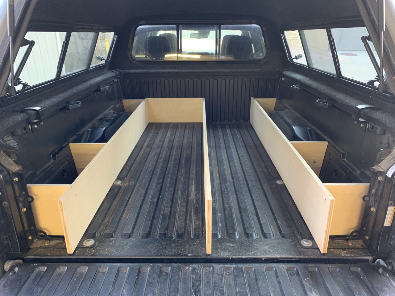

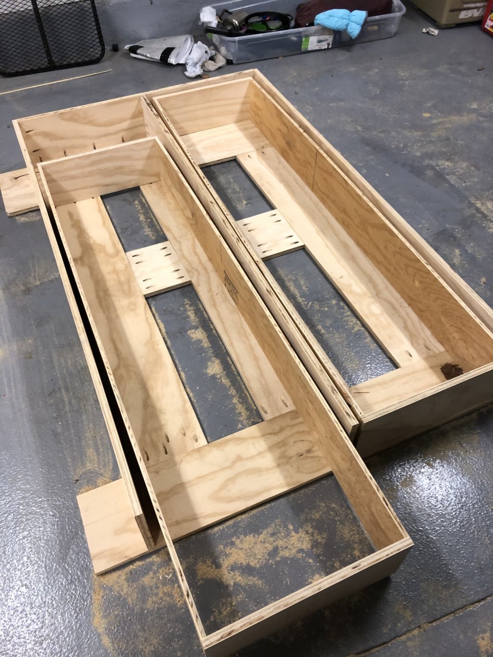

    Finally got around to updating my bed. For 2 years now I’ve had 2x6s laterally and carpet covered plywood on top. It’s worked great, but it sits low and I was tired of being unorganized. Borrowed the PaskMakes drawer plans on YouTube, and pretty pleased. My cuts aren’t square, it was trial and error, but works for me! More pics or plans if anyone wants them, message me.4857A8E1-DB70-4806-9C33-B14FF21D09F0.jpg3C82C199-92AC-4E4A-8D8D-6B2212B937C0.jpg57B55001-10FF-46E6-B55A-C758F1A2BF6A.jpg
