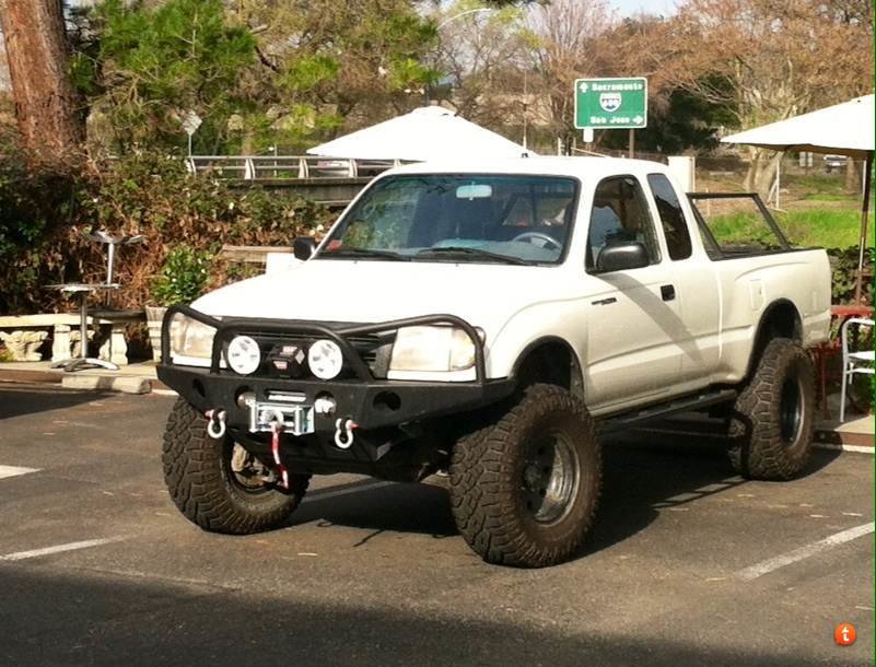

    98 Tacoma 4x4
    ubyqutyd_e65d7ce94cced56dc1bd171acfea8623e28d8d70.jpgybu5u8y6_7ef5fae83508d170059330f29c29999ef47f4f52.jpg
    Finally got one!

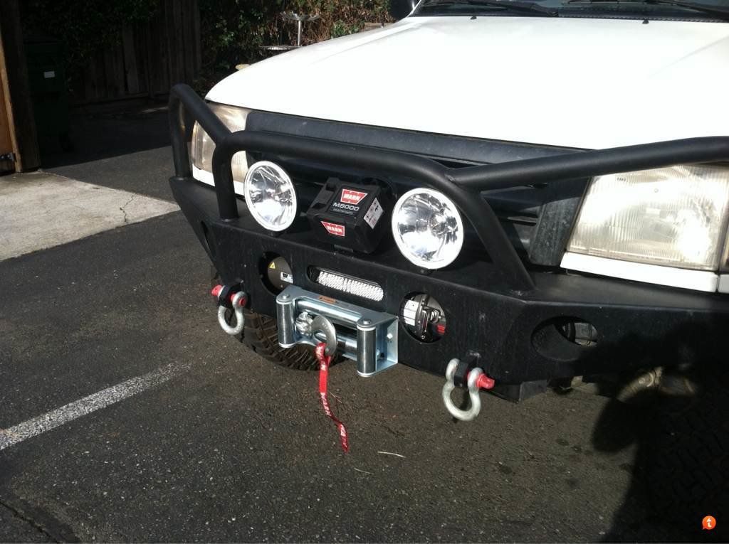

    11, 4dr, TRD Sport, 6sp
    DCFB
    Superwinch Tigershark 9500

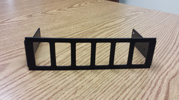

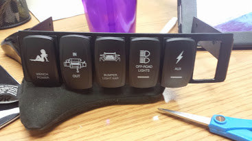

    Has anybody done this If so is this pretty universal for winches? I just order switches.
