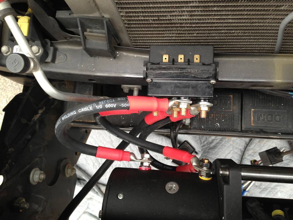

    After having the bumper sit around for almost 2 years and the winch sit around since June 2013...I finally slapped them on last weekend...
    I relocated the solenoid pack to behind the top passenger side of the grill and mounted it on a custom bracket I welded in. I clocked the disengage lever one rotation forward to make it easier to access. I spooled up the AmSteel-Blue synthetic line on Saturday morning...got stuck Saturday night...and did this to it during the first 20 seconds of winching...still not sure what happened!
    The winch is a Superwinch Talon 9.5... bad ass winch! Tough choice between this one and a warn ZEON...but after tons of research I went Superwinch!
