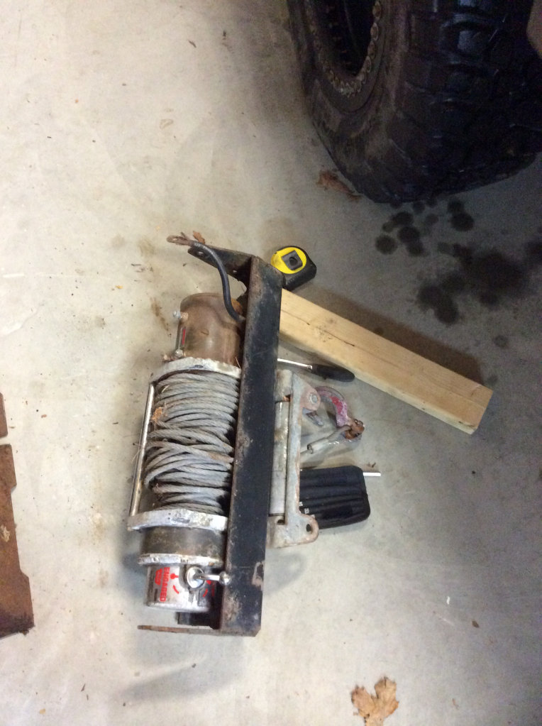

    limited 4runner
    Just picked up a warn m8000, looks like I'm missing the relays and haven't been successful finding a wiring diagram for it. Could anyone point me in a good direction to parts and diagrams? Thanks!
  17. Nov 10, 2014 at 8:25 PM
    #537
    Jiveydude
    Jiveydude Well-Known Member
    Oct 22, 2013
    #115035
    1,324
    Micah
    OH
    04Taco
    Stuff and things that make it better.
    Without your serial number, this is all I got.
