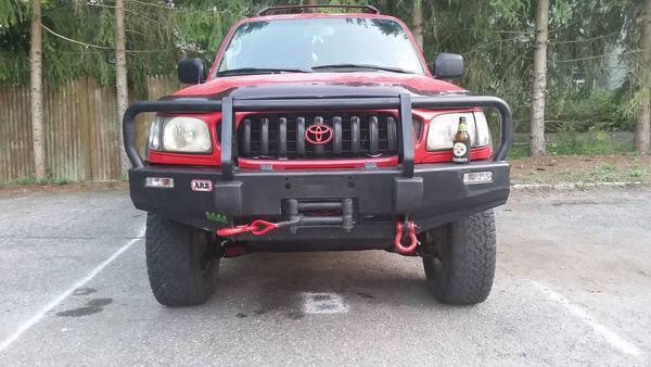

    They're just using amsteel line (which is on the table as an option). I'm not too concerned about the fairlead at this point in time. it was just a comment on a fairlead upgrade down the road for my next bumper.
    my current question is regarding the line itself.

    Gotcha.. Makes sense. ARB has a great design imo. You've got a great build! Looking forward to see what you design for a new bumper.
