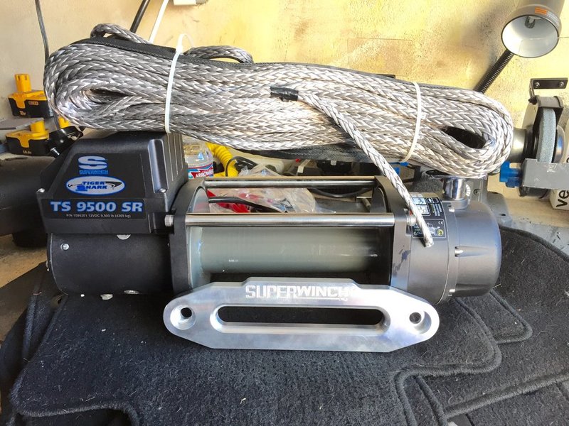

    Nobody has posted here in a while so here is a little thread revival action. Just got my Superwinch Tigershark 9500 with synthetic line and Aluminum Hawse fairlead. Pretty excited about it. Now just gotta build a new front bumper for it to go into haha

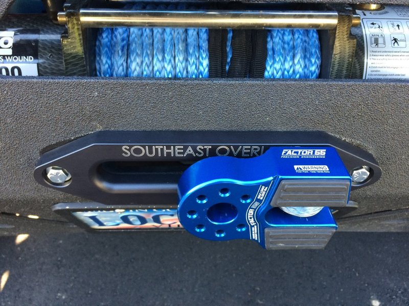

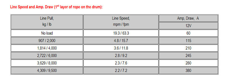

    Just for sake of comparison between the ComeUp and Warn. Here's the spec sheets I found when researching them on my own. First here's the specs for the ComeUp Seal Gen2 9.5rs
    Specifications:
    Rated Line Pull 9,500 lbs (4,309 kg) single line
    Motor 5.0 hp / 3,730 w 12V Series Wound
    Gear Ratio 3-Stage Planetary 159:1
    Clutch (freespooling) Rotating Ring Gear
    Brake (outside the drum) Automatic, full load CBS (Cone Brake Structure)
    Winch Construction Aluminum Die Cast Housing with Steel Drum
    Drum Size 2.5" x 9" (63.5 x 228 mm)
    Control Both built-in digital two way signal wireless remote control and waterproof remote with thermometric indicator LED w/17' (5 m) cord
    Rope Type Synthetic Rope SK-75
    Rope Size 3/8" x 100' (10 mm x 30.5 m)
    Mounting Bolt Pattern 10" x 4.5" (254 x 114 mm)
    Winch Weight 61.7 lb (28 kg)
    Gross Weigh 89.1 lb (40.5 kg)
    Warranty Limited lifetime warranty for mechanical components, three (3) year warranty for electrical components
    Box Dimensions 26.9" x 8.2" x 16.9" (682 x 209 x 430 mm )

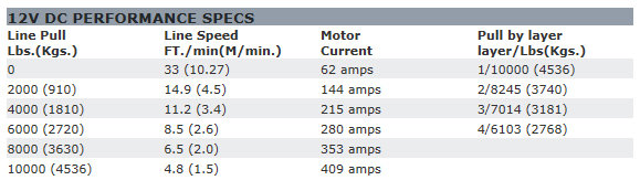

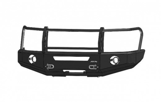

    Here's what I found for the Warn Zeon 10.
    Rated line pull:
    10,000 lbs. (4536 kg) single-line
    Motor: series wound, 12V DC, 24V DC
    Electrical controls: Contactor
    Remote Control: Remote switch, 12' (3.7m) lead
    Geartrain: 3-stage planetary
    Gear ratio: 216:1
    Clutch (freespooling): Rotating ring gear
    Brake: Automatic mechanical cone
    Drum diameter/Length: 3.15"/9.0" (80mm/229mm)
    Weight (kit shipping): 98 lbs. (44 kg)
    Rope: 3/8" x 80' (9.52mm x 24.38m) steel
    Fairlead: Roller
    Recommended Battery: 650 CCA minimum for winching
    Battery leads: 2 gauge, 72" (1.83m)
    Finish: Satin-black powder coat
    Warranty: Limited lifetime
    For me the ComeUp was the better choice. It was lighter, but nearly equal power. The ComeUp has slightly higher gear ratio but nearly double the line speed. I did a side by side pull with a Jeep buddy who lives near me that has a Zeon. It was a single line pull up a moderate incline. It was a little difficult to judge the power output but my Cruiser is MUCH heavier than his jeep and the ComeUp pulled the cruiser up the hill dramatically faster than the Warn. Also, from my recent experience of being stuck in a muddy riverbed I have no hesitation about the power of the ComeUp. We couldn't even move my cruiser an inch trying to snatch it from the mud with a strap but the ComeUp had no problem breaking the suction and pulling the cruiser out. The other things that were a plus with the ComeUp were the wireless remote and synthetic rope (20' longer than the wire rope on the Warn) that were included. Those were both extra upgrades with the Warn. Even with the wireless remote and synthetic rope the ComeUp was less expensive than the Warn. So very similar winches with similar ratings but better price, better performance and from looking at them side by side I'd say equal quality to the naked eye, but from everything I've seen and read the waterproofing of the ComeUp is superior so that gives the quality edge to the ComeUp in my eyes.
