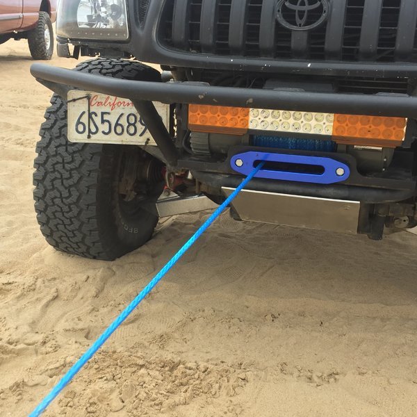

    I thought it looked just like all the other ropes ive seen. Did have to recrimp the terminal on the end which was no big deal. 125' is a lot of line.

    Yeah, I've got something like 125' of steel cable right now. I've never had it all out. Was the installation easy? I don't even know how you do it

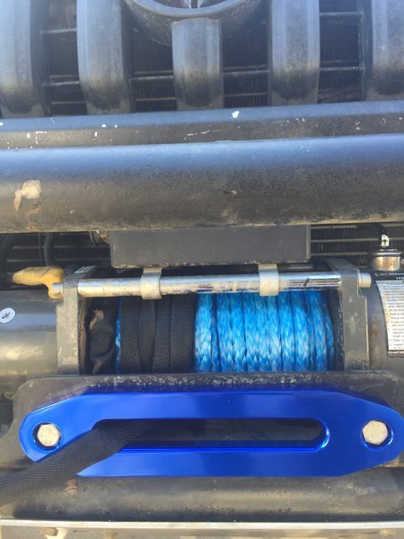

    Super easy once i recrimped the line. You undo your steel cable. Undo the allen head that holds it on. Attatch the line just like the steel cable was. I then spooled the first 15' with just hand tension then put the car in neutral and attatched the hook to my dads jeep and I pressed the button while my dad fed it in. Took maybe 30 minutes. The line lays itself for the most part just had to redirect it on the ends. Helps a lot to have a second person direct it while someone presses the button. And make sure the car is going straight lol.

    Yeah i got their diamond line which was cheaper but had good reviews as well.
    http://www.customsplice.com/product-p/5-16diamondline.htm
    They have an Amazon store as well so I ordered off of their incase there was any problems but got blue cause there was no options on amazon. Would have prefered grey.
