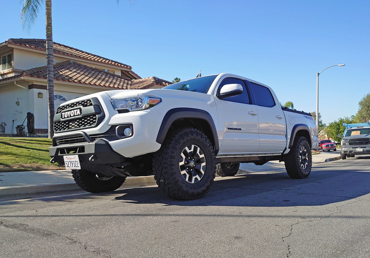

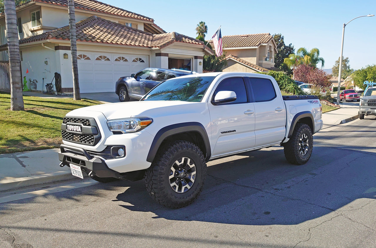

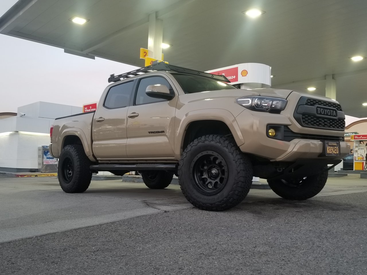

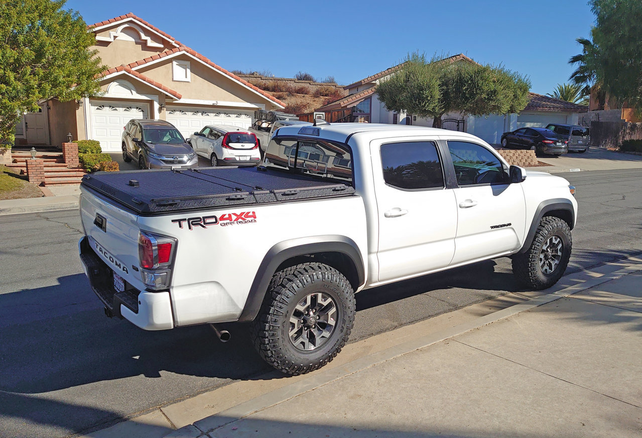

    285 75 16 Goodyear Wrangler Duratrac tires on stock Off-Road wheels with 1.25" Spidertrax spacers. Currently sitting at stock height with a cab mount chop and some plastic trimming inside the fenders, and I still get just a little bit of rubbing if I hit a dip with the wheels turned or fully locked in reverse. I'm just waiting for Headstrong's progressive AAL to be back in stock so that I can install my suspension setup, which will give me about a 2" lift in the front and 1.5" in the rear.

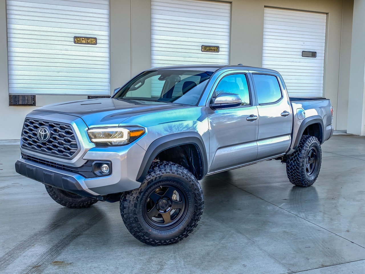

    285/70-17 Nitto Ridge Grappers SL
    Volk TE37XT 17x8.5 -10
    Lifted about 2” /JBA UCA/no CMC (yet)
    Good so far , no rubbing on the drive home and into my driveway.

    Looking good my dude.

    This looks perfect right now. I wish I could do this without the CMC.

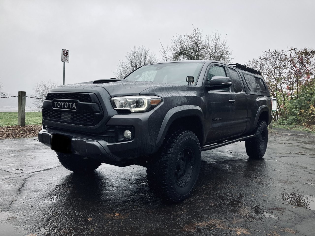

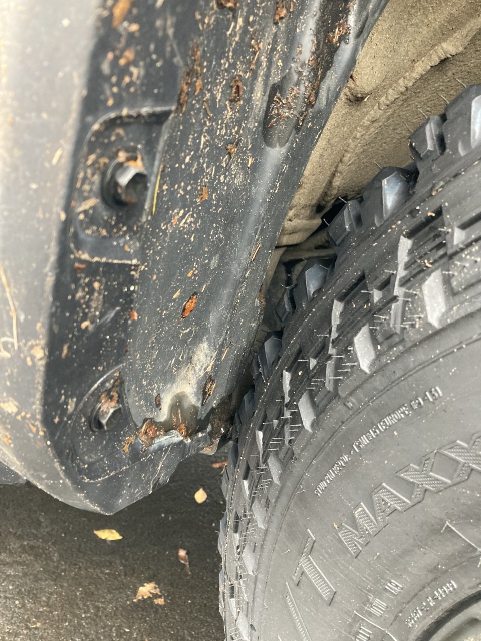

    285/75/16 ST Maxx with 2.5/4.5 lift via Bilstein 6112/5160 and Ironman leaf pack. Super rubs at full lock and bumps, waiting for CMC this week before going anywhere far.

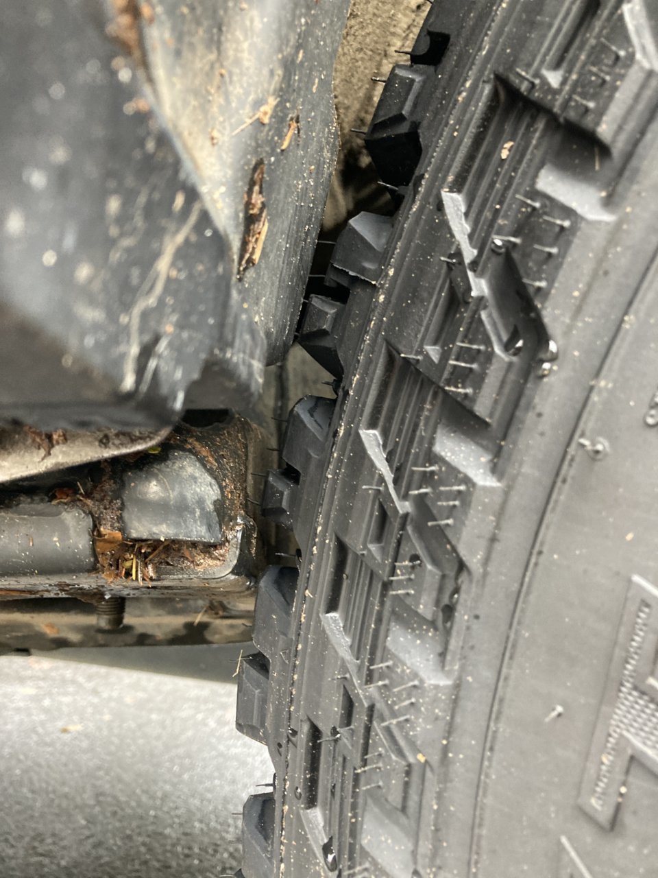

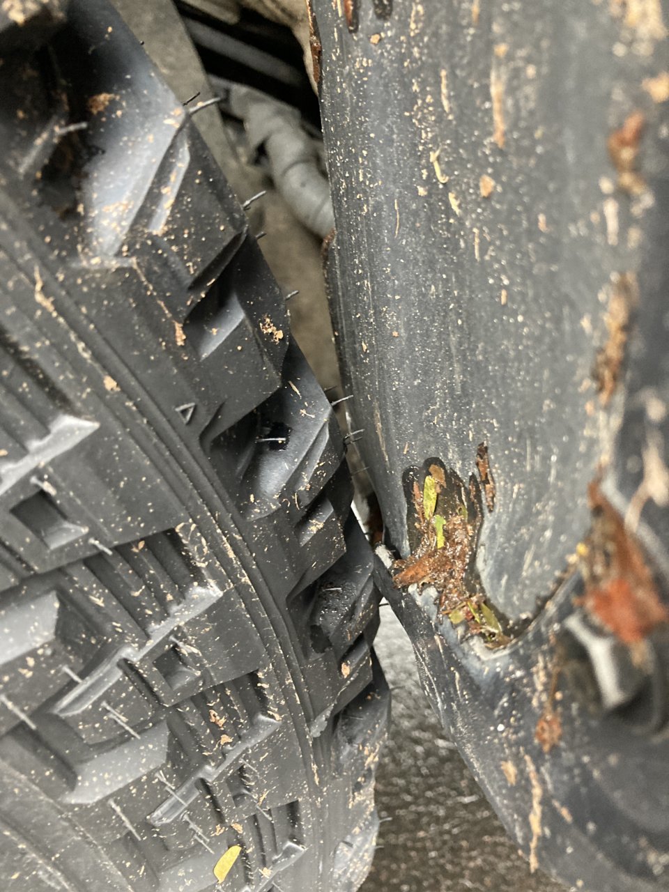

    CMC scheduled but do you guys think I need to get my pinch weld done too? First time having a truck cut up...

    Pinch welds are doable yourself. 5# hammer is your best friend. I'm in the same situation. CMC next week and I did the pinch weld myself already to save some money.

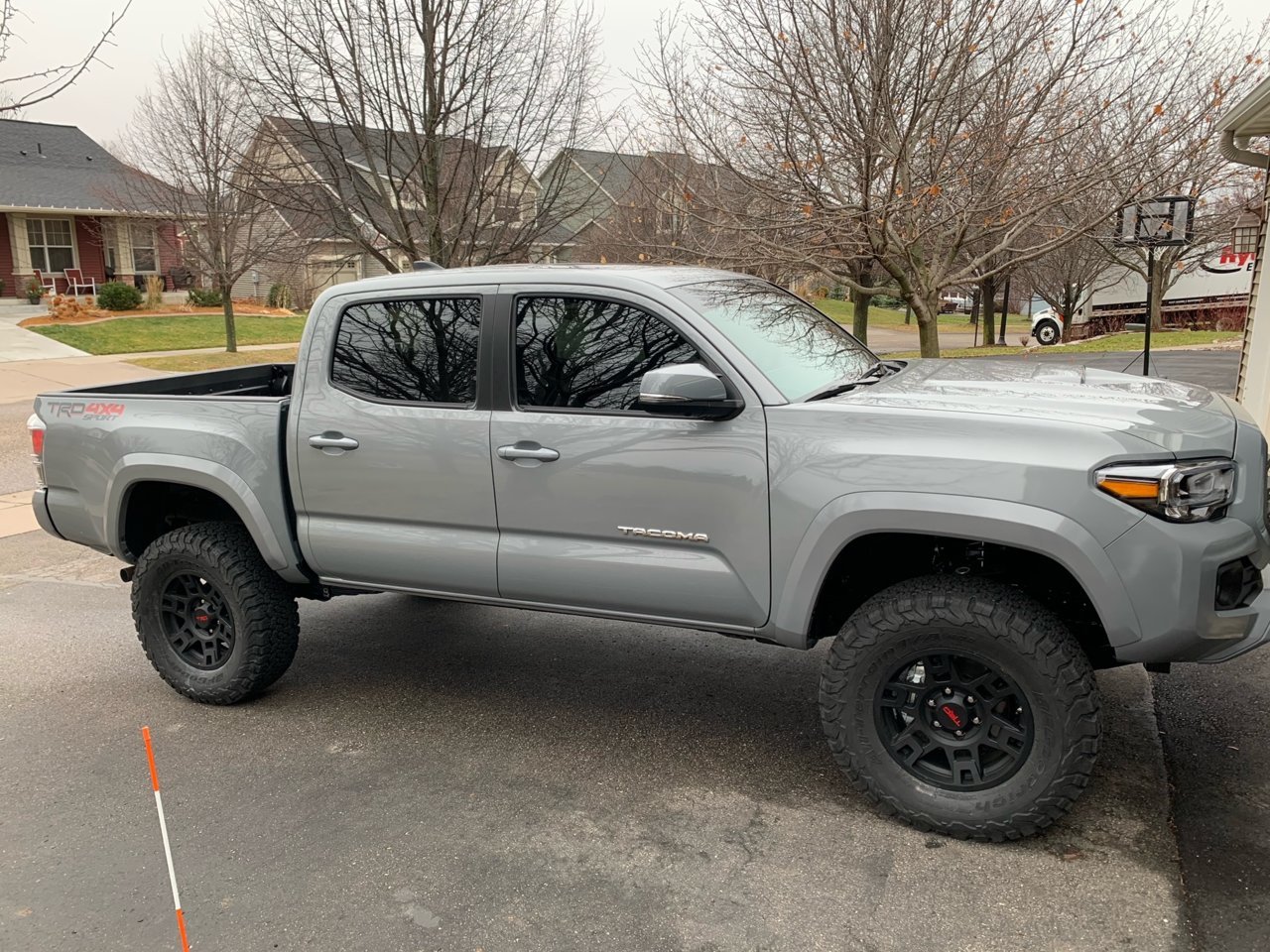

    BFG KO2s in 285/70R17

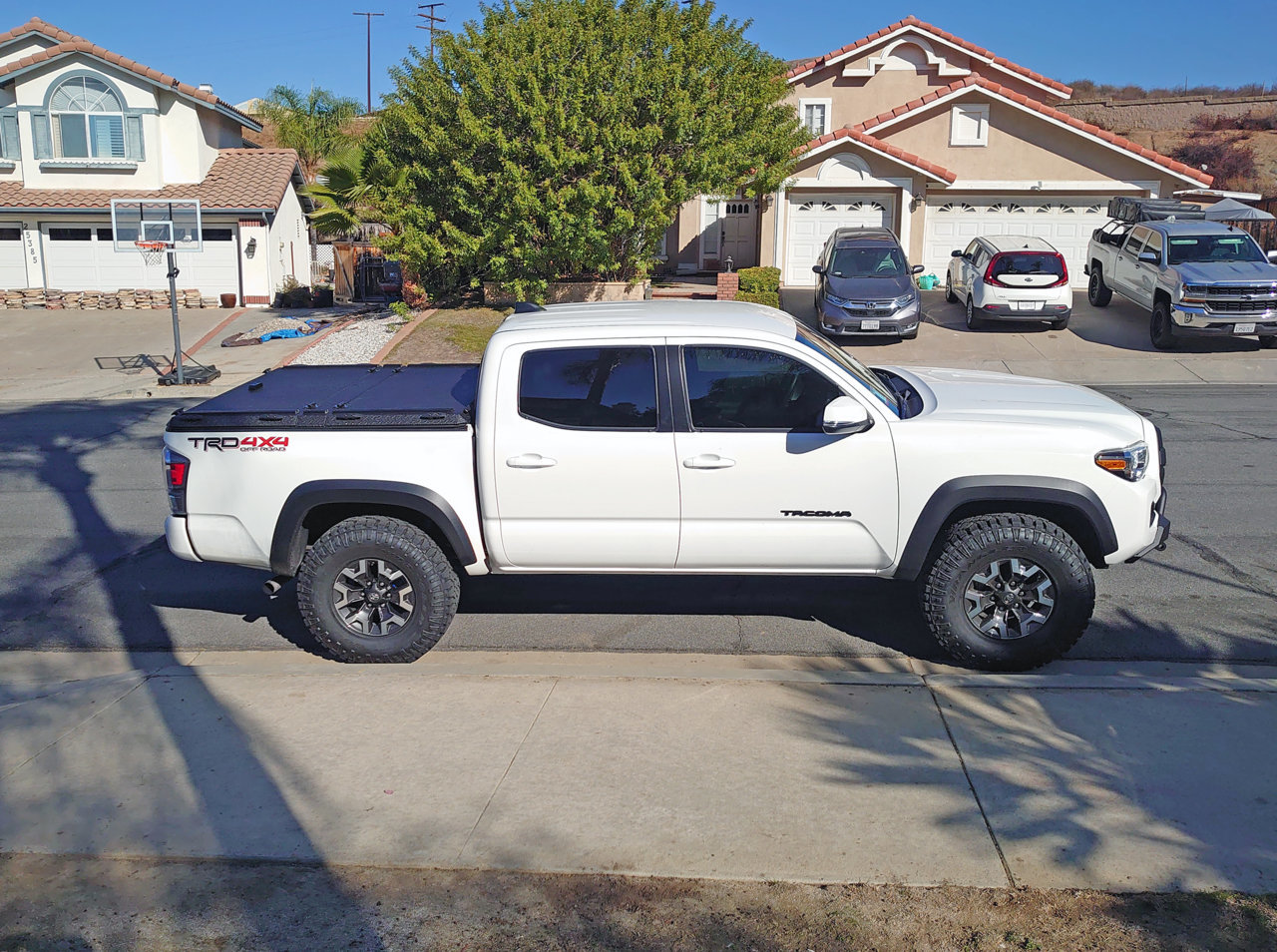

    Nitto Ridge Grapplers 285/70R17. I had minimal rub with the stock UCA’s and Eibach pro shocks for a 2” lift up front. Added JBA UCA’s and after an alignment rubbed backing up. CMC and pinch weld flattened no rub anytime. Also Method 17x8.5” rims 0 offset, no rubbing issues with stock or aftermarket UCA’s.

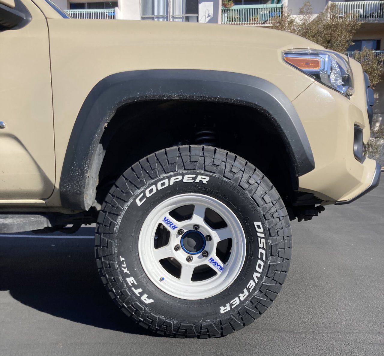

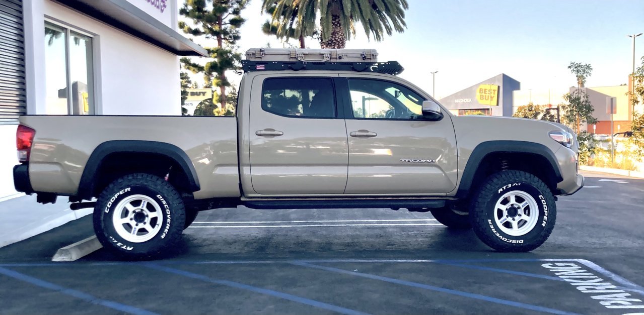

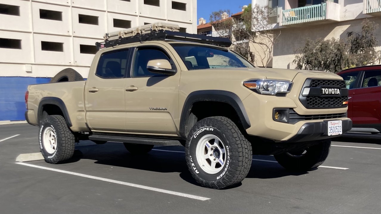

    AT3 XLT 285/75/16
    Eibach Pros on middle notch.
    Doing CMC next week to try and rid the rub on full lock. Doesn’t help I’m running +0 and 1.25 Spidertrax spacers

    Dem TEs doe

    that is super nice!

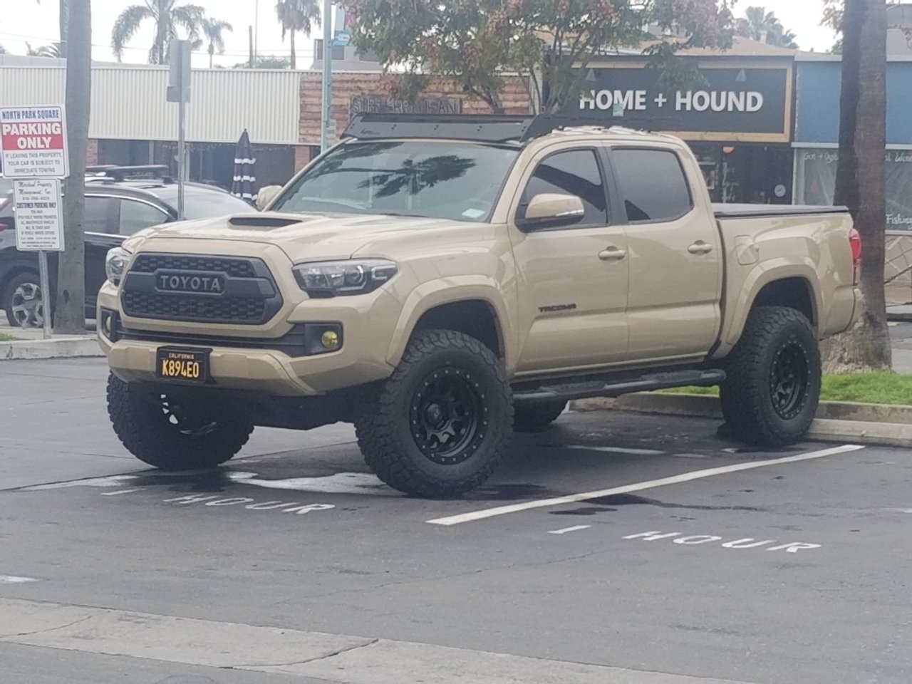

    That is the best looking desert beige Taco I have seen! Well done. Everything looks perfect.

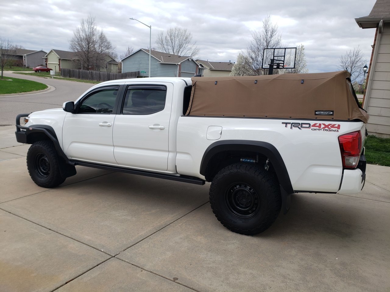

    20200328_165810.jpg steelies with k02 285 75 16

    Looks great

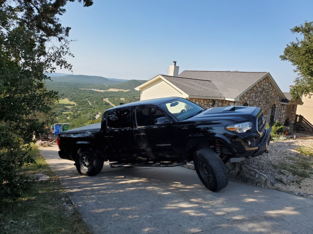

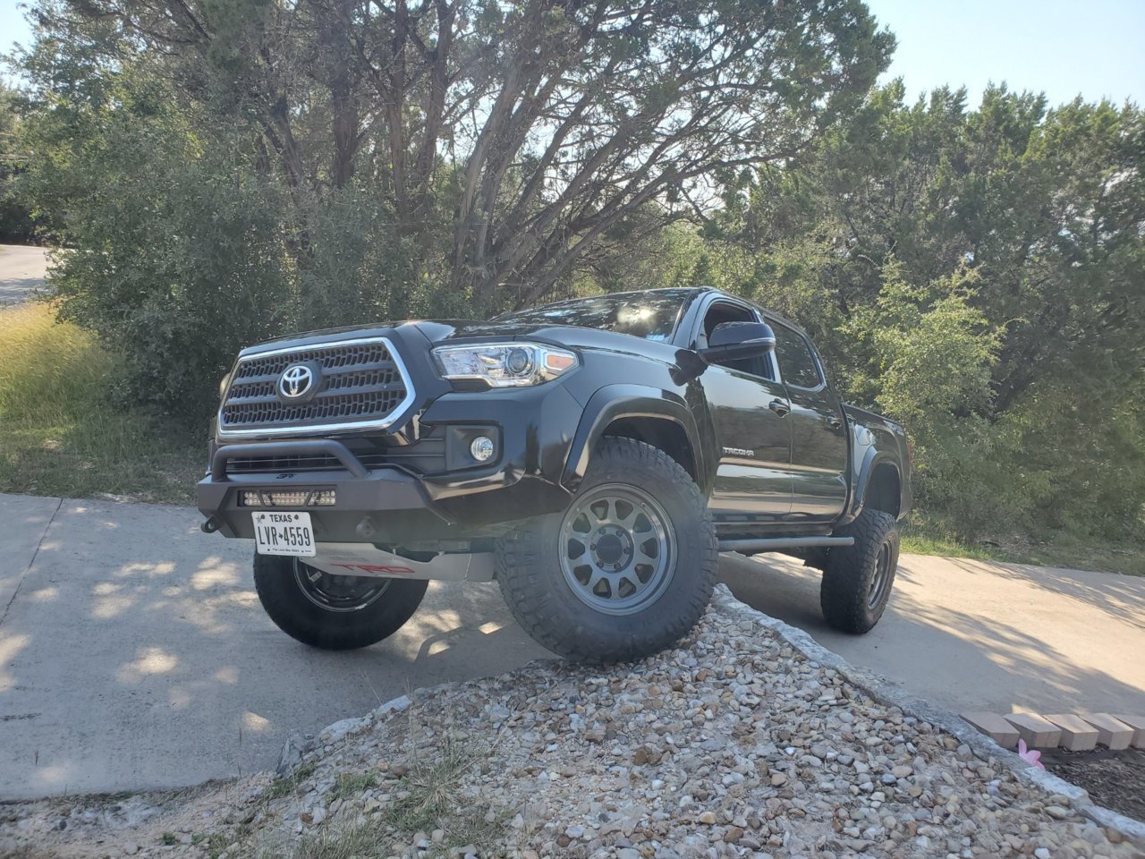

    Eibach stage 1 2.0 coilovers and rear shocks, JBA high caster UCA, Wulf AAL. Also did the ecgs bushing, CMC, and 3 degree axle shims.
    Wheels are Kansei KNP off road 17x8.5 -10
    Tires are Falken Wildpeak MT 285/70r17
    slight rub on plastic when turning full lock in reverse.

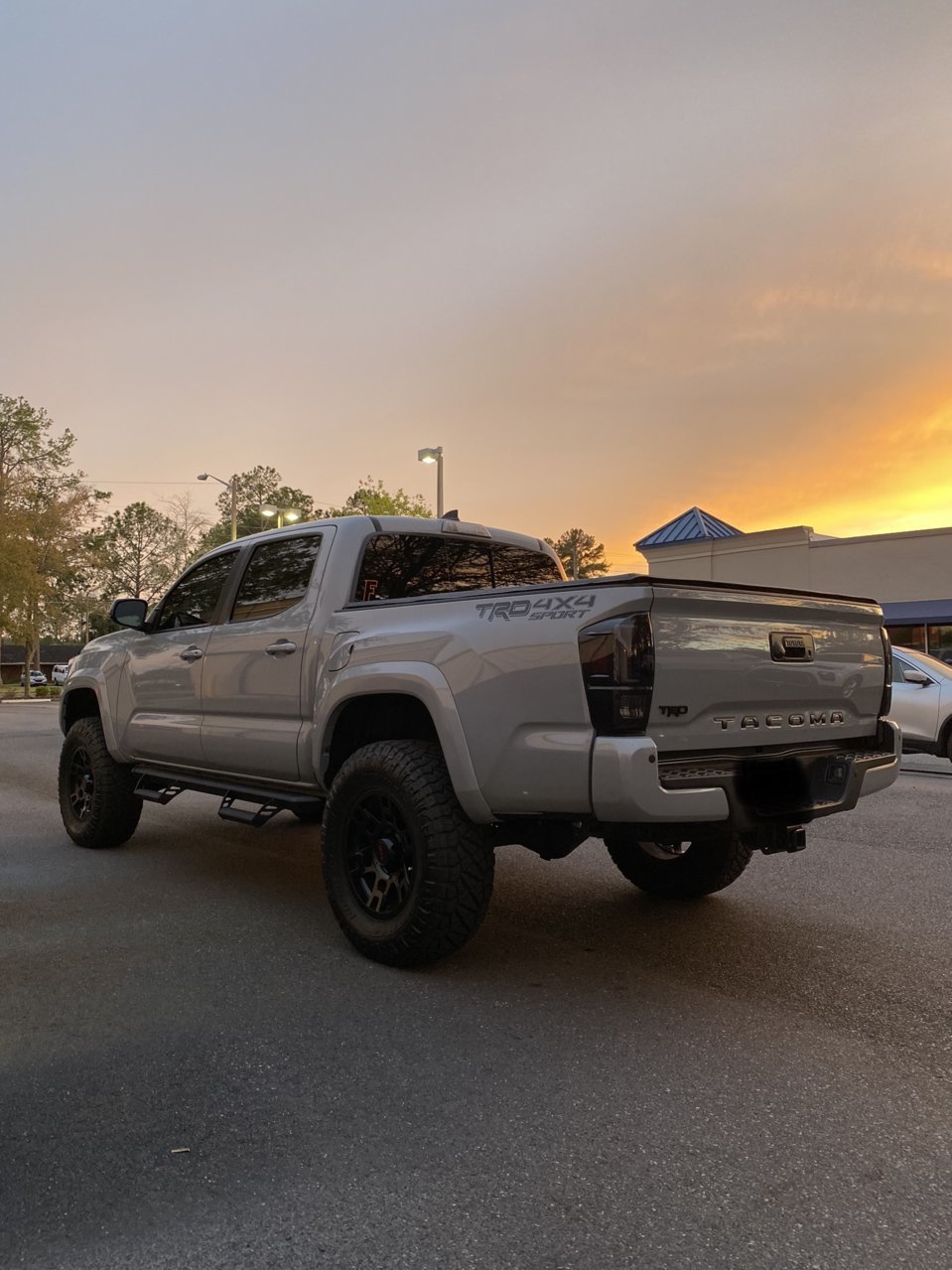

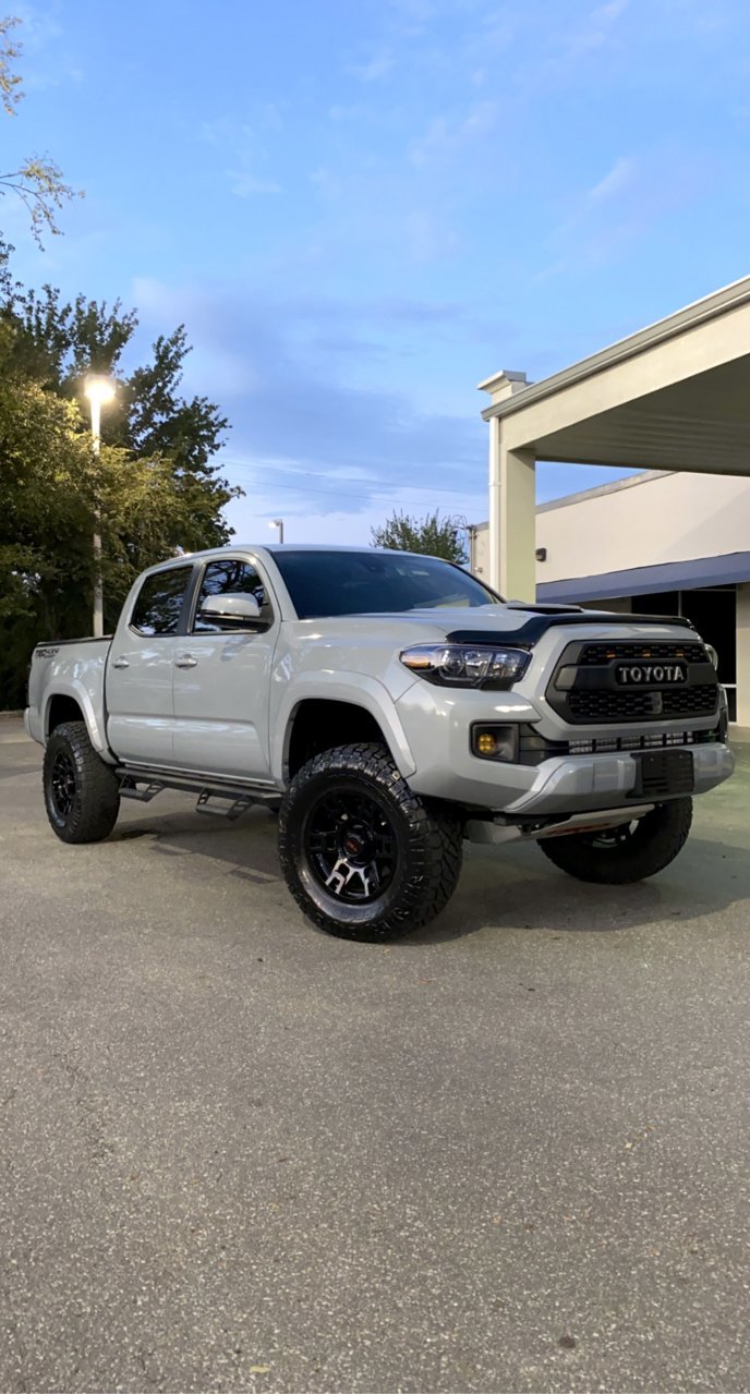

    285/70r17
    zero offset

    Looks good, how you liking the Wulf AAL? 2" lift in the rear w/ AAL?
