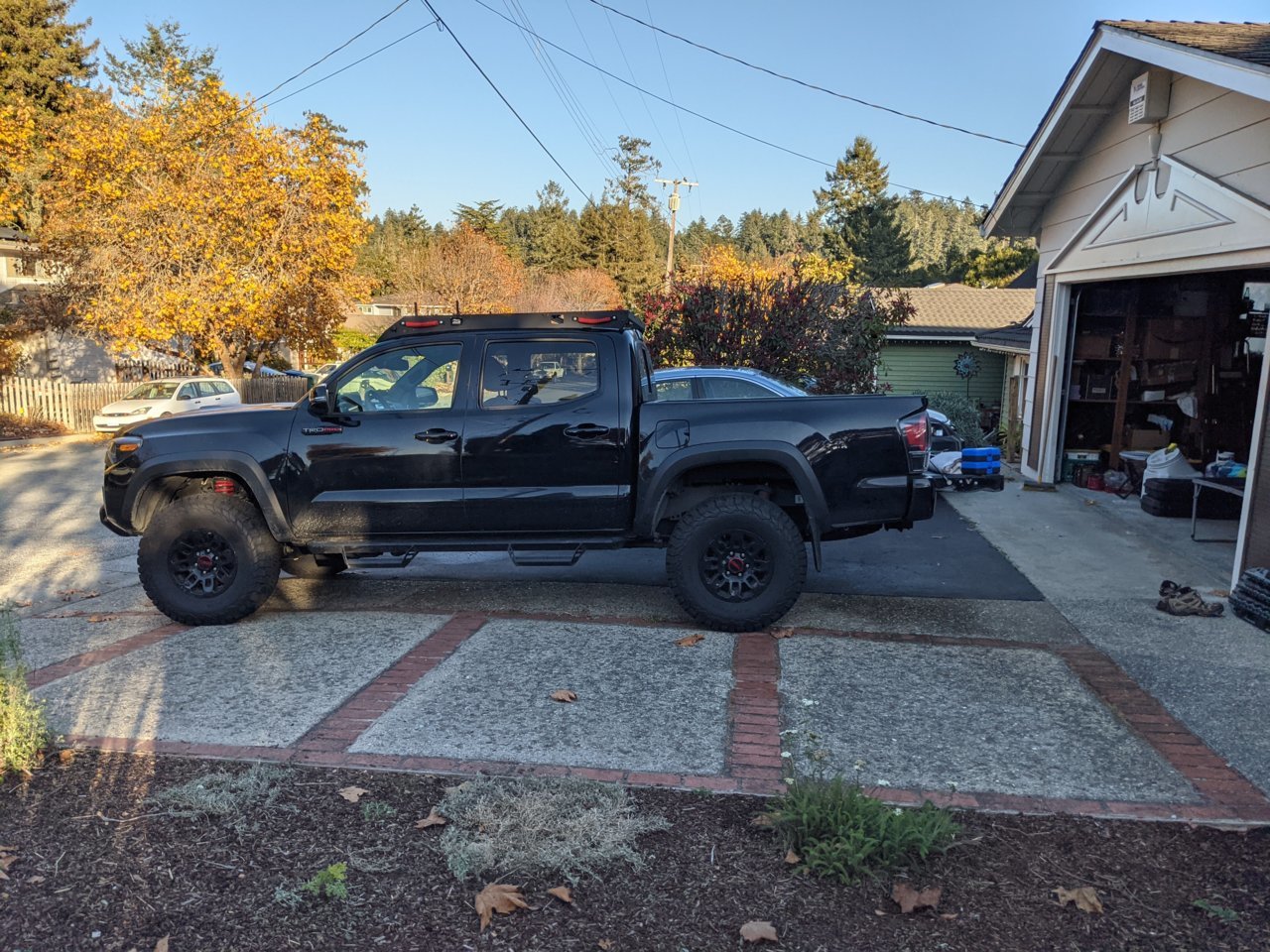

    285/75/16 BFG KO2 on Trd pro shocks, westcott front kit and icon RXT option 1 on the rear. (I would do option 3 but still waiting on @Wheeler's Off-Road Inc to ship me the missing leaf from the pack) 1.5" up front and similar in the rear. CMC and no rubbing.

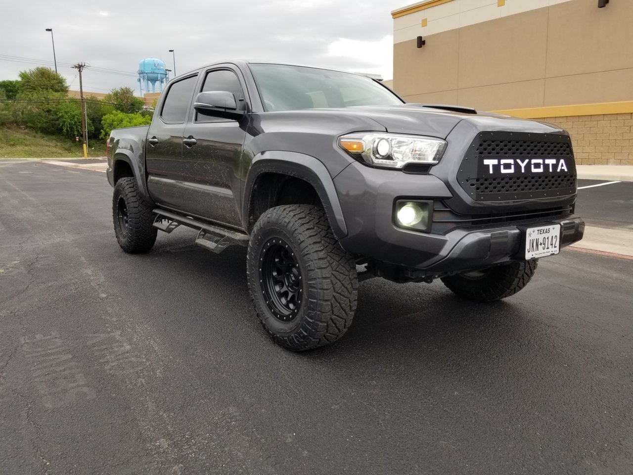

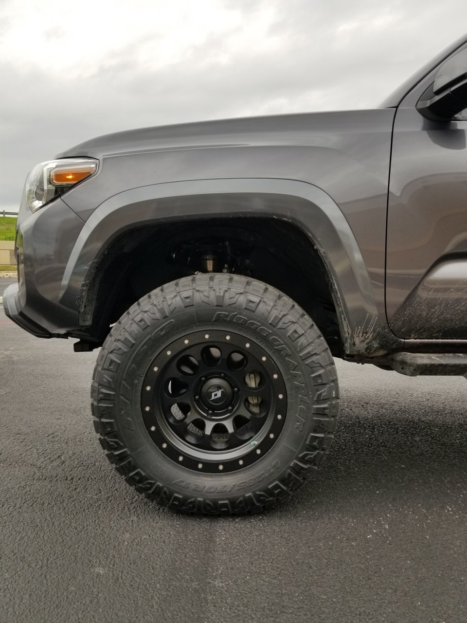

    Going with the ridge graps aswell, picking them up tomorrow. Great looking truck how has the tread held up?

    how does the ICON RXT pack ride with the pro shocks? Notice anything bad considering they are now riding in a different place than the valving intended? I’m thinking about doing the same paired with the Eibach spring upgrade when it’s available.

    With the amount of weight I had/have on the bed they actually rode a lot smoother than stock . Somehow it made the truck feel lighter. This is only on option 1 though which would be the softest ride vs the others but I think also just being a more progressive pack helps. Definitely happy with them so far and I just got back from an 8 day 1500+ mile trip with 700+ lbs in the back.

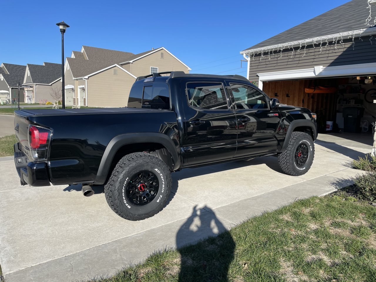

    285/70/17 KO2 on Methods

    Love this with the bronze ring and black bolts!
