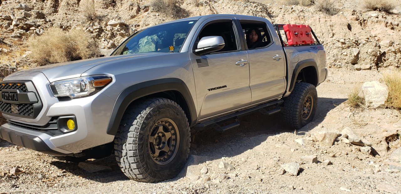

    I still rubbed on my 2018 pro with CMC on 285/75/16. I put Westcott on the front and icon RXT Leaf pack in the rear. No rubbing looks great and rides amazing with a little weight in the back.

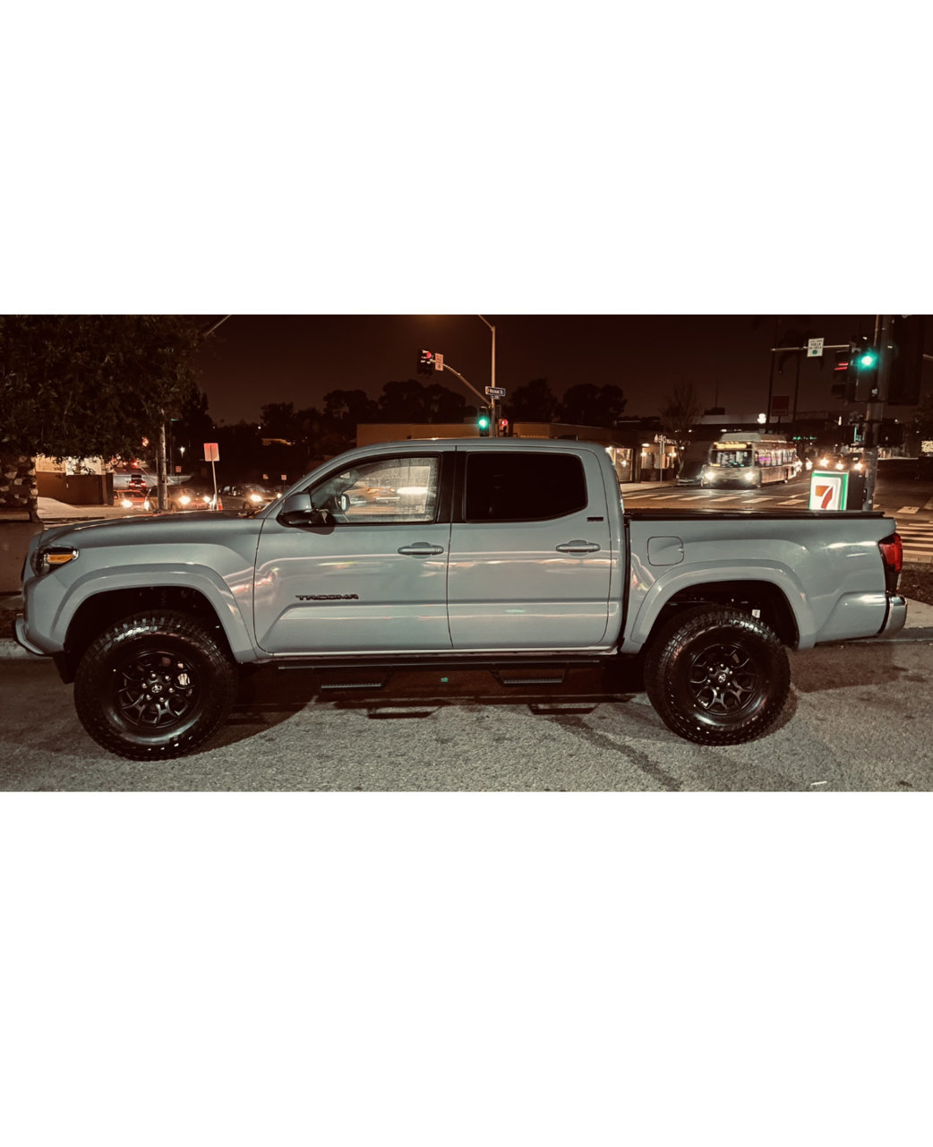

    First time poster, long time lurker! Just put Bfgoodrich KO2's 285/70/17 on the truck. Picture was before CMC. Could not make any sharp turn without rubbing!

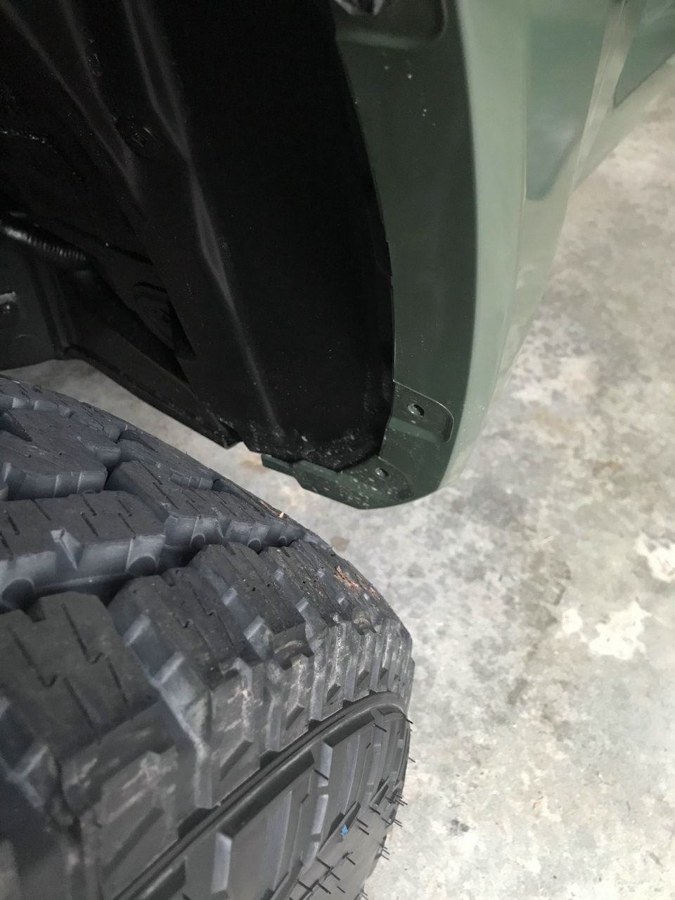

    I find that really interesting. I put a 2" OME lift on my 2021 with Dakar leaf packs & my 285's rub on the rear side of the front inner fenders when turning. They look great but I just can't have that rubbing.
    On this pic I already have the mud flap removed.

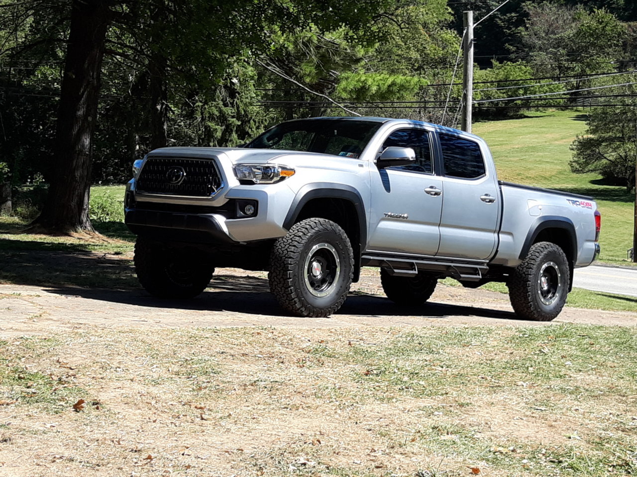

    3" front, 1" rear lift with diff drop Tuff Country, 285/75R16 K02's on TRD WHEELS WITH 10MM OFFSET- no rub

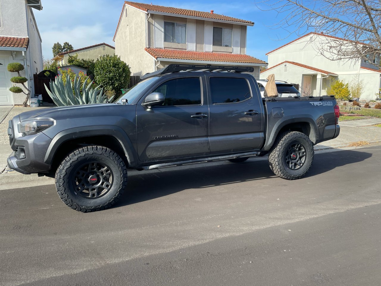

    20201217_165004.jpg I have 3" on front and 1" in rear on a 2019 off road with 285/75/16s all mud flaps on and a great ride.

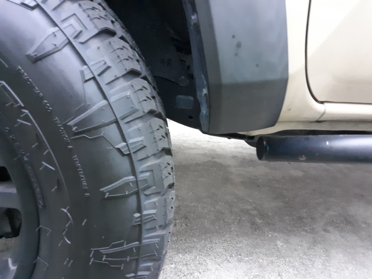

    Most of the rubbing I would get came from the suspension articulating into inclines off camber such as turning into a steep driveway or entrance from an angle, wheels at a 30 -45 degree angle from straight. I never rubbed going over anything straight ahead

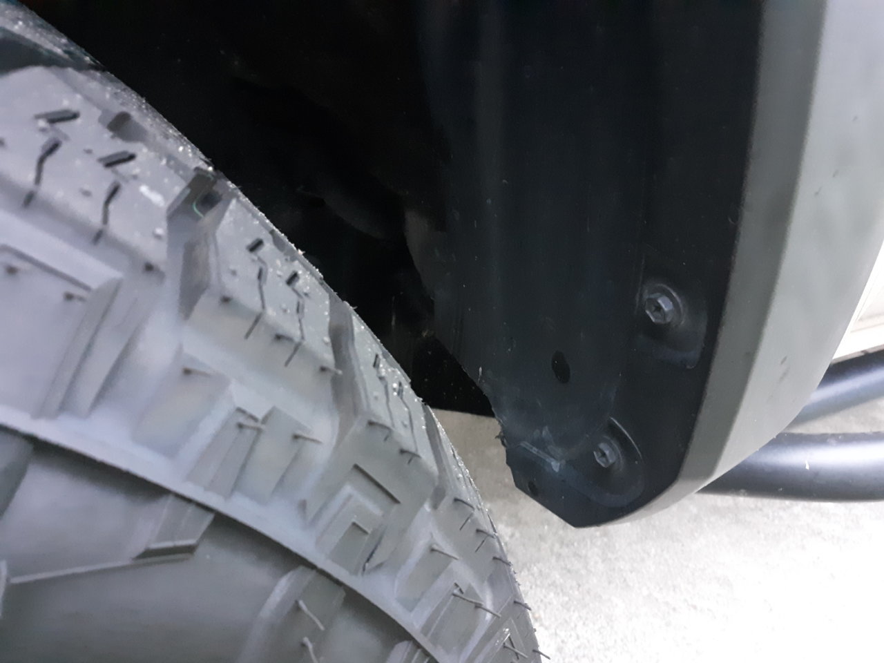

    Here's my clearance with a CMC and the tires are straight. I still need to shave a little more plastic.

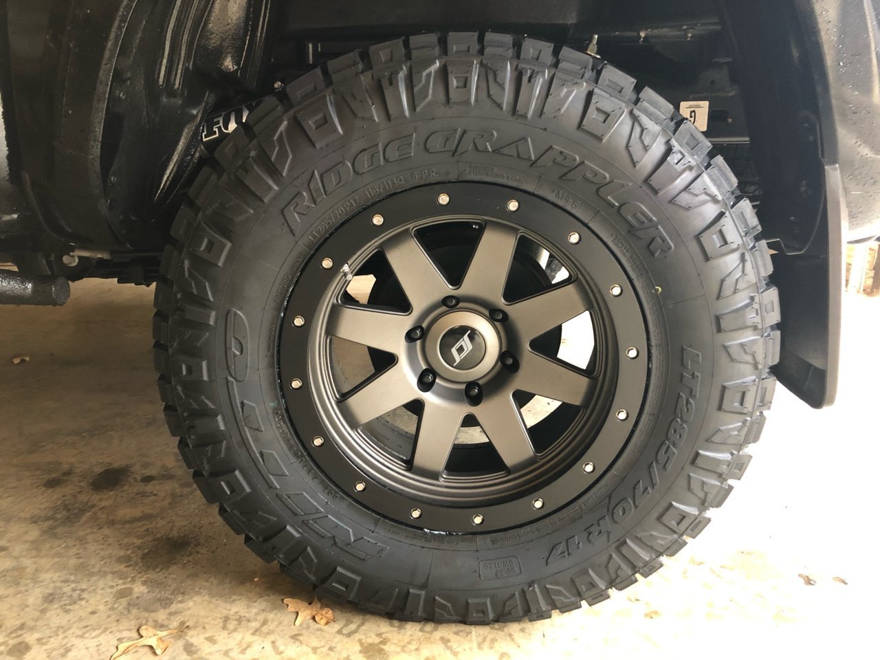

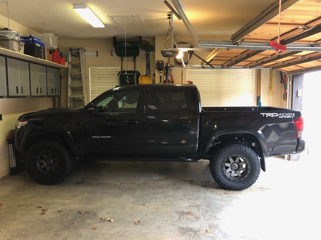

    285/70/17 Ridge Grapplers on SCS SR8 17x8.5 -10. Fox 2.5 set at ~1" lift, stock UCAs, Icon AAL. CMC and pinch welds done. Minor rubbing when turning out of my driveway; plastic trimming fixed that. Haven't tested full articulation yet, but that'll happen in a few months. Love the look and the stance. Not the best lighting in this pic. I'll try to remember to take some better pics and repost.

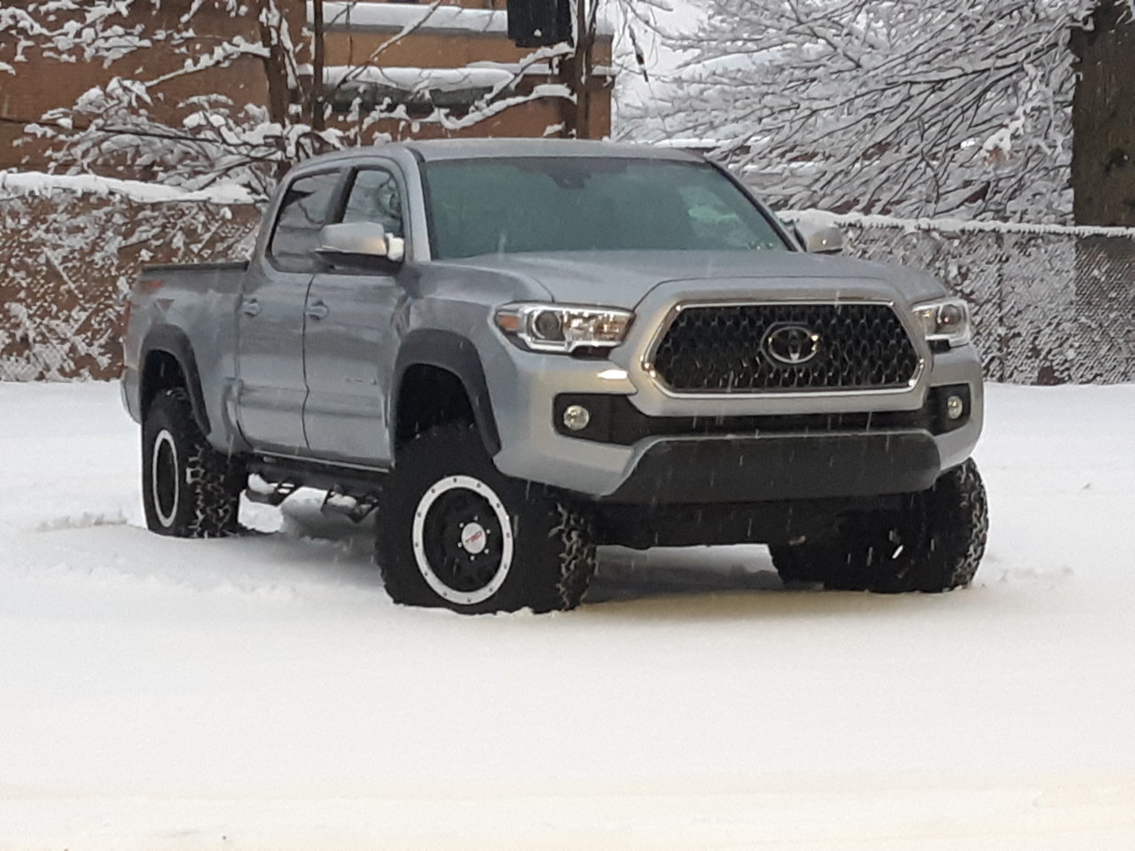

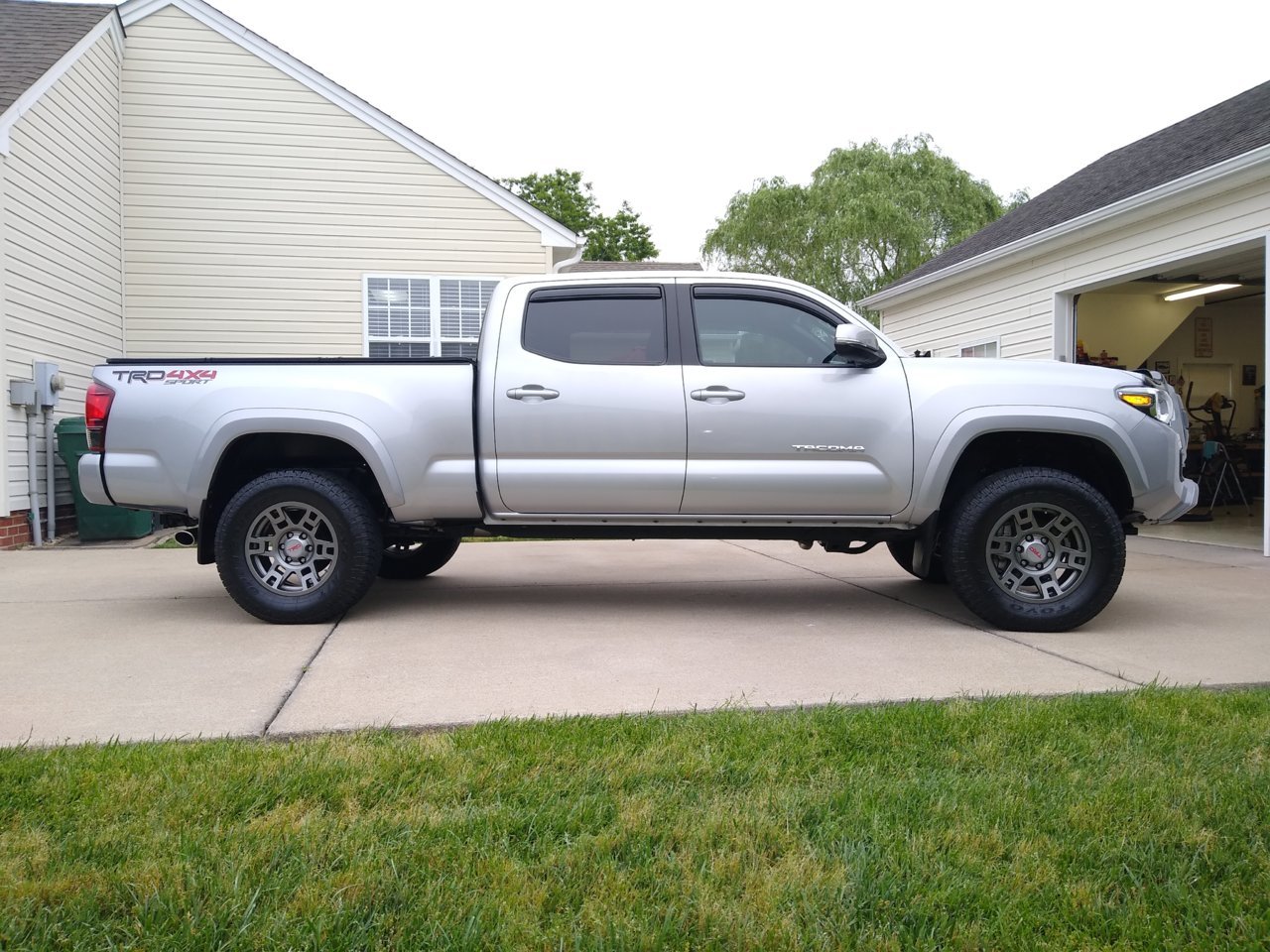

    Ifnibdo 285/70/17 on my 4runner wheels I have to keep my oem mud guards. I'm sitting on 265/70/17s and there seems like a lot of room, were only talking about an inch wider and taller. I seriously don't think I will need a cmc done, thinking about toyo open country at3s sl rated this time in around.IMG_20200524_092207736.jpg

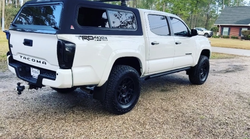

    Tail lights, contrast topper, lift, tires, automatic side steps
