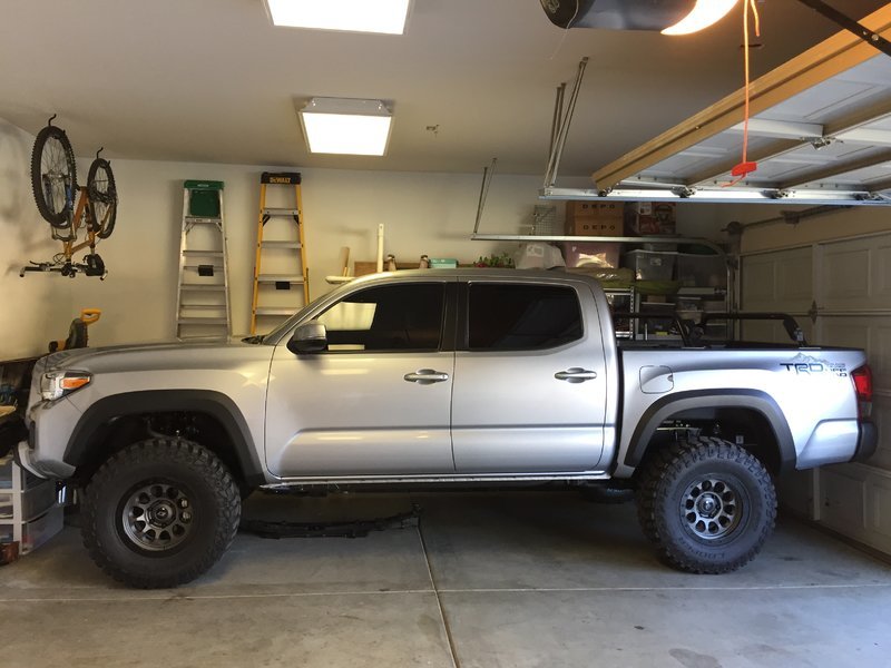

    IMG_20201212_104555_245.jpgOn stock suspension. CMC a must with this setup.

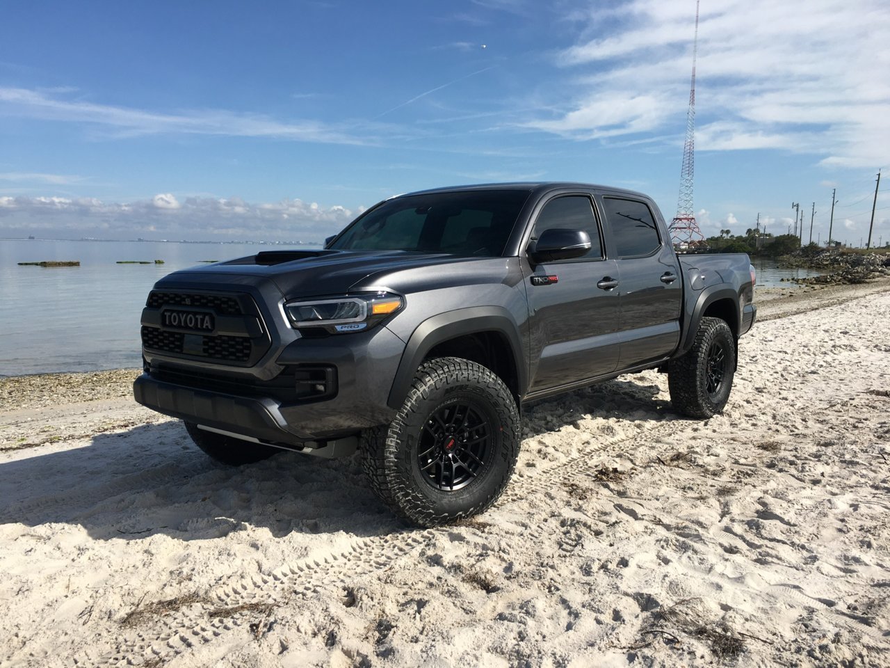

    Nice truck!!

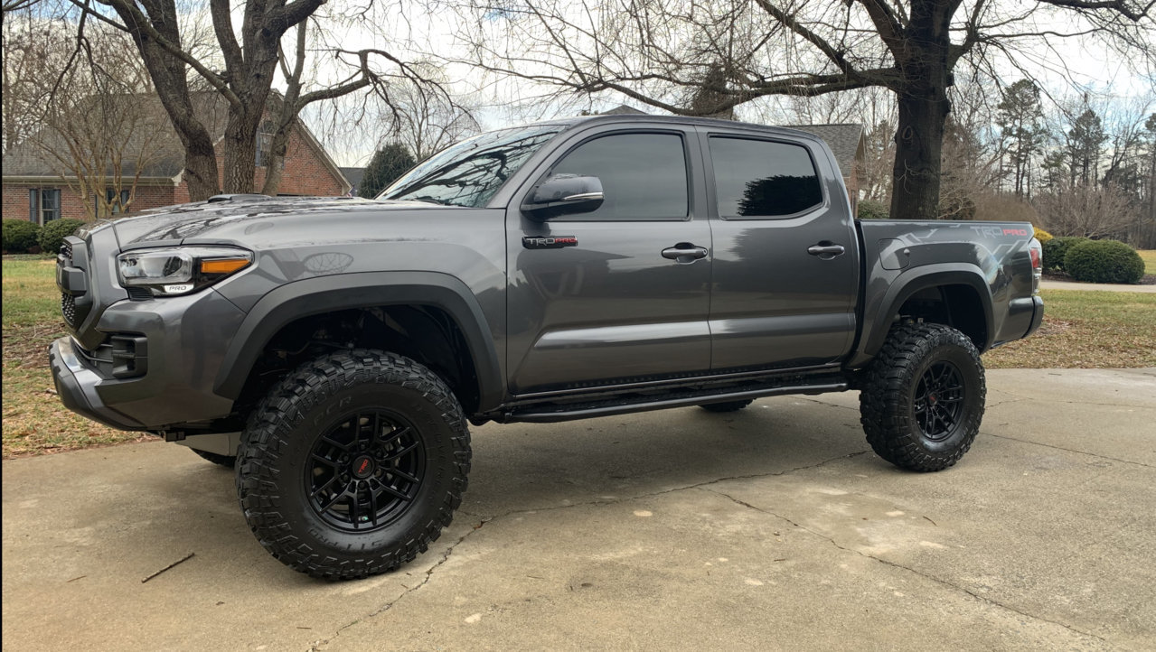

    I have the OME BP-51 suspension kit at 2.75 lift and 1 1/4 spacers and I only rub in reverse with wheels at full lock left. Don’t rub at any other time.

    I know it's been a while but are those RRW Wheels. I'm considering these hard
  12. Feb 1, 2021 at 6:57 AM
    #2232
    Tacosrus
    Tacosrus Carpe Diem
    Apr 19, 2018
    #251056
    1,662
    Northern California
    2018 Blazing Blue Pearl SR5 DCSB
    Or are they SCS Ray 10s. Offset ?

    Those are Ray 10’s and they are a -12 offset.

    Thank you! Yours as well!!

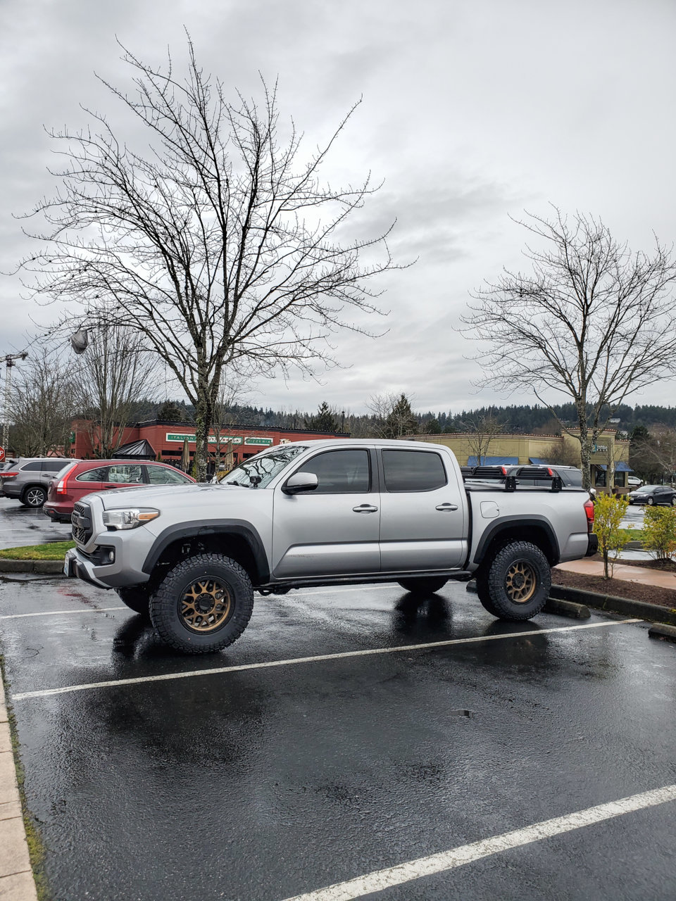

    Cough cough *33x10.5x17* cough. Tires measure at 32.8x10.6, 17x8.5 0 offset wheels, lifted ~1.75-2" in the front, 1" in the rear, 3.5 degrees of castor with Spc uppers. Zero rub dailying so far, going to body mount chop it tomorrow and flex it out on the forklift to see what rubs.

    Only ones I can find are E rated. Nice tire size and great looking truck.

    Yeah how are those Kenda’s? Really close to pulling to trigger on a set.

    Yeah they are a pretty heavy tire, wish this size came in like a C load. But at the same time I plan on wheeling it pretty often, so the thicker sidewall is nice in that way.
    I've had them for a week just road driving, and road wise they are great. Pretty quiet, and handle predictably in the rain which is key here in Washington haha. Taking then up in the snow tomorrow, so I'll post how they do!
