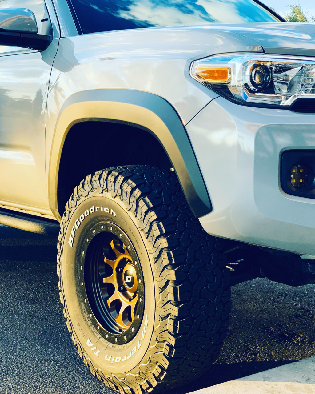

    Just got theses 285/75/R16 BFG KO installed today. Some slight rubbing on the front mud flaps, need to take them off and confirm 8953DD2E-26B3-41CE-851F-3CDFFFCD002B.jpg

    I took off an air dam once
    stock height? truck looks great!:cheers:

    Thanks. I've got an ICON stage 3 lift on there. It's coming together, but it needs a good waxing once the weather warms up a bit. Lots of pinstriping on my paint but no avoiding that if you offroad around here.

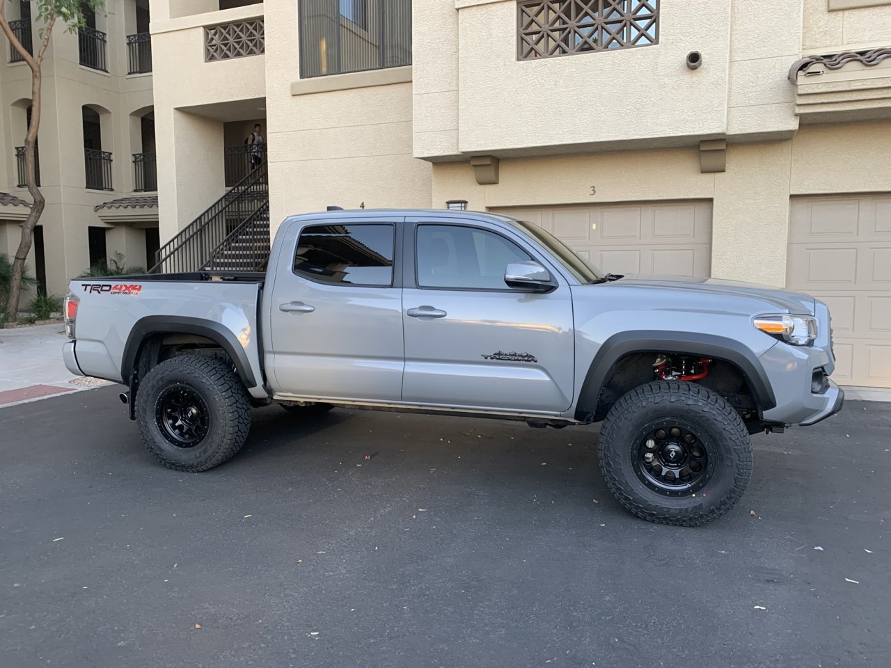

    285/75r16
    Bilstein 6112/5160 5/6 clip
    Add a leaf
    JBA UCA
    Got a CMC done and have absolutely no rubbing at all

    How many inch lift? Looks dope!

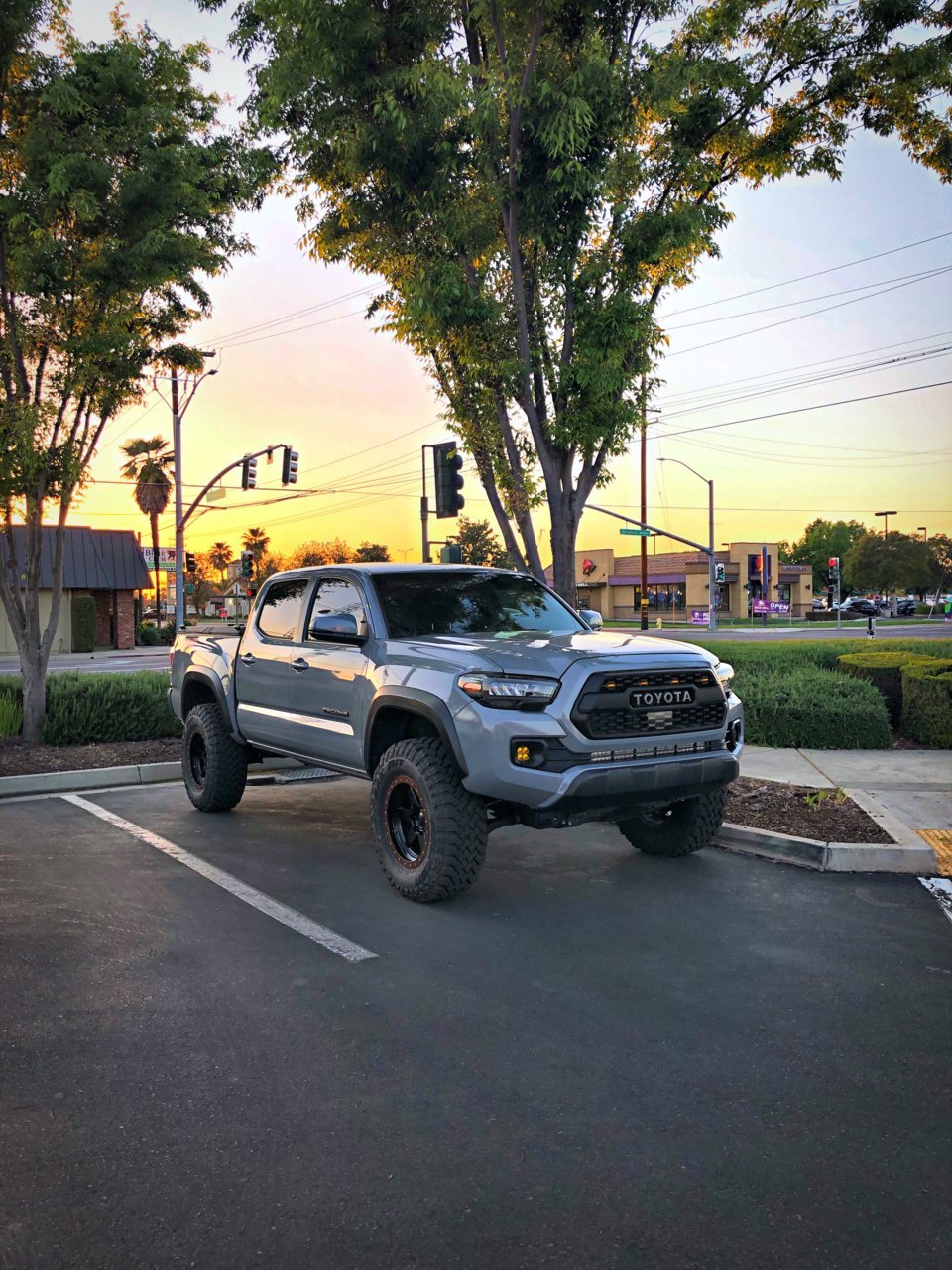

    Falken Wildpeak 285/70/17
    SCS BR6 -10 offset

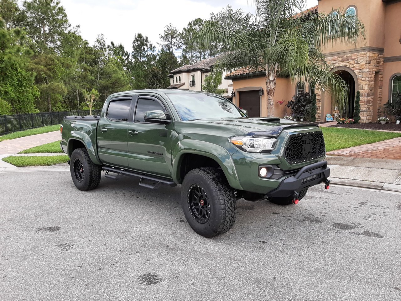

    Strange, your 285's look way bigger than mine. Gorgeous truck! I just installed some wider fender flares to give me more coverage.

    17x8.5 -10 offset on a 3inch lift?

    What do you measure ground to fender and hub to fender?

    Angle, aggressive tread/depth, wheel offset, and stock flares make them look bigger. Big guy, little shirt theory. Looks like you need 35s :sawzall:

    Brah! This is perfect. How many inch lift?

    It’s all MySpace angles! But it’s probably like he said ⬆️ the stock fender flares, and because they are M/T.
    yessir! Well it’s more a little over 2 on the front, not necessarily a 3inch.

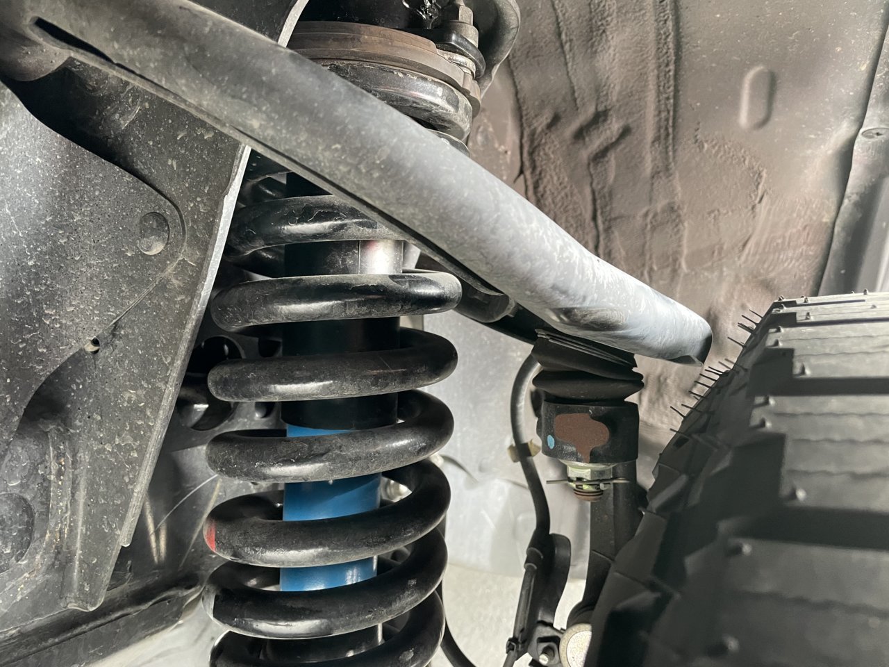

    Hey people I recently got some 285/65/18x9s with a positive 18 offset. And I rub on the UCAs. What was my mistake going with a positive offset? Would a spacer help me out or cause rubbing elsewhere. Here’s a picture with the wheel straight A866396C-586F-4C4F-8CC8-9533D9DEAFD7.jpg

    If you can stay close to 0 for an offset that will minimize other issues, a 1/2 inch spacer would do it.
