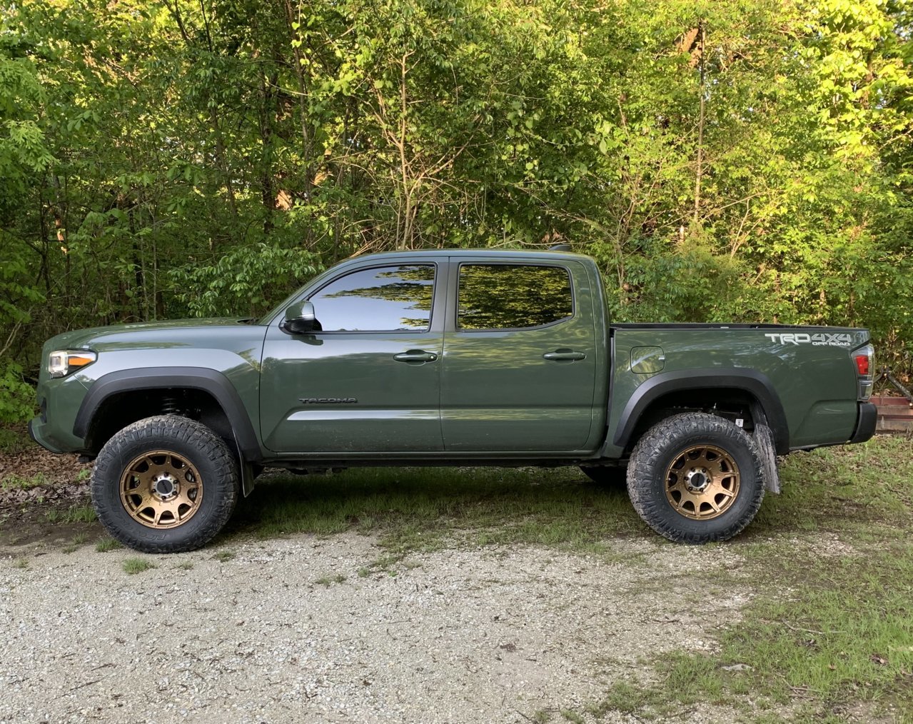

    16
    S.W. MO
    2021 Army Green TRD OR DCSB
    Nitto Ridge Grapplers
    Mastiffsrule, JDSmith and VR812 like this.

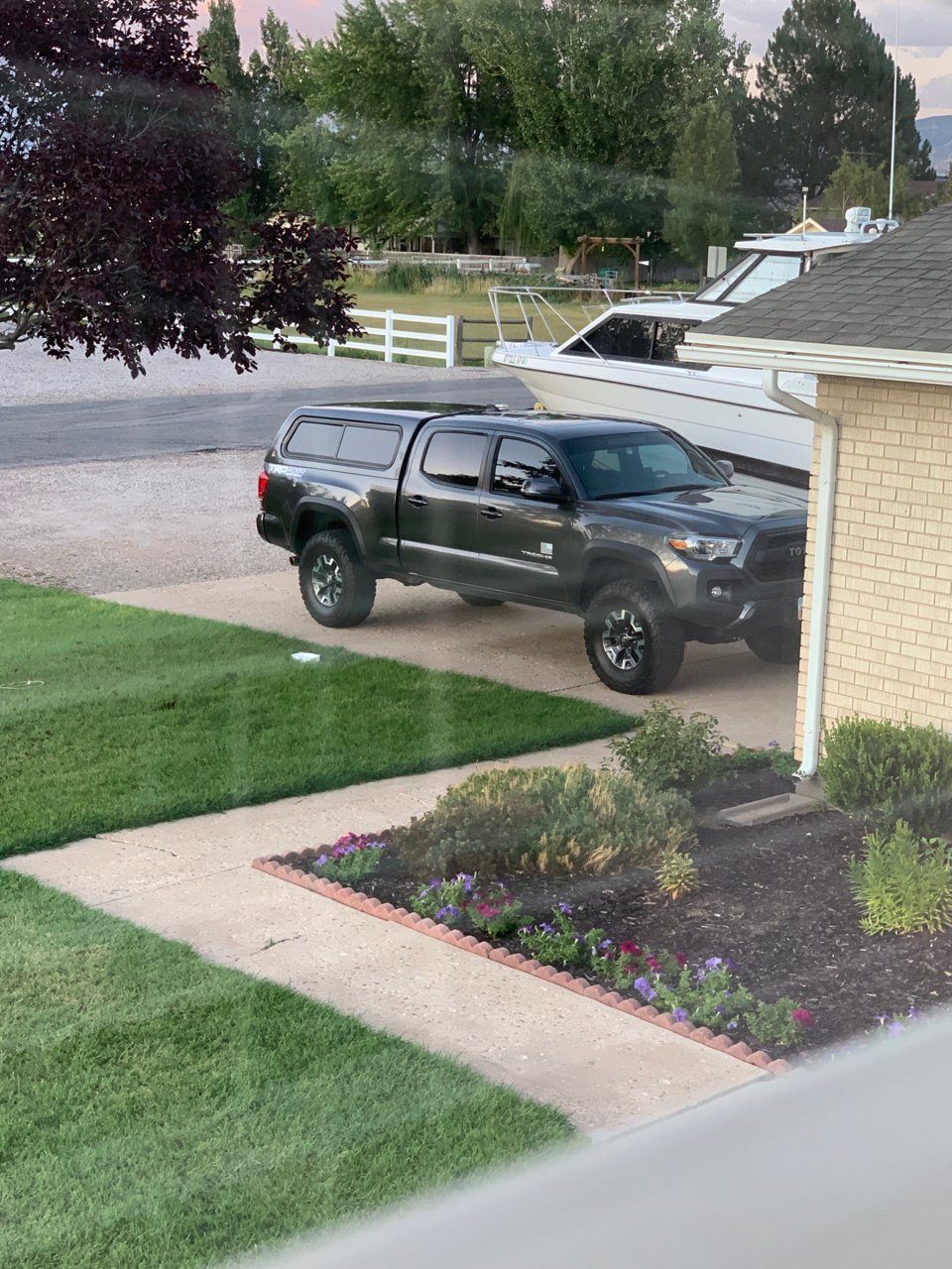

    285/70 KO2's on the factory wheels.IMG_0174.jpg IMG_1259.jpg
    Then 275/70/18's on KO2's as well. I definitely rub with this setup. Some caster adjustment should solve majority of it I believe.

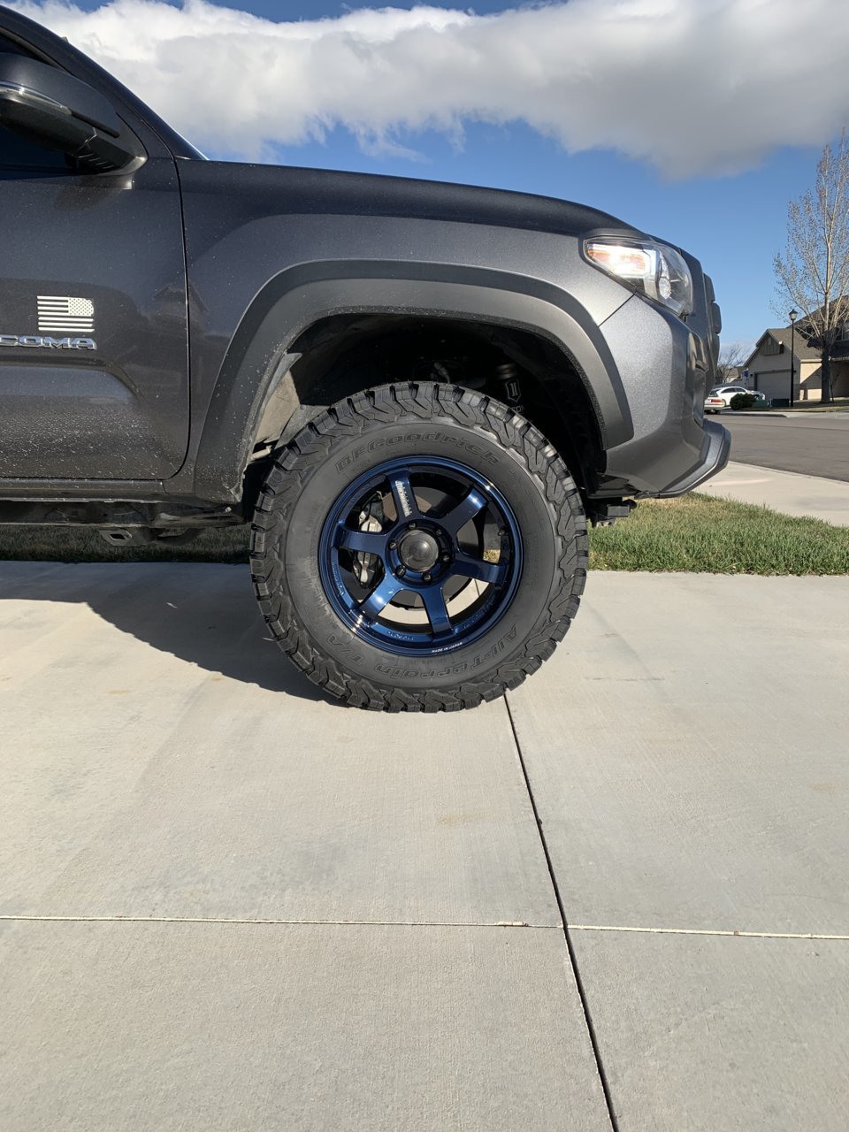

    What wheels are these? Nice rig btw

    Thanks. They are Vision 85 Soft 8's in the 17x9 -12 variant. I wanted the 17x8 -12 but was told it conflicted with the caliper.

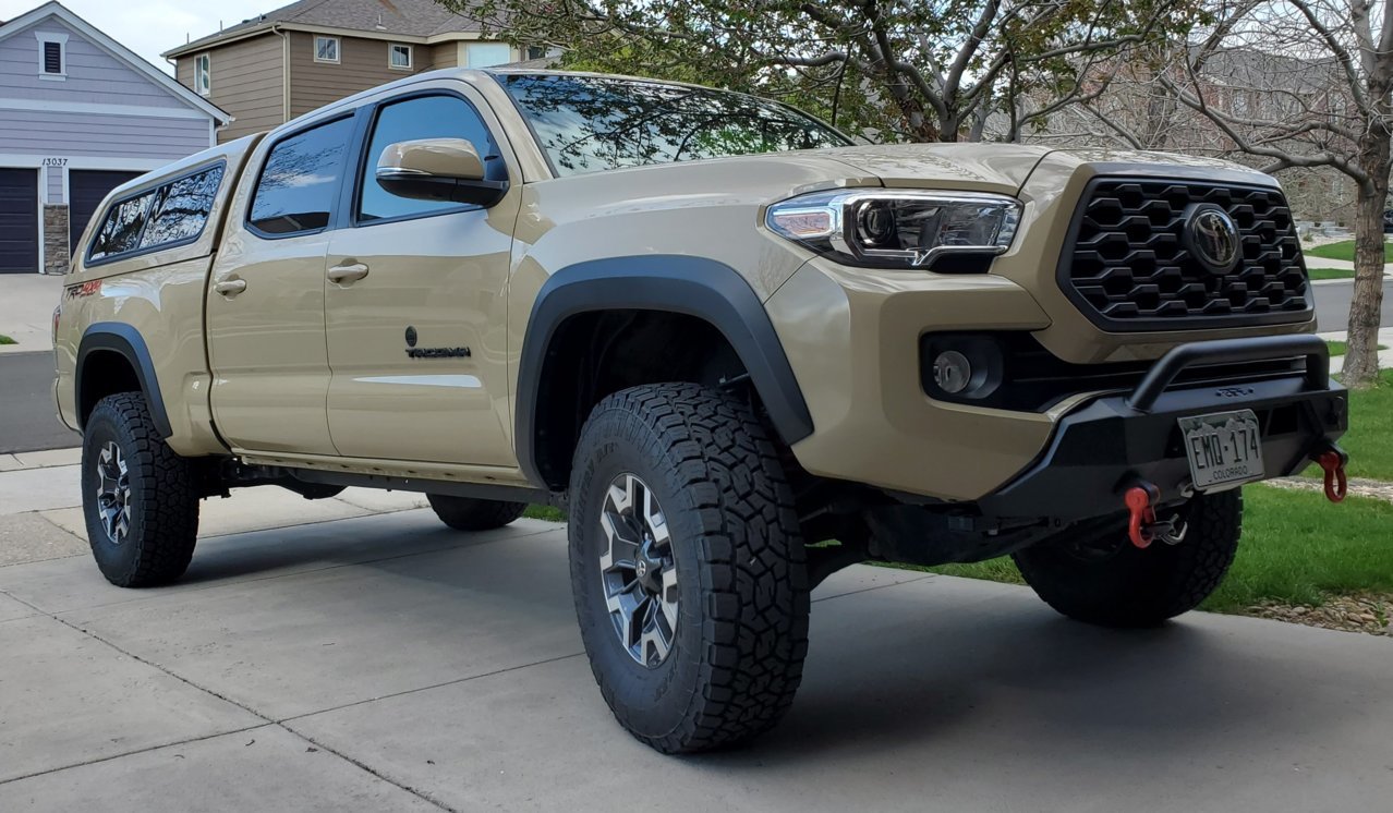

    '20 Taco long bed added 285/75/16 Toyo AT3's on OEM wheels just this week!
    With winch bumper and camper shell, truck dropped 1" in the rear and 1/2" in front on OEM suspension. I did these upgrades first to see where I would end up before adding a lift. After a couple of phone calls, I went to see Anthony at Toytec here in Denver. He measured my current height with the extra weight and recommended the Boss 2.0 (2.5" lift) coil-overs in front and I added the SPC upper control arms too so, no problems in the future. OME leaf packs for the rear (3.5" lift) and Toytec shocks. Spidertrax 1.25" wheel spacers allowed for the factory rims to be reused. After I got it installed with a little help, I took it to Toytec for adjustment/tuning and alignment. Truck looks great, alignment is perfect, and I'm not discerning but, the ride is definitely improved...smooth! They loaded my front suspension using their loading ramp and moved my steering through the full range of motion...NO RUBBING! This is just what I was looking for and can't wait to take it off road!

    Looks badass! So no CMC or other trimming?

    Still brand spanky new at this...what is "CMC" trimming? And, thanks for the "badass" too BTW!
