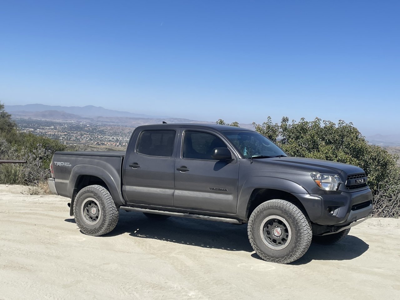

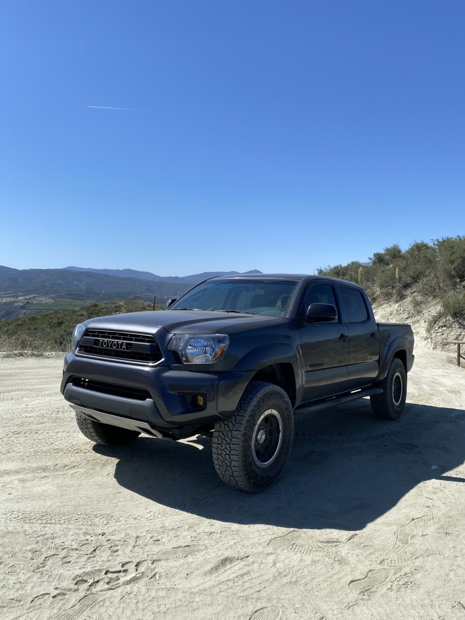

    Just have the stock 2nd gen trd pro / Baja suspension (about 1.5/2 inch lift in the front and add a leaf in the back) and a cab mount chop. No rubbing, I think part of it has to do with the 10mm offset of the trd wheels. Anyone hesitant about the 10 ply tires I would say it’s not bad at all imo.

    This looks really good on a 2nd gen. No rubbing on the inner well where the pinch welds are?

    Thanks man! I did have the pinch welds hammered down and cut some of the inner fender well plastic.

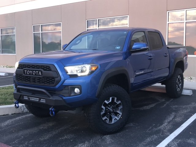

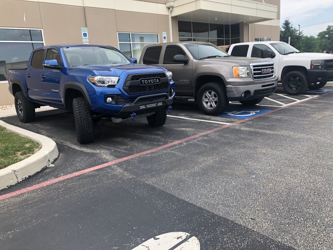

    Toytec 2.5 boss, SPC UCA, Falken Wildpeak 285/75/16

    Looks good! Wheel spacers?

    Yup, .75" Bora to clear the UC. I'm a big fan of the GALACTIC EMPIRE LOGO / O.R oem wheels :thumbsup:

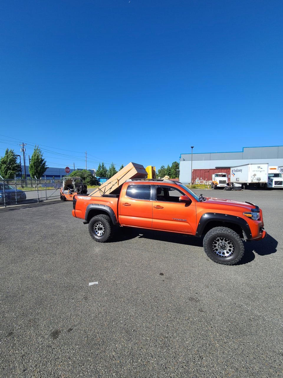

    285/75/16 method nv 305 4.5" backspacing 0 offset . My tires are bfg km3's E rated 10ply

    Did you have to do any trimming? And do you like a +1 offset rim would be okay in place of a wheel spacer? I just got my Tacoma and it has a rough country 3in lift and I'm trying to figure out if I can run 285's

    No trimming so far, I've tested with forward/reverse and incline/decline with steering lock. At the extreme I have 3/4" on both driver and passanger side wheels against the wheel well. Not really sure about the +1 offset,check out this post for the measurment
