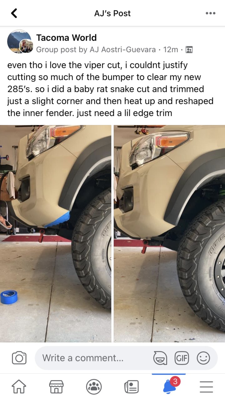

    i got 285’s BFGs on SCS sr8 -10 wheels on Ironman 4x4 lift but i have it 2” front 2.5” rear. stock UCA. i had to do a CMC with some extra lower fender cutting. and a bit of front bumber cutting.

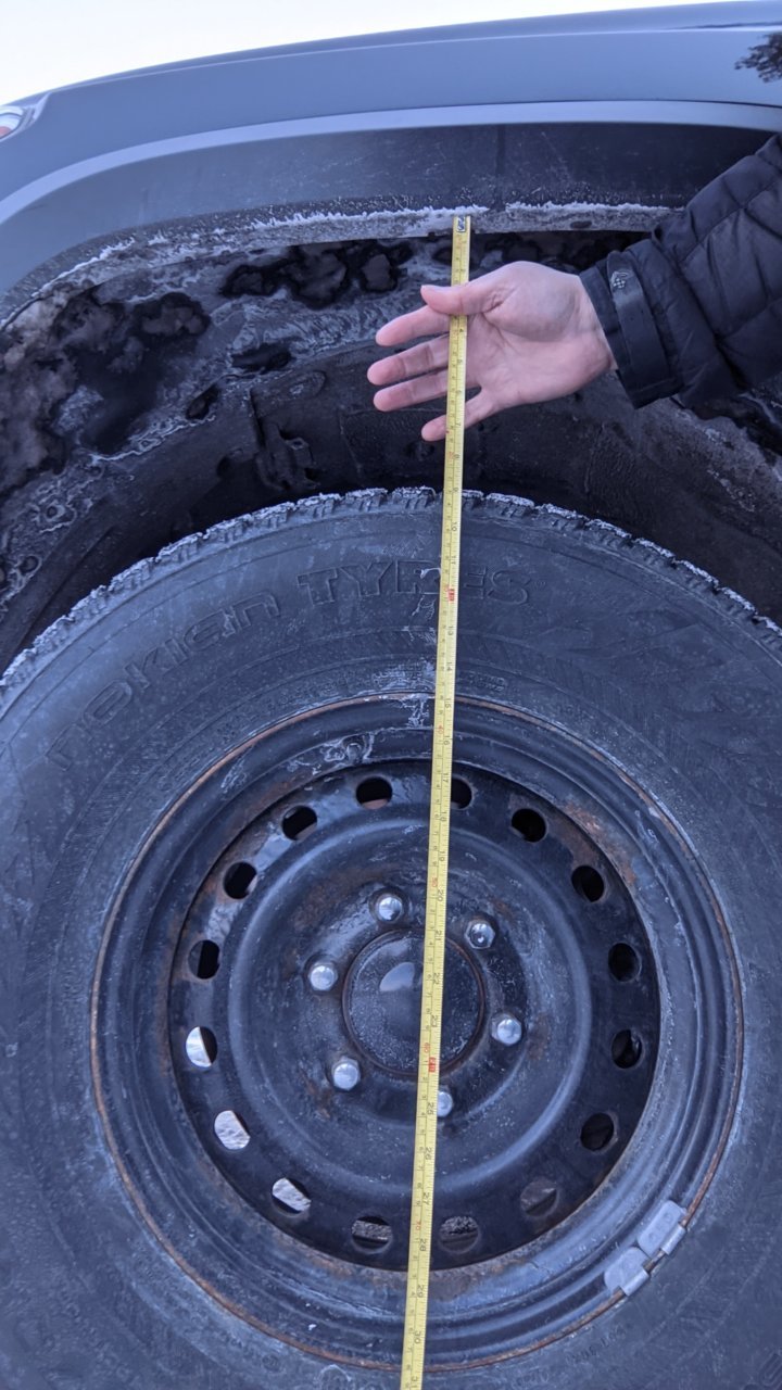

    Bought the truck used and the details of the lift are not available, but I snapped this shot and measured about 23 inches from hub to fender.
    Those are my old winter tires in the picture 265/70/16.
    I had to remove the mud flaps to get rid of the rubbing when I put the WildPeaks on.
    Maybe this crowd can tell me more...

    Those are the stock Bilstein 4600s looks like with a spacer lift. Maybe 2" or so

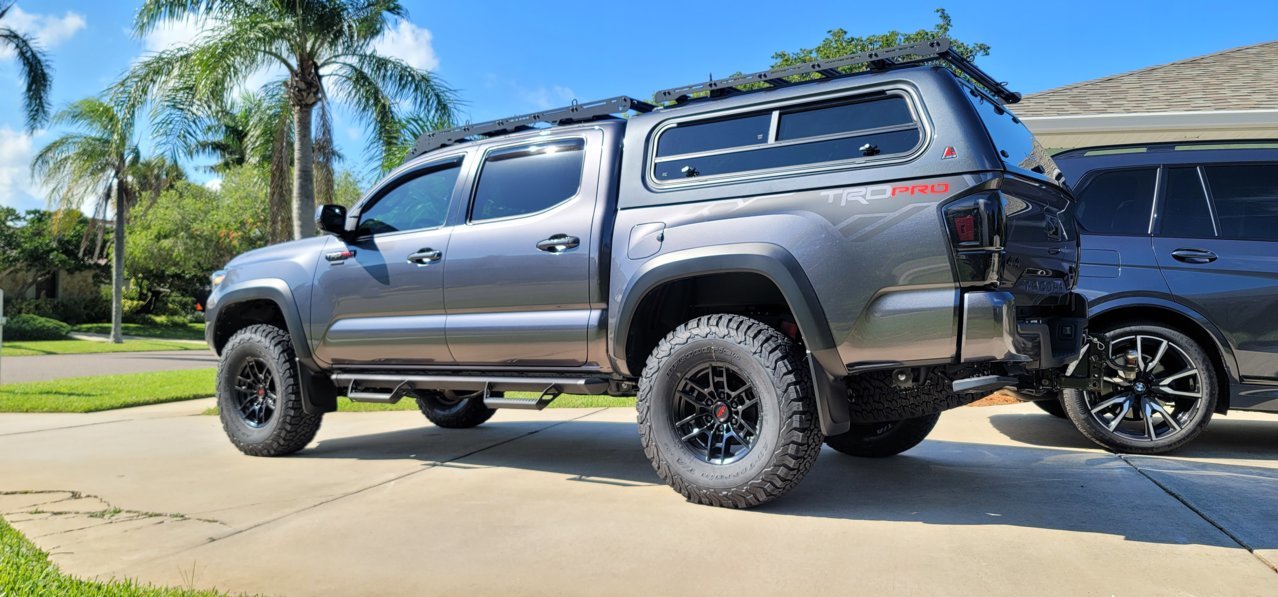

    20 Pro w/ Wescott Pro kit + 285 75 16 KO2s. No rubbing with OEM mud flaps.
    Has anyone ran a wheel spacer to give the tire a little poke past the fender? I had 265 75 16 KO2 with 1.5 inch wheel spacers at stock height. Looked killer - loved the stance. Rubbed a bit on the mud flaps, which I trimmed a bit to resolve. Hoping to run something similar.

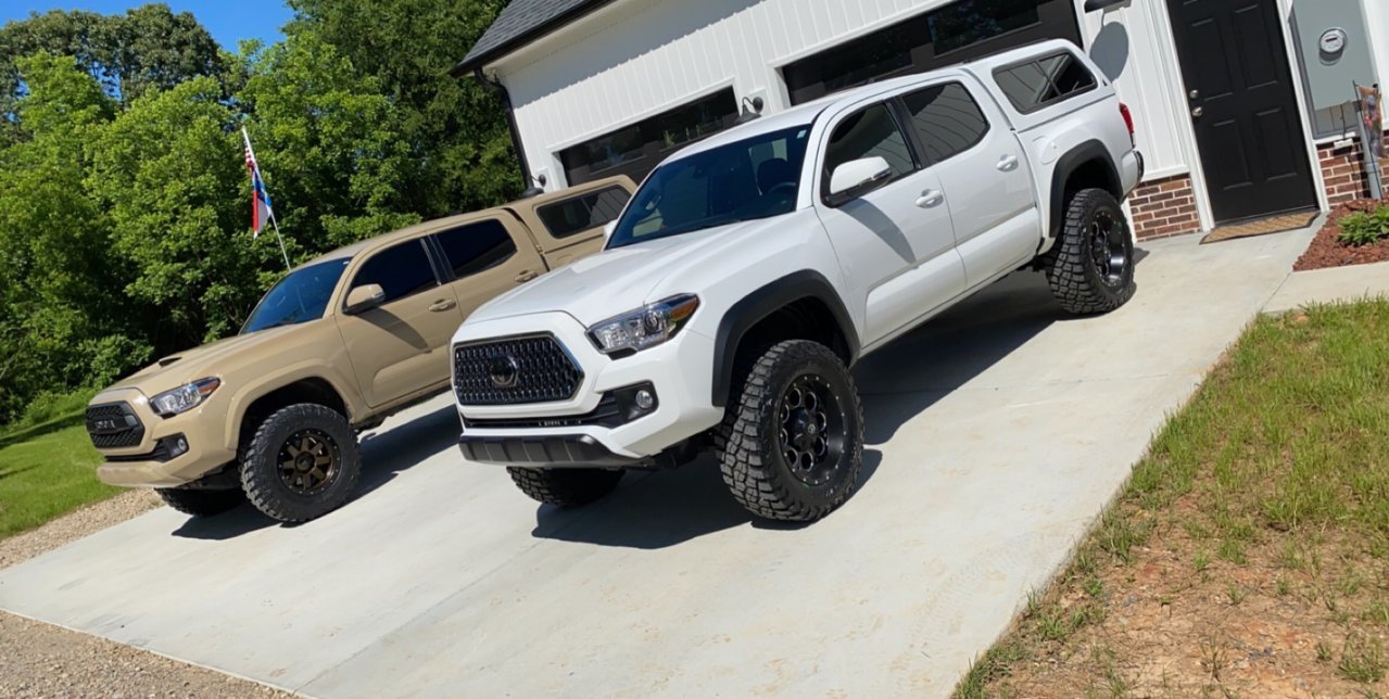

    my brother in law has the same lift, with different wheels and tires and his does not rub as bad as mine. His tires are slightly shorter which seems to help. I have attached picture of his truck.
