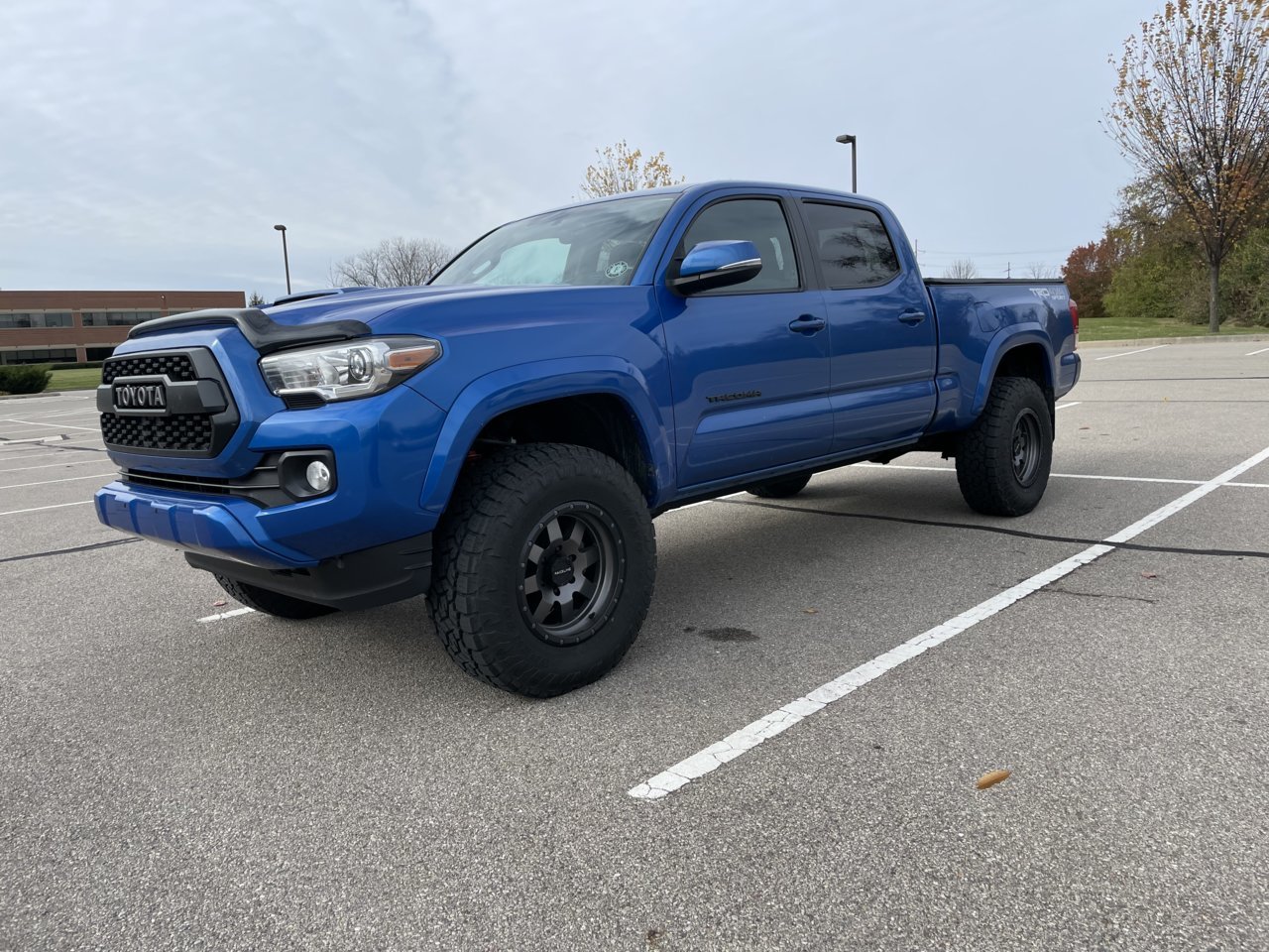

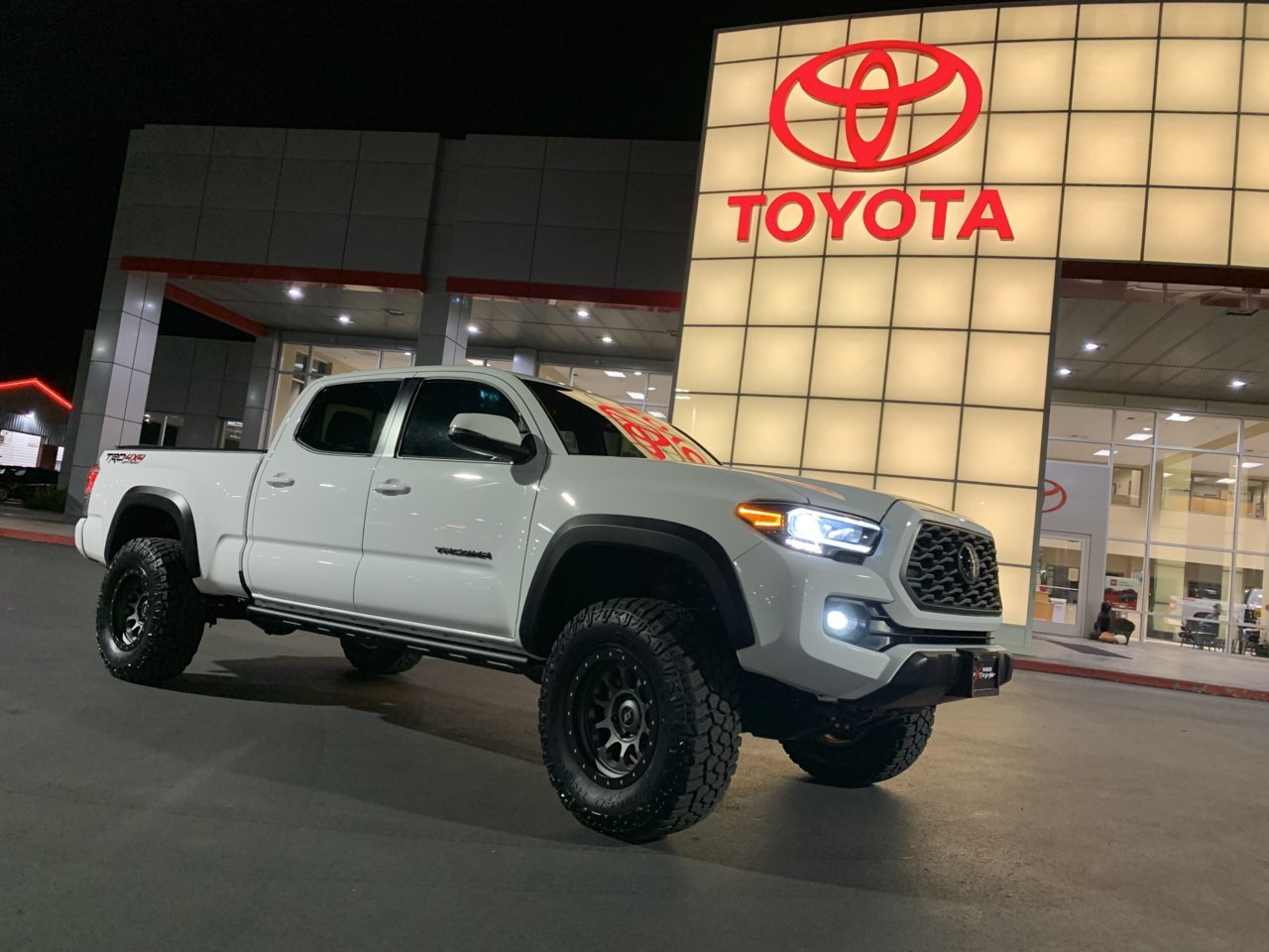

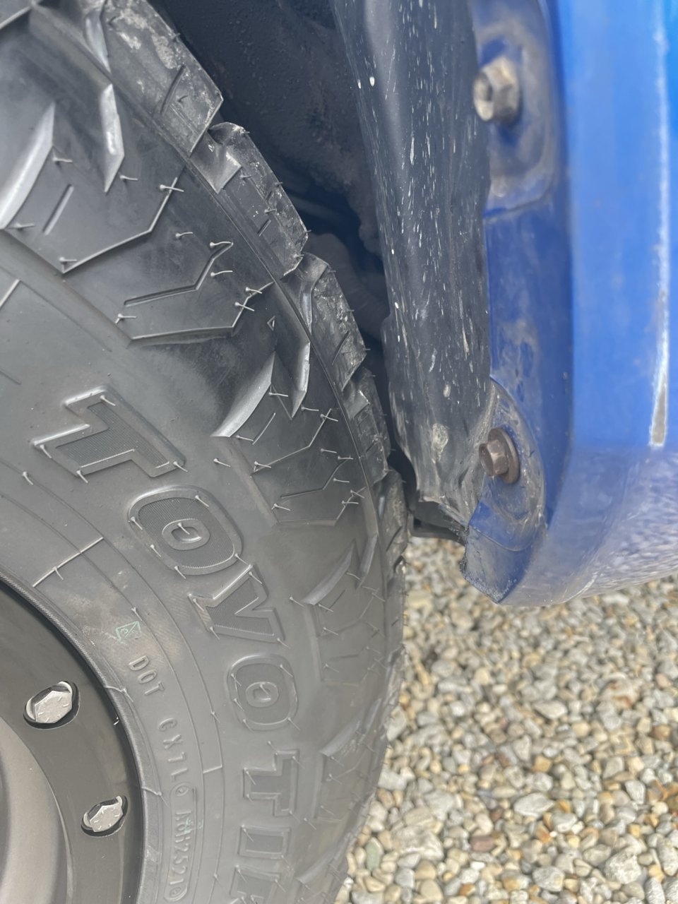

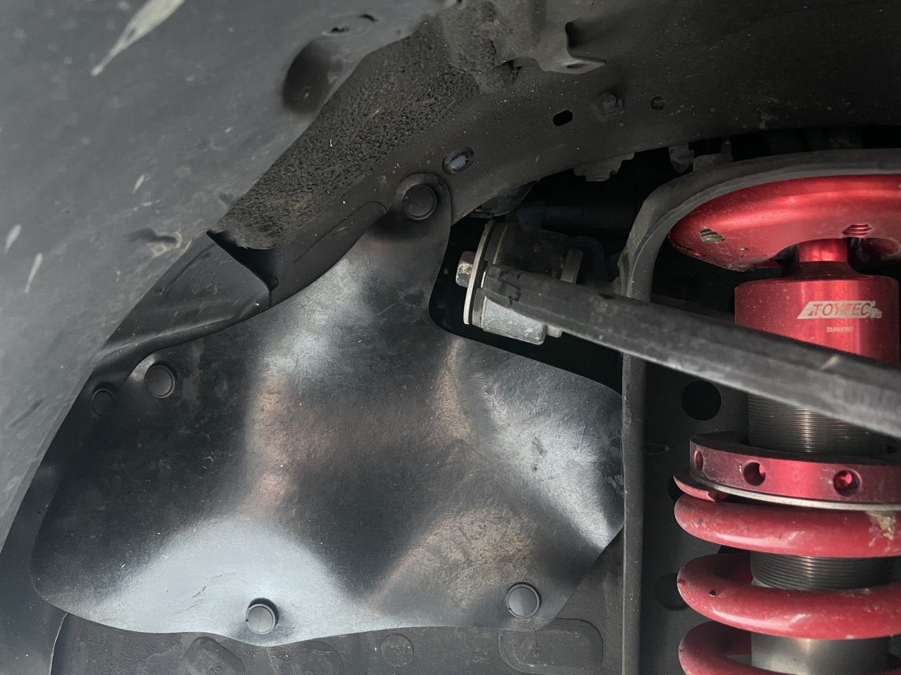

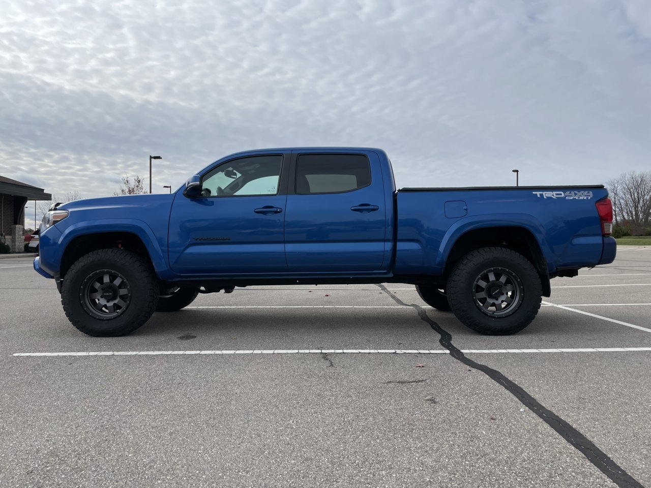

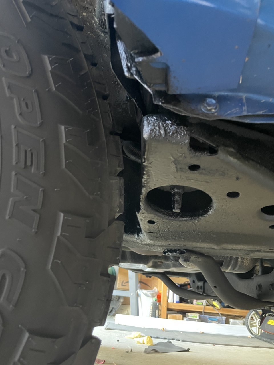

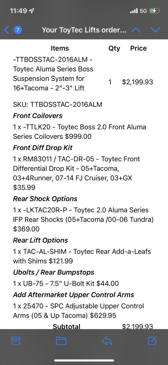

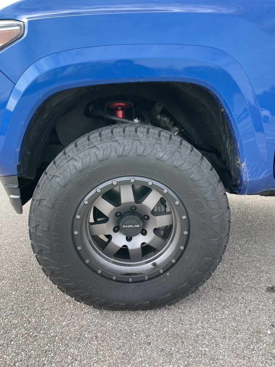

    (Also posted over in the double cab long-bed thread)
    Toytec 3” suspension lift (front and rear, with rear add-a-leaf and new UCA, see photo for the breakdown)
    Raceline 935g 17” wheels with 0 offset
    Toyo Open Country ATIII 285/70/17 (33” on paper, 32” irl)
    This setup *definitely* requires some trim work inside the front wheel well, including a CMC, which I’m having done tomorrow.
    Love how it turned out though!

    Check out the post I just made. From my understanding (somebody please correct me if I’m wrong), the more you push the wheels out, the more likely you are to rub. Stock offset for the ‘16 TRD Sport wheels is +25 for the non-TRD wheels, +4 if you have the TRD wheels. I just had 0 offset wheels installed with 285/70/17 tires and a 3” lift. Definitely rubs and requires a CMC. So I would imagine a -20 will rub even worse. The good news: CMCs are cheap. The bad news (or expensive news, rather) : you’ll still almost 100% need a lift for that to work.
    Again, somebody correct me if I’m wrong

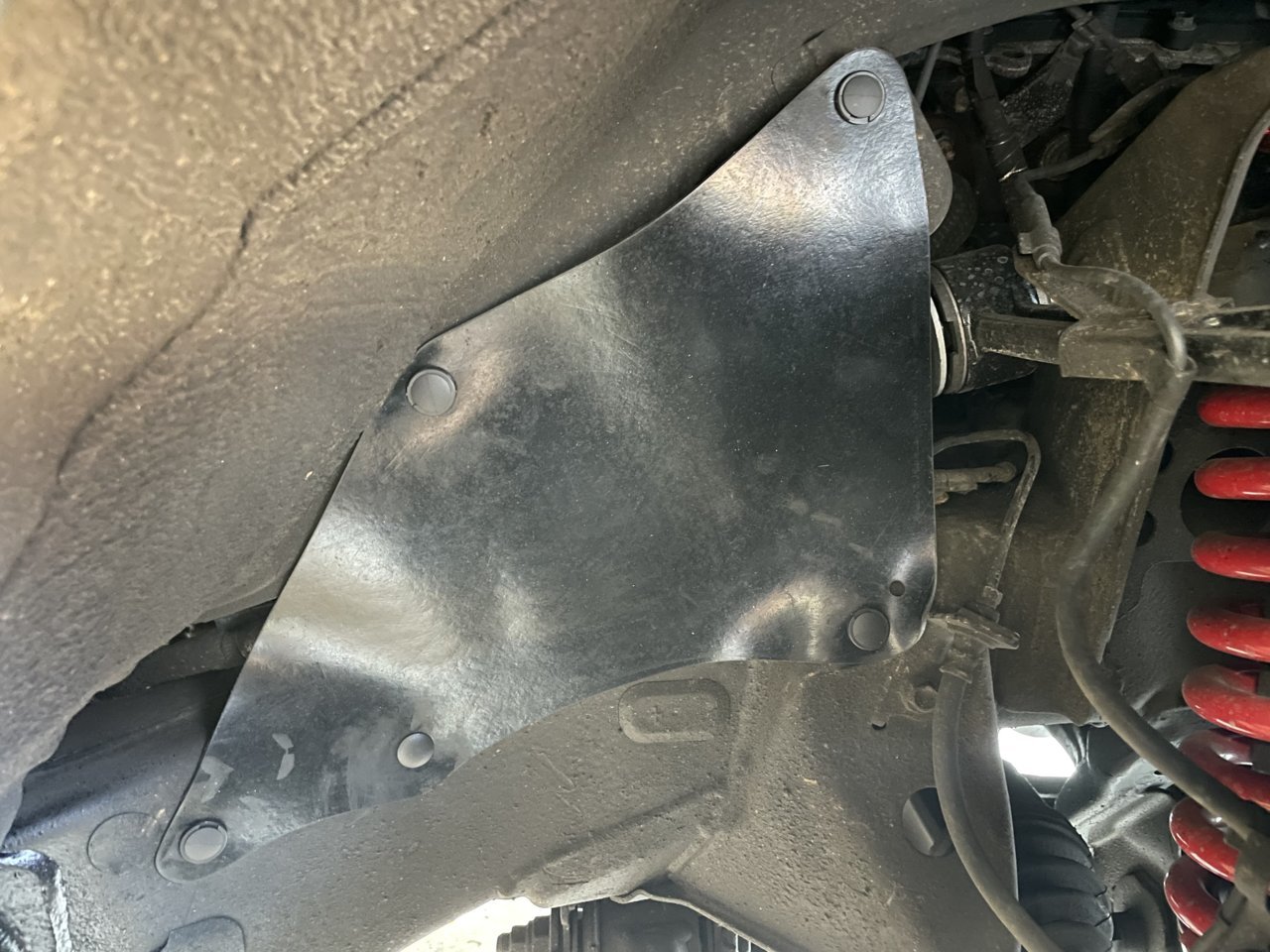

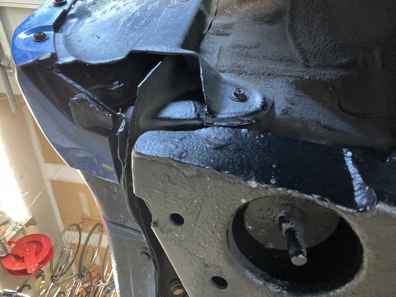

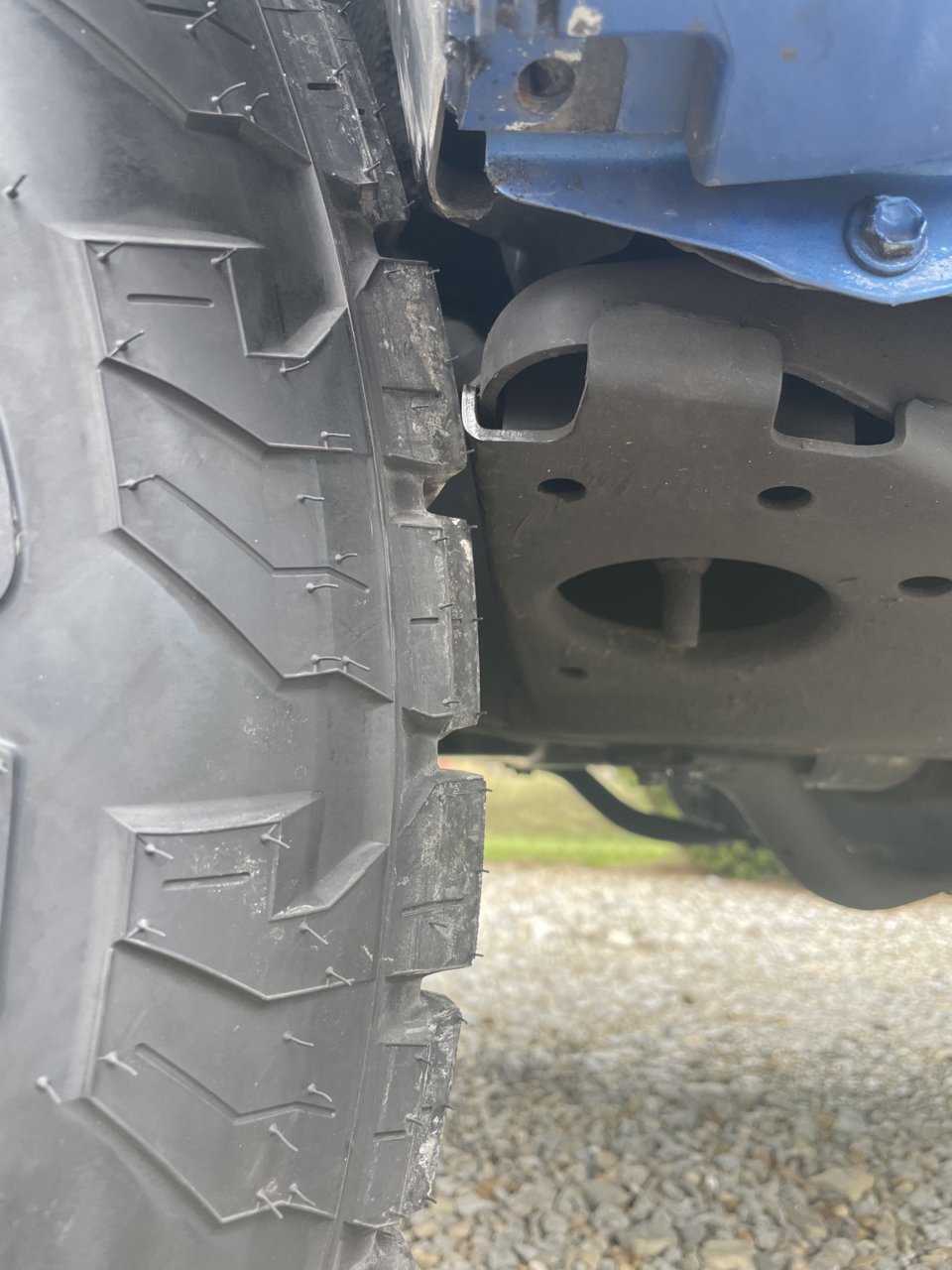

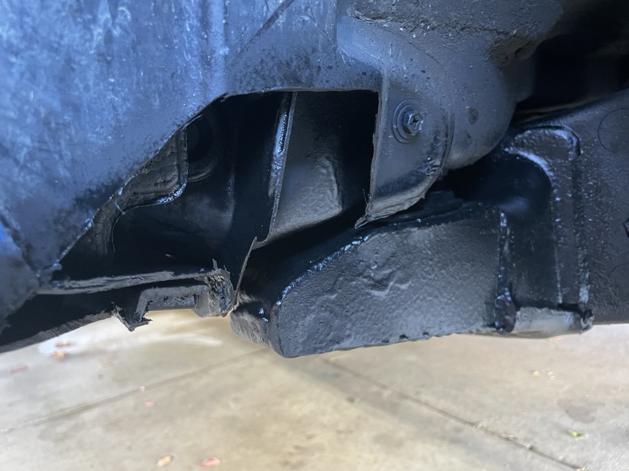

    Follow up post to the pics I posted a couple days ago… CMC complete. Absolutely no rubbing now. There’s really no reason NOT to get it done if you want bigger tires.
    I also replaced the splash guards with some Rad Rubber Design ones. Much beefier.

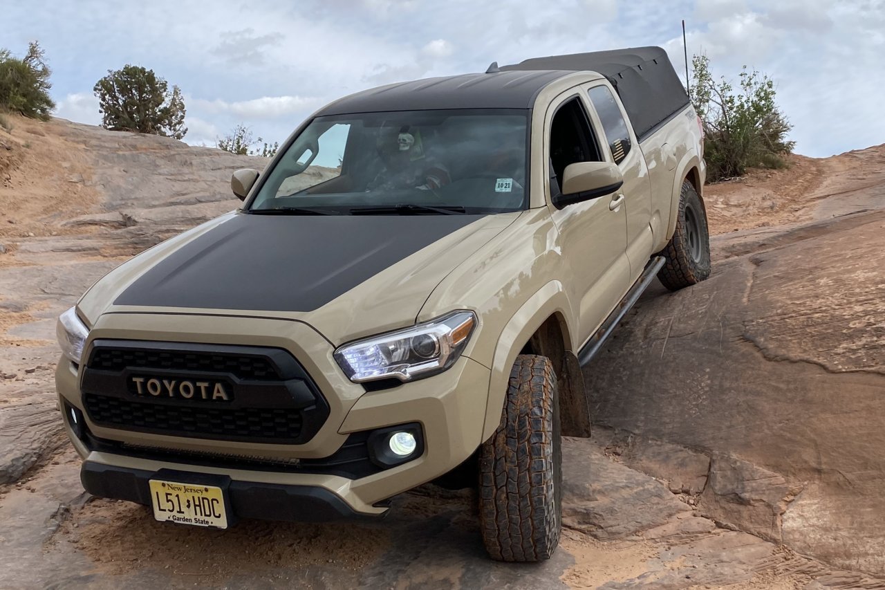

    285/75r16 Cooper AT3 XLT. Bilstein 5100s. OME-885 and 1.5” taper rear blocks…

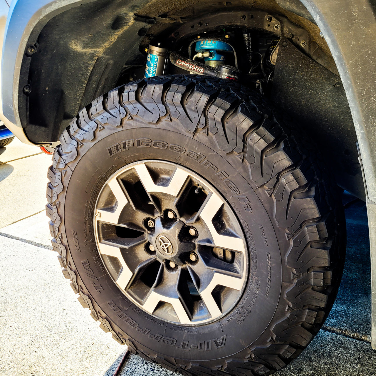

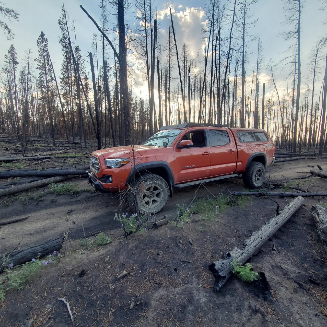

    Just installed Bilstein 6112s and SPC upper control arms on the front and Bilstein 5100s and 1.5" Icon add-a-leaf in the rear. Running 285/70R17 BFG All Terrain KO2s. No rubbing even at full lock both turning directions.

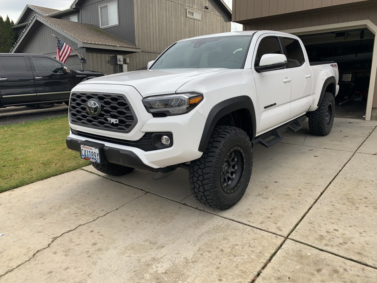

    285/70/17 Cooper Rugged Trek, SCS RAY10, 17x8.5”, -10mm offset DAE5886A-C3B4-4726-80E2-7DEF430607D3.jpg78D6620C-2AC4-4ADE-AA38-7615C734AAC8.jpg

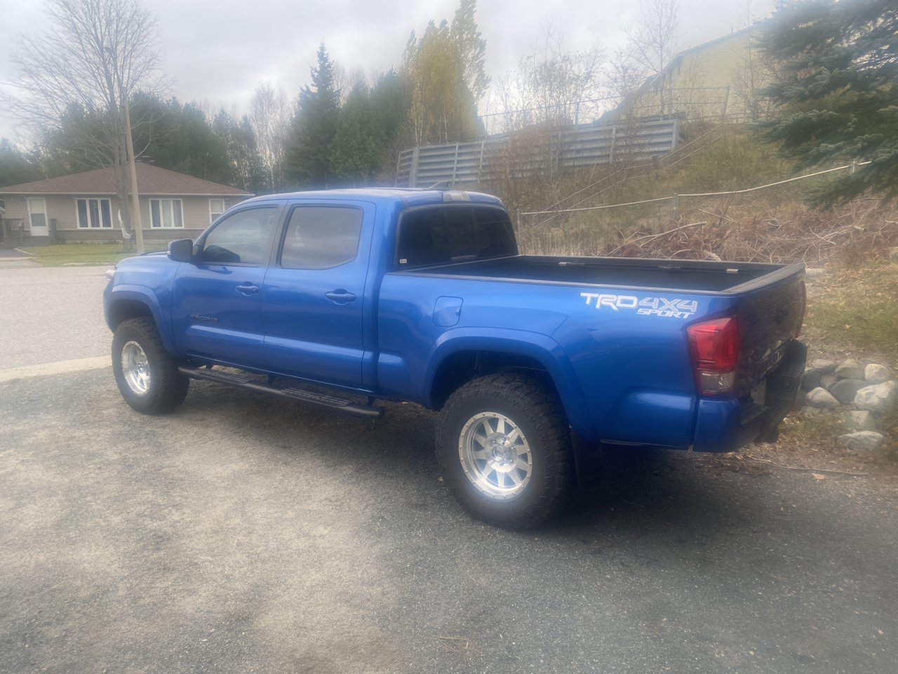

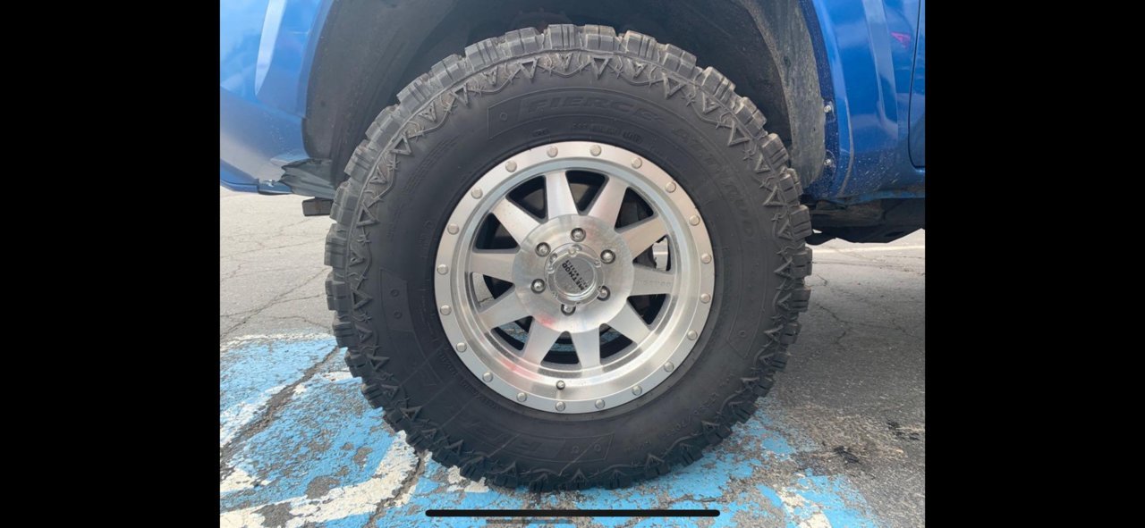

    Not much yet. Previous owner put some oversized tires and rims
    The truck actually came with this wheel and tire combo. I would have chosen a gold or bronze colour for the wheels. I may have them powder coated in the spring. I have a friend that is getting setup to do powder coating.

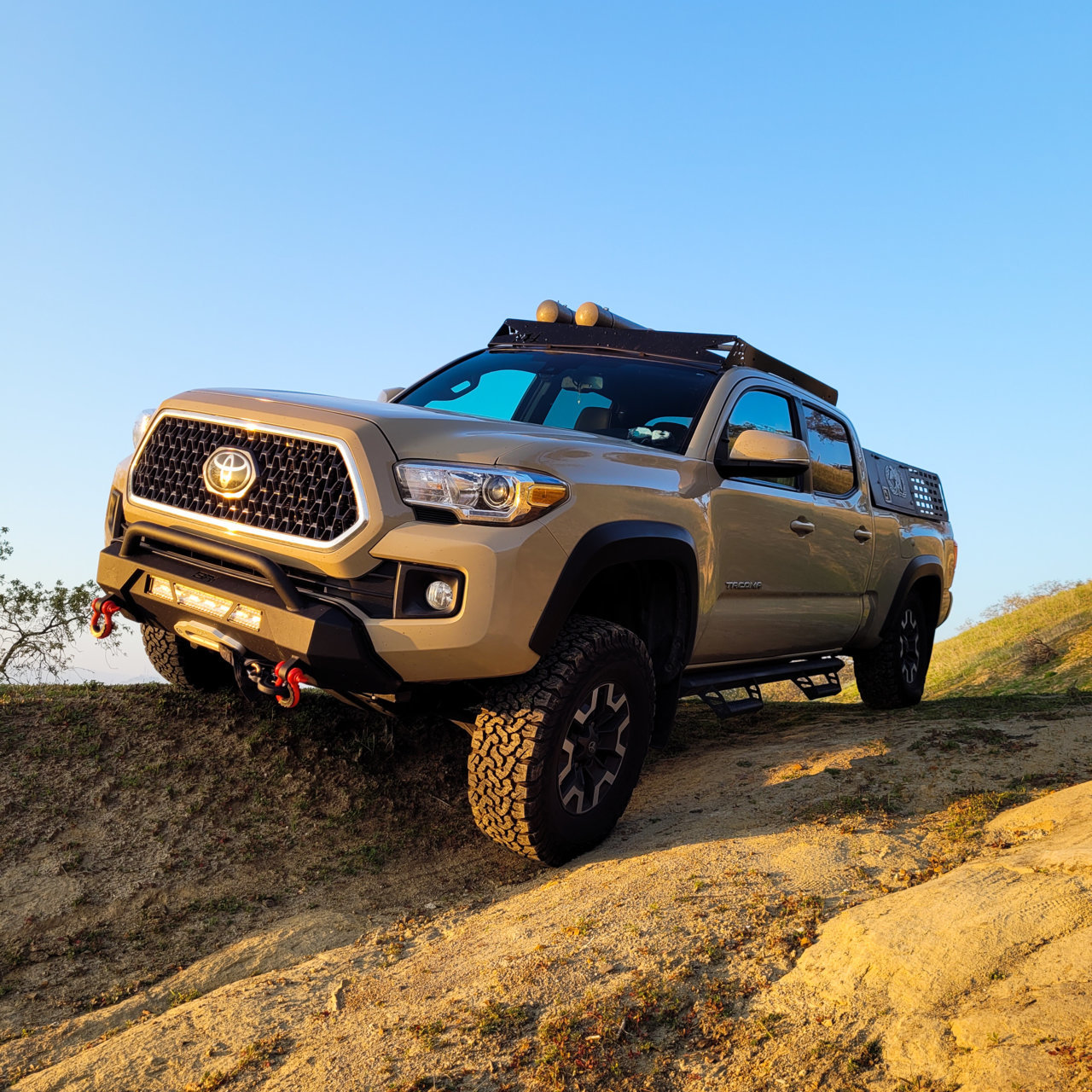

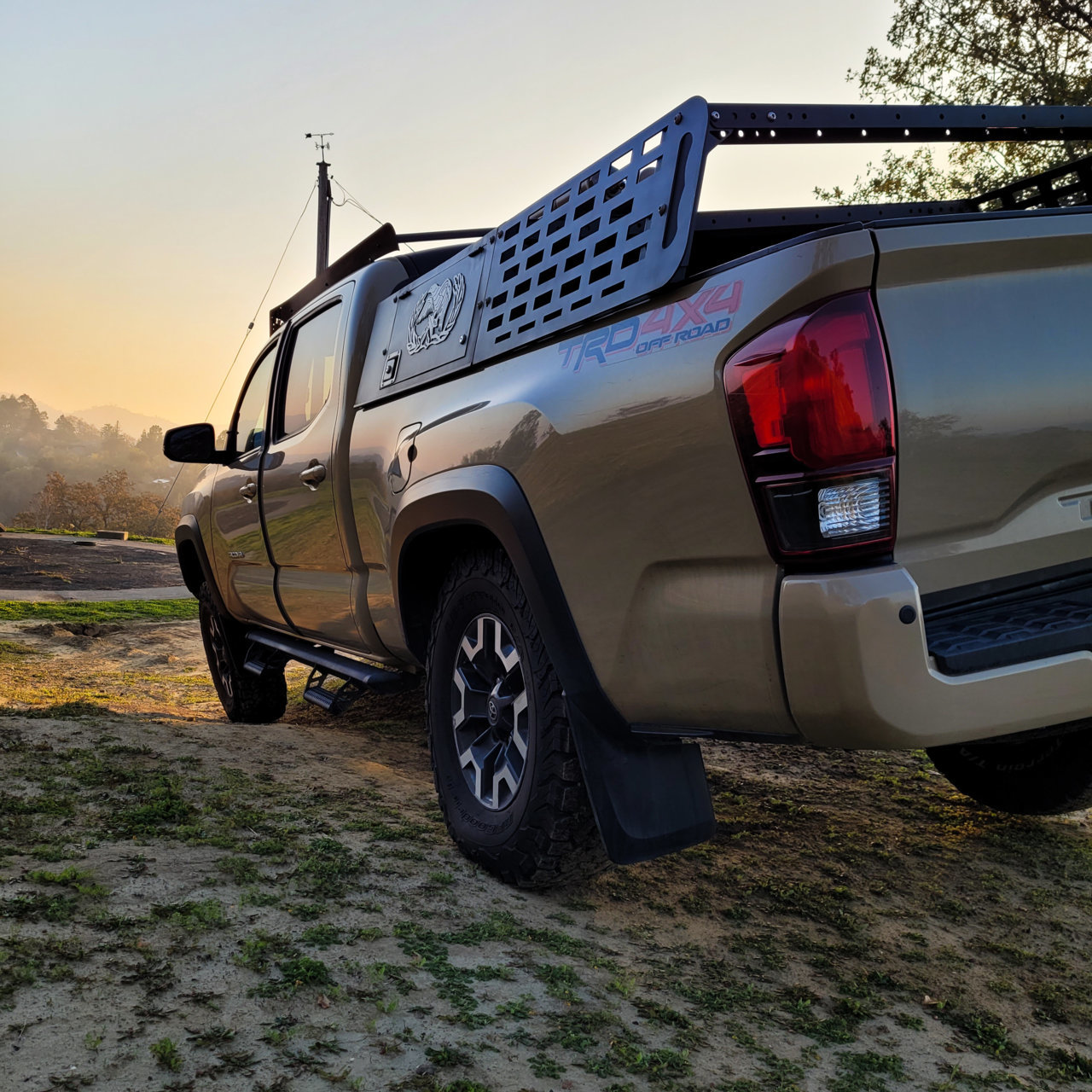

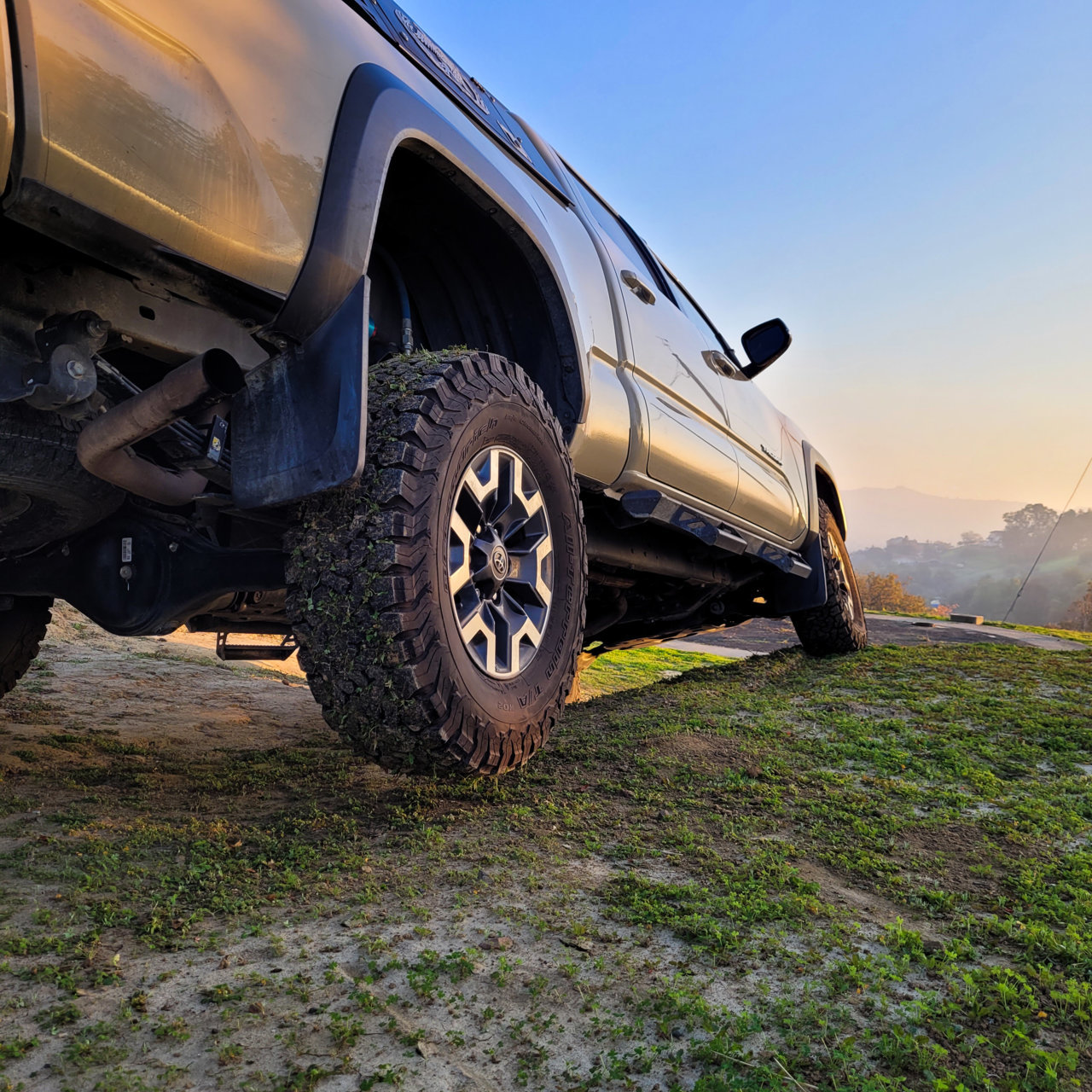

    I have a set of 285/70r17 ko2's on method wheels 0 offset we use for specific trips, mainly in the snow or less aggressive trails but I run 265/75r16 on the stock rims 90% of the time, mainly saves on fuel better freeway driving and tucks really well when on dry rocky trails at full flex, thats just my preference. Heres some pictures of the 265s
