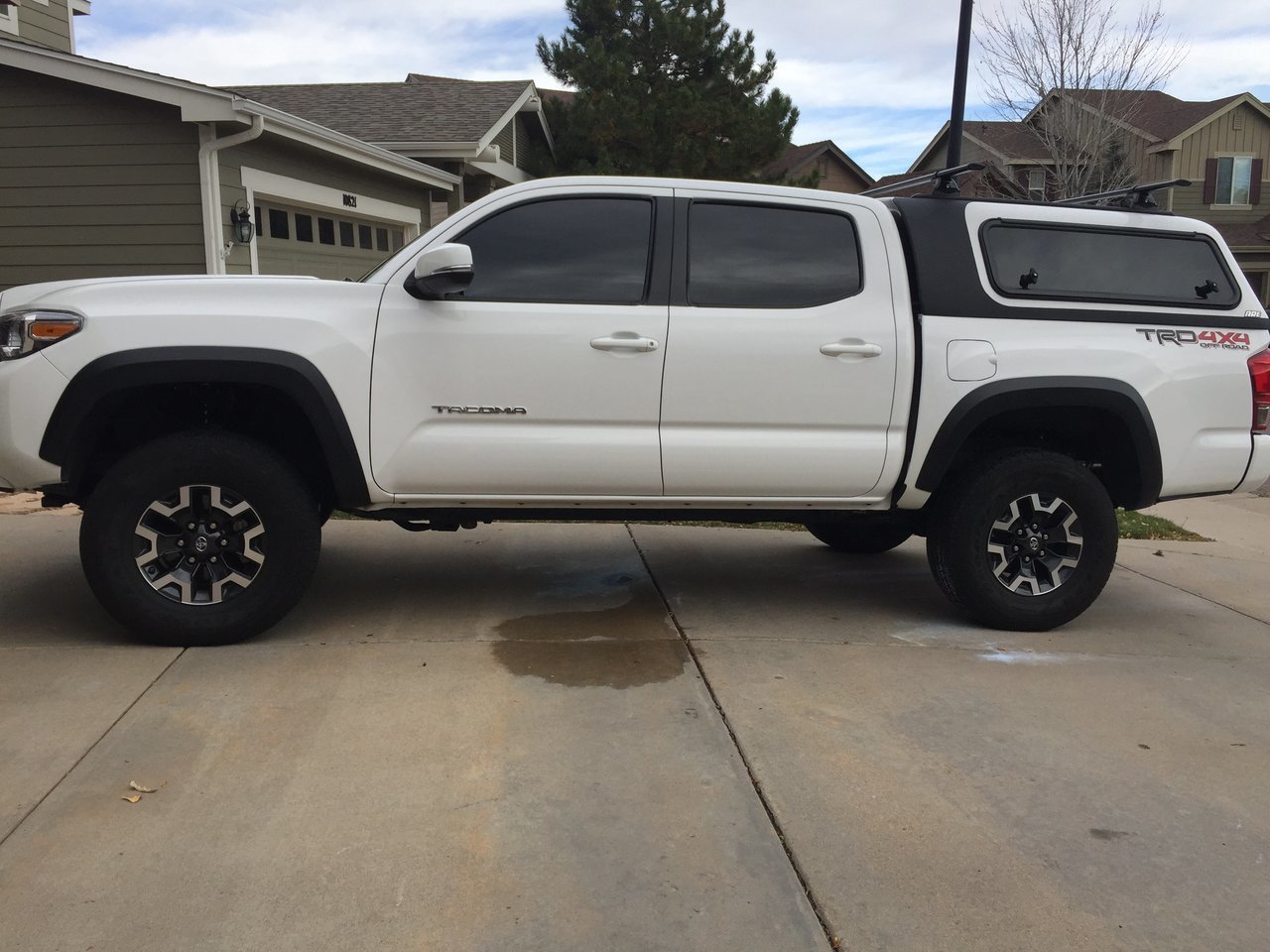

    Here is the same setup at 5/4 with Dakar Medium pack. No additional spacers. driveway make it look nose high due to slope. actually ended up with about 1.5 inches in front and 1.7" inches in the rear.

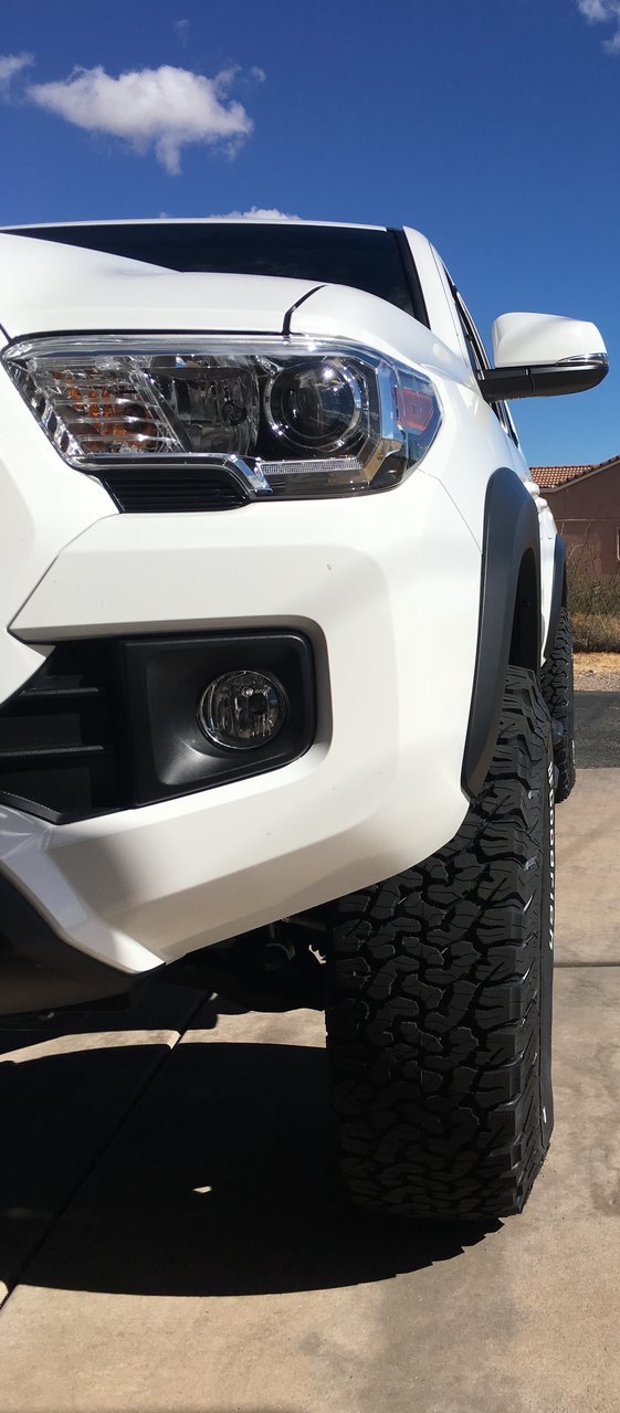

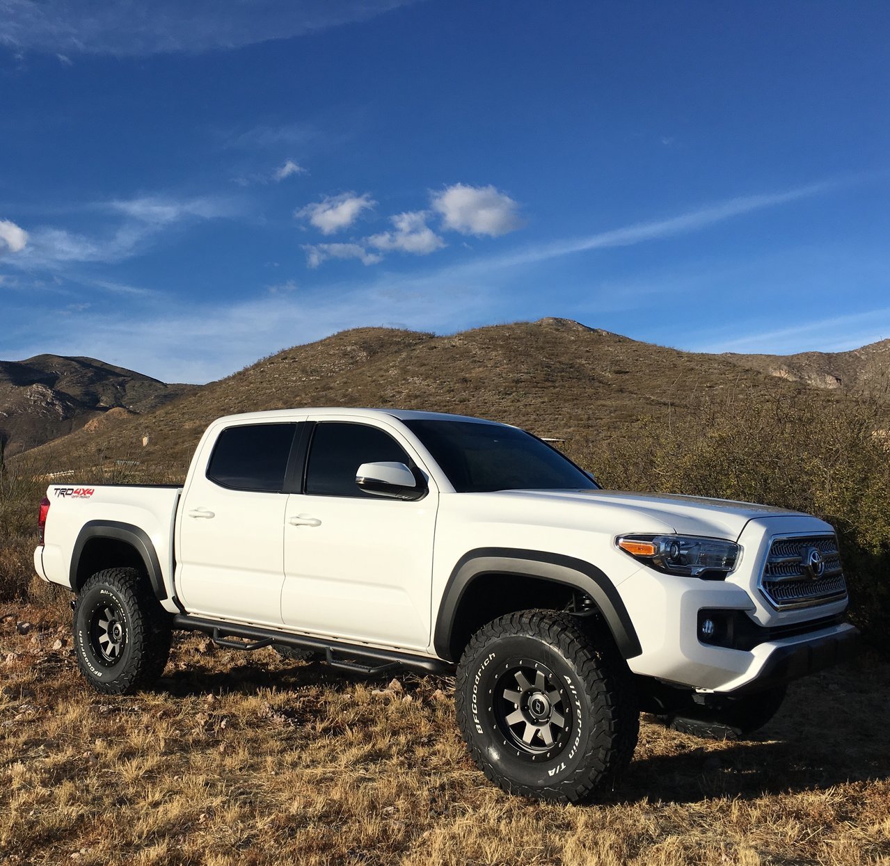

    Here's mine on 285/75/16 KO2s. Running Billy 5100s set at 0, OME887, and Deaver AAL for lift as well as CMC and very minor trimming inside fender well to eliminate rubbing when flexing/turning. No issues at all now.
    BA6F14B9-E16F-41EB-9AAC-F631477A1EC3.jpg FCE52DA3-CEEC-4115-BEB7-46B6FCEFC739.jpg

    285 fills the wheel wells so well. :drool:
    Sweet ride man! How is your mileage?
    I have a similar suspension setup to yours but am running 265, they look like skateboard wheels in comparison. :anonymous:

    I have only been on this setup for about a week now (one tank of gas) but so far it looks to be about 16-17 MPG.
