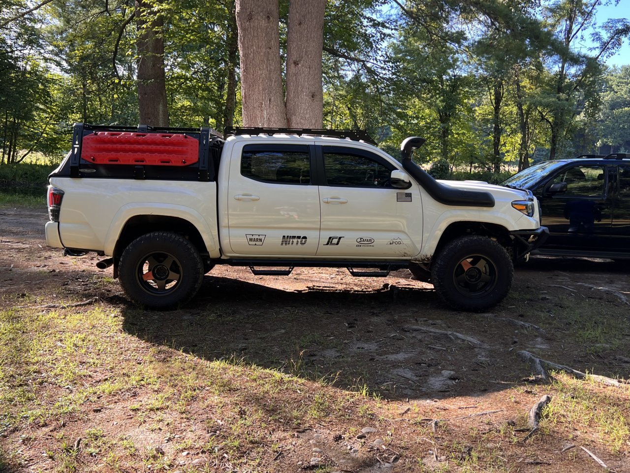

    2” Old Man Emu Lift 285/70R17 Nitto Ridge Grapplers MR304 Double Standard 17x8.5
    2” Old Man Emu Lift

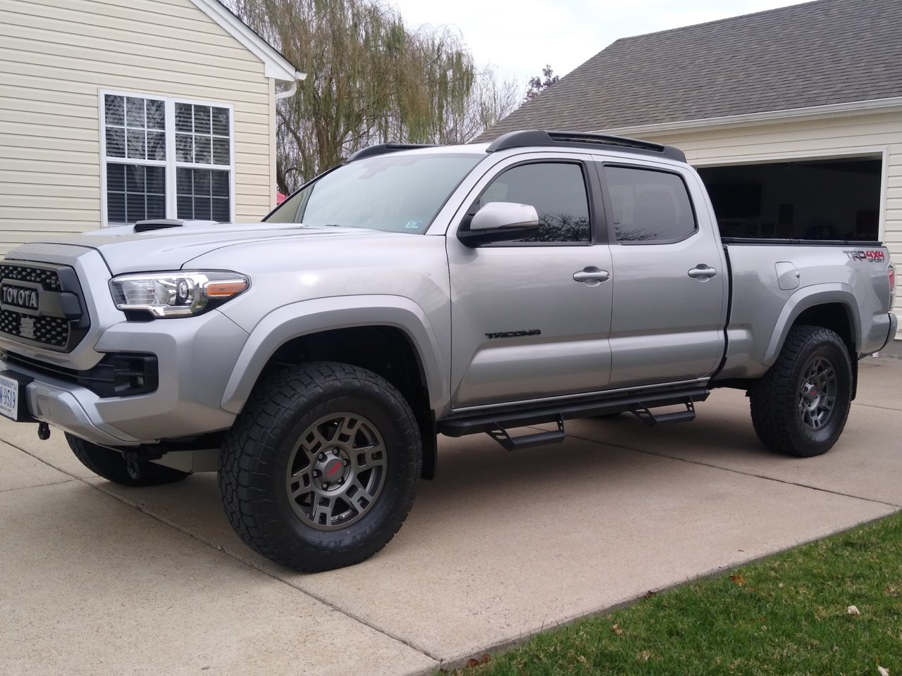

    Bilsteins 5100s on the top setting, 4runner Gray TRD Pro Sema wheels, 285/70/17 Toyo AT3s, Sumo Bump stops, TRD exhaust, ECGS Clamshell bushing, 1/4 shim for the lean and one inch rear block, OEM Pro grill and garnish OEM TRD Skid plate, TRD CAI, Demon Brackets, Rigid Industries Pro fog lights, OEM Trail Rails sidebars, Diode Dynamics LED SL1 high and low beam lights, OEM Roof racks, Clazzio leather heated seats, Remote Start, TRD Pro shift knob, tinted windows, Rockford Fosgate 4 channel amp for the headunit and sub and amp combo, OEM Puddle lights, OEM tailgate lock, OEM bed mat, LED interior lights, OEM blackout kit for letters, JLT catch can, upgraded 27F toyota True Start battery, Vleds led tail light kit with Pro tail lights, OEM Rave4 side mirrors with convex spotters,just to name a few mods.
    I personally think mine rides better than 265s. I was riding on the Toyo at2s on the 4th perch, went up to to the 5 perch on my Bilstein 5100s and added 285s Toyo AT3s and the ride is very smooth and vibration free.and is a noticeable improvement from great to even a greater ride. The alignment was done even better, no trimming and all I had to do was move the bottom hole

    My 4Runner SEMA are +4 and have all the poke I want. It has that factory aggressive look that I wanted and just barley poke out past the fender.
