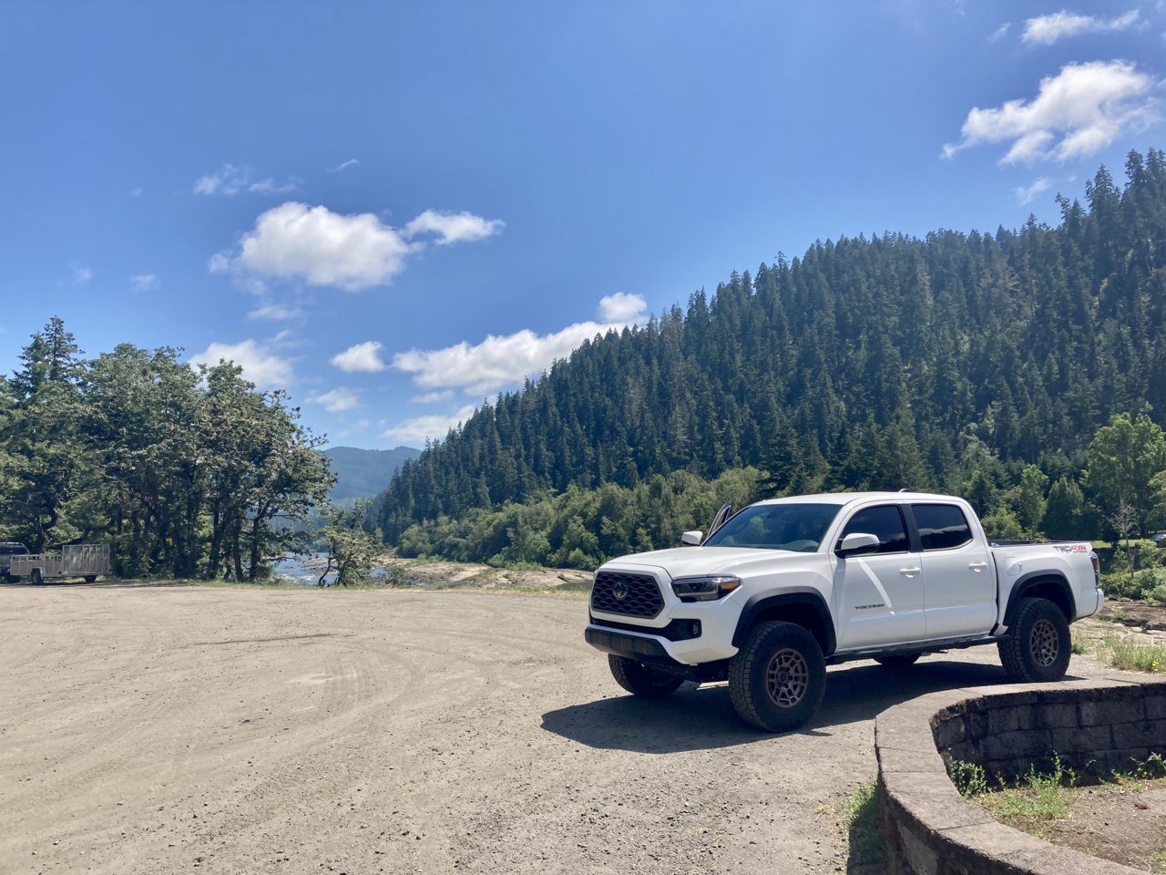

    Looks amazing! How much lift in the front and how hard was it to fit that offset without rubbing?

    Thank you!
    I think lift in the front is just over 2in maybe a little bit more. still have another clip I could go up to. I got the body mount relocated with the DRT kit. After that it was just the pinch weld and some of the liner had to go in front and behind the tire.

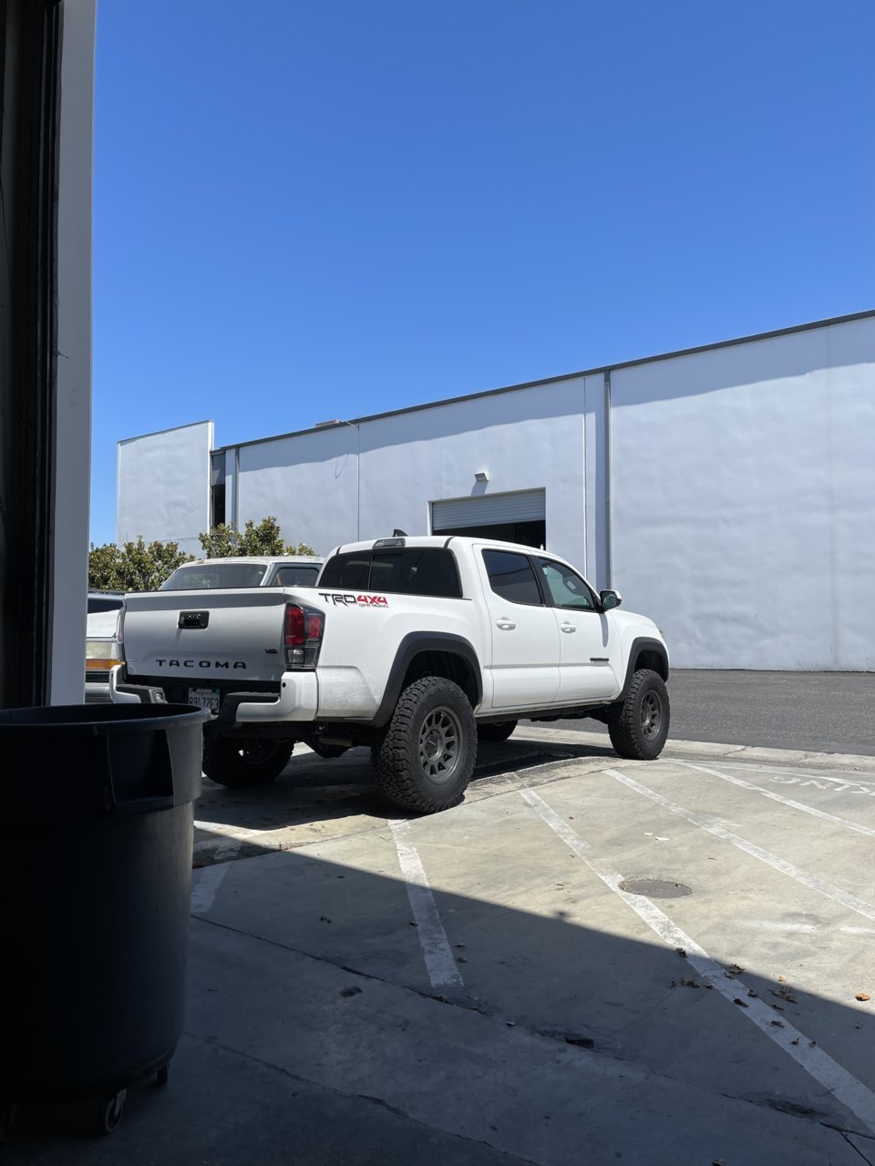

    My 2021 TRDPro with Baja Boss A/T 285/75R16

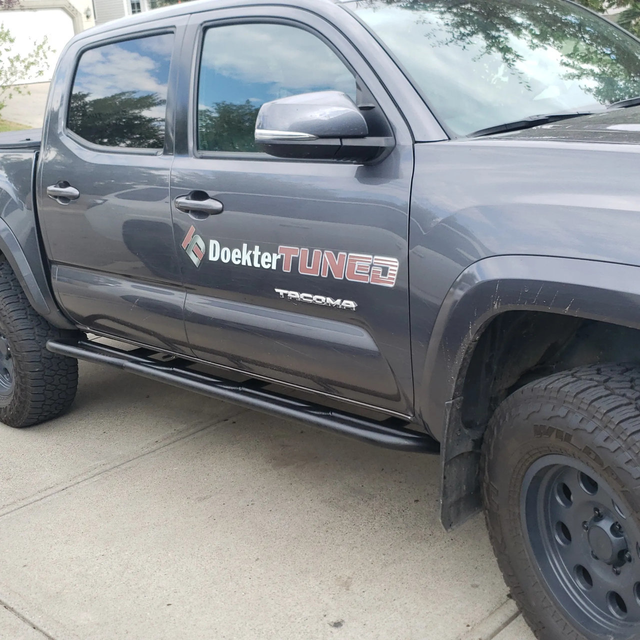

    I've had these on my 2021 Tacoma.
    285/70/17 for show and shine
    285/75/16 for wheeling.
    I like having 2 sets of wheels, just in case. Some might say I have a wheel problem, the most I had were 5 sets of wheels and 2 spares for a total of 22 wheels for 1 single truck. Single rear wheels D9dge Cummins... and 22 wheels(rims+tires).
    On my Tacoma, I had 3 sets of wheels. 4 if I include the black TRD rims it came with
    On my 4Runner I now have 2 sets of wheels and 2 spares.
    Yep, time to hit a meeting..

    Are those the 16" TRD Pro rims?
    Aren't they 7" wide?
    Any issues fitting 285/75/16 and what lift do you have?
    Do they clear the TRD UCA or did you had to replace the UCA?
    I just canceled the order for Yokohama Geolandar MT in 285/75/16 after reading that the 16" TRD PRO rims are only 7" wide and you need 7.5"-9" for 285/75/16 and considering pizza cutters instead..
    Lmk please?

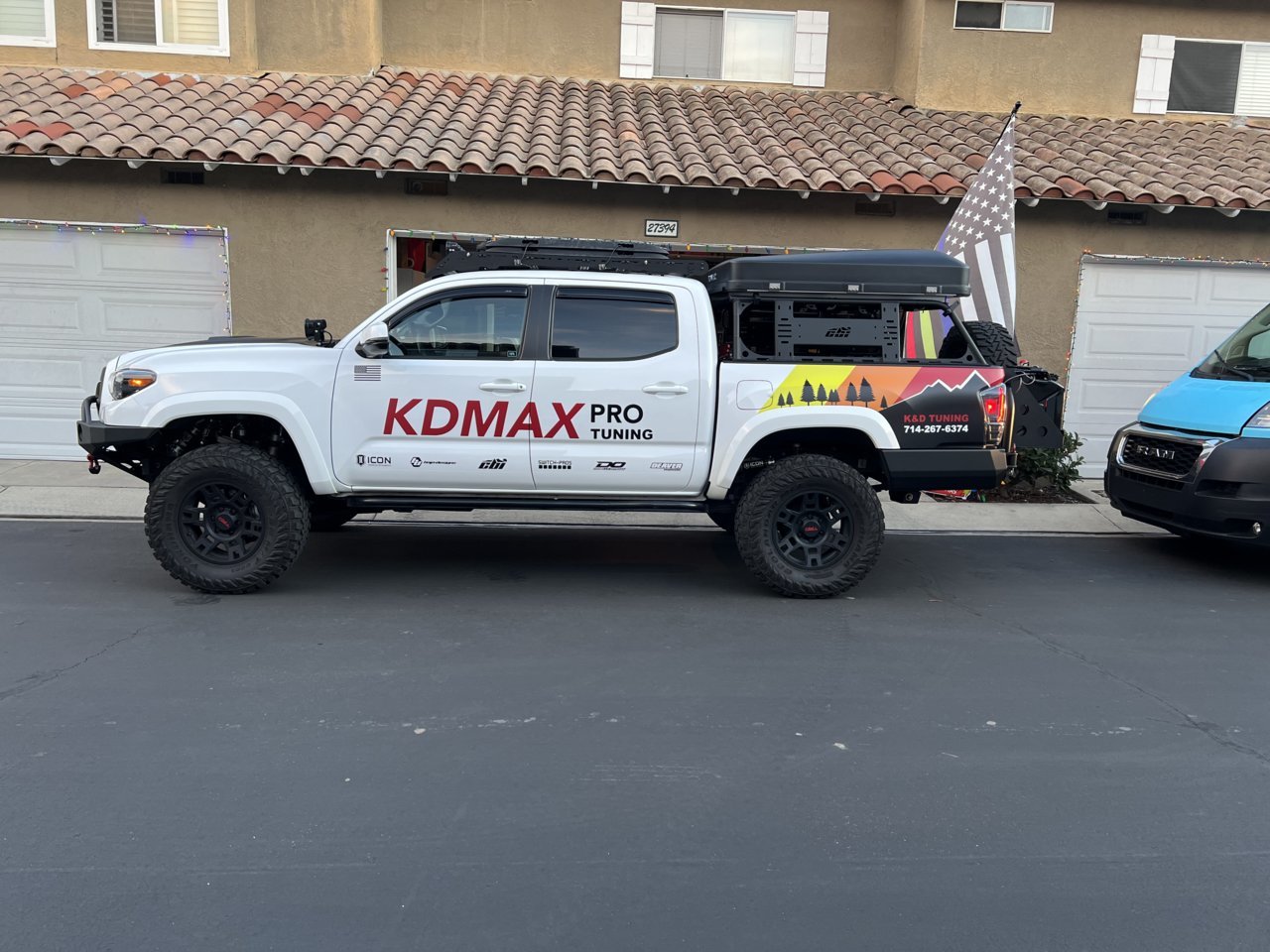

    What bumpers are those?
    Me like them.

    Morning. Yes these are the factory trd 16 wheels. No issues but I am running the Westcott designs lift just in the front. On the 23 I hear you have to run spacers because of the the different UCA. Not on this 21.
