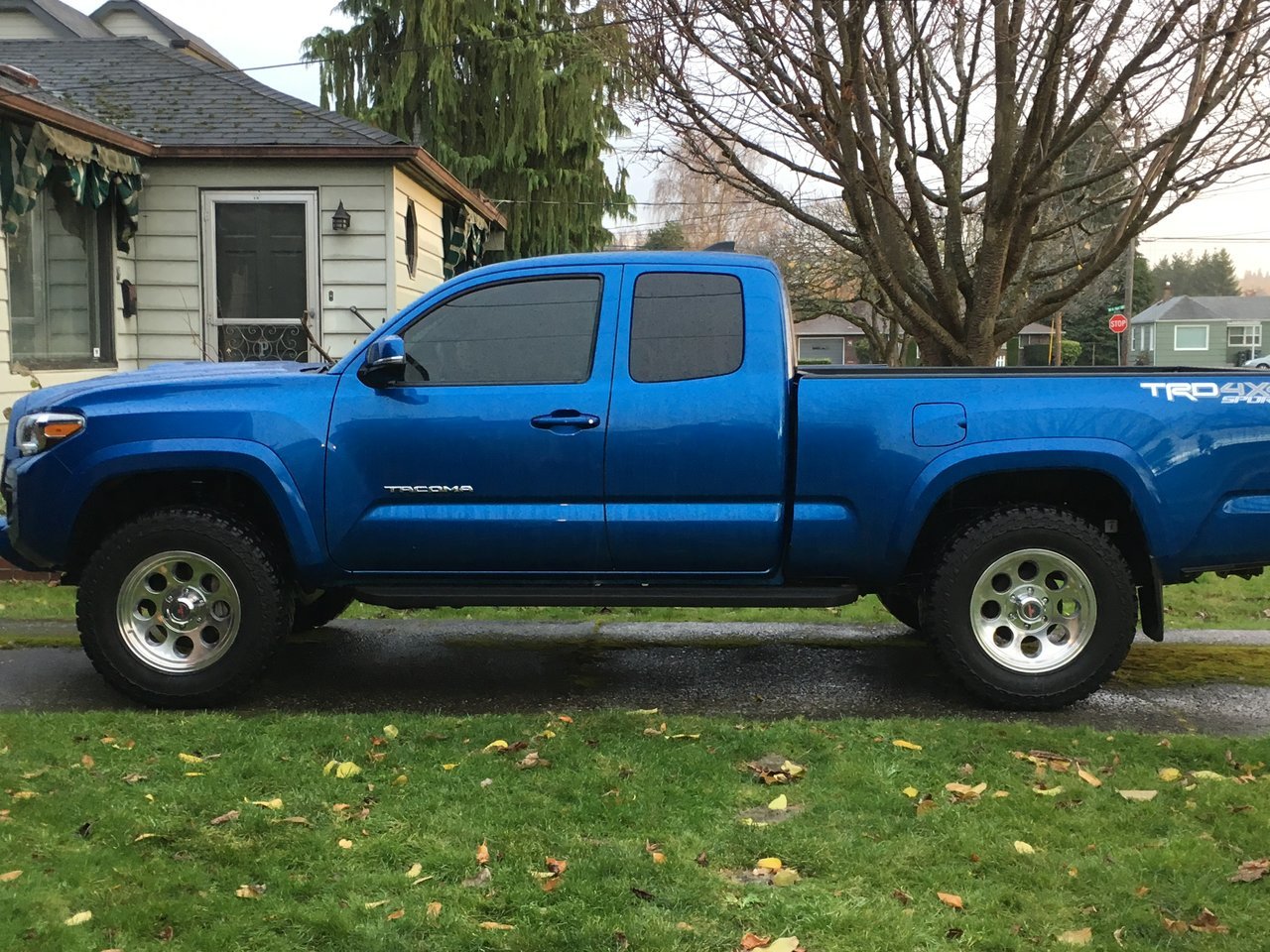

    It could be the old school wheels.
    IMG_1698.jpg I have similar wheels and it give the truck a whole different look.

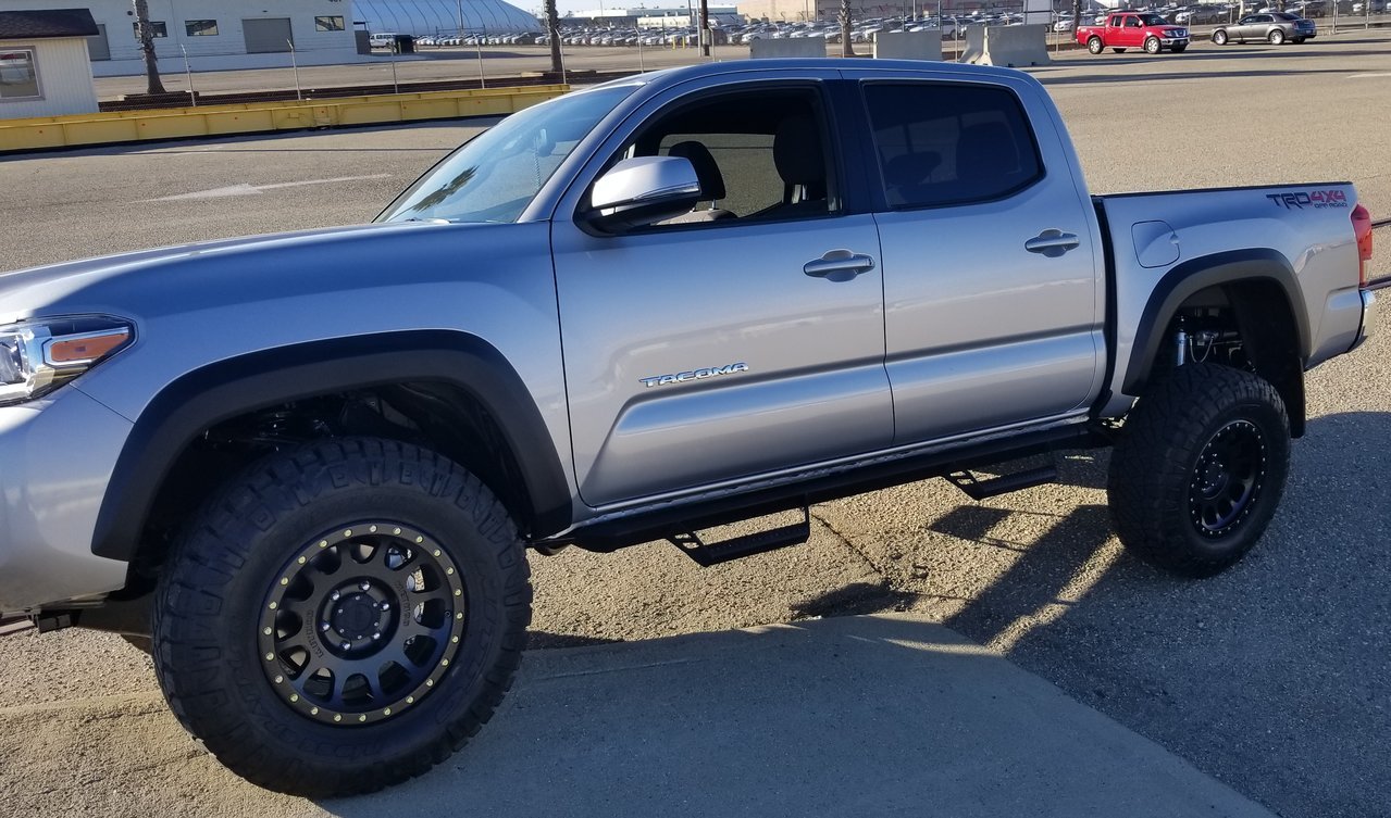

    285/75/16 pro comp at sports. 4 wheel parts had buy 3 get 1 free on them so I pulled the trigger. With spyder trax spacers I have zero rubbing issues. Didn’t even have to chop the cab mount.

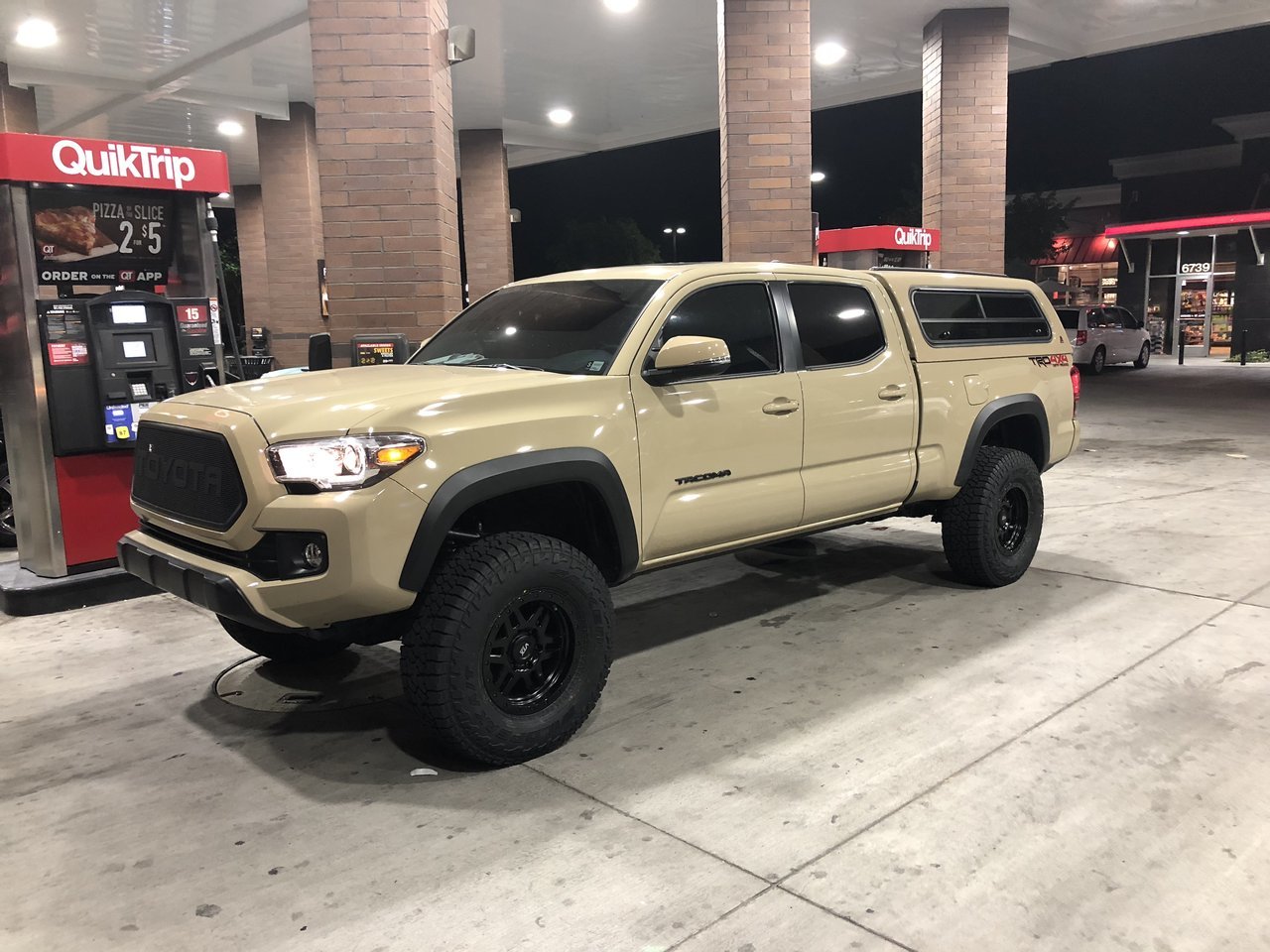

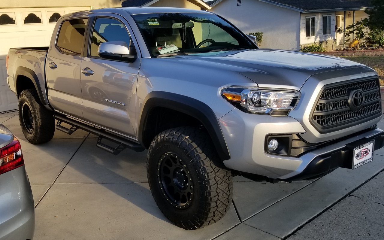

    Front is bilstein 6112 set at notch 5/6 with a 1/2” spacer.
    Rear is bilstein 5160 with Dakar heavy pack.
    No rubbing. Didn’t need to trim or cmc.

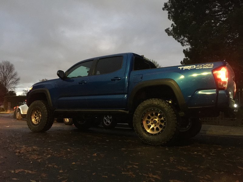

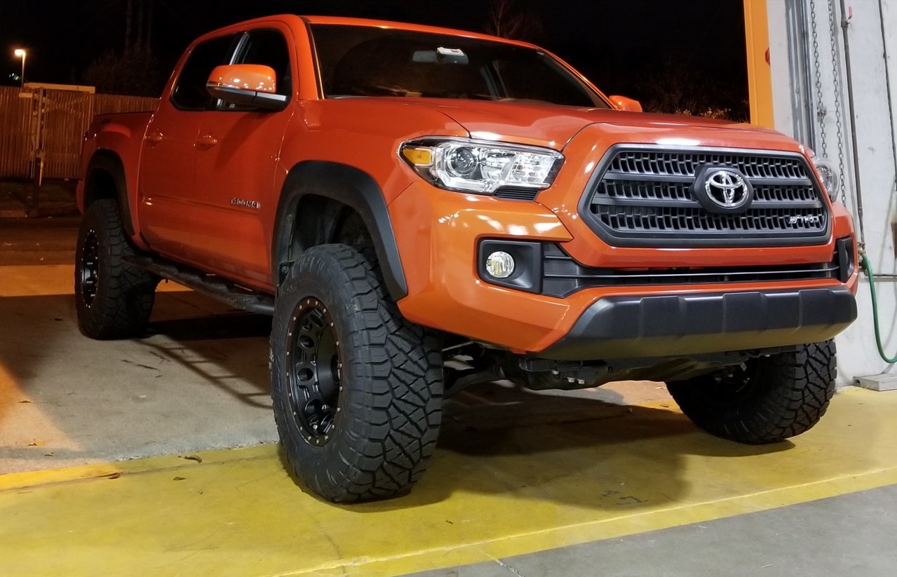

    No more rubbing and no CMC done yet (will do later).

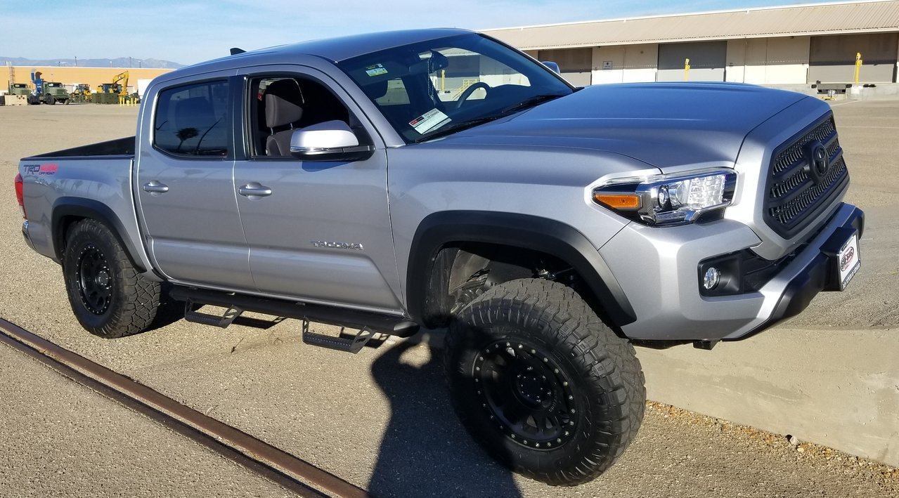

    Bilstein 6112's in the front and 5160's with deaver mini pack in the rear. 285/70R17 on Method NVs20171121_160032.jpg
