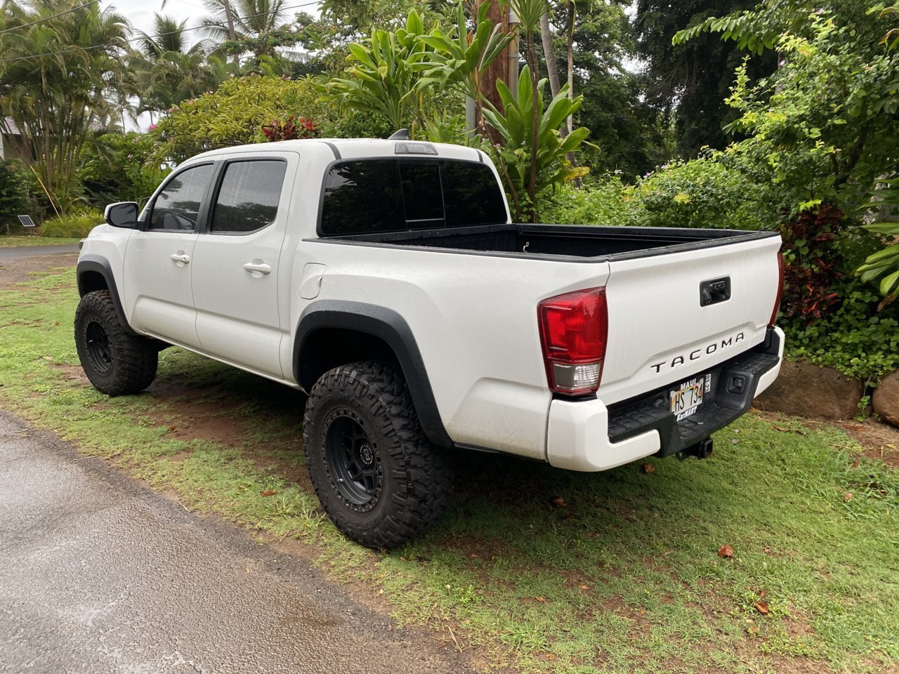

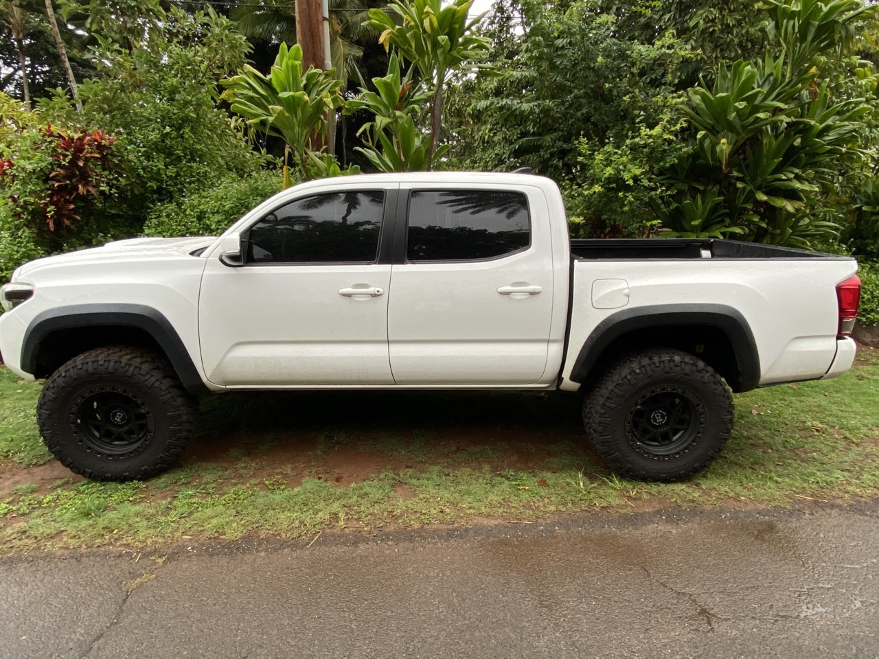

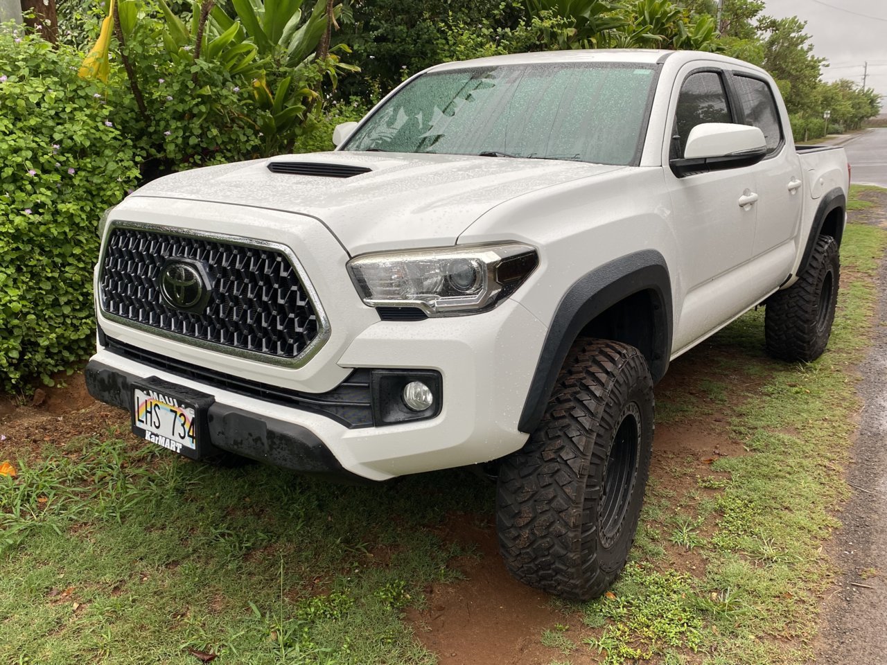

    This one is being shipped in from Maui as I type. 2017 in peeling white. Wheels are by Black Rhino - don't know the model.Tacoma front 3:4.jpg Tacoma.side.jpg Tacoma rear 3:4.jpg

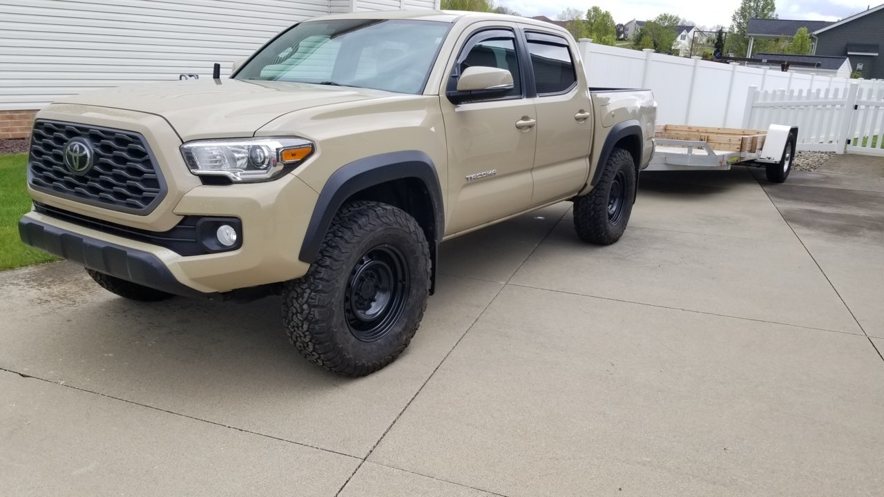

    Are you running spacers with the steelies? Been thinking about going this route, found some FJ steelies. Truck looks good!

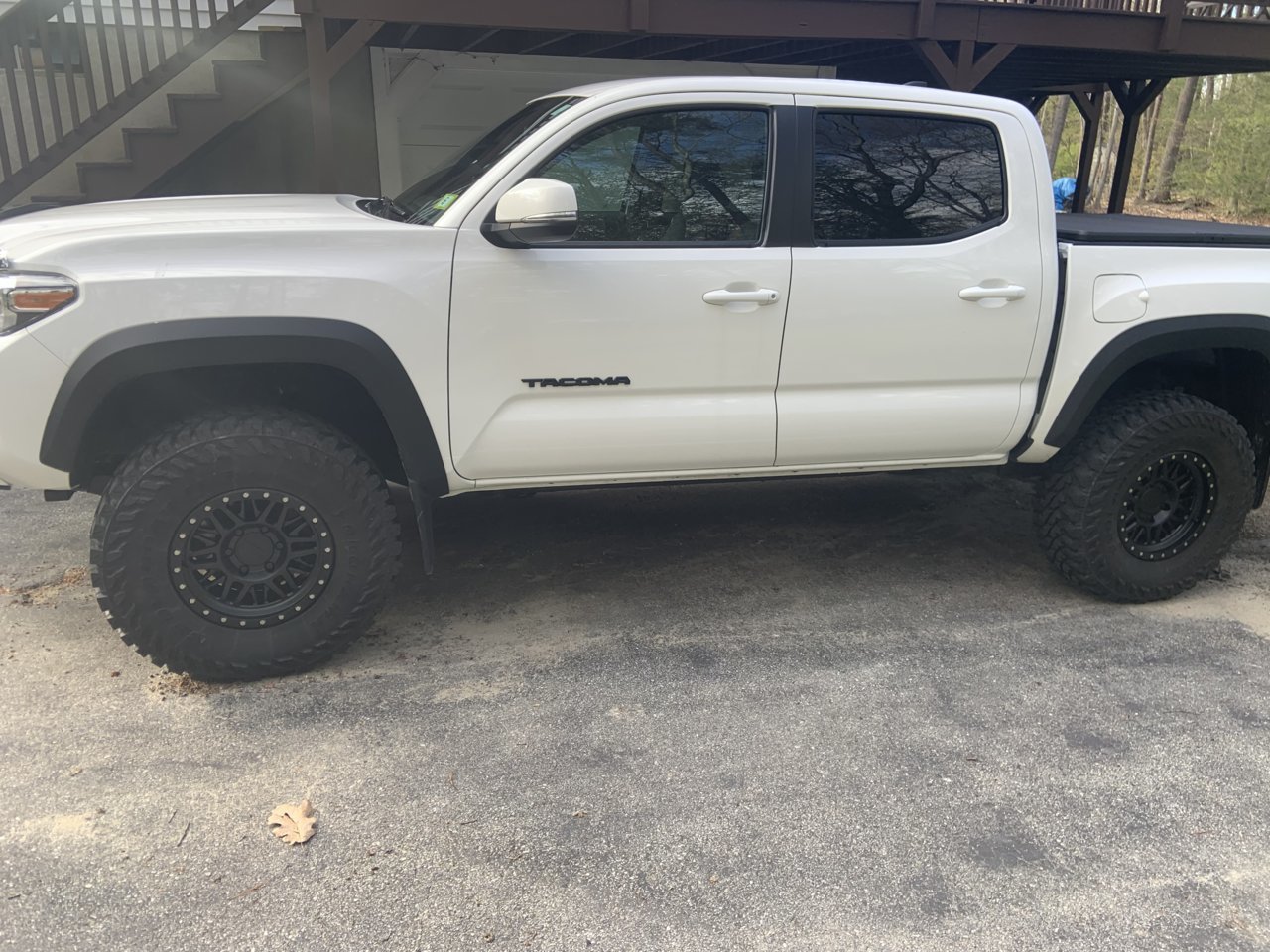

    Its set to 3'' in the front and the leaf pack I have in the back is 2-2.75.. they don't give an exact number

    None

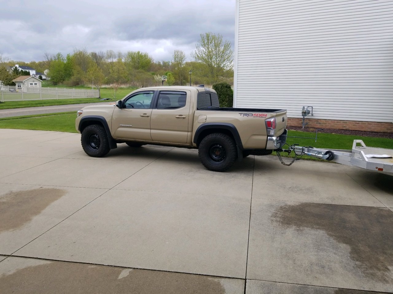

    No spacers. Truck is all stock. Wheels are 17"x7.5" I believe. Not sure on the offset/BS but wheels do stick out a tad more but not outside the truck. I did have to remove the OEM mud flaps and install Rokblokz but that's it. I only have the slightest rubbing when turning full lock on the UCA but really not noticable and not worried about it. Main reason I went this route was wheels are cheap and I had a new set of stock JL Rubicon take off tires. Also the spare does fit but it's tight.

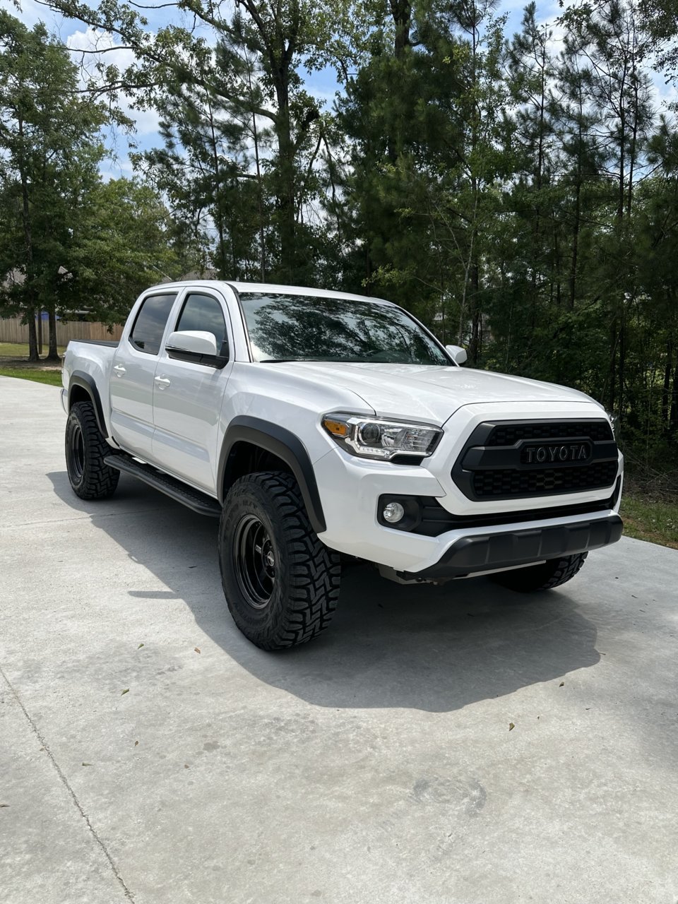

    Front end alignment complete. Moved caster to 2.9 with stock upper control arms. Very minimal rub on occasion at full lock. Drives great for daily driving.

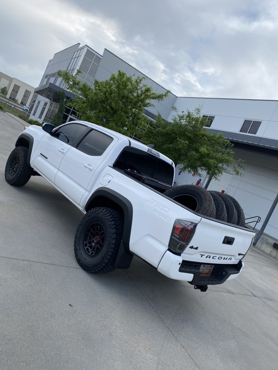

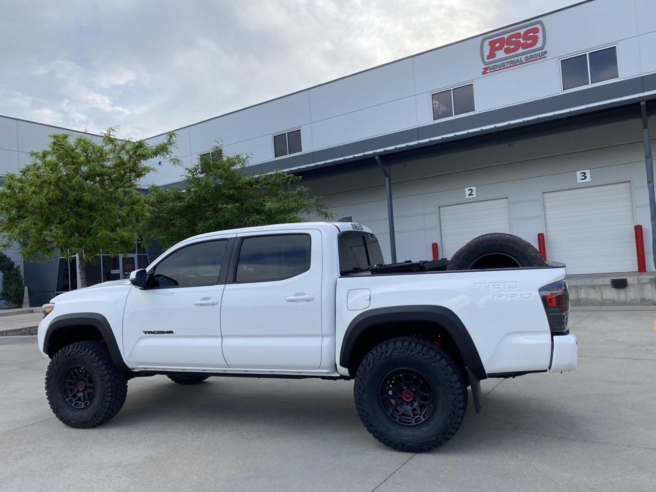

    Finally got the new tires!
    Did the Mickey Thompson Baja Boss A/T 285/70R16 with the 1.25" spacers along with the Westcott Designs trd pro lift.
    Overall I am pretty happy with how everything turned out. Had to do some minor trimming to avoid any rubbing.

    They look great. Just curious why you did these and not the RT Trail's.

    What trimming did you do?

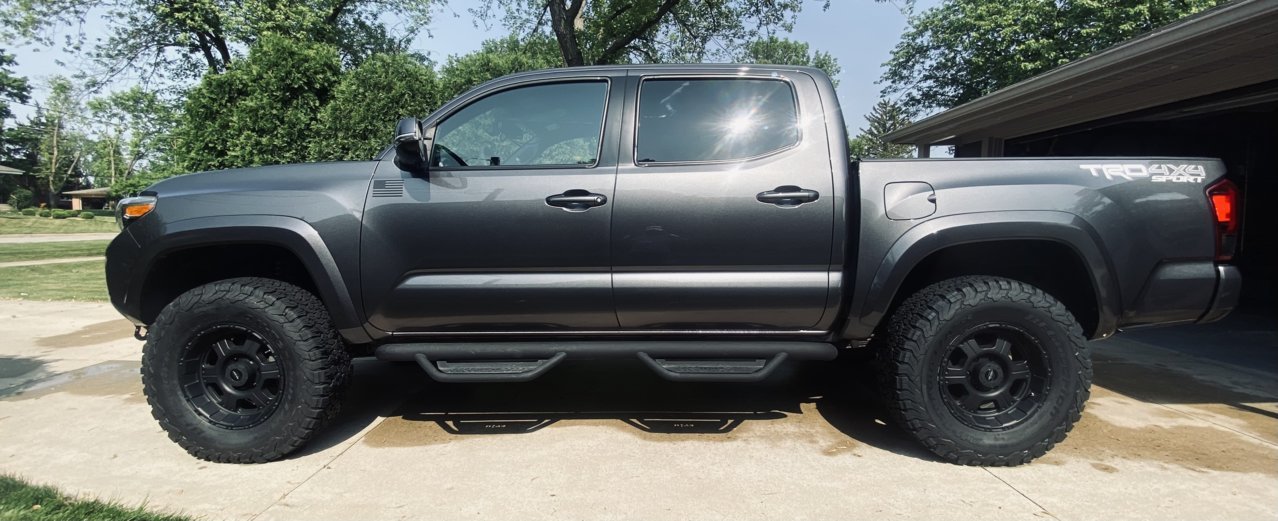

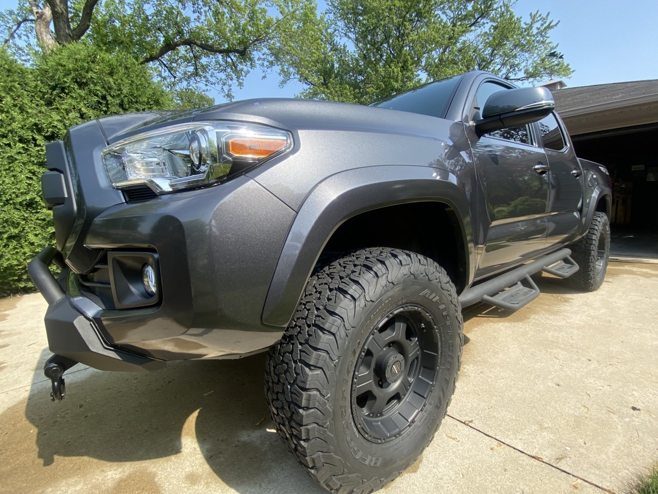

    19’ TRD Sport Dbl Cab M/T
    5100’s w/AAL, Dobinson's 314 coils. 285/70-17 BFG KO2's, 17X8 Pro-Comp 89's 0 offset, BA Highline Front Bumper, K&N FIPK CAI. N-Fab Podium steps, Gatorz Low Profile Hard tri fold Bed Cover.
    Just washed with my new 285/70-17 KO2’s Went from 265/70-17 WildPeaks

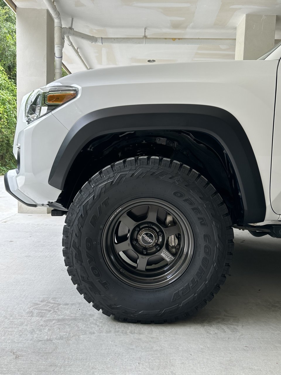

    Thanks! I actually mounted 265/75 Nitto Ridge Grapplers and the look was just too small for my taste. I’ve look at tons of trucks for years and two of them ran these RTs and I have always been drawn to them. I prefer the look of the tread pattern a tad more. The RT Trail is a great looking tire though.
