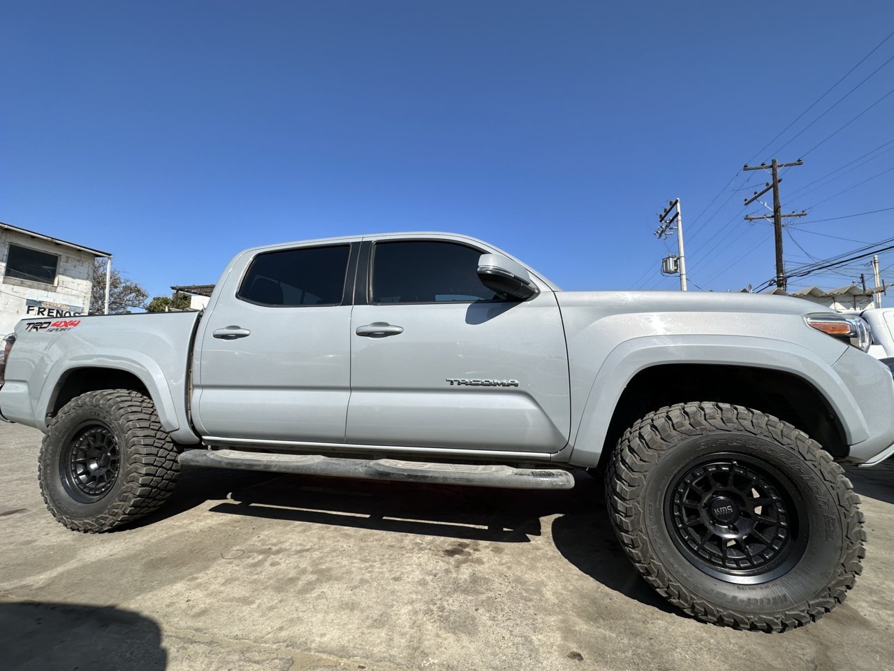

    I just put on some 285/70/17 on Sunday.
    I’ll have to get some better pictures!!

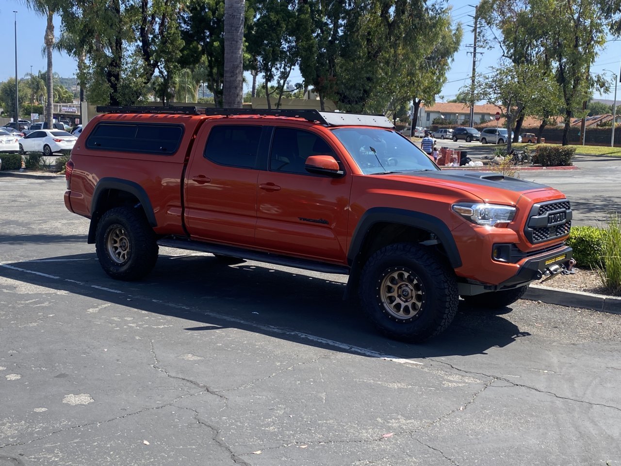

    285/70/17 on KMC's

    Solid truck What suspension are you running?

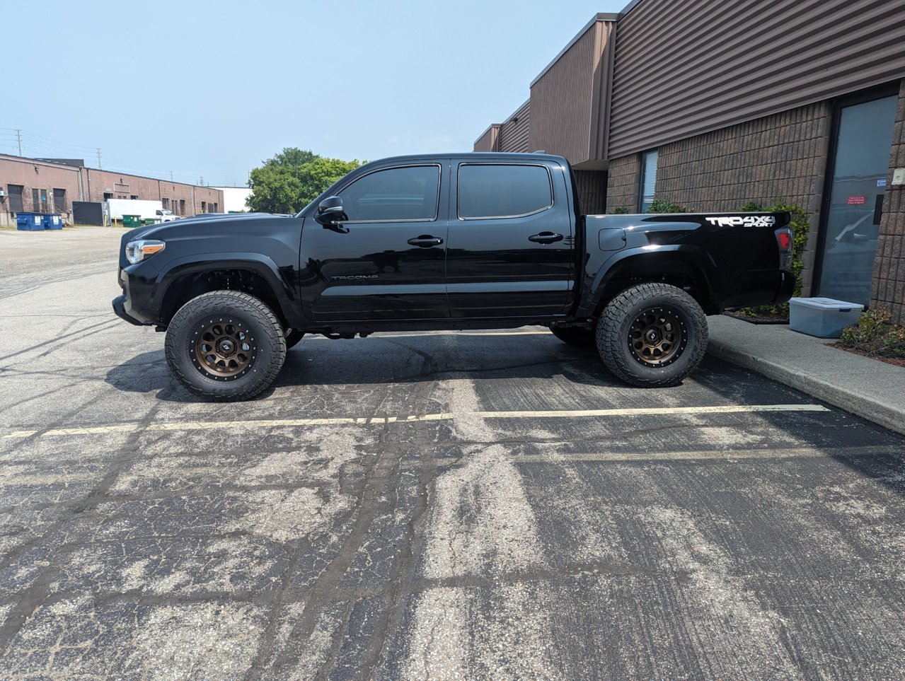

    Bilstein 6112/5160 with icon AAL on 285/70R17 Falken Wildpeaks and SCS Ray 10s

    Perfect stance! Nice truck, man. What settings are you on?
    I've been looking at doing the exact same setup on mine.

    Thanks man! I'm on 11/9

    What upper control arms are you running? Any rubbing issues with the 285's?

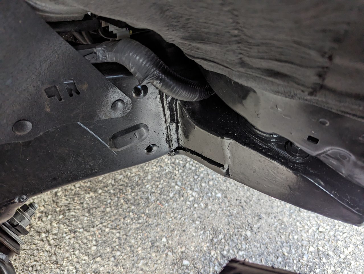

    Didn't change the UCAs yet. But no rubbing at all. I do have a nice CMC though and trimming

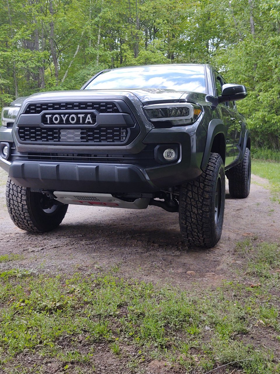

    I've got Icon UCA's with the delta joint and 285's and I don't have any rubbing either. And I didn't have to cut anything.

    What wheel offset?

    0. The wheels are 17x8.5x0 offset. That, and the alignment is what makes the difference. Alignment numbers are +4° caster, adjusted on the LCA, and camber and toe to spec.

    Ya I think the offset is what's helping a lot. Mine are -10.

    It's both. The Icon UCA lets me get to +4° caster and still get camber and toe to spec. The 0 offset lets me clear the UCA, and not poke out to much that would cause scrubbing, and rubbing.

    For sure, but even with UCA and a good alignment, I've heard every truck differs and lots will still need a chop. For me I didn't want to spend the extra on the UCA right now so opted for a chop instead.
    Your rig looks great btw. Is it black or MGM?

    Thanks, it's MGM. Too be honest I'd like to see a truck with a high end UCA, a 4°caster adjusted at the LCA and 0 offset wheel that rubbed. A lot of guys run the SPC UCA's, and they're good UCA's, that lets a shop adjust caster at the UCA. Adjusting caster there will push the tire right back into the cab mount. There's an older thread on here with a guy that built his own UCA and LCA and run 35's without a lift. No rubbing at all, even at full articulation. :thumbsup:

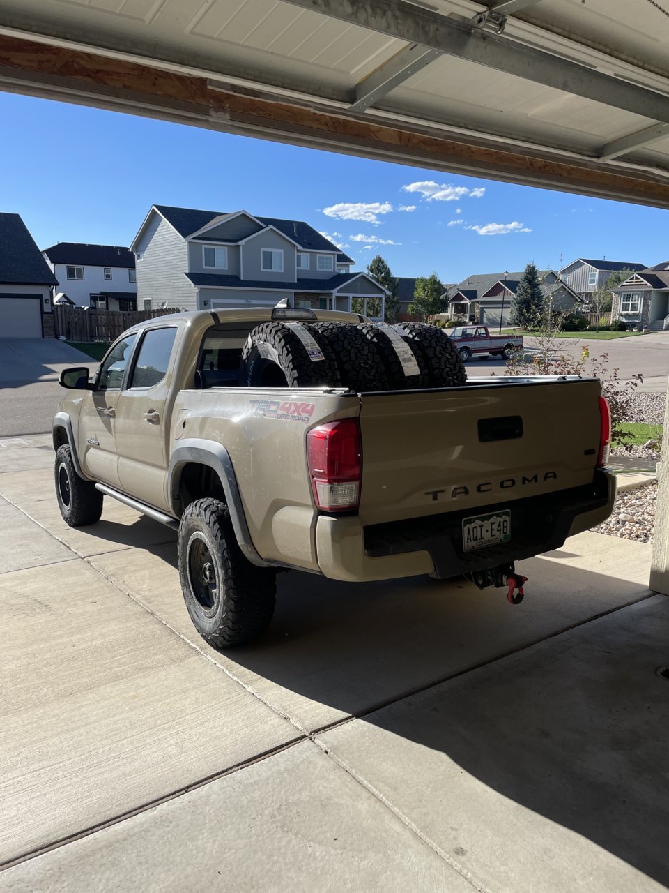

    Getting my 285/75r16’s put on tomorrowupload_2023-9-7_20-27-19.jpg

    285/75r16s on! No rubbing anywhere!
