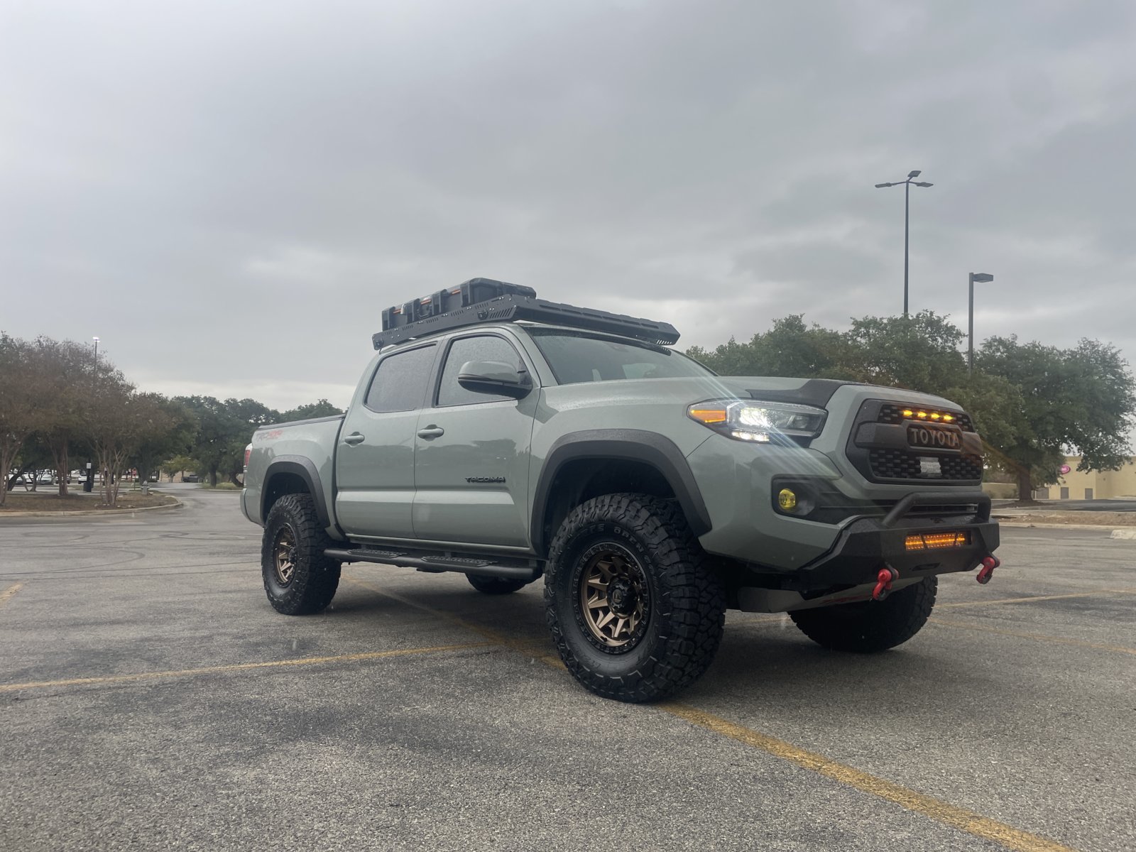

    Looks great! What lift are you running? Are those 16x8 0 offset wheels?

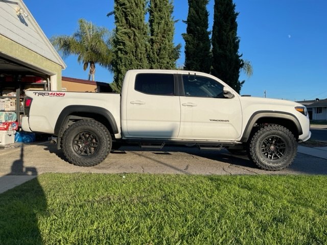

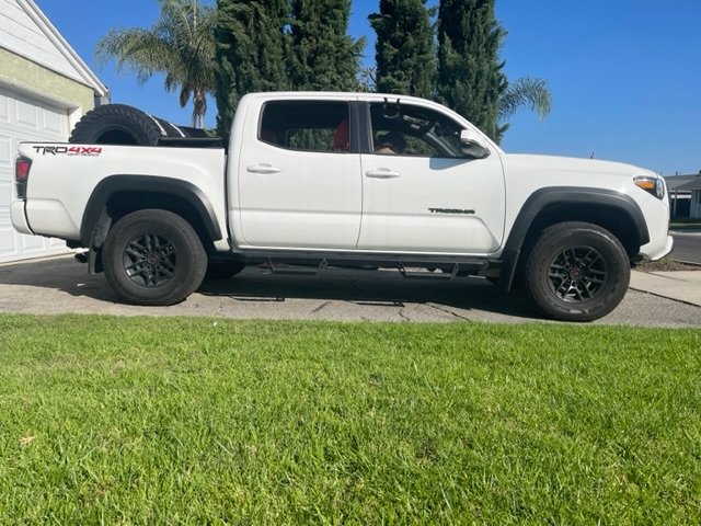

  2. Sep 24, 2023 at 8:34 PM
    #3242
    vivid02
    vivid02 Buy a Tesla…..I need the gas.
    Nov 30, 2020
    #348314
    2,239
    Edwin
    SoCal
    2021 Tacoma TRD Off Road 4x4 DCSB
    OEM+

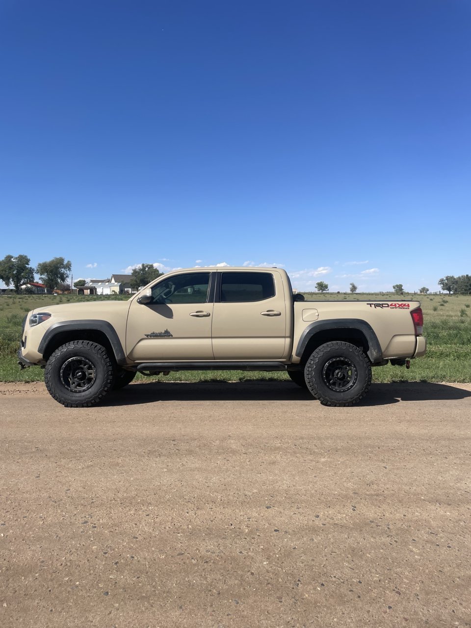

    From oem tires to now 285/75R16 Yokohama Geolandar M/T G003 :D
    2021 Pro wheels and Pro suspension
    Before and after pics:
    Dfpftw, Raku77, kas2828 and 2 others like this.
  3. Oct 6, 2023 at 2:54 PM
    #3243
    pauldotcom
    pauldotcom Well-Known Member
    Jun 6, 2008
    #7148
    544
    Paul
    MA
    2012 Toyota Tacoma 4x4 TRD Sport Quad Cab
    OEM Roof Rack, Bilstein 5100's @ 1.75", Rear 1" block, TRD 17' Wheels
    Stock PRO suspension? Ignore my ignorance - does the PRO have more clearance than the Off-ROAD? I have an OFF_ROAD w/ TRD lift 2"/1.5 - same wheels (7 degree offset I believe). 265's in my opinion look way too small but I am worried about rub... No rub for you?

    Lift? Are those factory TRD wheels? Tire size?

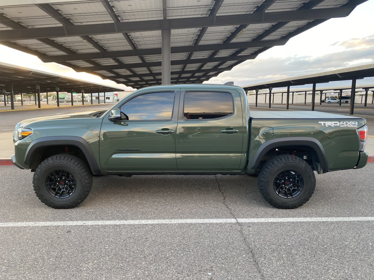

    2022 OR Lunar Rock
    Toyo RT Trail 285/75/16 No rubbing. 2/1 lift. Belstien 6112/5160.

    is this truck lifted? I’m digging those Klevers

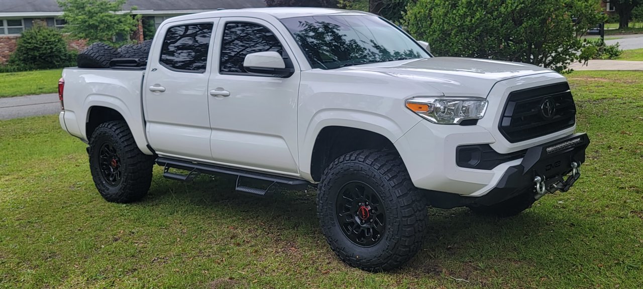

    A few things….
    Going to go 315s next tire
