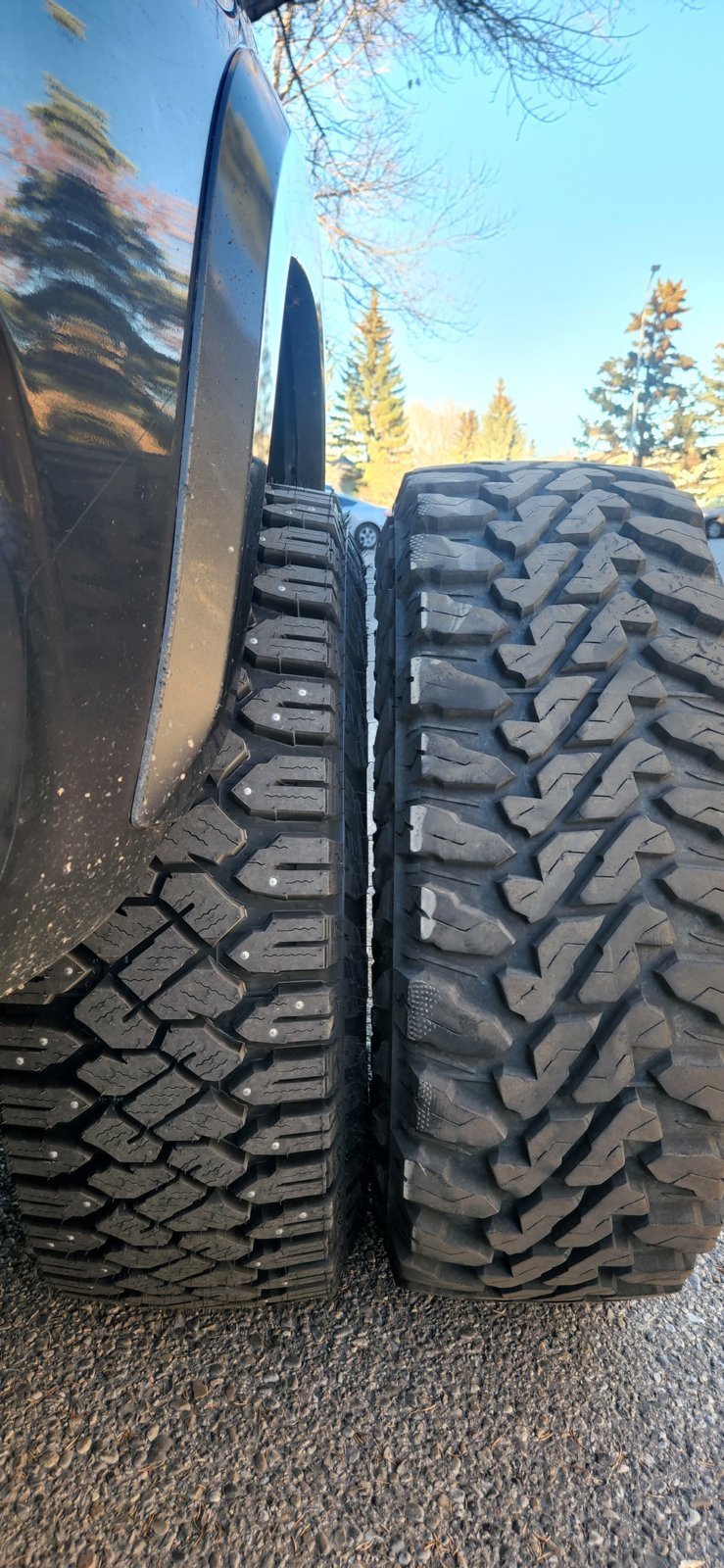

    A few things….
    Now I have a full 6” of up travel and about 9” of droop

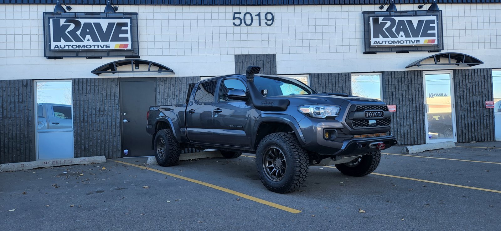

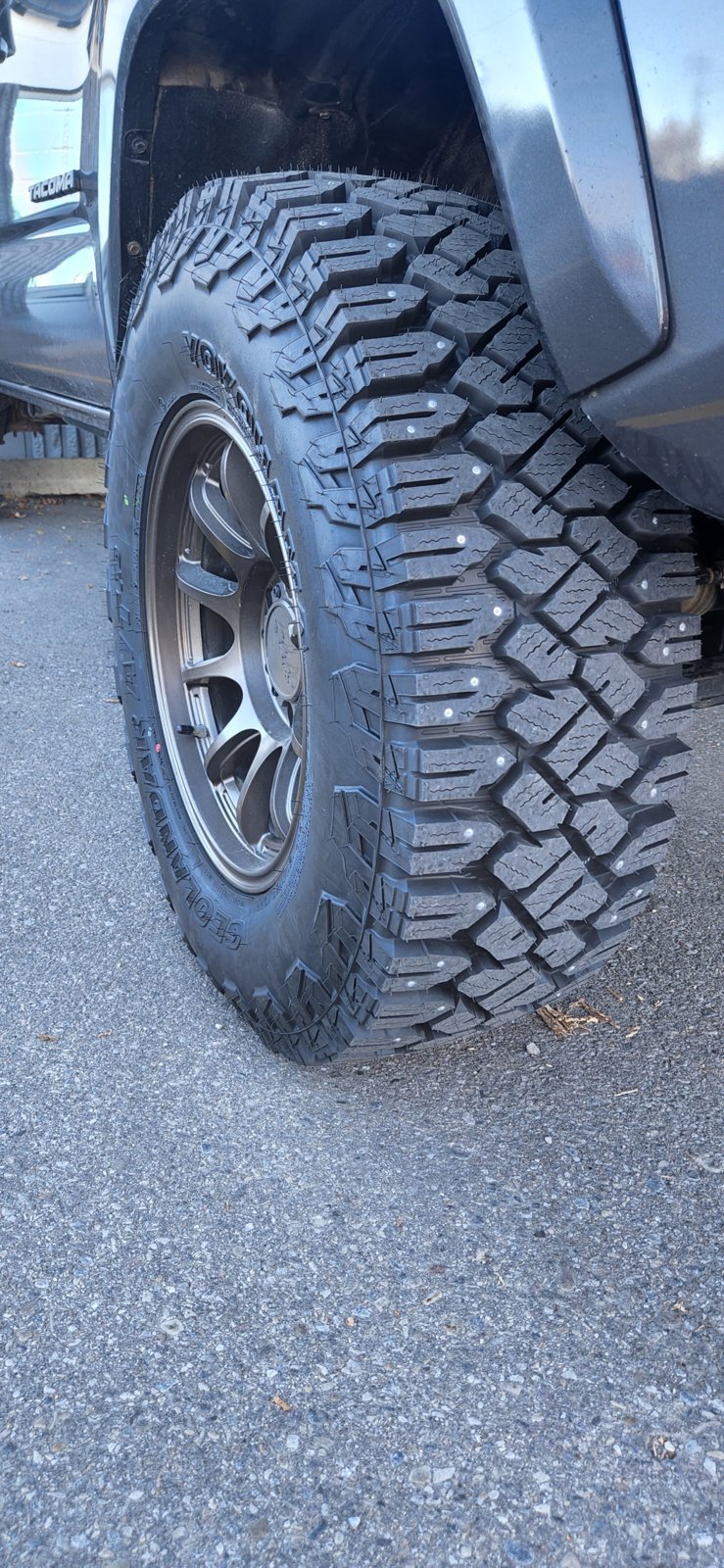

    Gmak621
    Gmak621 Łøādîñg…
    Dec 13, 2020
    #349537
    1,567
    Nørth Çøast
    2024 TRD ØR
    285 75 16

    1,567
    Nørth Çøast
    2024 TRD ØR
    They ride pretty well. Very quiet. There is obvious power loss but worth it in my opinion. Tune helps. I can get almost 19/20 mpg if there aren’t many hills. The tires are very good off-road and have an aggressive look for an AT tire.

  16. Oct 24, 2023 at 11:23 AM
    #3276
    fake4x4
    fake4x4 Well-Known Member
    Jun 20, 2015
    #157787
    912
    Los Angeles, California
    3rd Gen Tacoma TRD Off-Road DCSB
    Cool stuff
    what mods did you have to do to fit?

    Maybe its just the angle of the photo, but these look massive and I like it.
    Gmak621[QUOTED] likes this.
