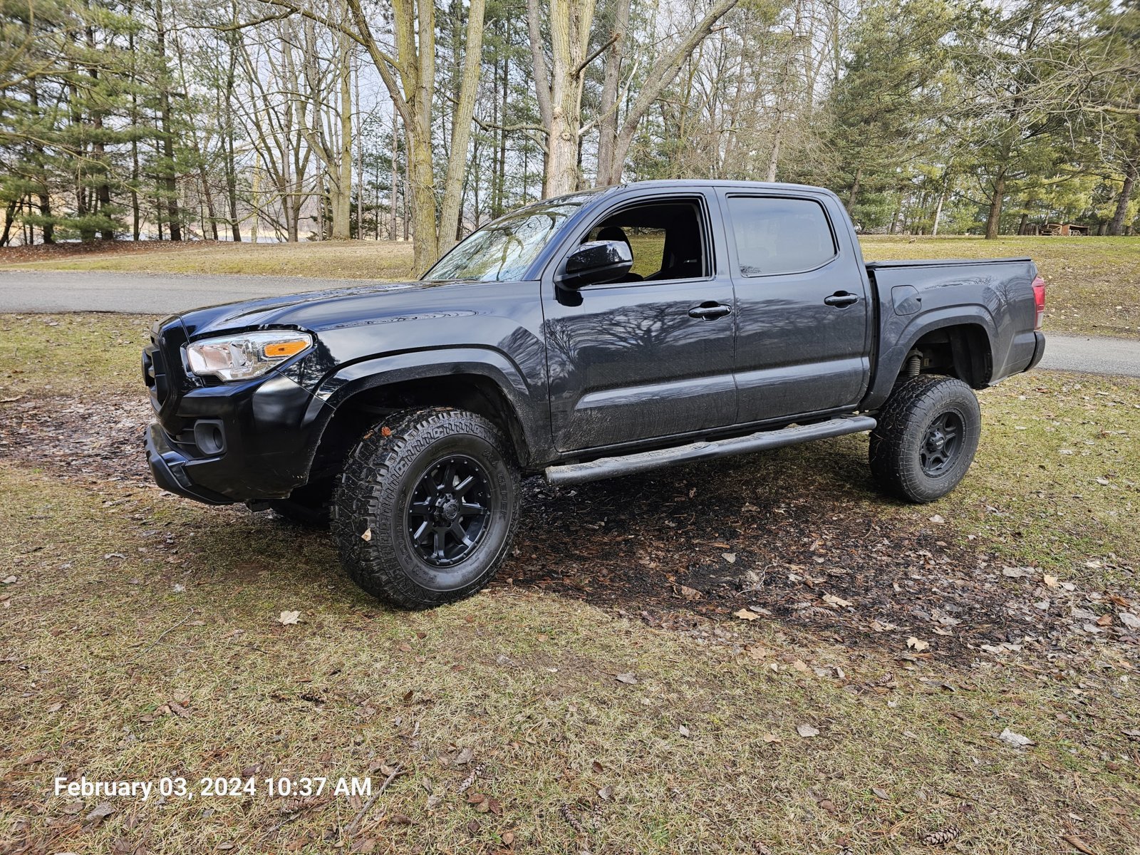

    Millertaco21
    Millertaco21 Active Member
    Mar 23, 2021
    #360340
    29
    2021 Tacoma SR, 4x4, quad cab.

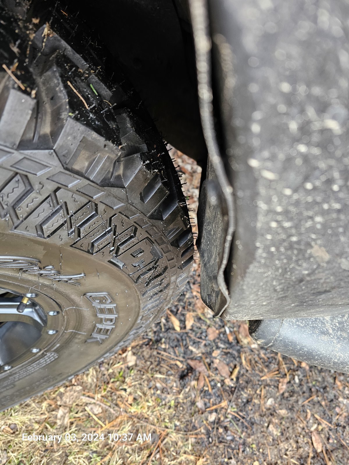

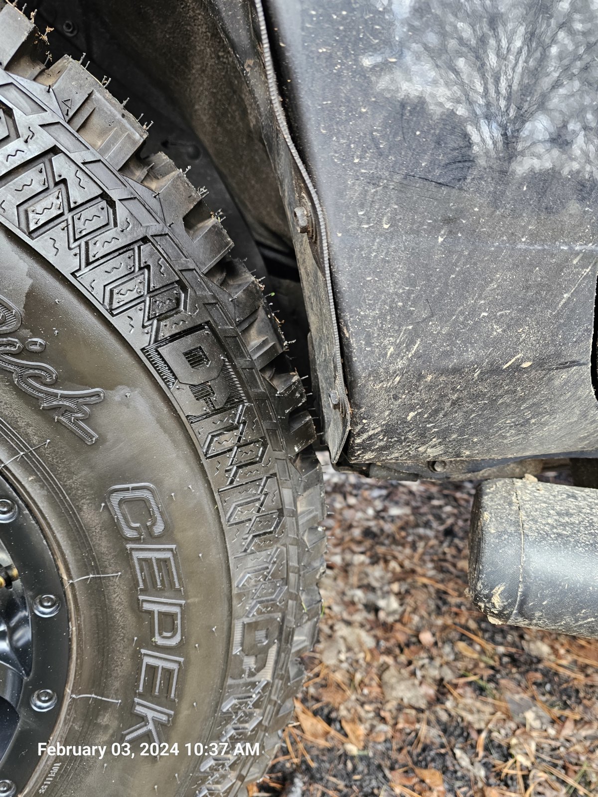

    For what its worth, i bought this 285/75/16 tire at a local tire shop for $75 to do some testing, this is on a 16x8 +10 offset wheel, I have a 1 1/2" lift in front i tried many different scenarios, hitting this small hill and all different angles, forward and reverse and never rubbed. This was all low-speed driving in my yard, so if your doing baja at high speed you may rub, lol, but i have decided if i go to a 285 tire i will definitely go with a + offset.
    SloTaco13 and Road_Warrior like this.

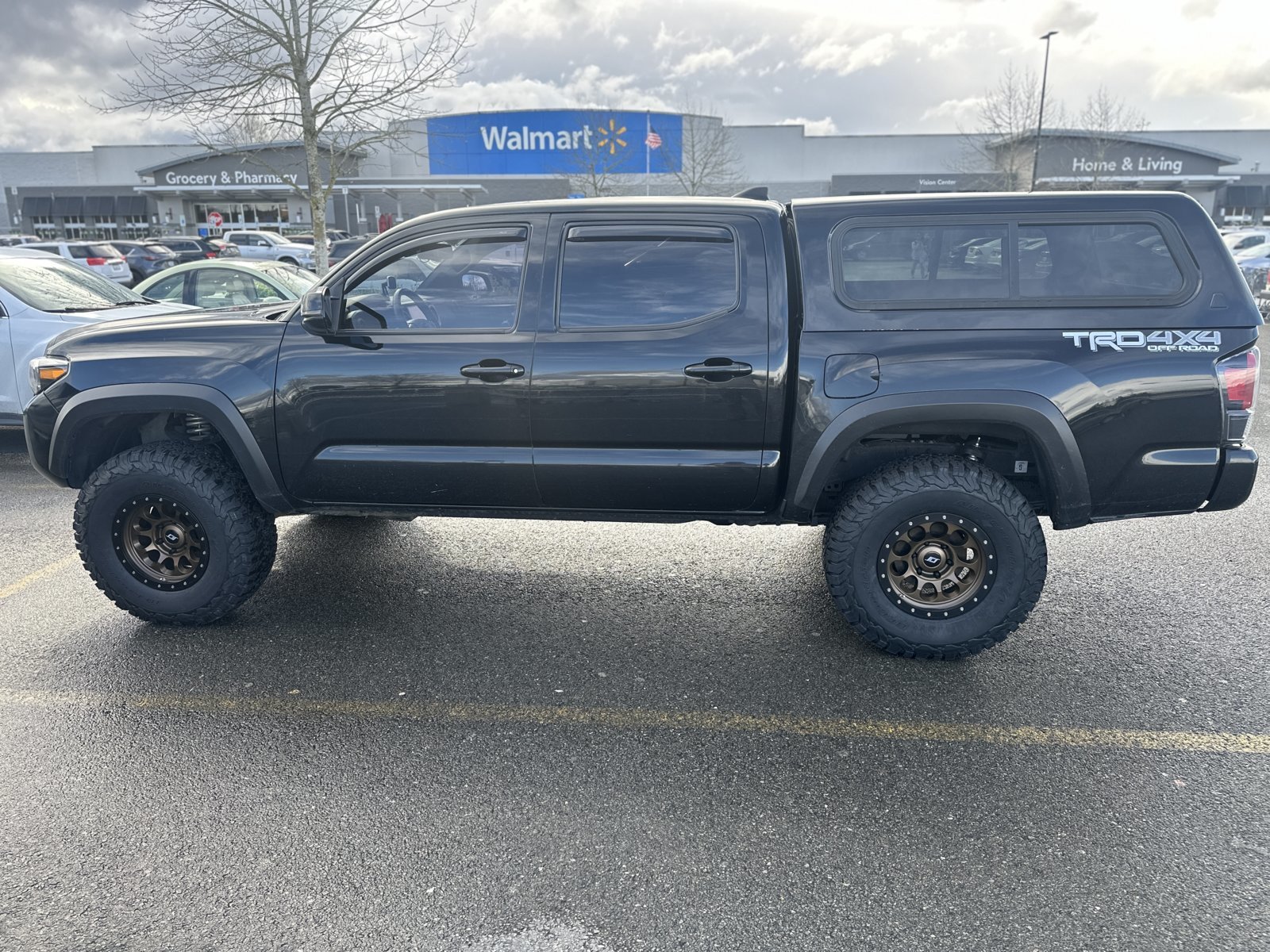

    mryan_884
    mryan_884 Well-Known Member
    Dec 11, 2020
    #349306
    78
    Michael
    Camano Island, WA
    2017 Tacoma TRD OR

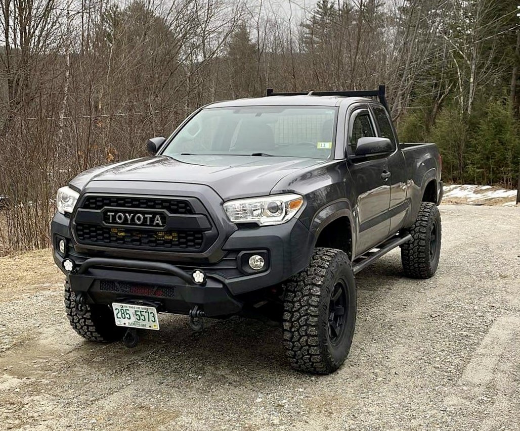

    Got my 285’s mounted today. So much better looking than the 265’s I was running.
    285/75/16 ko2’s
    16x8 -12 SCS Ray10’s
    Eibach stage 2r
    Icon 1.5 AAL
    SPC UCA's to be installed

    From my testing you should be fine, I couldn't get it to rub anywhere.

    Good lord your truck looks so good. So simple and rugged at the same time. Excellent work.
    jeffmansion[QUOTED] likes this.
  7. Apr 2, 2024 at 4:52 PM
    #3367
    AGTaco22
    AGTaco22 Well-Known Member
    Apr 6, 2022
    #394403
    425
    Warren
    RVA
    2022 Tacoma TRD OR
    Nice! Your truck looks great! What size lift are you running? Did you have to do the cmc?
  8. Apr 2, 2024 at 5:03 PM
    #3368
    Veet-88
    Veet-88 Well-Known Member
    May 21, 2015
    #155792
    1,737
    18 Tacoma DCLB sport
    Those are good specs for optimal clearence but you will want to have some caster added to your alignment to help with the cab mount clearence aswell.
    abou824[QUOTED] likes this.

  10. Apr 3, 2024 at 6:18 AM
    #3370
    mryan_884
    Dec 11, 2020
    #349306
    78
    Michael
    Camano Island, WA
    2017 Tacoma TRD OR
    it’s about 2.25” of lift. No cmc did have to do some trimming/ re shaping of inner fender though.
    AGTaco22[QUOTED] likes this.

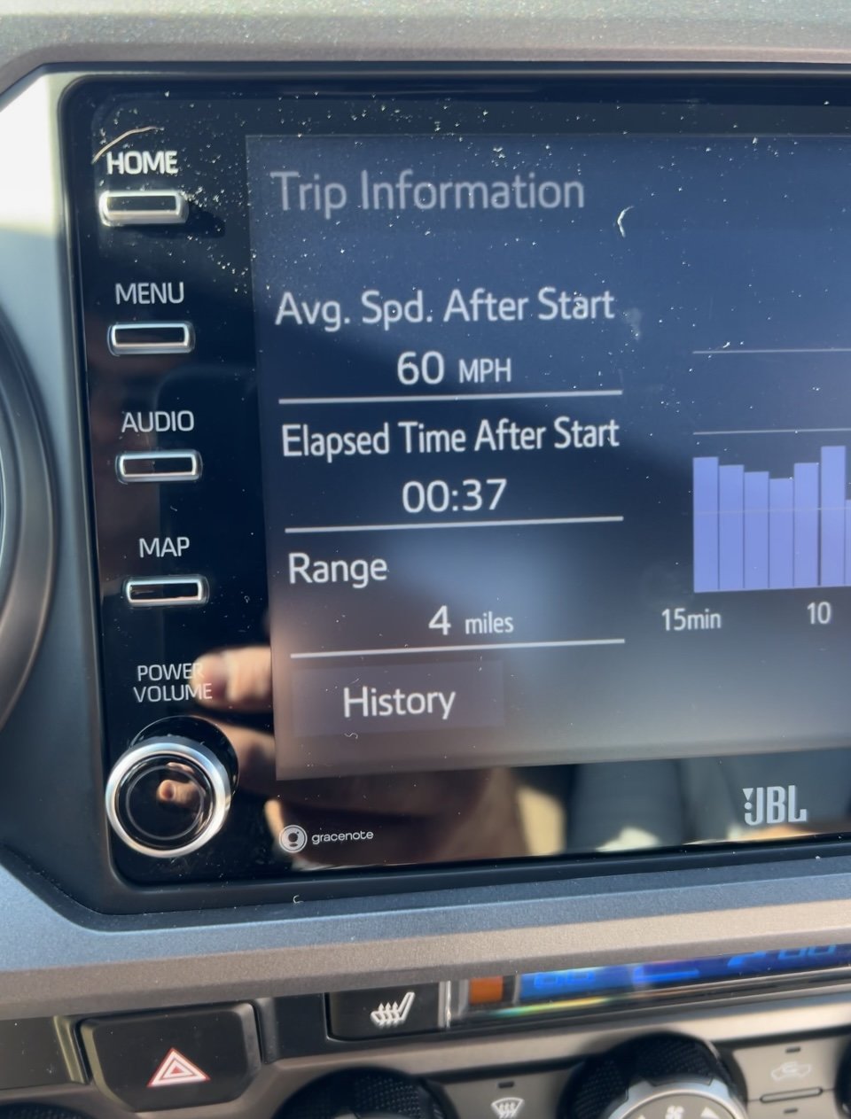

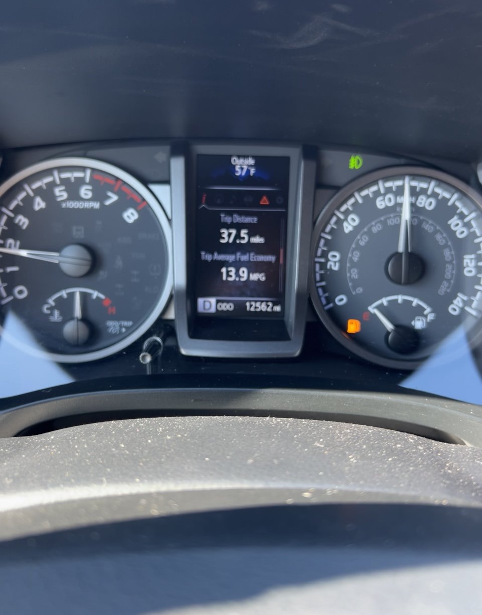

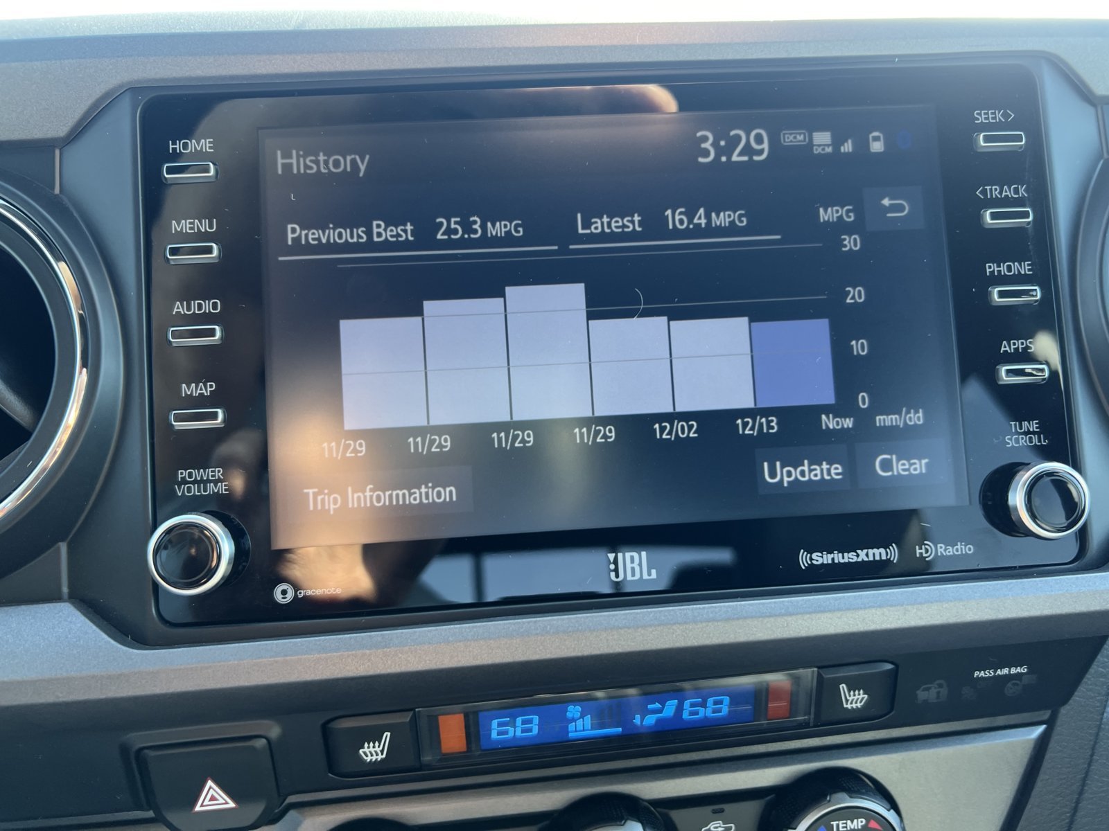

    So I’m running 265/75-16” and Fox sus. Off a Pro. Which added a couple more inches.
    I see where some of y’all are getting decent mileage, but I’m over here barely getting 16/17 mpg averaging 65mph unloaded?
    Yesterday it was really windy NW, steady 25mph with gust up to 40’ I was headed due west into the cross wind around 65mph for almost 40 miles, And almost reached 14mpg.
    I’m driving straight Mo farm county, not specifically hilly, but not KS flat either. It will hit 3k when pulling a long grade a few times during the commute! Which is pretty regular, the truck is new w/ 12xxx miles since Nov 2023. As you can see I reached 25.3 mpg once!
    I’ve never hit mpg again!
    I'm 50 and I’m super conscious on the gas when I’m trying to justify keeping this thing. My V8 Lexus w/280k is getting the same with full time 4x!
    I’d consider a OTT tune if they could give me a money back guarantee it would give me 3mpg’s . I’m currently in the cycle of checking it (mpg) manually again, it checked out the first time I did it when brand new.
    SloTaco13 likes this.
  12. Apr 4, 2024 at 2:47 PM
    #3372
    Redsquirrel
    Redsquirrel Well-Known Member
    Oct 30, 2022
    #409378
    538
    i would pull your battery leads and for a few minutes and then hook them back up to reset everything. i had to do this when i had to put a speed calibration inline behind the dash. My smiles to empty always said 277 when full no matter what after that everything started reading correctly now i'm up to 320-350 depending on who i get to draft. lol
    Fireme[QUOTED] likes this.
  13. Apr 4, 2024 at 2:53 PM
    #3373
    Fireme
    Fireme Well-Known Member
    Dec 9, 2023
    #439183
    186
    Bill
    St.JoMo
    2023 LR DCSBOR
    265/75-16 KO2, 16”trd beadlock, 23 OEM Pro Fox sus, OEM roof bar, seat spacer, sequencing mirror indicators, RC tri fold bed cover, weathertech mats. Homemade bam bed sleeping platform.
    I was thinking about doing this anyways since my new TPMS won’t talk to the dash since installing them new? Discount tried 3 times now, the dealer tried the reset but didn’t do the scan tool route yet. They don’t throw a code but there is no reading at all dash or app!
  14. Apr 4, 2024 at 3:40 PM
    #3374
    TacoTrigger16
    TacoTrigger16 Well-Known Member
    Apr 22, 2018
    #251378
    153
    Central Valley California
    2022 TRD OR 4x4 DCSB Super White
    Armor: RCI Plated 20 Degree Sliders RCI Full Skid Plates Steel RCI Fuel Skid RCI Rear Diff Skid SNS Designs ABS Guards Front Bumper: C4 Overlander with Full Hoops C4 Front Bumper Frame Support Brackets Bed: Total Chaos Bed Stiffeners Cali Raised Bed Light Kit Toyota Bed Mat Alu-Cab Contour Canopy Blue Sea 5025ST Fuse Block Blue Sea 4363 Switch Panel Victory 4x4 Front Bed Molle Panel Mountain Hatch Tailgate Table 3.0 Fire Extinguisher Shovel Axe Fatmax Extreme Lighting and Electrical: PowerTrays Essentially BantamX Spod Bantam X w/ Touchscreen Baja Designs 30” S8 Light Bar Driving Combo Baja Design Squadron Sport Diving Combo Baja Design Squadron SAE Fleece All Lights On Engine: K&N Drop In Air Filter Mishimoto Intake Hose Toyota Air Accelerator Toyota TRD Oil Cap Toyota TRD Radiator Cap ECGS Bushing SDHQ Terminal Kit Fumoto Engine Oil Drain Valve AC Drain Mod Exterior: De-Badged Black Tacoma Tailgate Letters Heritage Badge In Black/Grey/White AVS Rain Guards AVS Aeroskin Hood Protector Lftd Customs Taco Sauce Gas Cap Holder Tacoma License Plate Frame Black Sylvania License Plate LED Lights R4T Bumper Caps Meso Customs Headlight Trim Plate Meso Customs V5 Ultimate Turn Signals SDHQ Ditch Light Mount Rago Fab Antenna Mount Interior: Desert Does It Seat Jackers & MMP K&N In Cabin Air Filter Matte Black Steering Wheel Emblem Meso Customs Red Push To Start Meso Customs Vent Rings SW Meso Customs Climate Control Rings SW Meso Customs Interior Chrome Delete SW Meso Custom Minimalist Key Fob V2 SW Meso Customs Extended Fuse Cover AJT Designs Door Handle Covers Z Precisions Cup Holder Midland MXT275VP4 Yodaverse Interior LED Kit Yodaverse Center Console Organizer TacoMods Radio Knobs w/ Backlighting Headrest Paracord Grab Handles SOG Rapid Rescue Dongar Technology Mirror Adapter Garmin Dash Cam Mini 2 Baby Toyoda Square Center Console Insert WeatherTech FloorLiner HP Grey Expedition Essentials 3TPAM Ram Mount Accessories GoGettaGrip Shifter Knob Magnetic Mic Patches Suspension Lift: DuroBumps Front Bump Stops Icon Billet UCA’s Delta Joint All-Pro Sway Bar End Links Marlin Crawler HD LCA Frame Brace Bison Offroad Cam Stop Kit Total Chaos Cam Tab Gussets Total Chaos Cab Mount Chop Plates Total Chaos Spindle Gussets W/ Sway Bar Accutune Fox 2.5 DSC Front Shocks Accutune Fox Tundra 2.5 DSC Rear Shocks Accutune 2.5” Bump Stop & U Bolt Flip Deavers U402 Stage 1 Yota Mafia Rear Extended Brake Lines 24” ARB Carrier Bearing Drop Kit FK29 Archive Garage Hammer Hangers Archive Garage 3.6 Shackles Archive Garage High Clearance Cross Tube Wheels and Tires: SCS F5 16x8 -25 Offset 3.5 BS Gunmetal Mickey Thompson Baja Boss M/T 285/75R16 Gorilla M12x1.5 Lug Nuts ET Liftd Customs Leashed Valve Stem Caps Winch: Warn VR Evo 10-S Warn Wireless Hub Factor 55 1” Fairlead Factor 55 Rope Guard Factor 55 UltraHook Gray Tandem Offroad Control Box Mount LambTek Innovation Switch Bracket Kit Blue Sea Switch Recovery: Factory 55 HitchLink 2.0 Warn Epic Shackle x2 ARB Tree Saver 16’ Special Thanks to: Sibi Built for the lift installation. Tiny Rig Co for the Alu-Cab and installation. Accutune for the Fox Shocks with Adventure Tune. Baja Designs for lighting. C4 Fab for the front bumper. RCI for sliders and skids.
    Try unplugging the battery for like ten minutes. That’s how I got mine TPMS sensors to work again.
  15. Apr 4, 2024 at 5:26 PM
    #3375
    Canadian Caber
    Canadian Caber R.I.P Layne Staley 67-2002
    Oct 28, 2020
    #345206
    2,692
    Les
    B.C. Canada, eh
    2020 TRD Sport DCLB 4X4 Super White
    Are those E-Rated tires? As well, return it to 100% stock and watch your MPG's improve.
  16. Apr 5, 2024 at 4:17 AM
    #3376
    abou824
    abou824 Well-Known Member
    Oct 6, 2023
    #434917
    593
    Aidan
    Central PA
    '21 TRDOR Army Green 6MT, '13 Lexus RX350
    TRD Lift (Toyota 5100's) LT265/75 AT4W Method MR305 16x8 Bronze ARB Diff Breather Subaru Tweeters Garmin Dash Cam Clutch accumulator delete plate Vibration dampers on MT driveshaft shield
    The K02's are E rated, 17mpg highway seems pretty on par with what I'd expect from 60lb ~33" tires on a taco.
    RCrumb and Fireme like this.
  17. Apr 5, 2024 at 5:31 AM
    #3377
    guaco.supreme
    guaco.supreme Fk around and find out
    Jan 26, 2024
    #442486
    548
    MN
    You won't see 3mpg gain from a tune. You might see minimal gain in your real-time mpgs here and there simply because the truck will start to somewhat properly use gears when accelerating, but overall your average isn't really going to budge. The claims from folks saying they saw an increase in mpgs is likely because their driving habits changed, or it's placebo effect from hopeful thinking.
    A tune will, however, make it drive better, especially with larger tires. I too am running 265/75R16 (heavy AT4W to be specific) with mostly 70mph highway and I see around 15-16 average, hand calc'd. I expect I'll see 1-2 mpg gain as we transition from winter to summer temps and gas blends. But I've also stopped obsessing over mpgs and don't look at it anymore. It'll just drive you mad.

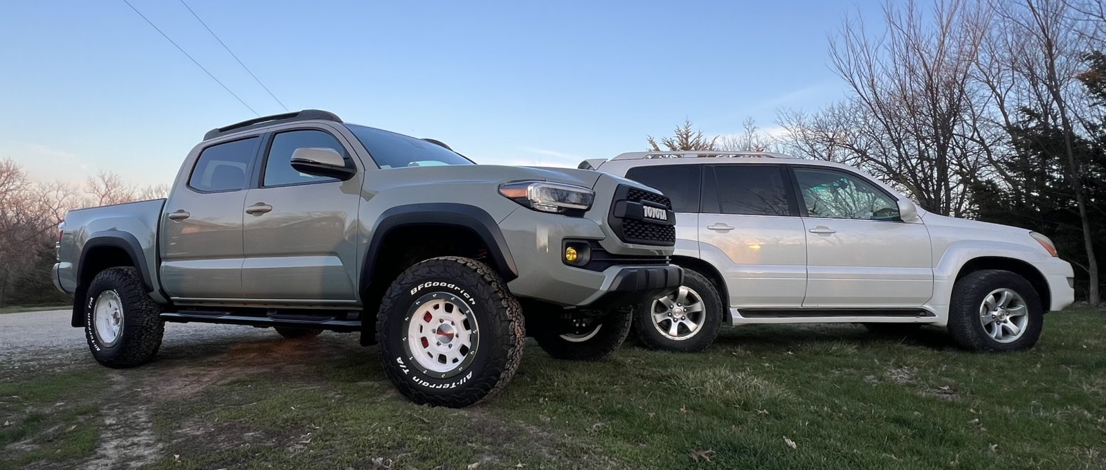

    That looks good! I dig those wheels, I might have to use this to photoshop them onto mine and see how they'd look.

    I have the same wheels on my trail edition. Do you rub at all? I've been on the fence about 285s with only about 1.5 of front lift I'm not sure if I will have fit issues.

    You should be fine for street driving, not sure about off road if you flex stuff.
    I used to run 285/75/16 g003’s on my truck with a 2” front/1” rear lift and there was no rubbing anywhere. That was also with a -10mm offset wheel so yours should fit a little better.
    That was only with on-road driving. I only had the g003’s for about a week before I went back to my old 265/75/16 tire so I never had a chance to run the 285’s offroad.
