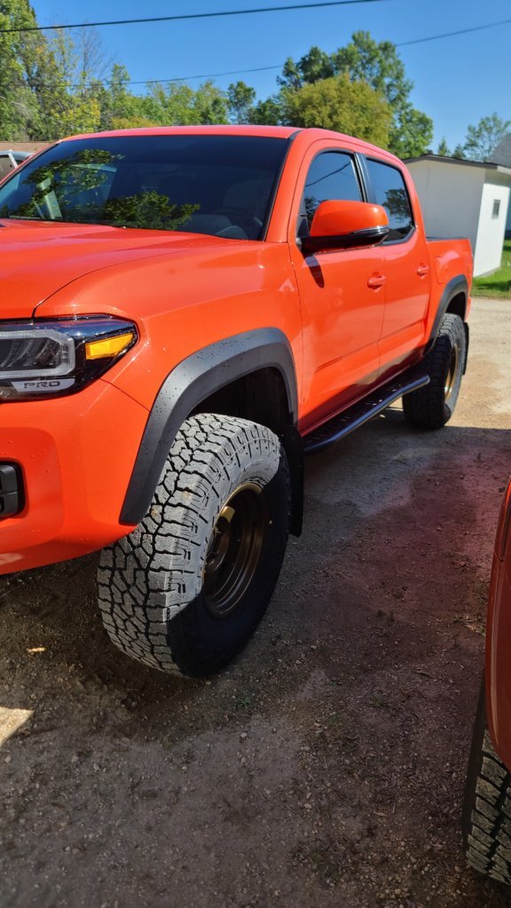

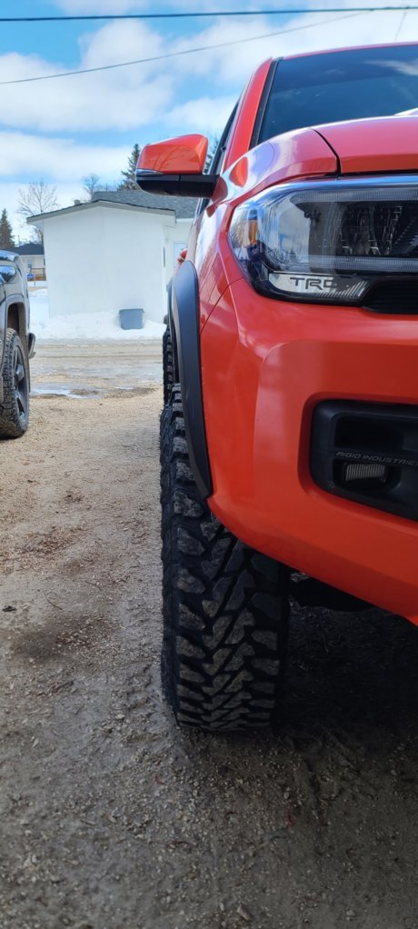

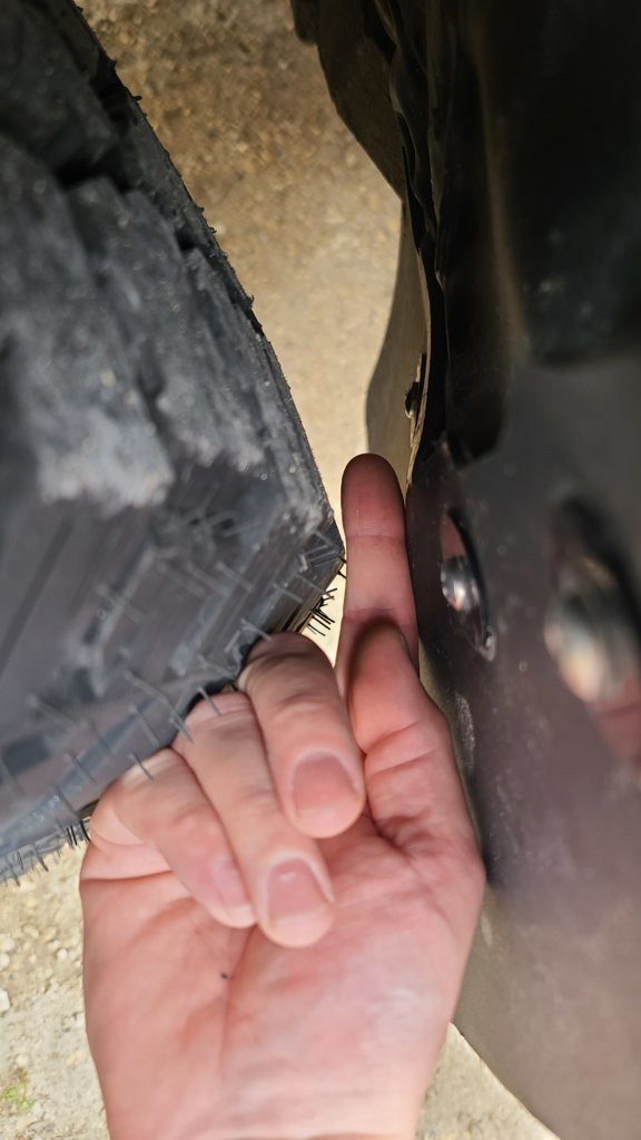

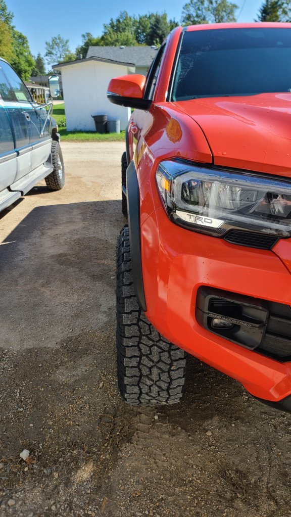

    I changed my setup recently, took off my 255/85r16 geolandar mts and put on 285/75r16 At4w. The weight is the same as my stock rims on 255s.
    I got tired of mud terrains and I didn't want to do another winter with them. I got away with it last year since it was so mild, couldn't stand the look of skinny tires. Keep in mind the g003s run half in narrower then other 255s
    My pro is stock suspension bmc pinch weld flat running custom made mudflaps that are mounted to match the clearance of the bmc. 3 degrees of caster, kp offroad alignment cams. Heated and pushed the plastic in the front out of the way. There is no rubbing anywhere, not even close. I'm running scs f5s 16x8 - 25mm 20240915_122251.jpg 20240915_122243.jpg

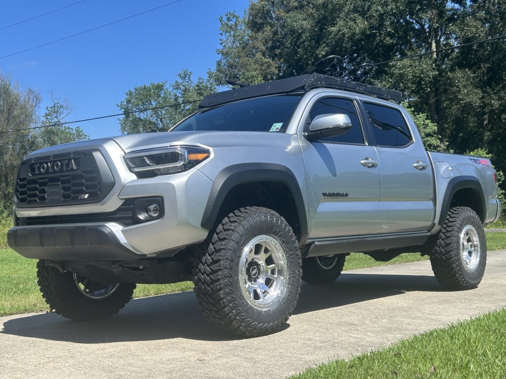

    RRW 17x9.5 -12 Offset on Maxis Buckshot MTII's
    3" Lift No CMC

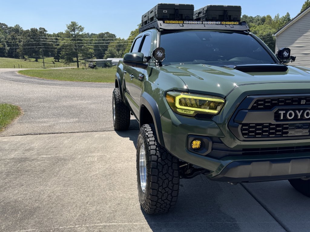

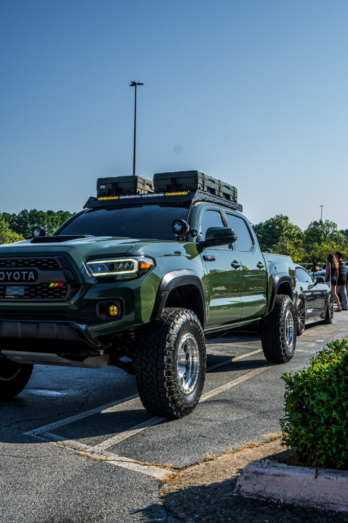

    I went with 285/75/17 and love them. I do have a CMC and 3” lift w/ 1.25 spider tracks spacers.

    Can you show a side profile? What wheels are those? Looks awesome from the front.

    No trimming of the front fender? Did the kp off road alignment tabs help with getting the 3 degrees of caster or can that be done with the stock pro setup?

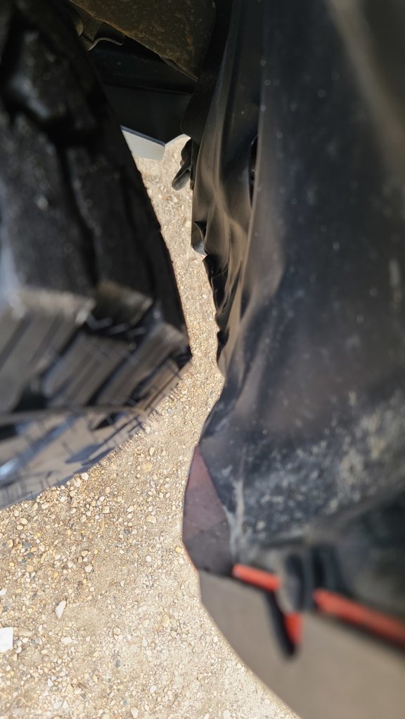

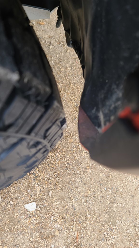

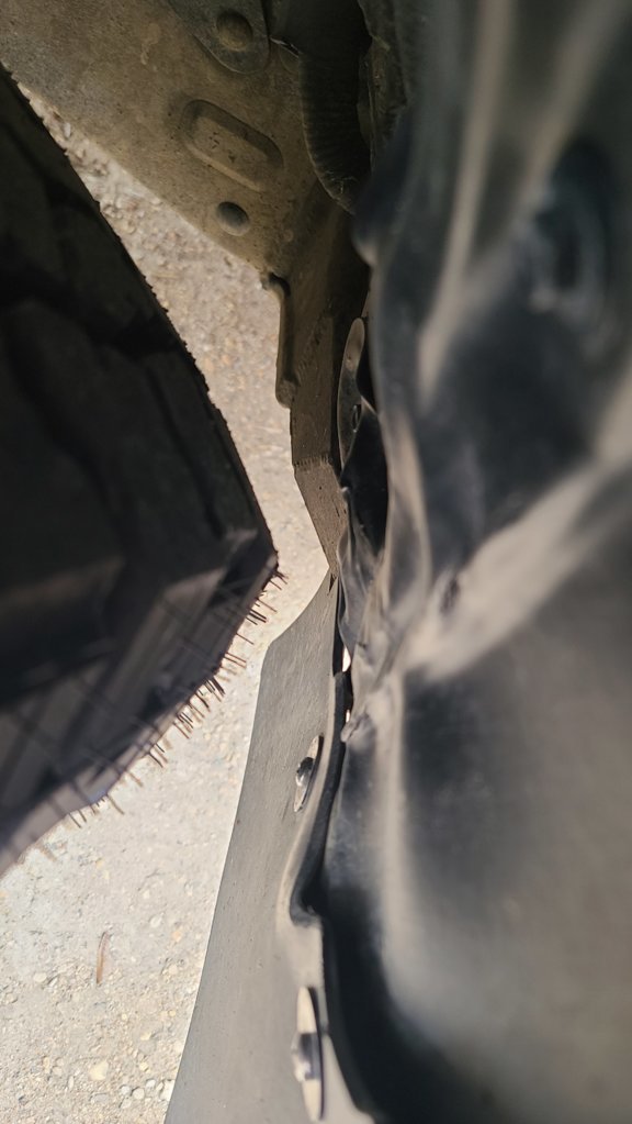

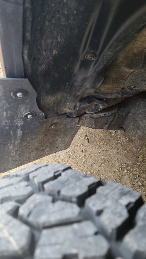

    No trimming of the main fender just a bit off the corner above the body mount to match it. I don't see why you wouldn't be able to get 3 degrees with stock cams, but I already had the kp offroad ones. My buddy has access to a hunter alignment machine that is regularly calibrated. We played around for a couple hours to get it how I wanted.

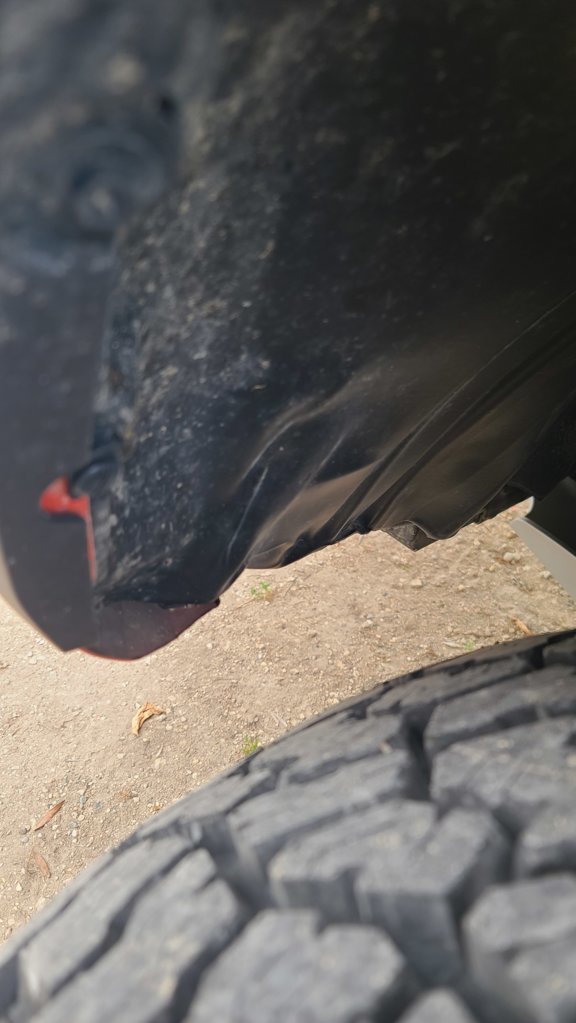

    The front edges of the bumper are trimmed a bit and the whole liner is heated and pushed back a couple inches, I could probably take the bumper edges back another inch but I don't feel the need yet. I hate viper cuts and I like having fender liners so here I am.
    Lots of people seem to think pulling 3.5 plus degrees of caster with an aftermarket uca is giving them clearance. It's just pulling the tire back towards the body mount from the uca. For correcting alignment when lifted 2 plus inches you want that but not explicitly for clearance.
    My mudflaps are molded to match the body mount and there is no exposed metal like I see alot of guys have. Just the body mount. This is as close as I can get to rubbing. 20240916_145258.jpg 20240916_145358.jpg 20240916_145446.jpg 20240916_145345.jpg 20240916_145318.jpg 20240916_145153.jpg

    What's the offset of those wheels (excluding spacers)?

    Hey man I appreciate the detailed response and pics!! I have -20 wheels with 265/75/16 tires on my pro and I’m like a few mm away from rubbing in both the front and back so I pretty much gave up the idea of ever getting 285’s without an aggressive viper cut but now thanks to you I see it’s possible. Do you think getting the wescott lift would mitigate some of the need to cut up front with the additional 1.5 inch?

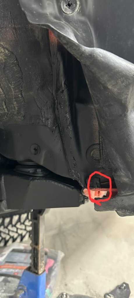

    The front was the easiest part. I took the little bolt out thats in the outside edge of the bumper holding the liner in place. Then I pulled the liner back and used one the the holes thats already in the bumper to remount the factory plastic clip/nut further back. just used an olfa knife and trimmed the edge of the bumper back until I could get the clip to fit over the existing hole thats there. Really not invasive at all, then I just heated the liner carefully with a heat gun and pushed it all back.
    I wouldn't worry too much you'll see what I'm talking about if you look under your bumper at the bolt that mounts it. I think alot of people do viper cuts that don't necessarily need to. What I did to my old colorado was very extreme compared to this. I like things to be clean and neat.
    All I really did on the rear was cut this edge at an angle as well as the bottom of the plastic flare to match. Removed this plastic nutsert (the angled cut through the flare and metal goes right through the middle of the hole the clip was in) drilled a hole behind it to mount the L bracket for my mudflaps, and bolted it back together with a stainless bolt. Then heated everything to form and match my bmc. I didn't cut any of the wheel well liner, it and the mudflap both go over top of the metal I cut. Which was painted then coated in cosmoline.
    The alignment gave me at least half an inch more clearance at the rear of the front tire. I could fit a bigger tire then a 285, but I have 0 interest in 35s on this truck. Screenshot_20240917_201221_Gallery.jpg

    They are -12/4.50"
