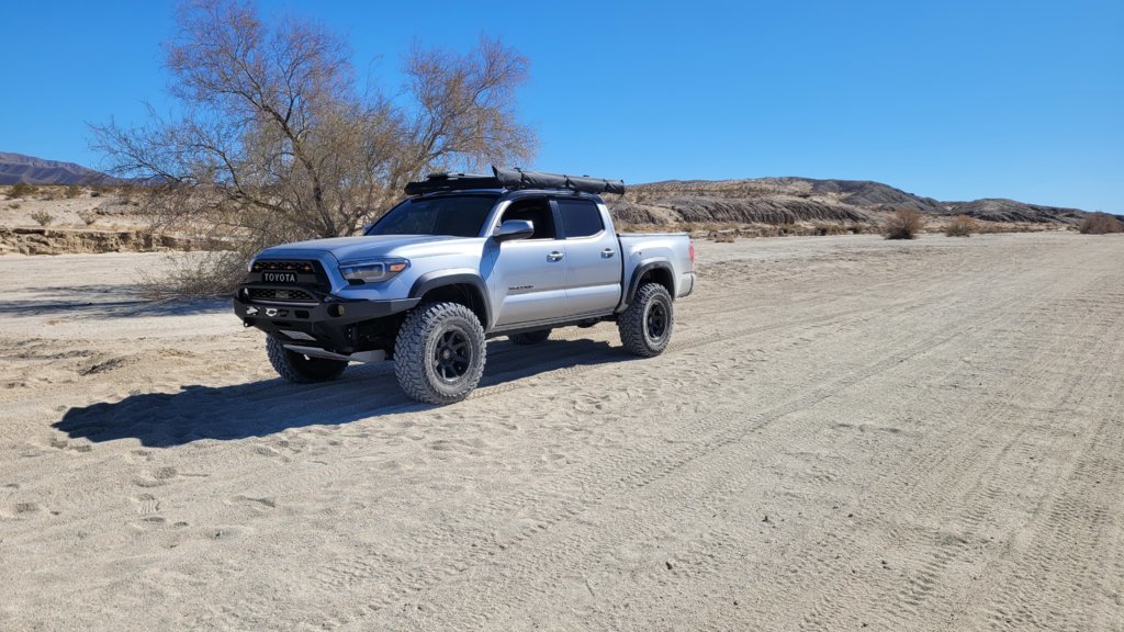

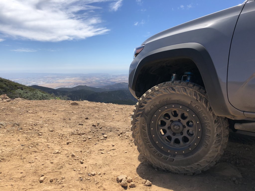

    Icon rebound zero offset and yoko g003 285 70 17 load e . Bilstein 6112 /5160 .

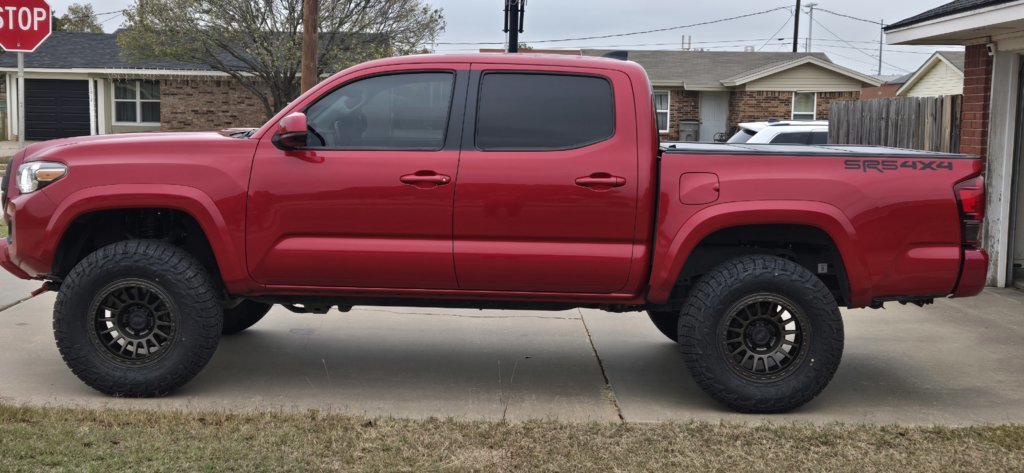

    Rrw wheels -12 offset. Falken wildpeak at4w 285 70 17

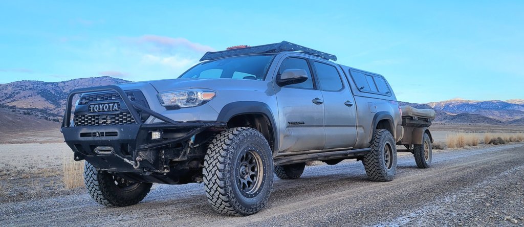

    Awesome build!!!

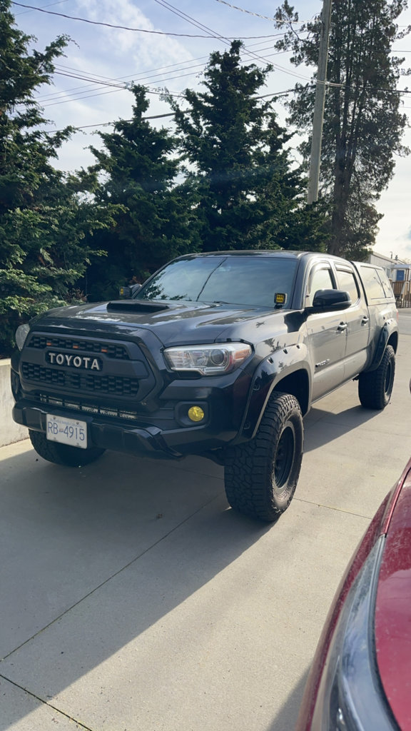

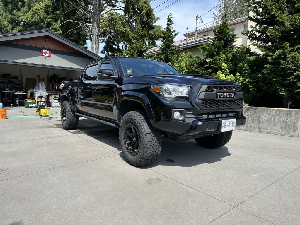

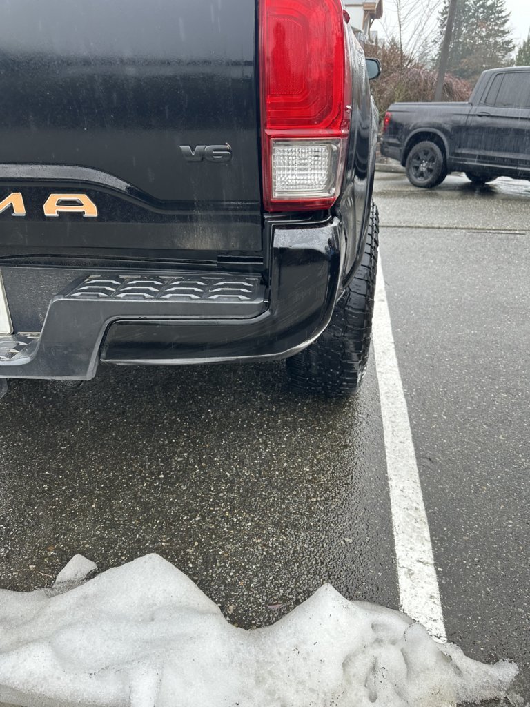

    Bilstein 5100 struts and shocks, SCS RAY 10 17x8.5 -10 offset and 285/70/17 falken AT3w. They sit nearly flush with 2” flares but would be very aggressive without. Rubbed very badly on the front fender liners before I cut them but surprisingly no rubbing on the uncut cab mount

    Previous setup was fuel 17x9 0 offset which had about an inch and a bit of poke on the stock TRD sport flares

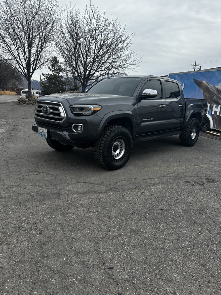

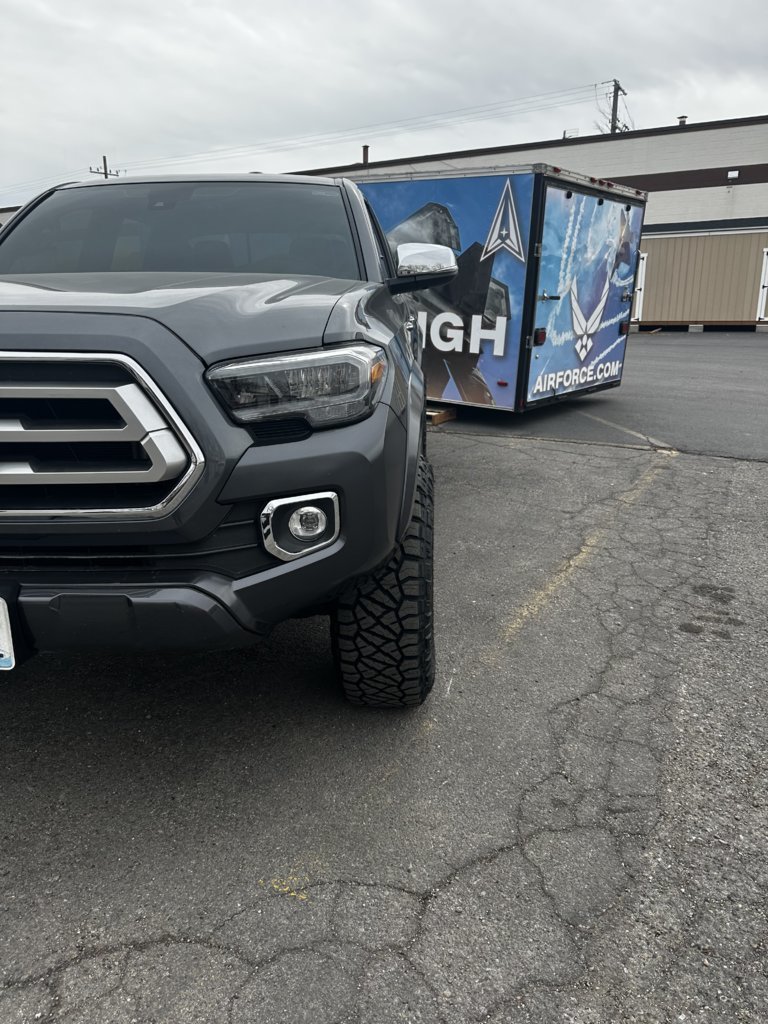

    Giving the limited trim level some love. What I've done; Bilstein 6112/5160, Bilstein UCA, 1.5 Icon AAL, KMC IMS 17x8.5 -10 offset, Nitto Ridge Grappler 285/70/17 , BMC and some plastic trimming to fit this set up!
