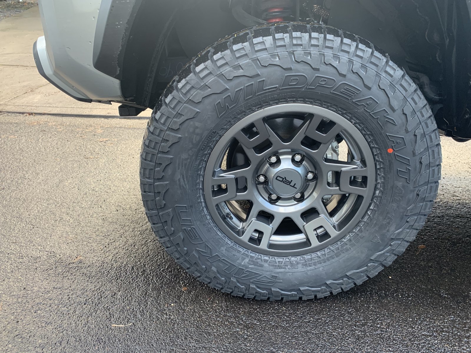

    285/75r17 Falken Wildpeak at3w on 17x8.5 Icon rebounds.
    Juspat2, RCrumb, Dude Labosky and 2 others like this.

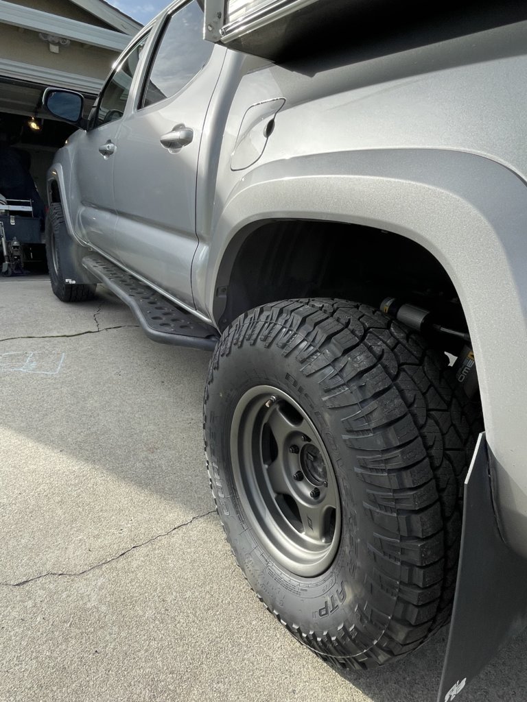

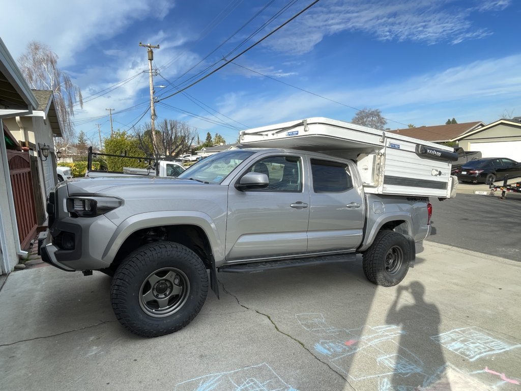

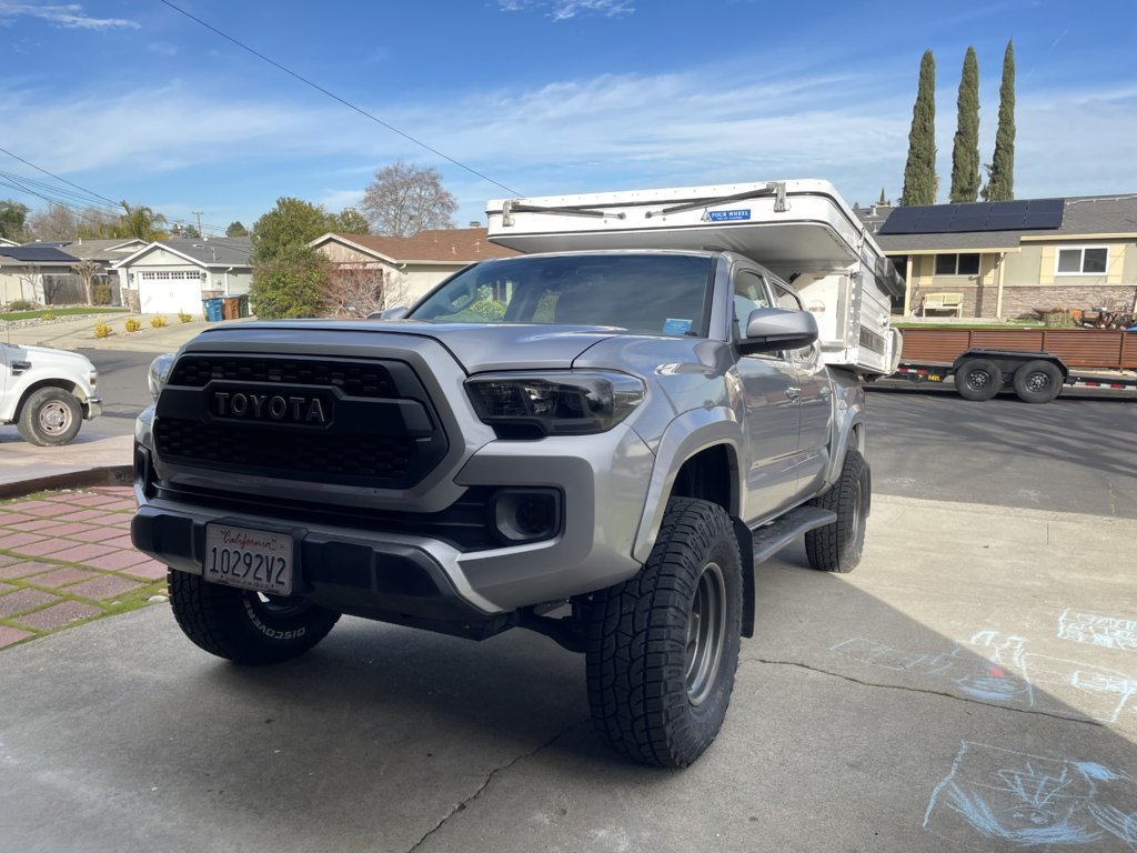

    Switched from Cooper st maxx to the Cooper atp ii. I really like them so far. 285/75r15 IMG_0830.jpg IMG_0827.jpg IMG_0833.jpg

    The weight savings are great but man, there is just something I love about those nomad wheels. Great looking rig either way.

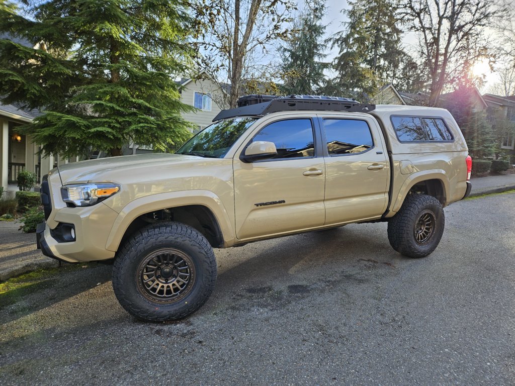

    285/70r17 AT4W on RRW monoforged wheels
