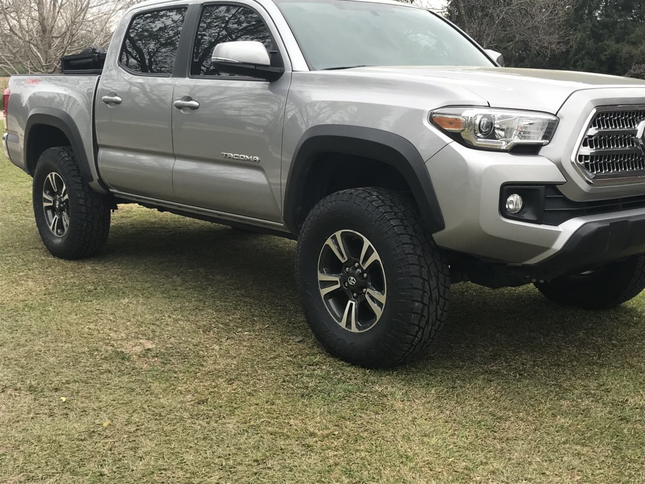

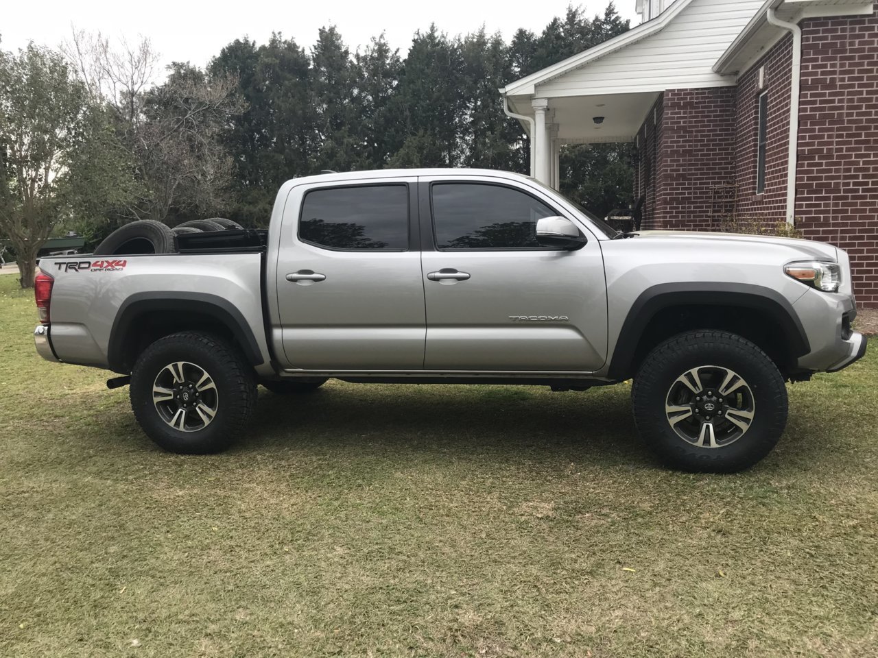

    Bilstein 5100s, 285/70/17 Toyo AT2s
    23E78E38-01D1-4F6B-856B-22078BCF8D7F.jpg Bilstein 5100s 285/70/17 Toyo AT2B3E53BCE-2C47-43F0-8CD2-9D3460F3D3D4.jpg

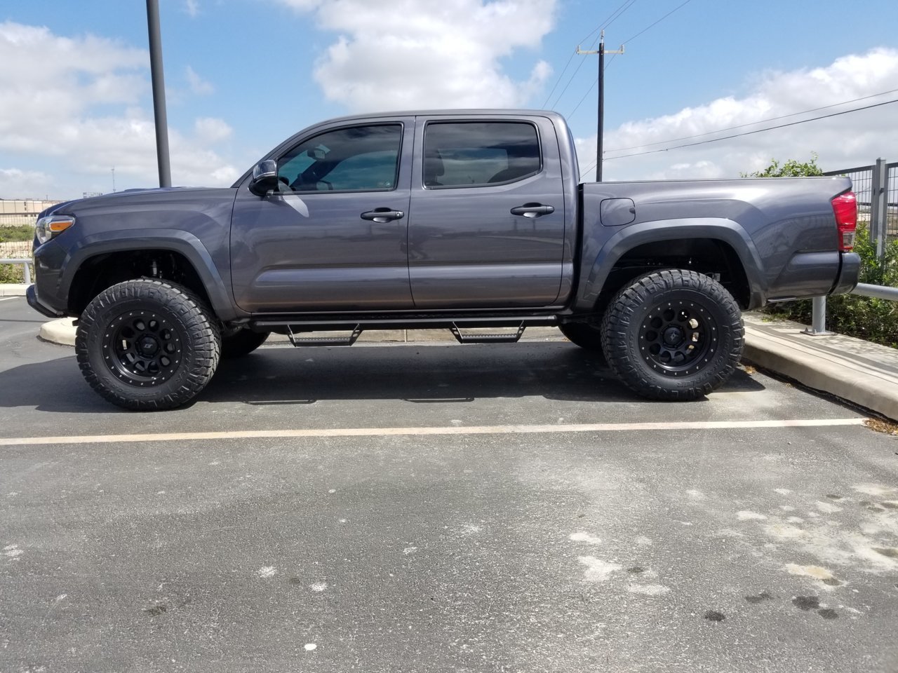

    Icon Stage 4, Icon Alpha wheels, Ko2 285/70/17

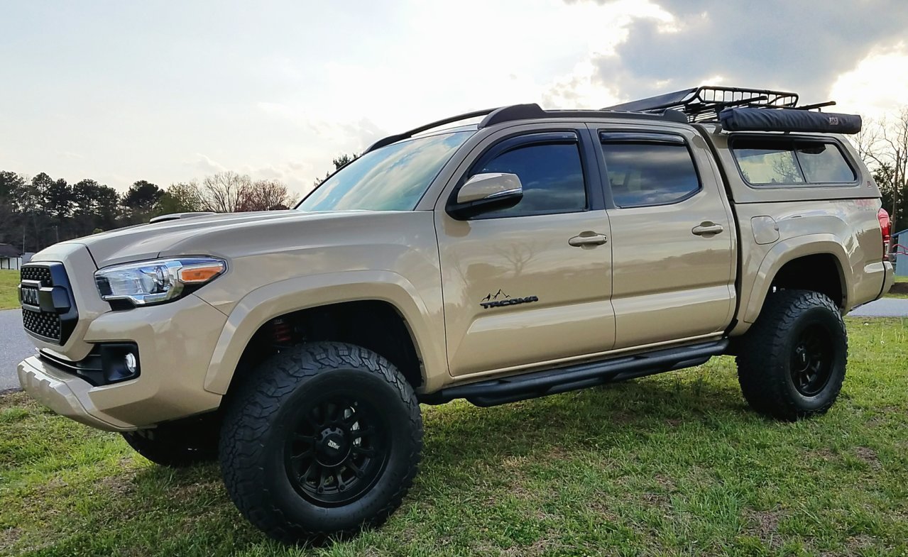

    OME suspension 285/70/17 WildpeaksIMG_20180113_143658.jpg

    whats your lift setup? im looking to fit those same wheels and tires

    I'm on full OME suspension. OME 888 springs and medium duty Dakar Leafs. Tires did rub alittle so I had to do a minor trim job on the fenders.

    That almost exact setup going on my truck next week , it sitting in the garage ,any other issues ?

    No issues at all, rides quality is SOOO much better than oem. I then installed icon UCAs after a couple months with the OMEs and it rides even better now.

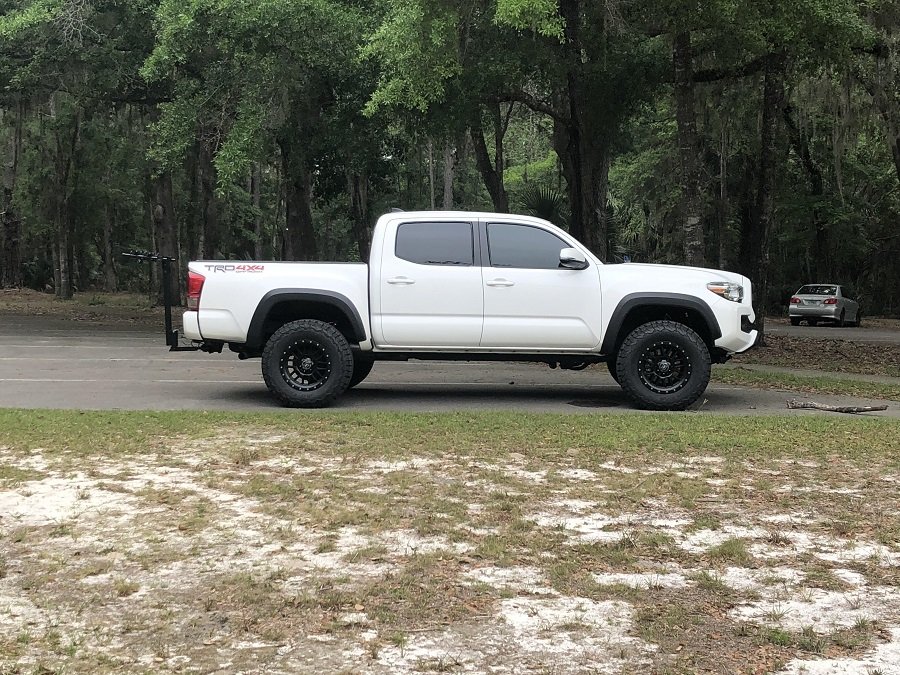

    285-70-17 KO2 Toytec Boss lift. -12 offset
    No rubbing but did remove the air dam

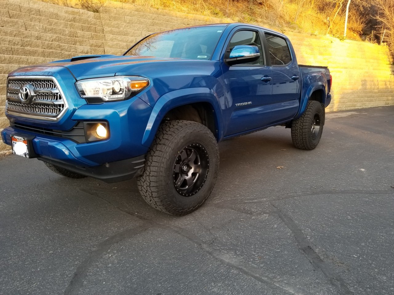

    Fabtech 3" Uniball System w/Front Dirt Logic Adjustable 2.5 Coilovers & Rear Dirt Logic 2.25 Resi-Shocks. 285/70/17 Nitto Ridge Grappler Load C wrapped on 17x8.5 Jet Black SCS Ray 10's....
    Had to get a CMC done, the 285's were rubbing at full lock:mad: I can make full U-Turns now:D:D

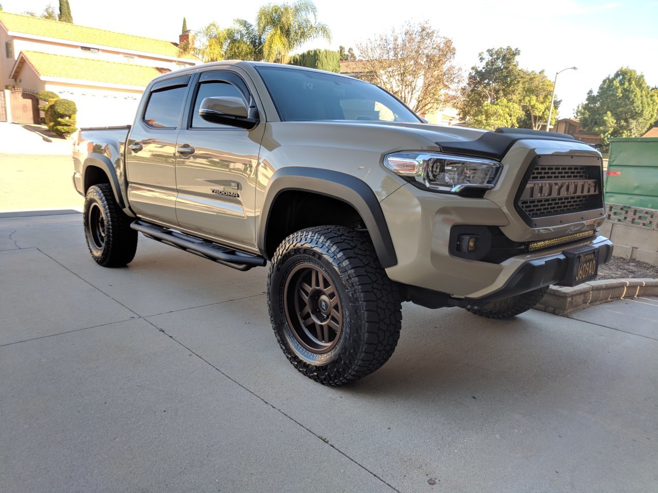

    That was before bumper and winch, so I believe it was ome 888/bilstein up front with custom uca's, and Dakar leaf packs w/overload removed and bilstein 5100's.
