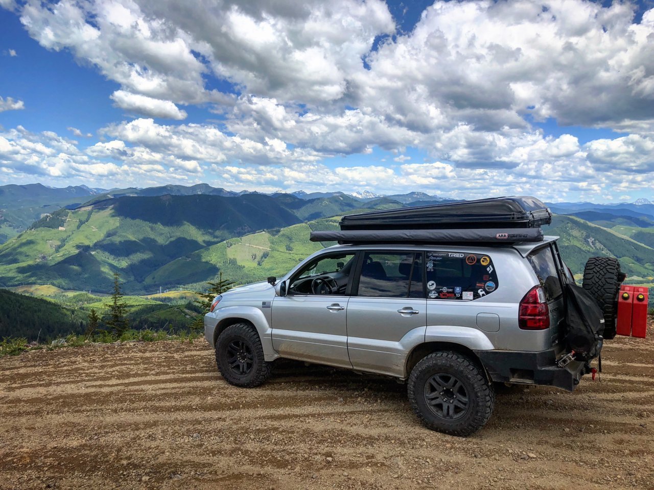

    Always happy to post pictures of my truck. 285/70/17 on Tundra/Sequoia rims

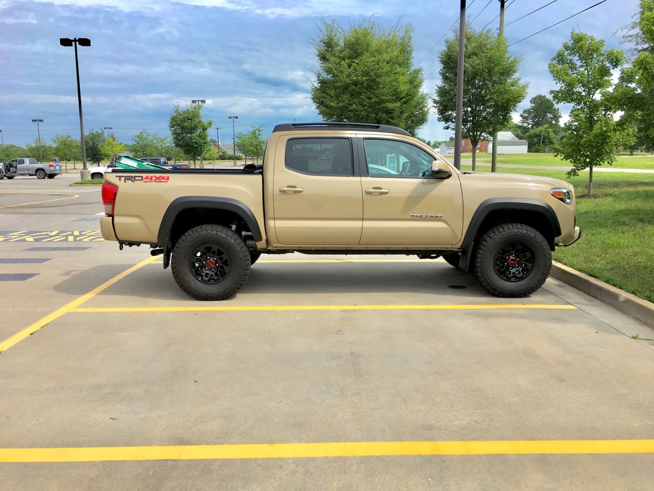

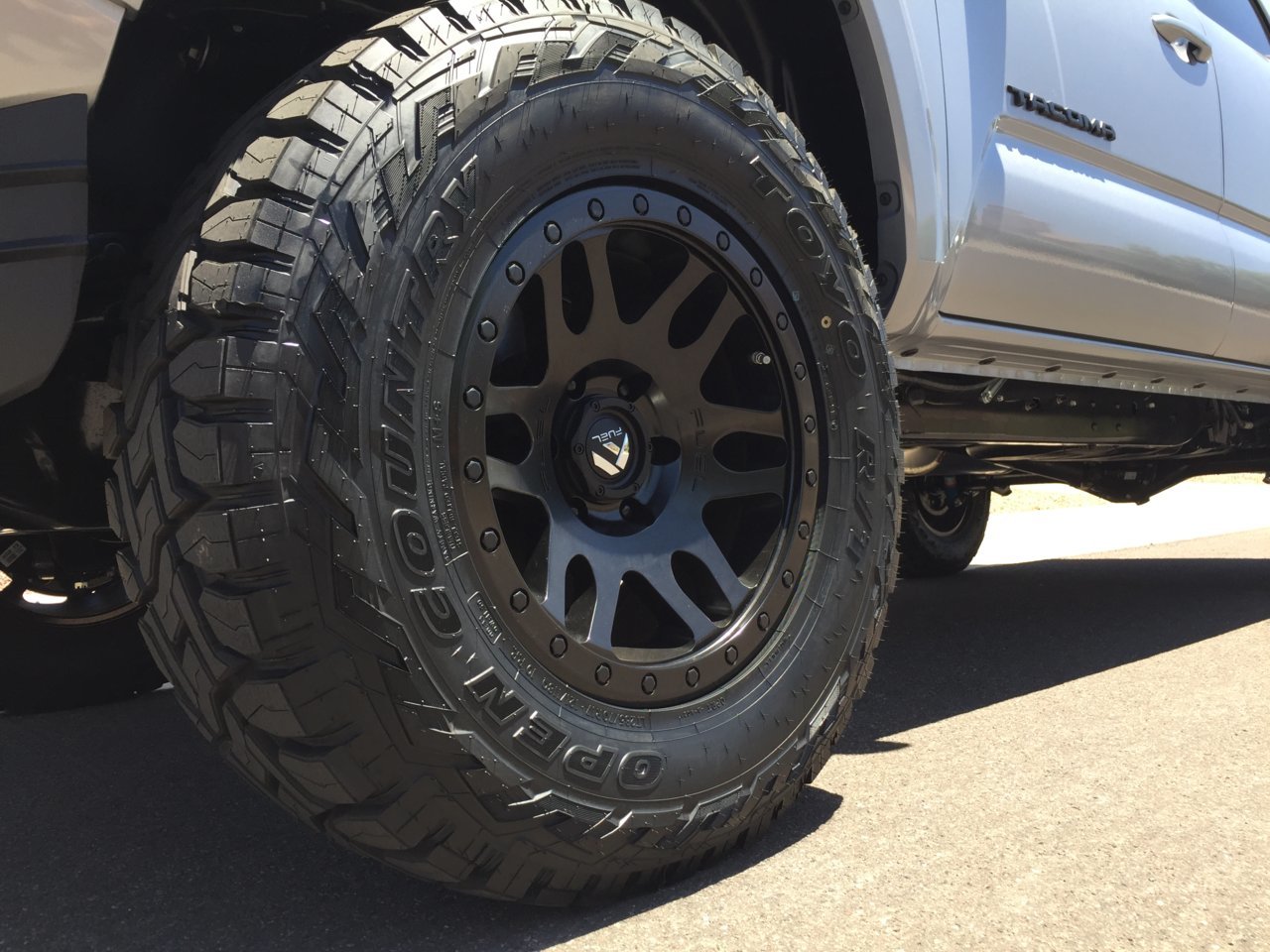

    285/70/17
    Toyo Open Country R/Ts
    Fuel Recoil Wheels

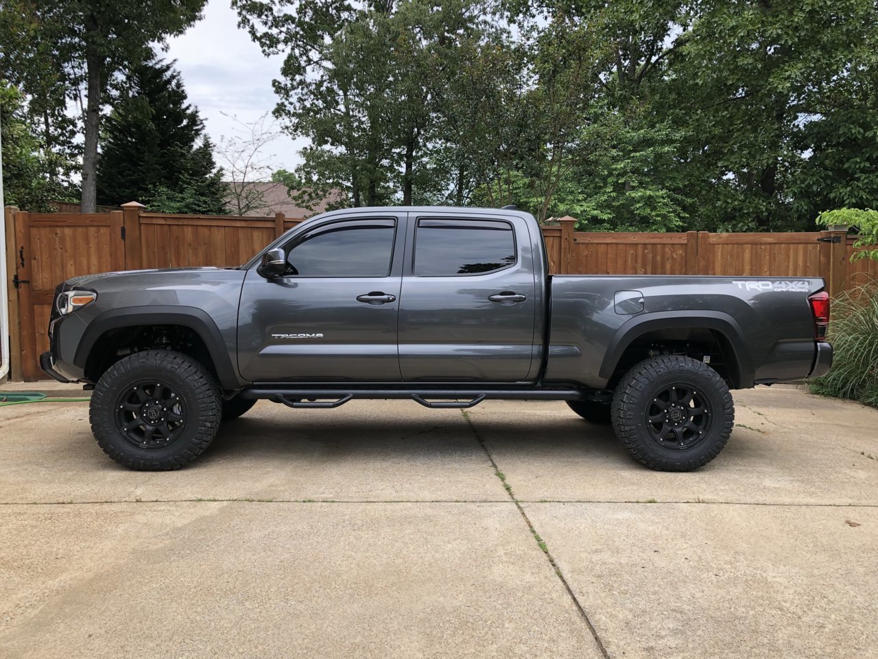

    OME BP-51 Nitto 285's C4 Low Pro Bumper Mobtown Skids
    From stock to the 285’s. I should add that I drive in s mode and don’t let the truck have 6th gear so my mpg’s were already off from stock. I hate the way the truck hunts for the right gear in drive.

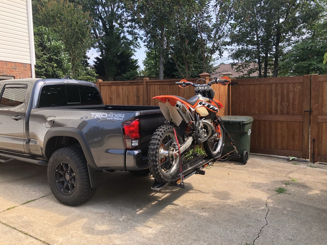

    If you plan to add a shell or regularly haul heavy items it keeps the rear end from sagging. I went that route cause I haul my dirt bike on a hitch mount.

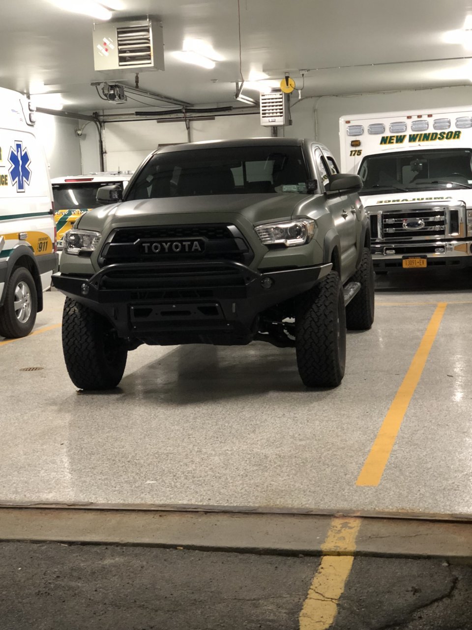

    How do you like your lift? Ive been thinking about going same route. Also tell me about yoiy paint job. How much did it cost?
  9. Jul 10, 2018 at 6:18 PM
    #749
    Beef Nachos
    Beef Nachos Here for a good time, not a long time
    Apr 6, 2017
    #215592
    8,093
    Dallas/Ft. Worth
    2017 SR5 DCSB 4x4
    Looks like a wrap. You can bet on $4-5k for decent materials and labor

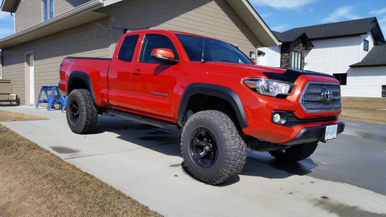

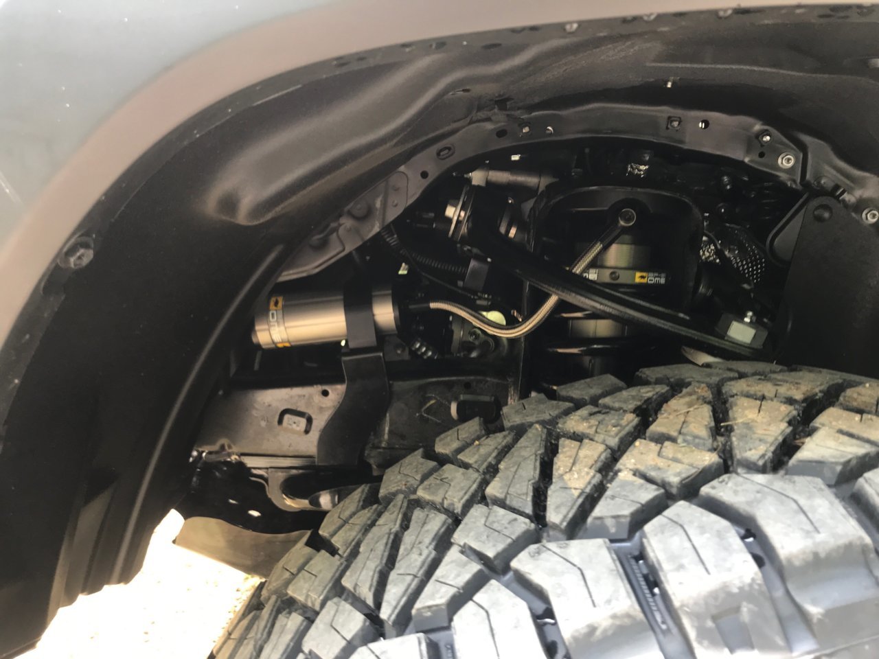

    Finished my lift and installed my wheels and tires this weekend. 285/70/17 KOs on Fx Pro wheels, Bilstein 5100s set at third notch, 1” body lift and CMC. No rubbing as I checked by cycling the front suspension without the shock installed. Total lift is 2.5” front and 1” rear. Truck is level to maybe .5 low in the rear. I came from a Rock Crawling Offroad background so a truck with a rack seems odd to me.
