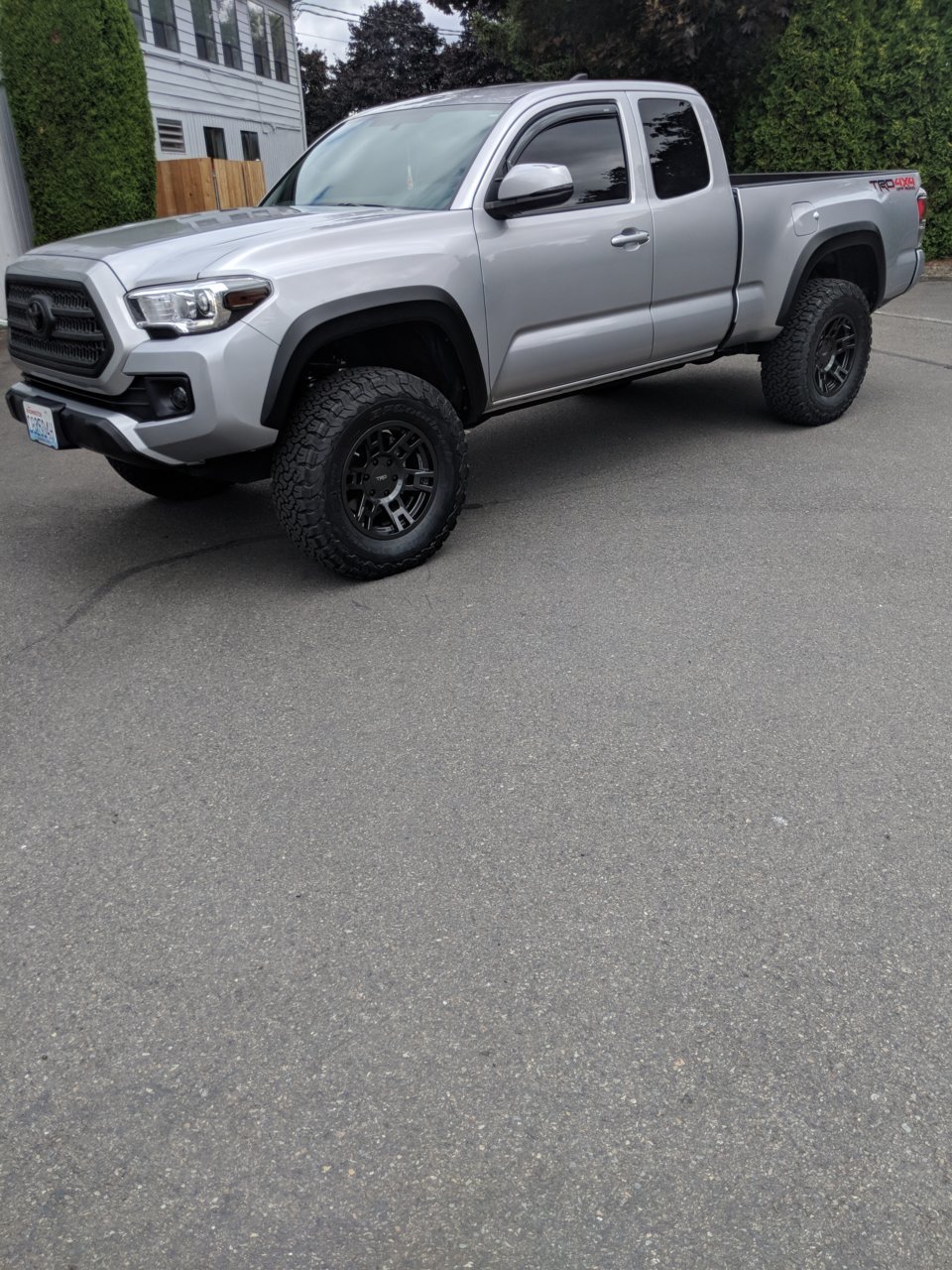

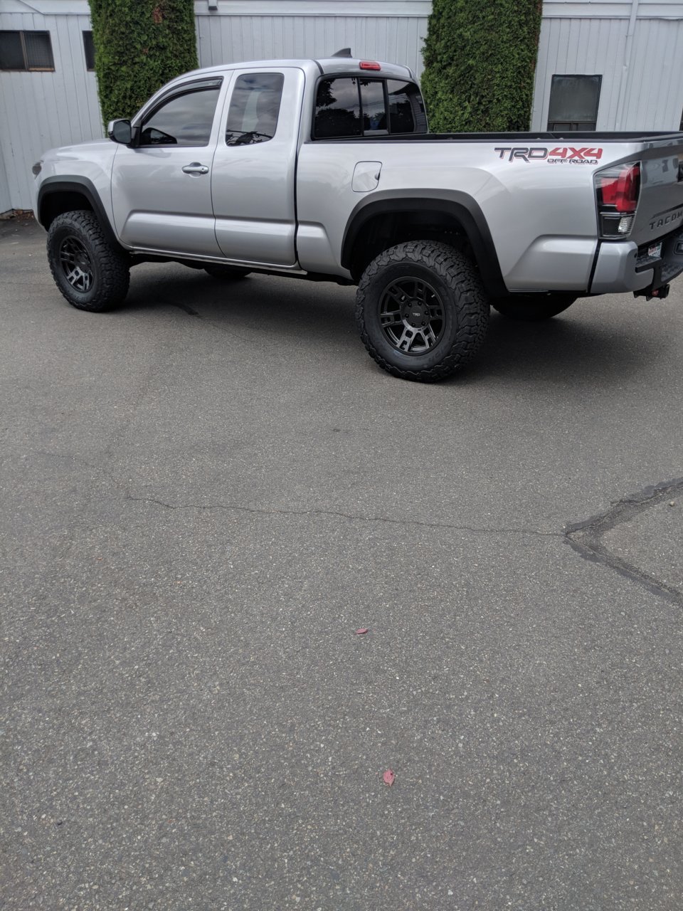

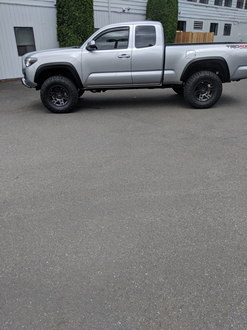

    OvTuned
    285 70 17
    Roddy13, SilverII and Dee1seven like this.
