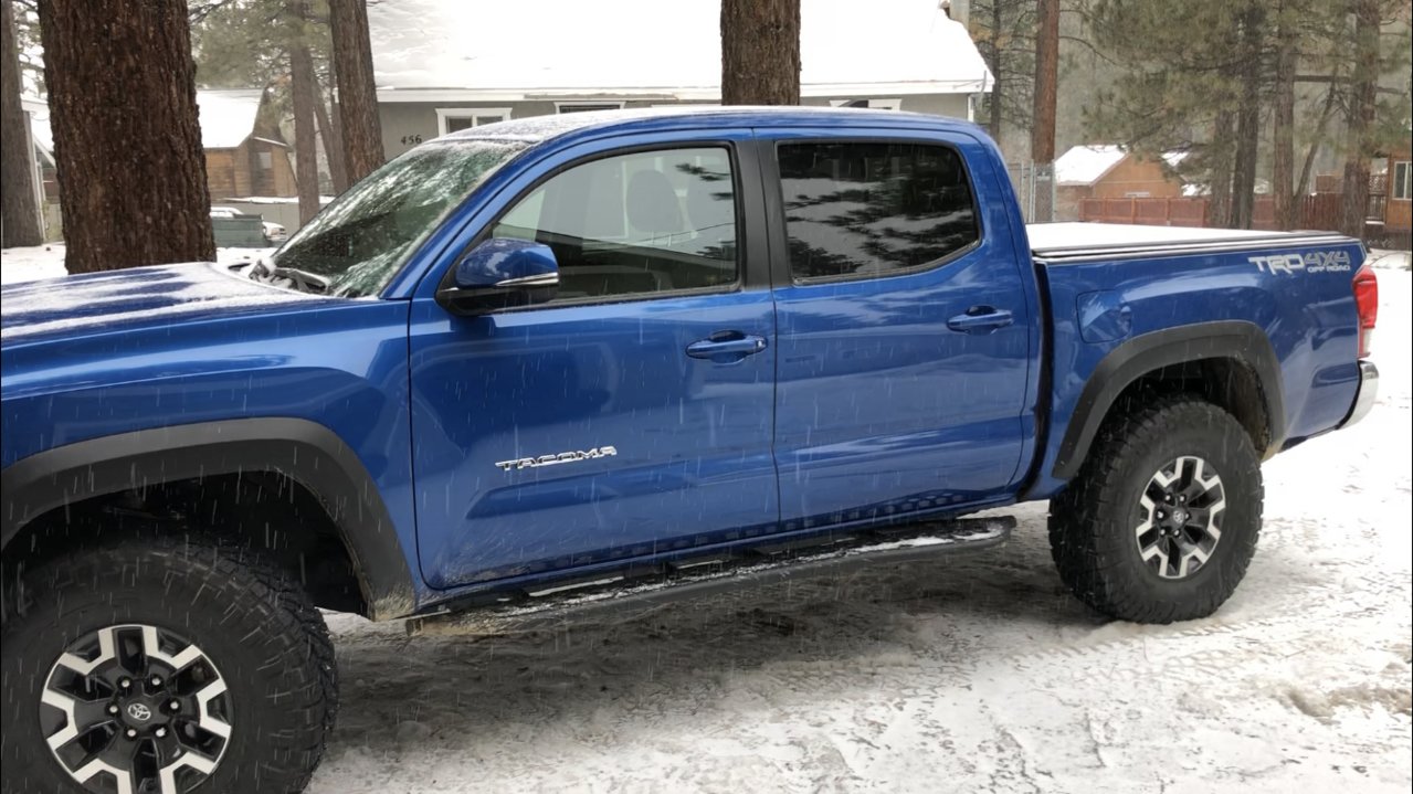

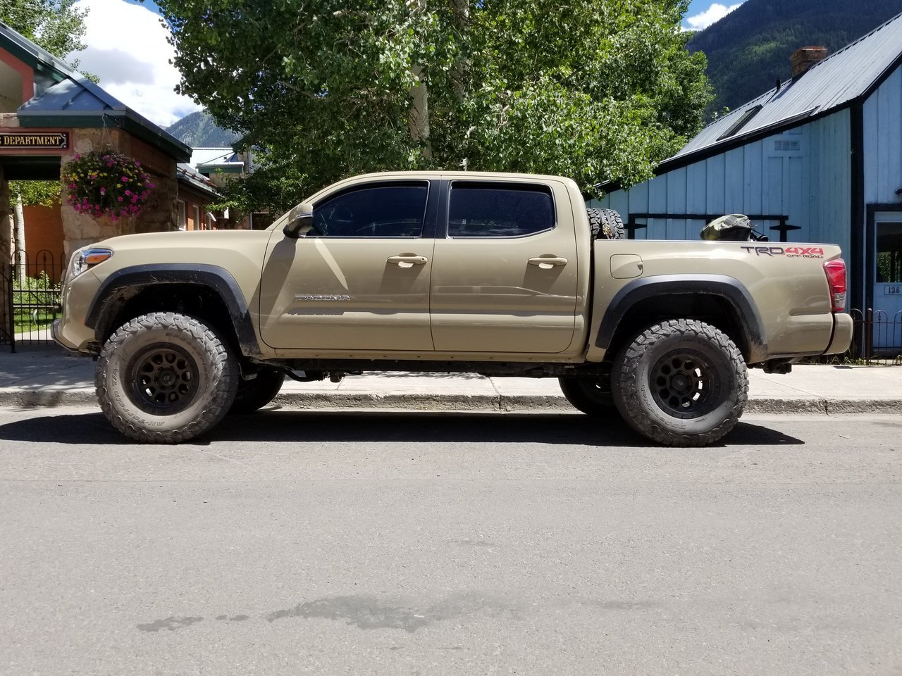

    Ive searched these forums high and low before making a post here,I was trying to not be that guy but I cant find anything or anyone with the same setup I have. Im Getting a set of 5-285/70/17s ATKo2s practically for free (from a friend). Im running 5100s all around, fronts are set too the 3rd notch (.085 i think?) with TRD Pro 4 runner wheels. Anyone running this same set up or know anyone who is or can point me in the rite direction or thread? Thanks in advance.

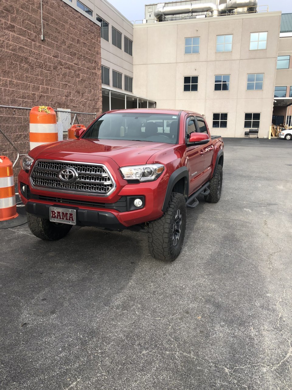

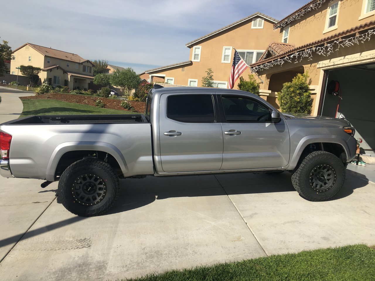

    5100s on highest notch, stock sport wheels. No CMC, stock UCA. 285/70R17 Falken wildpeak. 1.25” spidertrax. 42A555ED-081F-45A3-990F-6B88617D5387.jpg No rub. I must be lucky from what I read about the rubbing.

    whats done on the rear?

    5100s in the rear, 1" block for the springs and the 1.25" spidertrax

    Aftermarket UCA's?

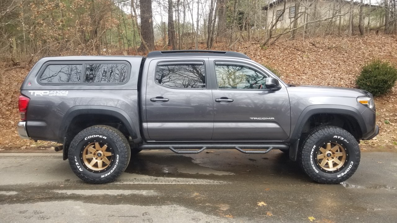

    OME 888's, Dakar pack, SPA UCA's, SCS SR8, Cooper AT3 xlt 285/70r17

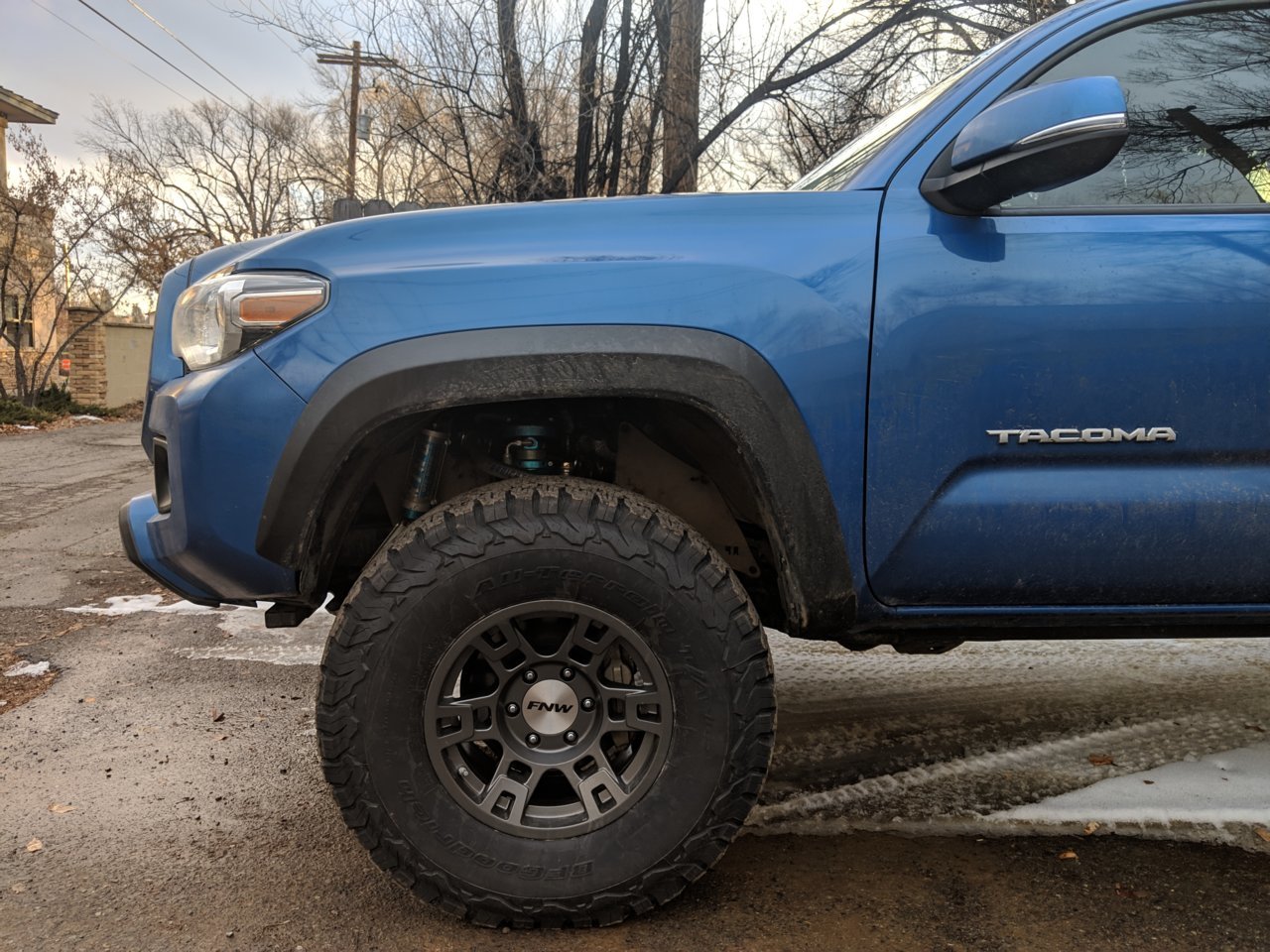

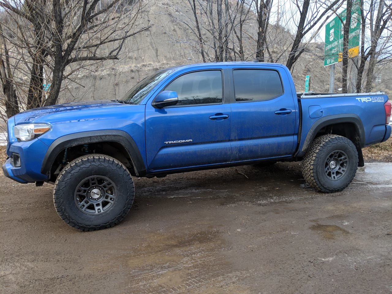

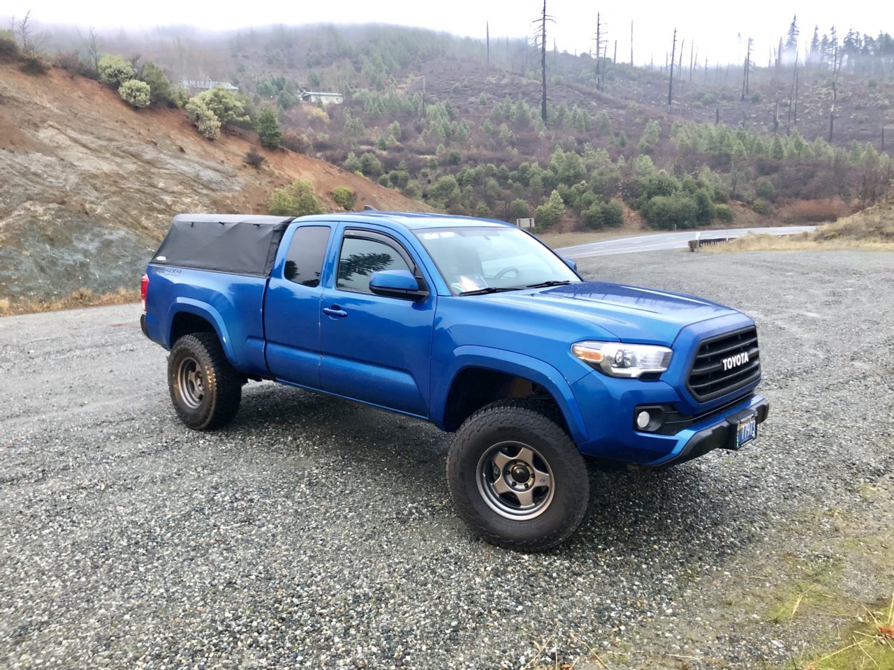

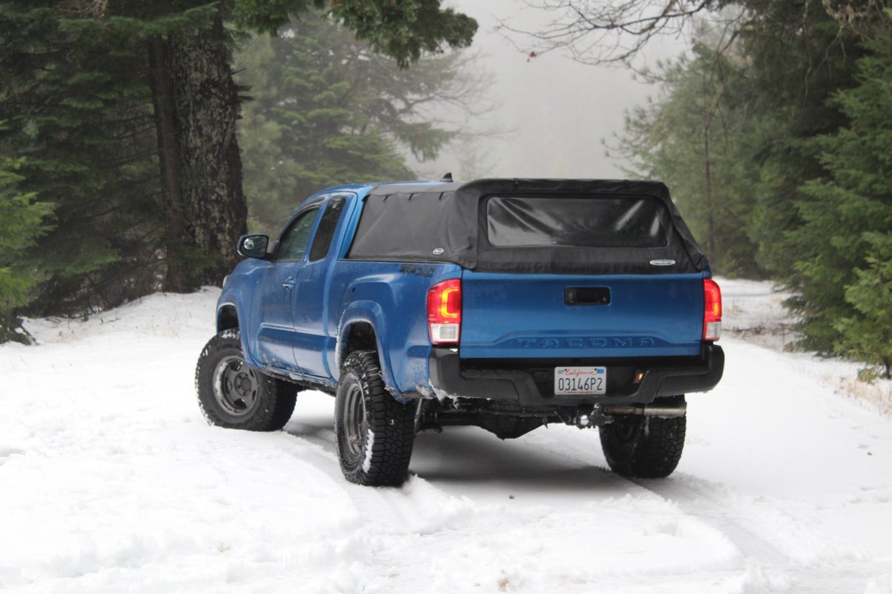

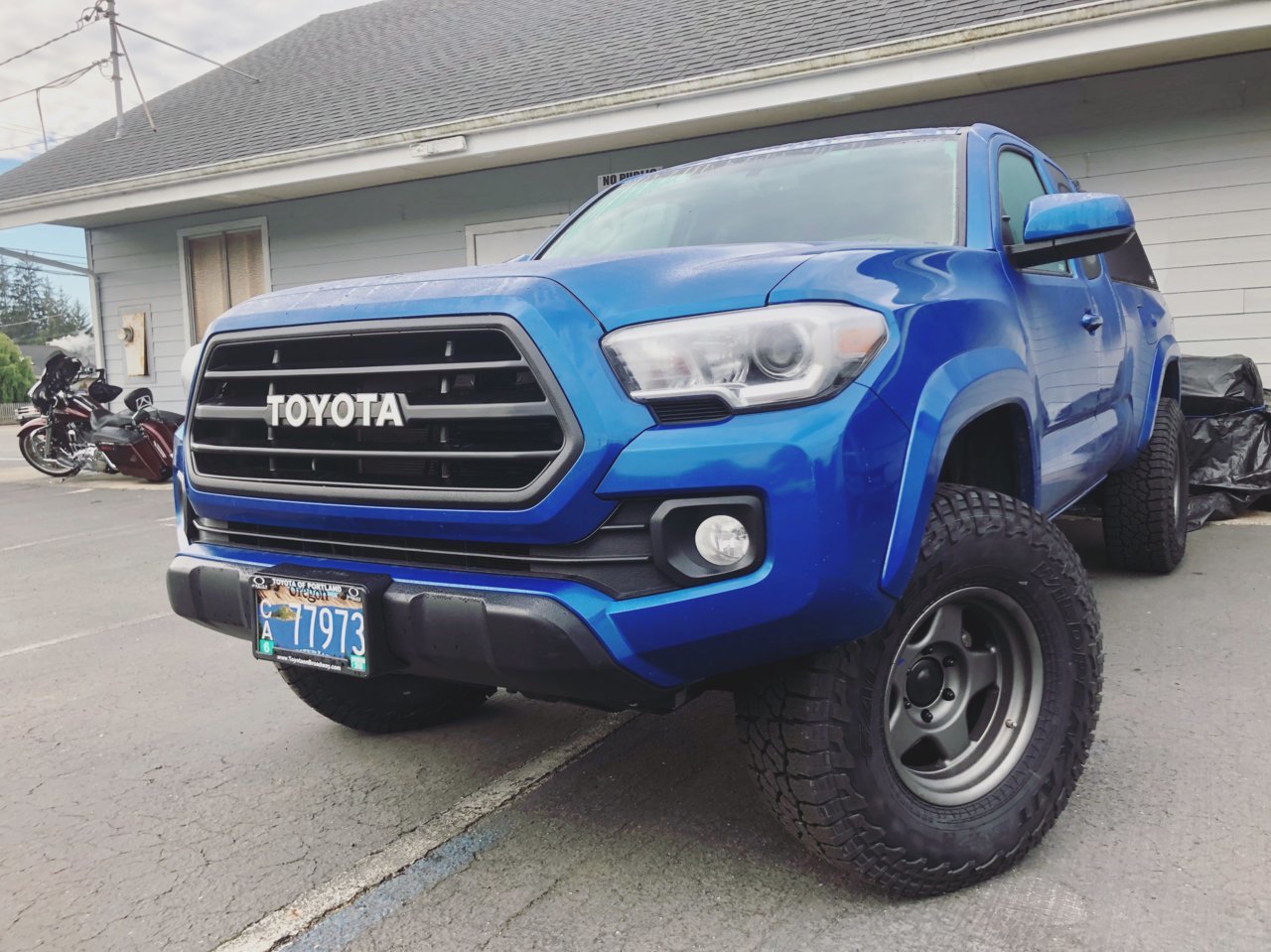

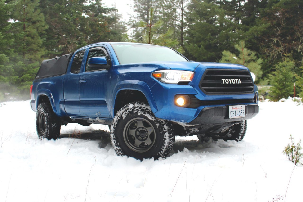

    Got my 16x8 light matte gunmetal Fn Fx Pro wheels on with 285/75/16 tires. They look awesome in every way. I have King OEM suspension with Deaver leafs that add about 2.2 inches in the back and front, rake of 1 1/4 inches. The rear wheels have no clearance problems, the front I got aligned to +3.0 caster and they don't rub at all in normal driving or straight full compression, but do just a little when turned hard and fully compressed on the cab mount, not enough to cause a problem.

    Those wheels and soft cover look great together on blue. Nice set up.

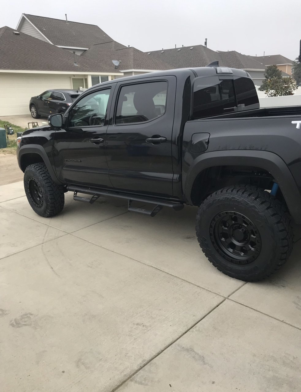

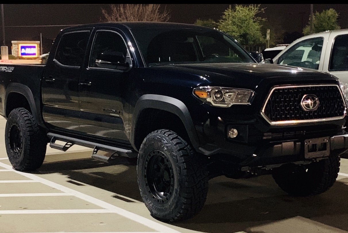

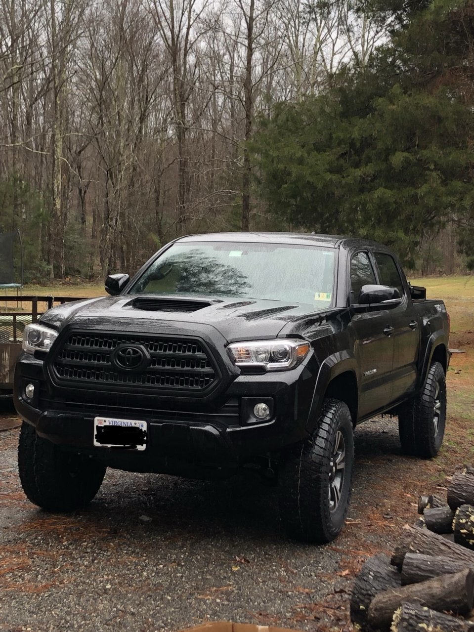

    C9D88BDC-165B-40D8-B5E6-D28CF29B1F08.jpg AF2B29D3-17EA-48E1-B42A-D56E1993126E.jpg 3/2" lift
    17x9 ATX201 Wheels
    Toyo RT 285/70/17

    Looks great. Are those the 17’s? Looks like -35 offset? How much chopping did you have to do? What lift are you running? Any rubbing?

    Was this photo taken in Crested Butte? If so, I remember seeing this truck in person. It was the reason I went home that following week and bought a 3rd gen.

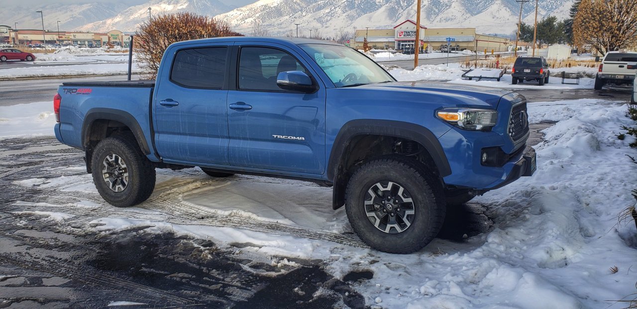

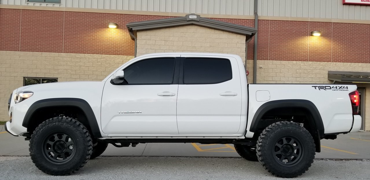

    285 75 16 on factory wheels and control arms. Alignment in the green.
    Added 1.25 spacers after this photo. Minor rubbing solved easily
