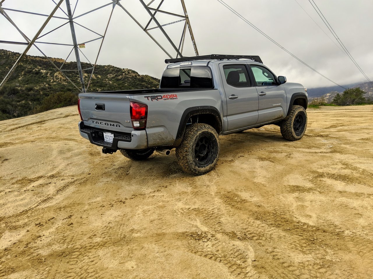

    2885 springs / 5100s / rear 1" blocks / 16x8" 0 offset XD Turbines / 285/75R16 Cooper Discoverer ATR XLT
    Stock UCAs , Camber in stock range ~ 2 degrees on each side
    No rubbing to note at all, I've bounced it around and haven't rubbed anything yet.

    Looks good! Those are probably the tires I'm going to go with next.

    Pretty sure you just changed my decision on the wheels I was about to buy. Are you happy with these? Anymore pics?

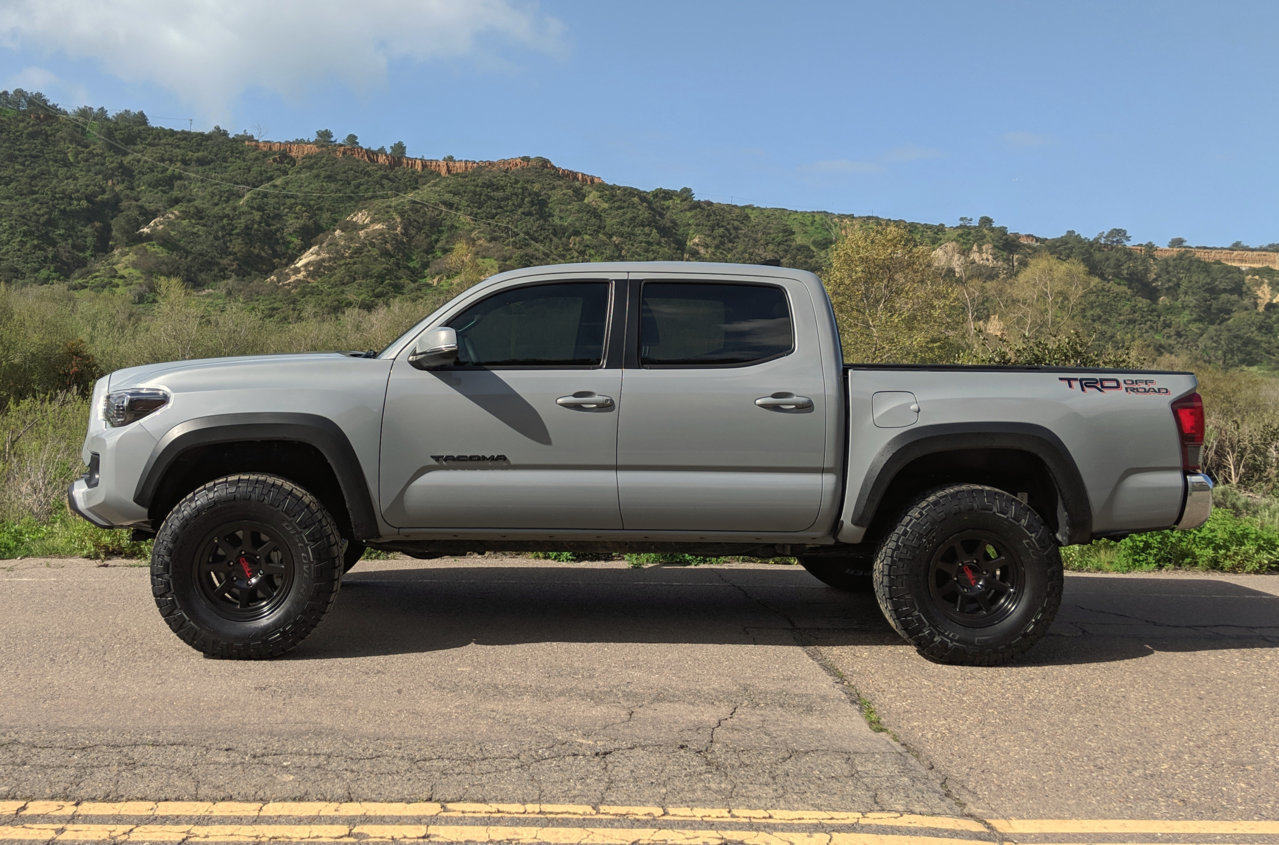

    Fox 2.0 Coil over suspension lift add a leaf in rear SCS Ray10 Matte Gunmetal 17x9 -38 off set Nitto Ridge Grapplers 285/70r17 KB Voodoo bed rack All pro APEX sliders Rigid industries fog lights with brackets Cali raised led ditch pods with low profile mounts
    285/70r17

    Truck looks perfect. What offset are these rims? -38 or -10?

    Any rubbing? Did you have to do any trimming?

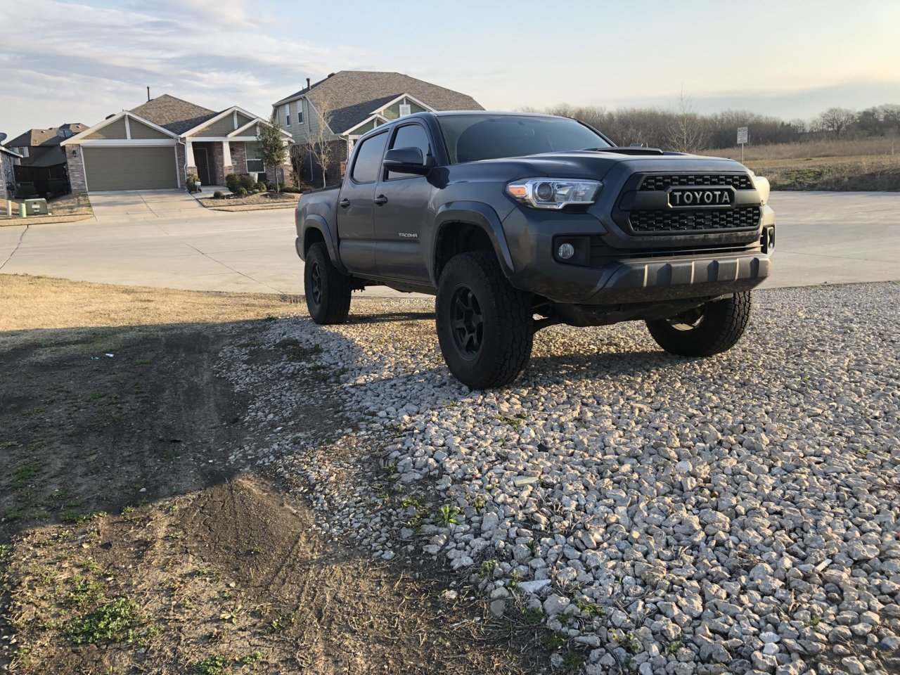

    Icon stage 3 tubular 285/70/17 Toyo ATII
    285/70/17

    Are you on stock suspension?

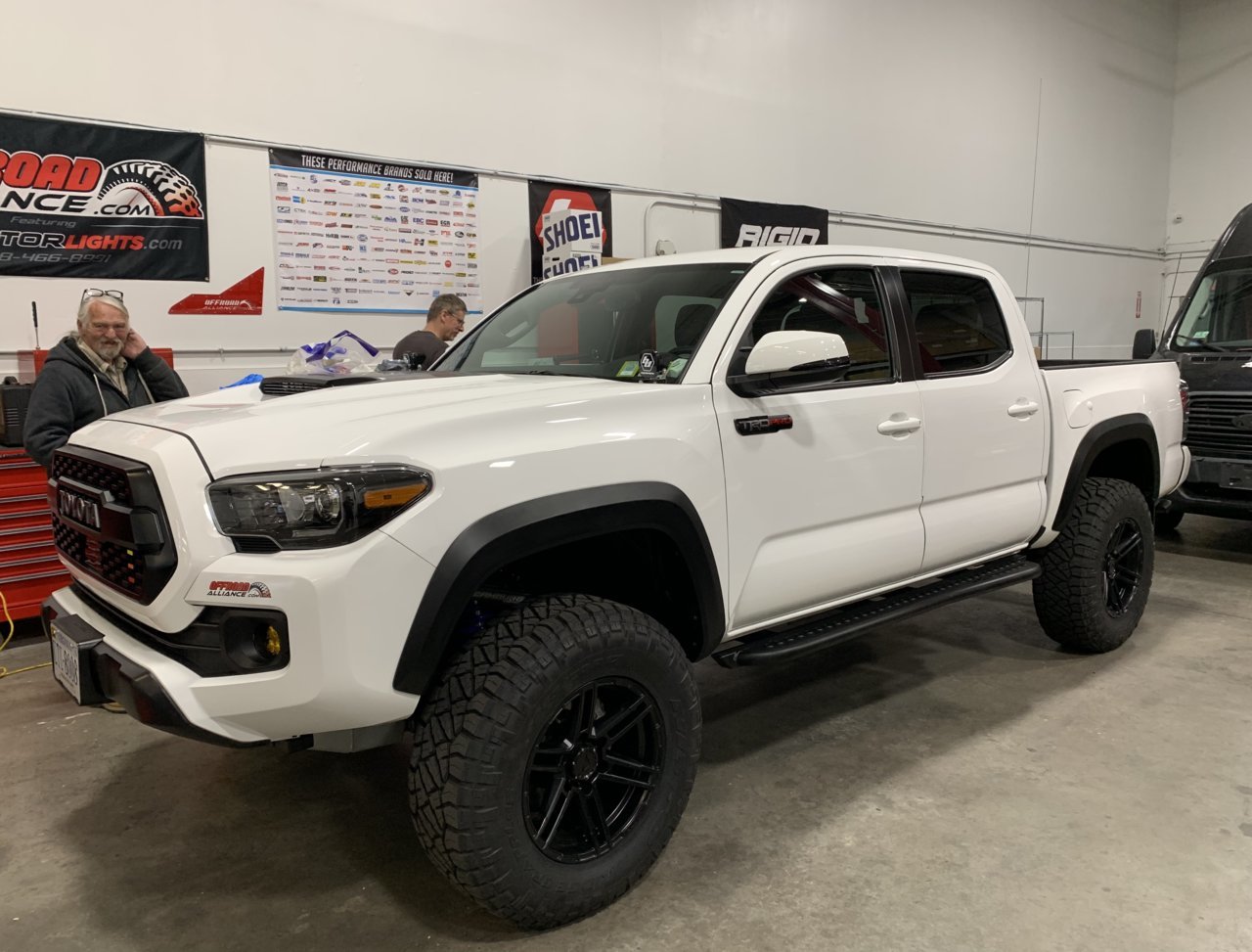

    285-70-17 Ridge Grapplers on Venomrex 602 series wheels. Was rubbing so did a CMC and full pinch weld mod.

    I was pretty worried initially about the ride and going to load range E tires for the 285/75R16s, but honestly, at 30psi, they ride just as good or close to the stock LT tires.

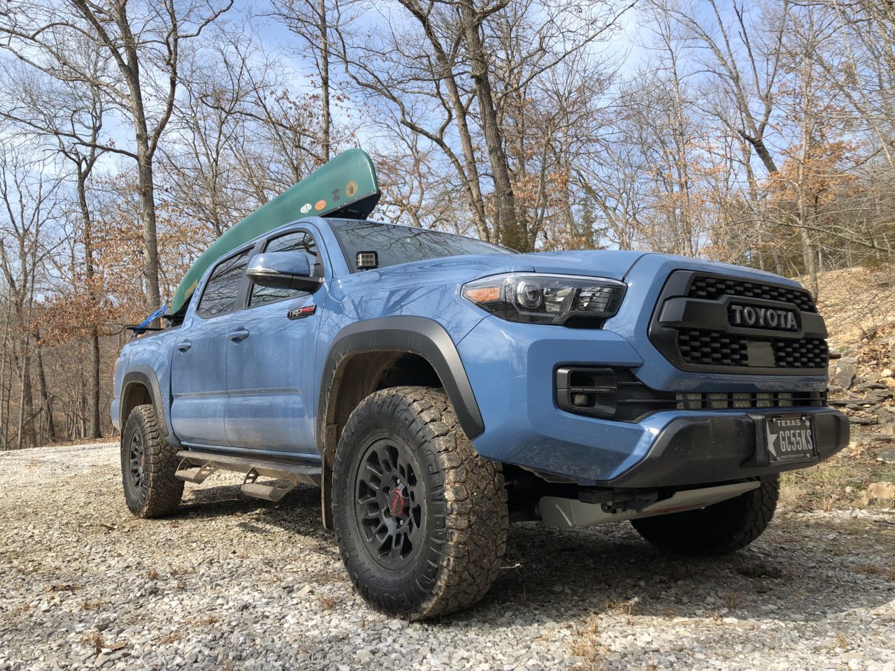

    285/70/17 on Kings

    Damn, that looks good!
