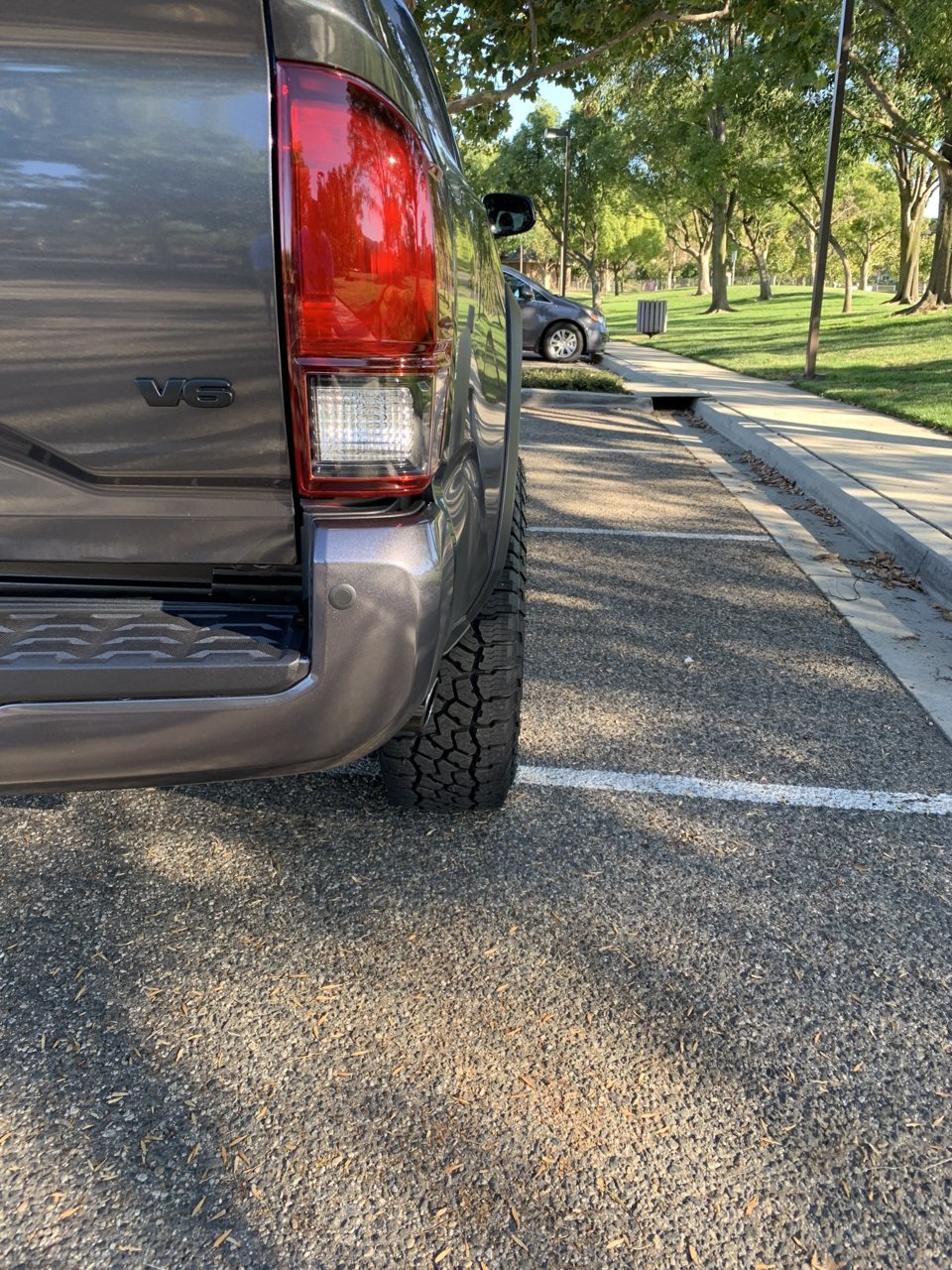

    Nice truck! I want to keep my factory wheels also and would need to add 1.25" wheel spacers. Can you post a picture to show how much tire comes out on the side? Thanks.

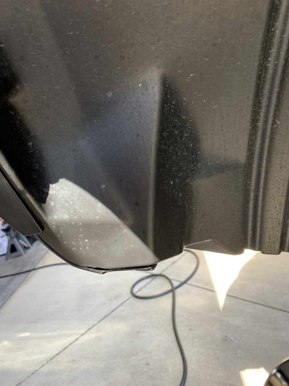

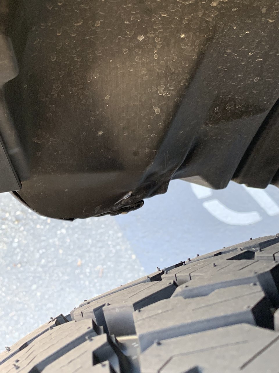

    Mine rubbed at full lock going over speed bumps or large dips as well. The rubbing was only at the lower front part of the liner. I heated it up and pushed it away from the tire then trimmed a bit. All is well now.IMG_3051.jpg IMG_3100.jpg IMG_3075.jpg

    The tire sticks out just right, not too much. Thanks for the tips.

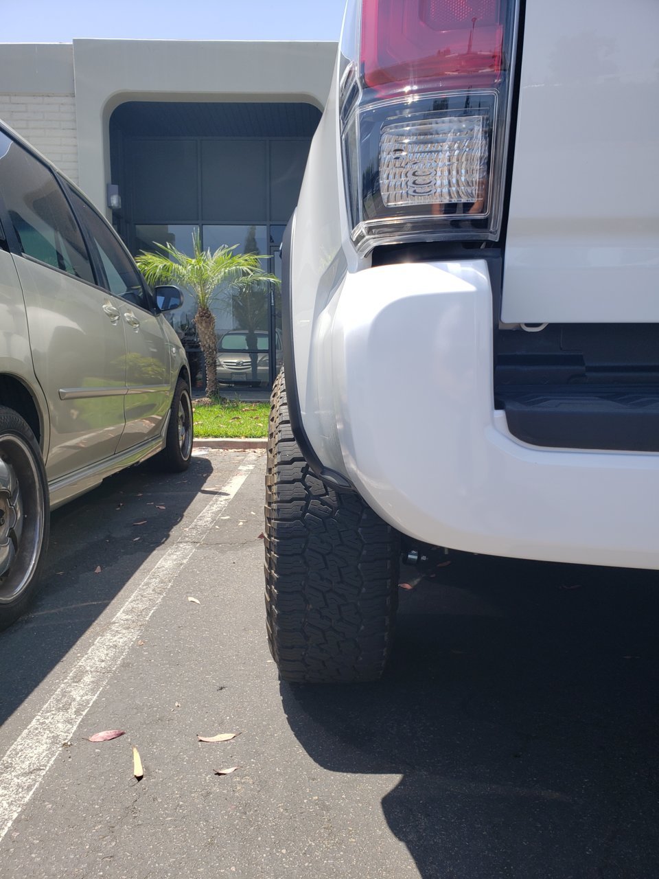

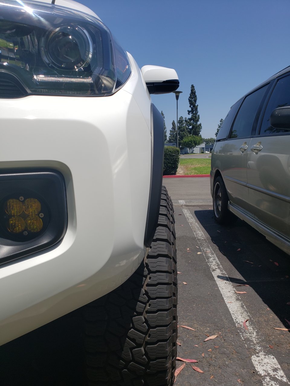

    sweet thanks...how far past the fenders do your tires push out?

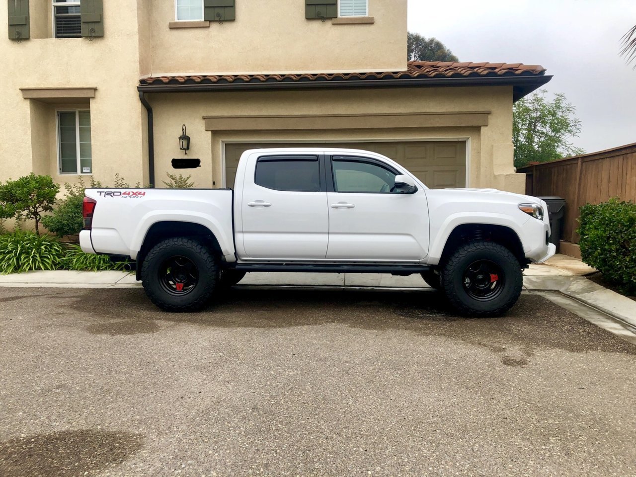

    I got 5100, springs, AAL, JBA UCA. Gave me about 2.5" of lift. I did CMC right from the start. Ill rub very little during reverse at full lock.
