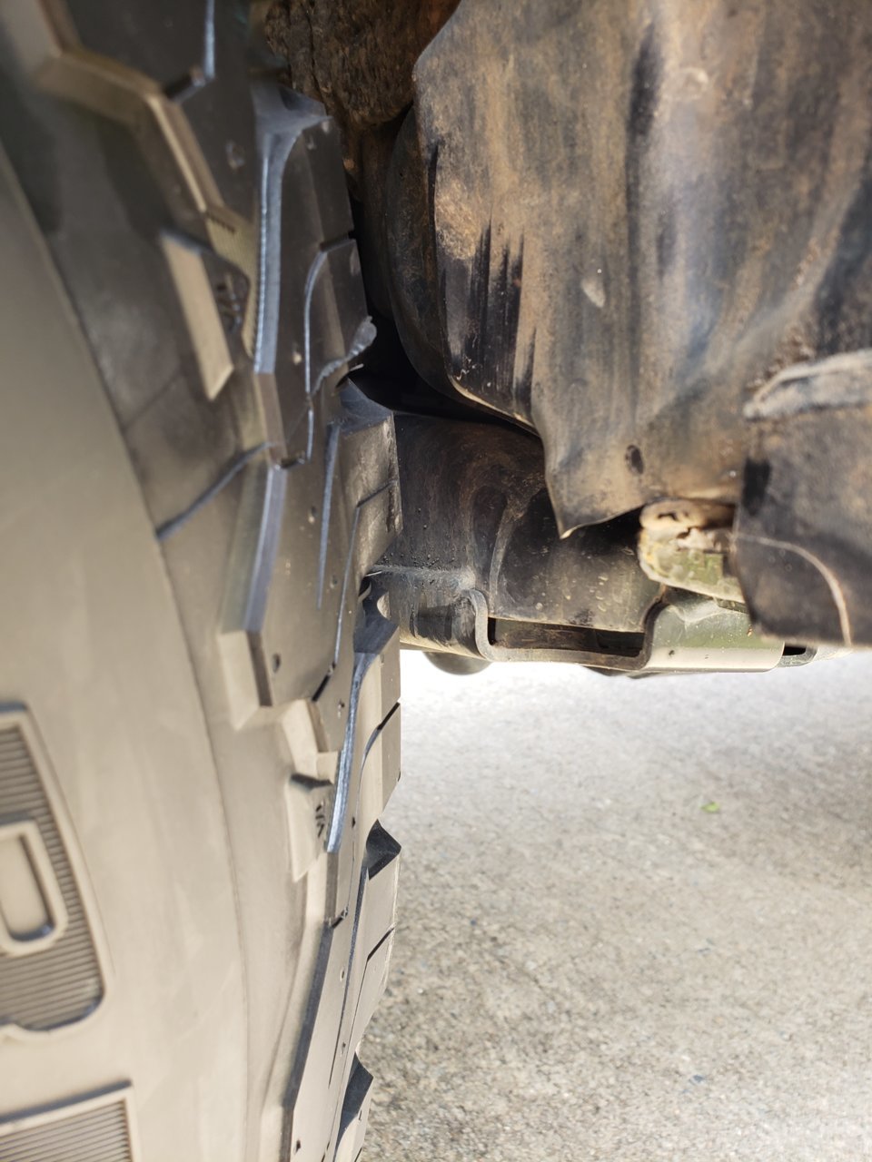

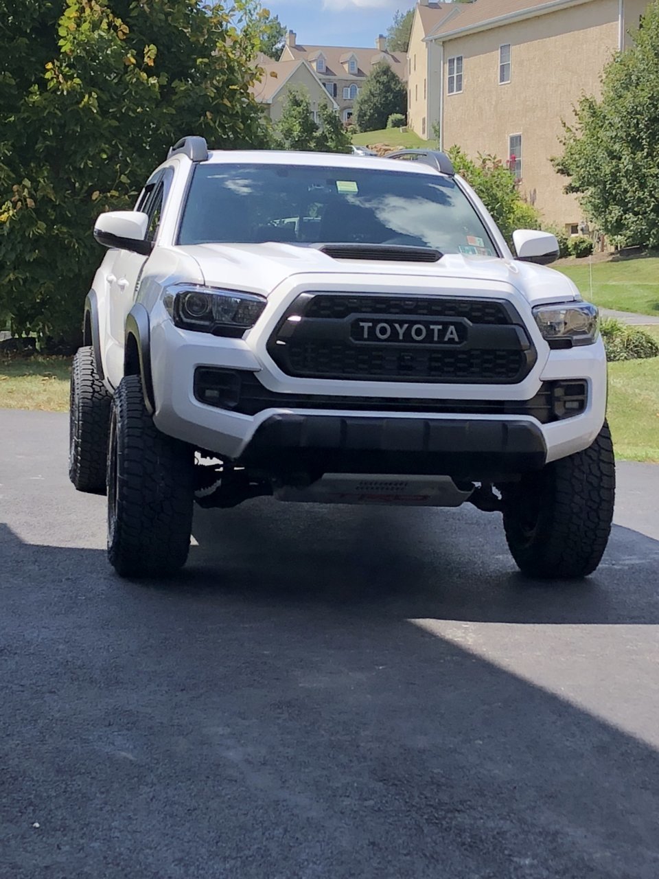

    Thanks Brent! I did not get the adjustable uca's this first go around....still stock, I ordered the BAMF plates yesterday after testing on curbs and driveways. I didn't get a chance to go offroad but am certain it would have only proved worse on rubbing for me anyway, who knows maybe you won't have to do a cmc. I was also rubbing on the front of the wheel well at about half turn backing out of my driveway dropping off the curb. I cut off the small square plastic that had a bolt throught it and moved it further away to the next closest hole along with some minor heat gun to alleviate plastic rubbing. Not the best pics but hopefully show the slight rub I have at the rear of the wheel well. Hope this helps Brent, if anyone needs more info or better pice lmk.20190808_122023.jpg 20190808_123547.jpg

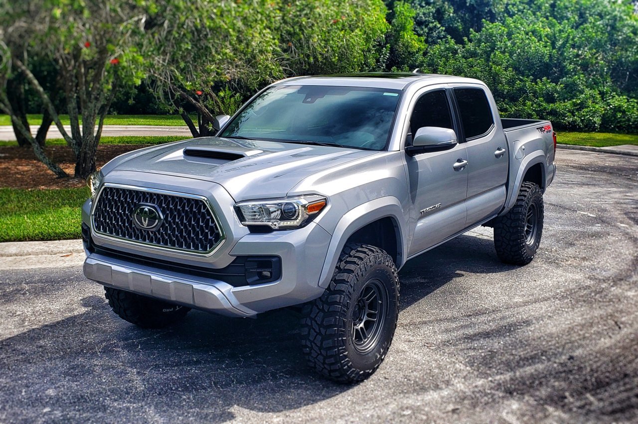

    285/70/17, CMC, no rub, no spacers...other info in my signature. IMG_0449.jpg

    What wheels are these, and what offset? How much lift is this? Absolutely beautiful

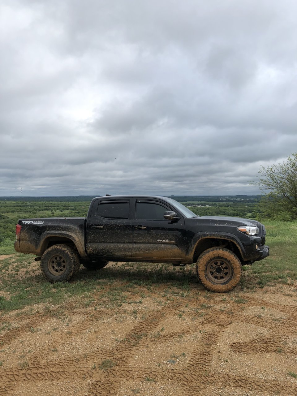

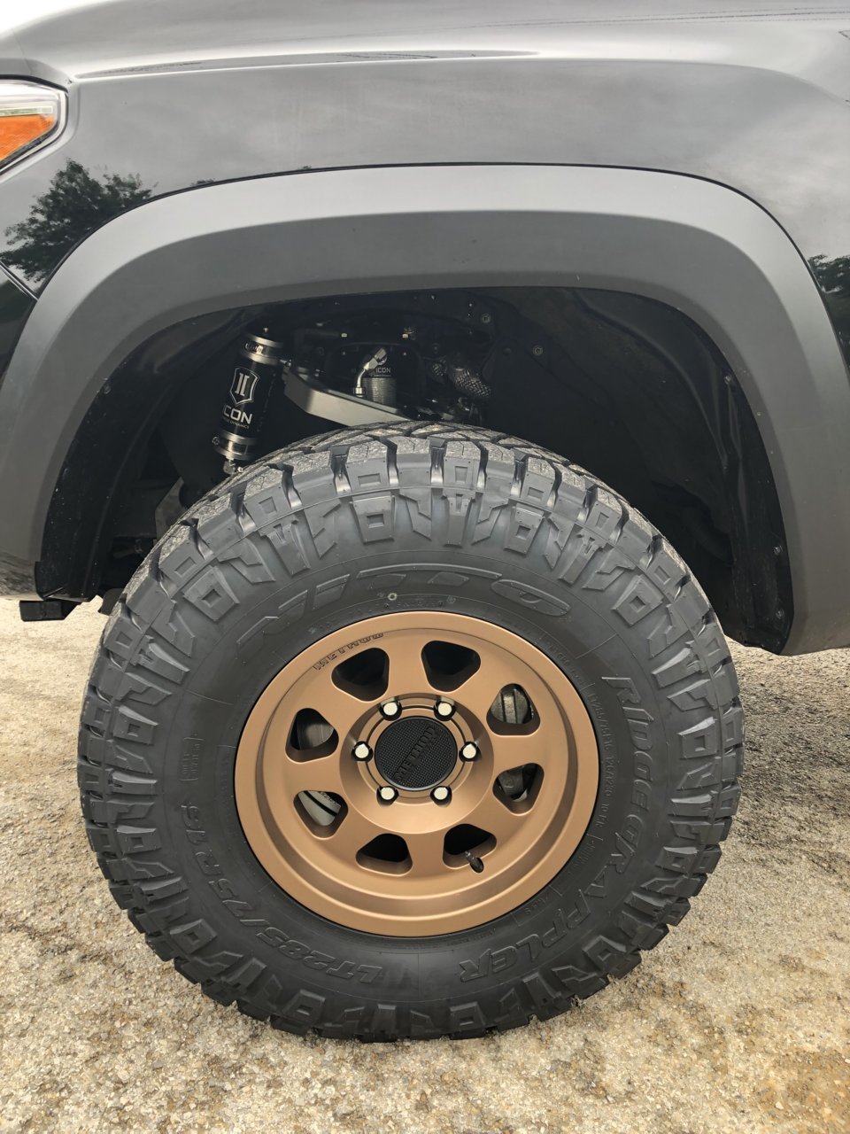

    Icon stage 5 lift w/billet uca, methods mr701 and 285/75r16 Ridge Grapplers, Ov Tune, Timbren bump stops rear with u bolt flip, duro-bumps front, pop a lock tailgate, trd pro grill with raptor lights, backflip tonnu cover, window gaurds, smoked tail lights, spyder headlights w LED bulbs, smoked led mirror turn signals, blacked emblems
    upload_2019-8-14_1-32-22.jpgupload_2019-8-14_1-32-55.jpg285/75r16 Ridge grappler, Method mr701, icon stage 5 lift W/Billet uca
    Zero rub at full lock and while off-roading. no cmc, did do very minor fender trim

    Does anyone know what bumper that is?

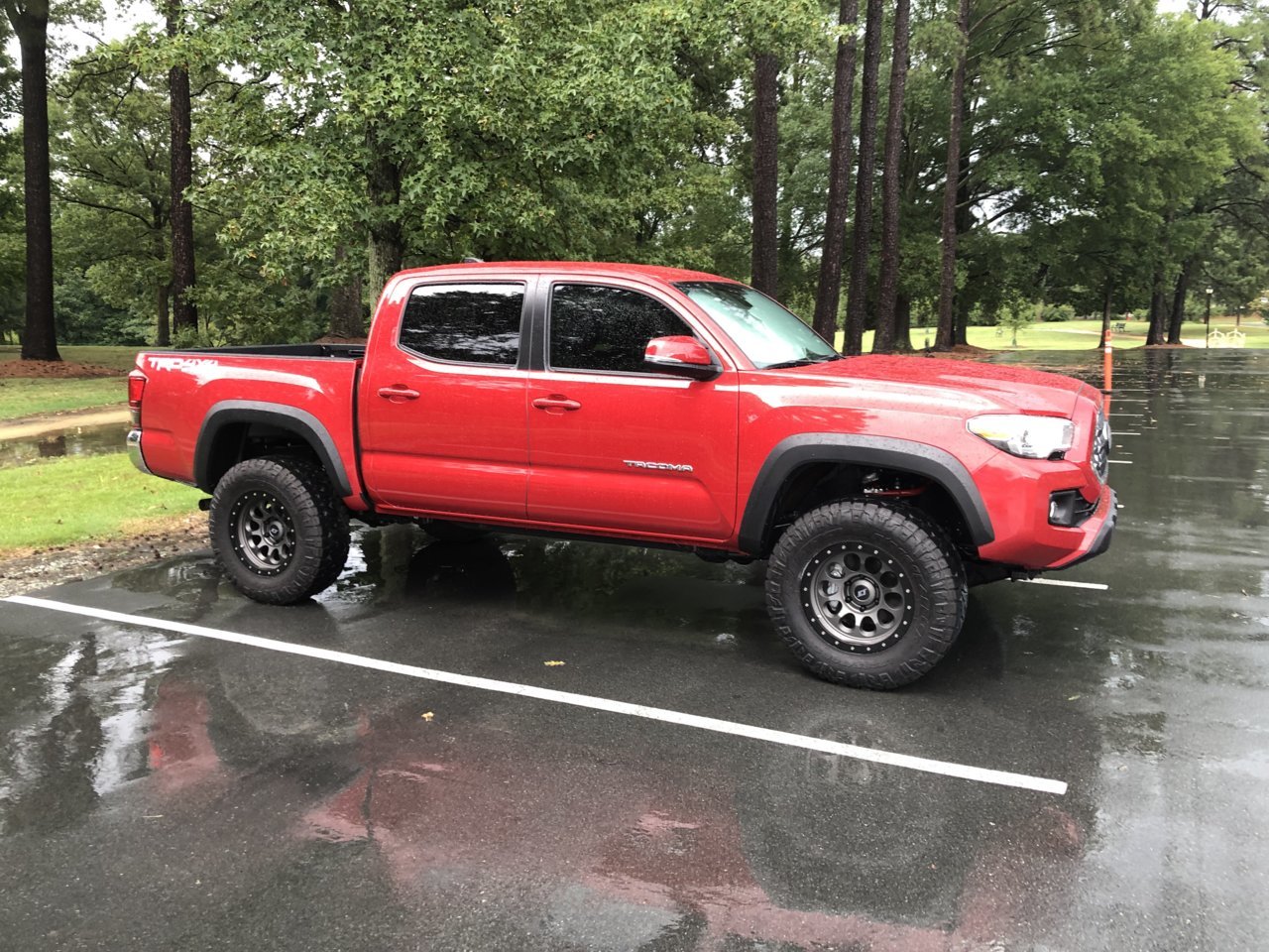

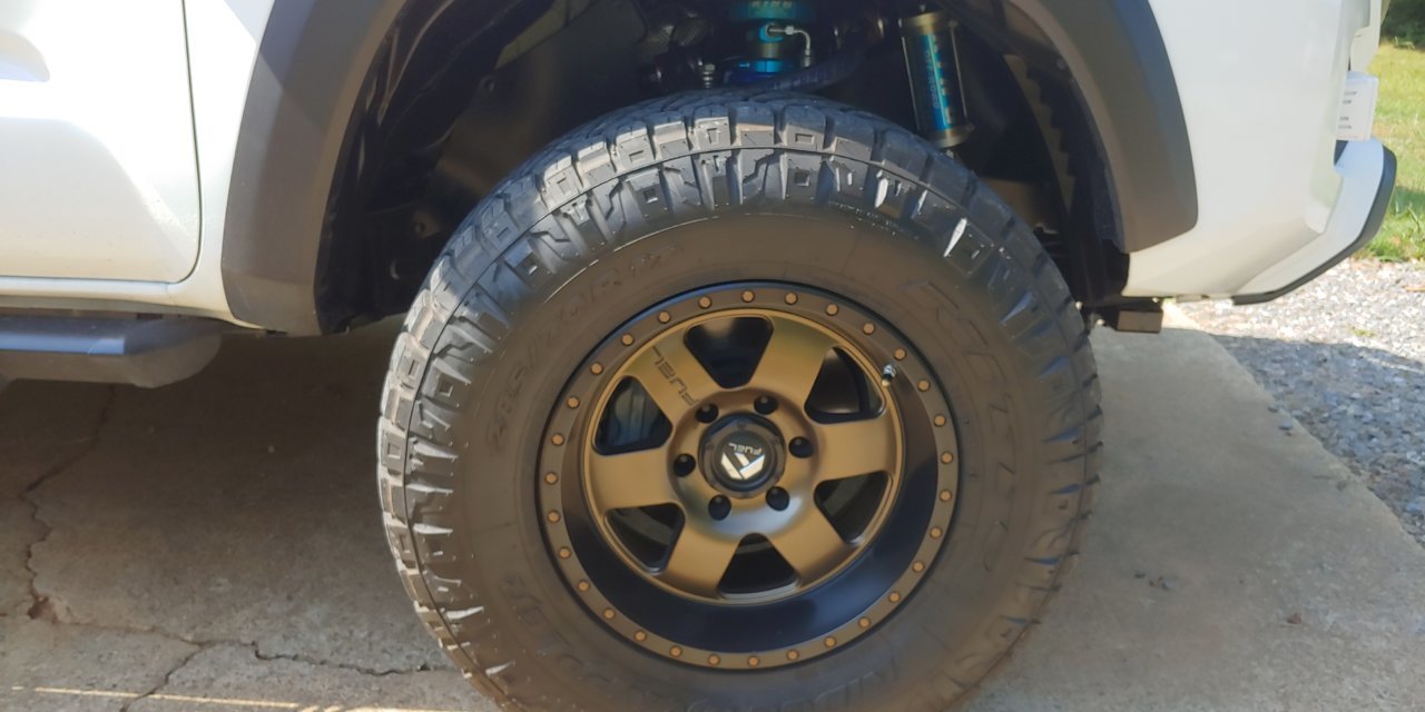

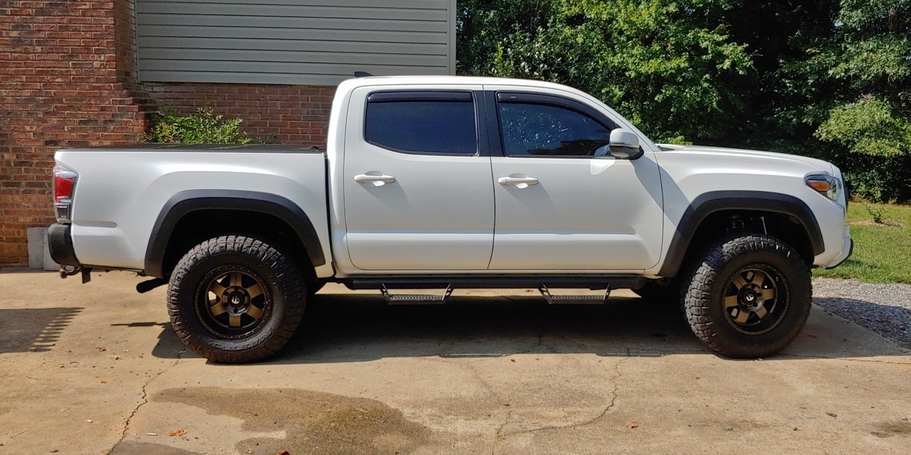

    285/70R17 Nitto RG C Load on gunmetal Ray10s. Need to CMC and trim.

    What steps are these?

    Sweet! How drivable is it before you trim/cmc?

    I daily it right now. Gotta be careful not to take any sharp turns. All the rubbing right now is on the plastic. I really only rub on sharp turns and reversing while turning.
    I am going to trim some plastic this weekend and will eventually CMC so that I will not have a problem in the future. I can do the CMC, but gotta find someone who can weld in my area.

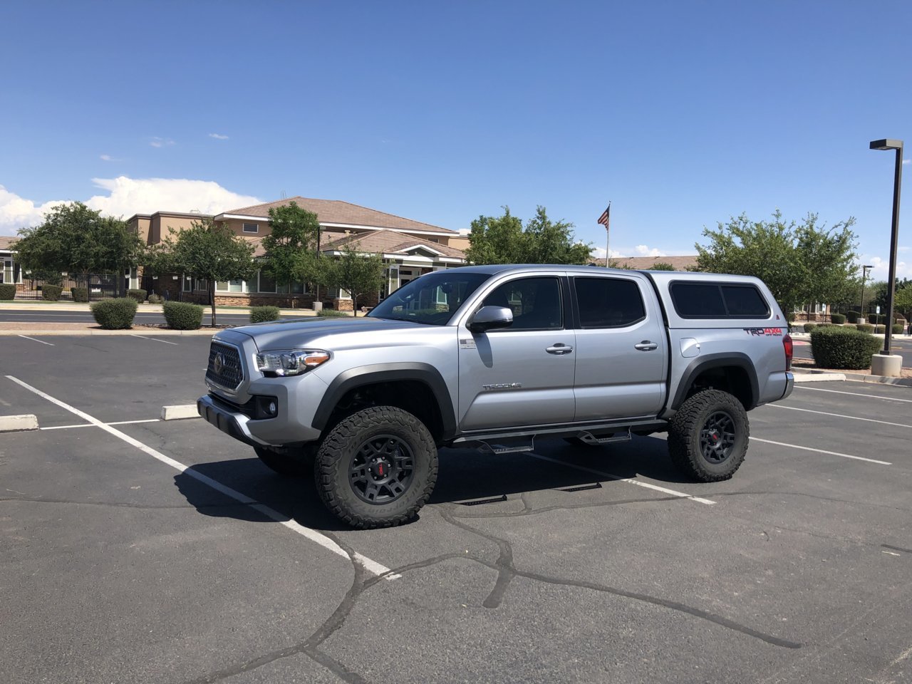

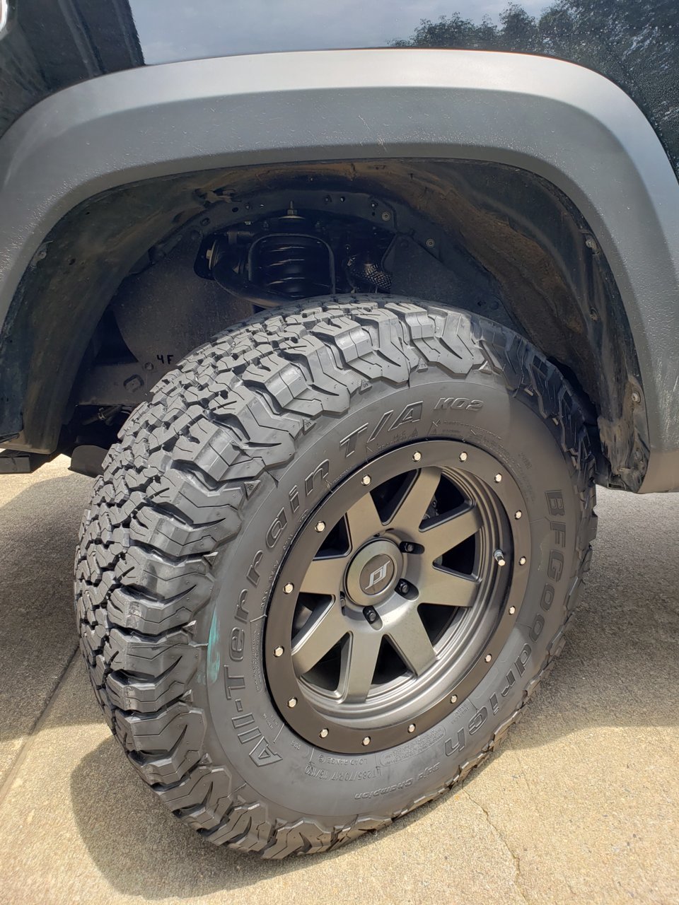

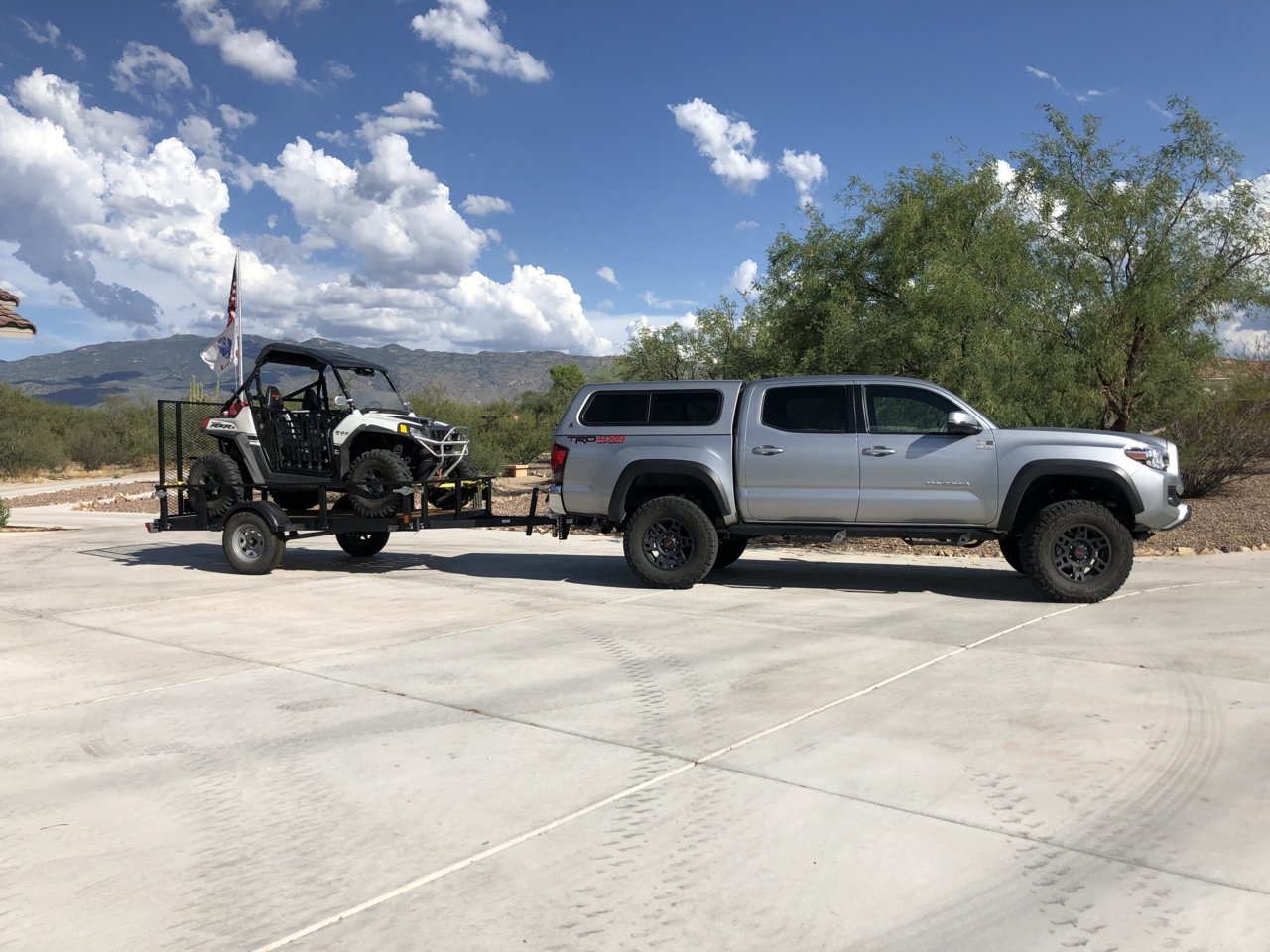

    7D108B37-1AC8-4CB5-859E-288A03BF9E0B.jpg D2FB0631-D0A3-49CC-9EB9-556AF39CB7EB.jpg
    285/7017 KO2 and TRD 4Runner wheels
    OME BP-51 Kit with Dakar HD springs.
    No rubbing. No CMC. Trimmed an inch off the bottom inside of the plastic liner. Was able to fit a full sized spare in the stock spot. I just took a sledge hammer and pounded out the stock spare retainer arms a little bit. The spare fits perfectly.

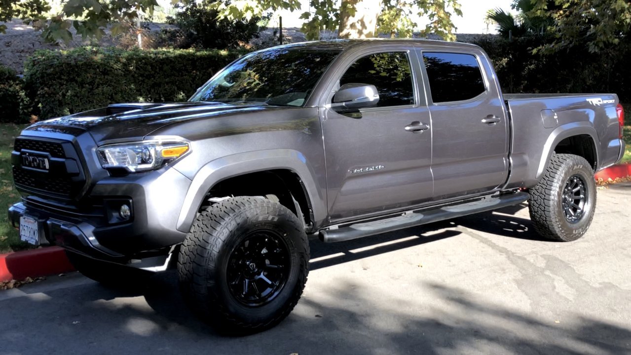

    849DE318-12A1-4E46-B578-8773AD35C9EA.jpg E6E197A3-9E53-48C2-AE4A-5991F9750DC5.jpg 285/70/17 Falken Wildpeak AT with Fuelly rims. Bilstein 5100 and OME 888 springs
