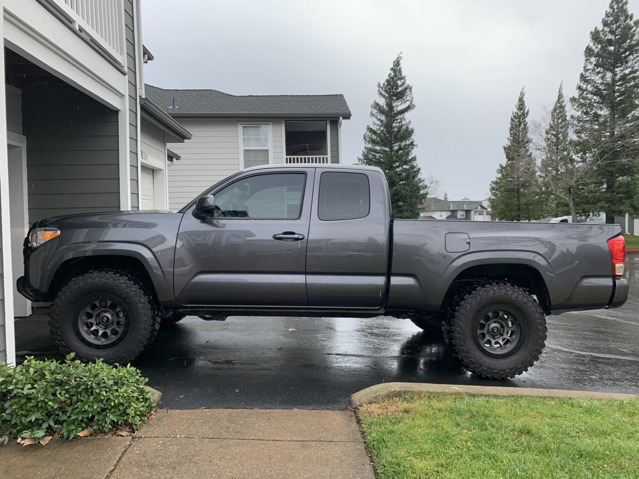

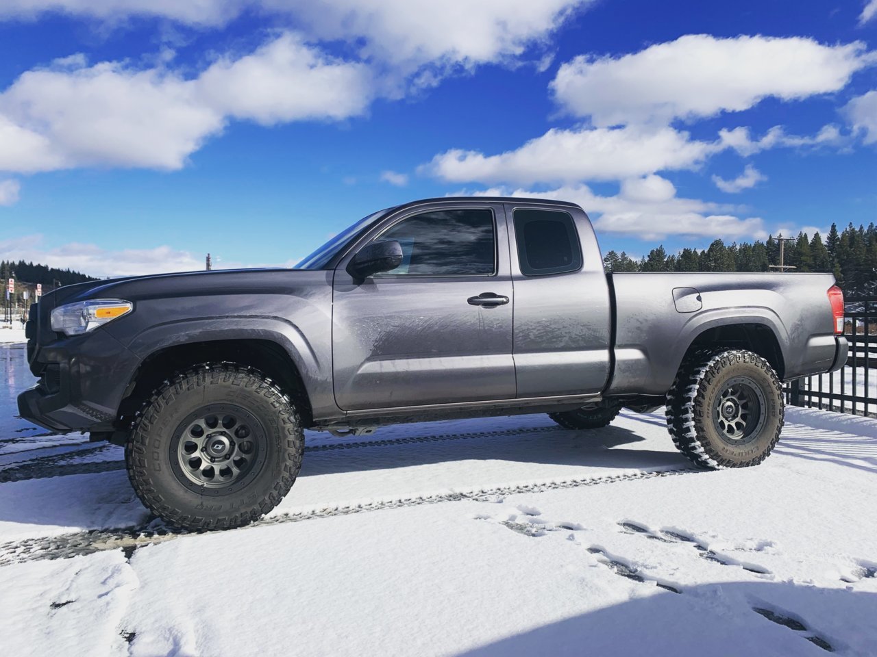

    I’ll play.
    Ray10 16x8
    STT Pro 285
    Stock suspension
    Soon to be 315s after the new suspension and regear.

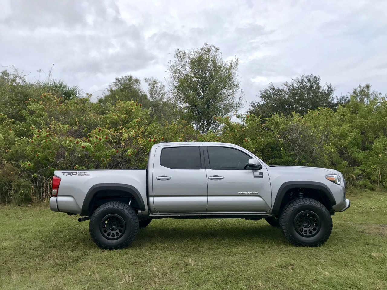

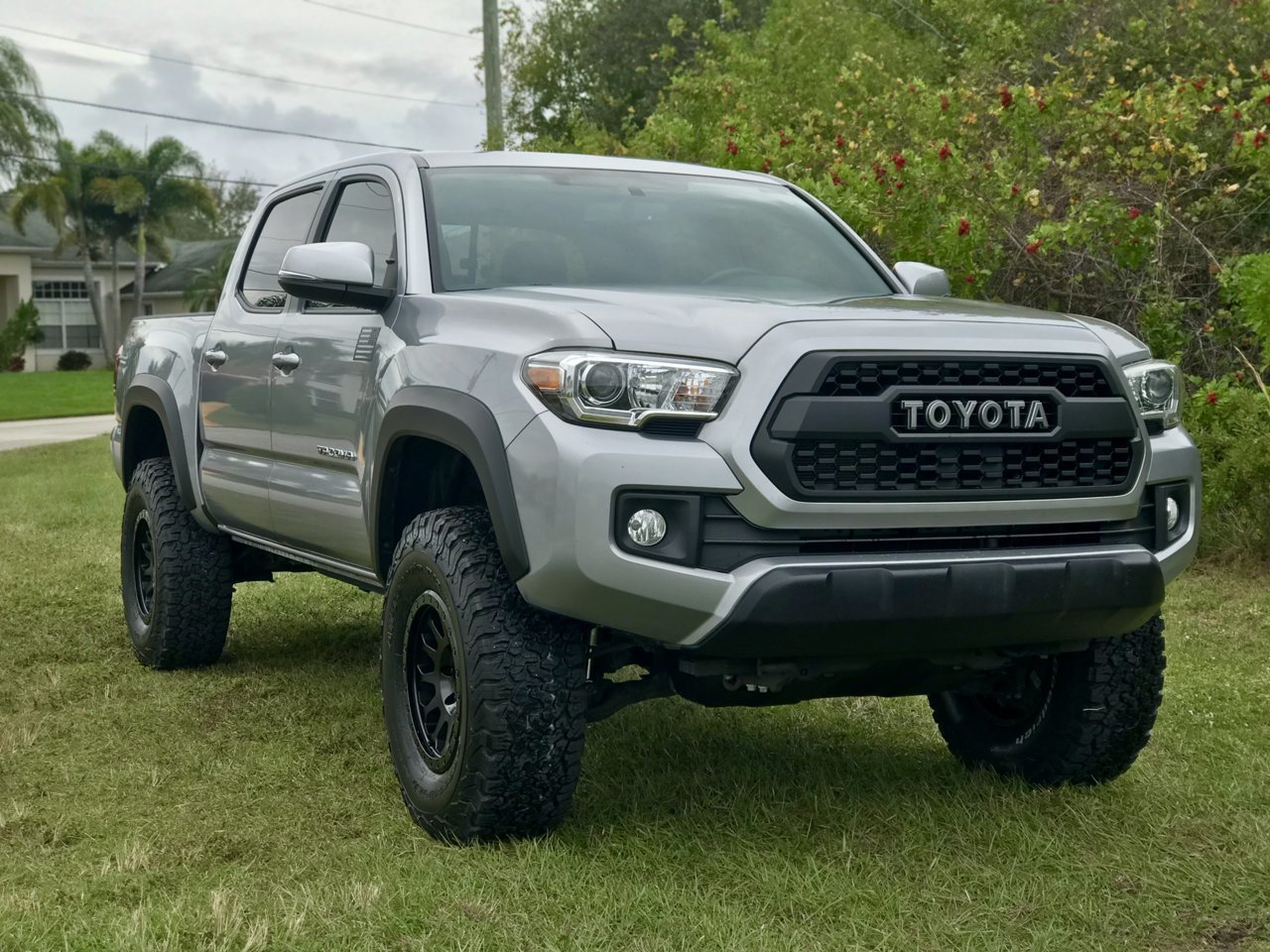

    Fuel vector 16x8 et1
    Bfg k02 285/75/16
    Eibach pro lift (set on lowest snap ring)
    Wheelers 1.5” aal
    No rubbing, or clearance issues.

    dang on the lowest setting?! that looks nice!

    Thank you! Yep, lowest setting. I'm really happy with the way it turned out.

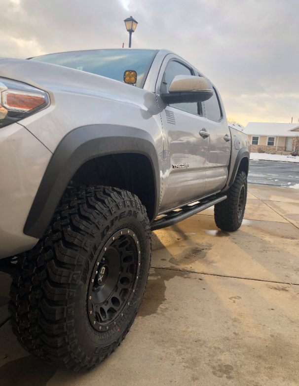

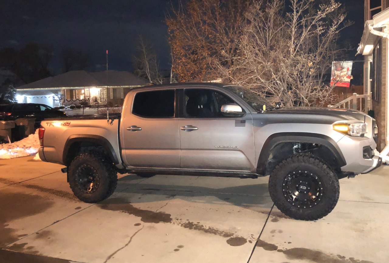

    Just got them put on yesterday. Falken MTs 285/70/17

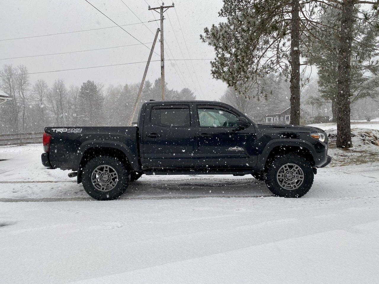

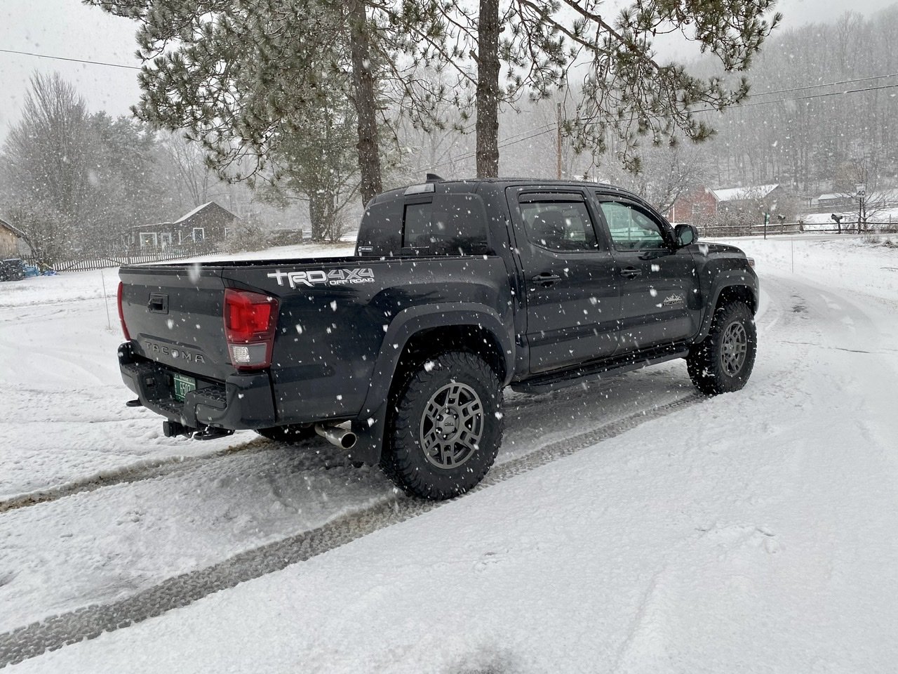

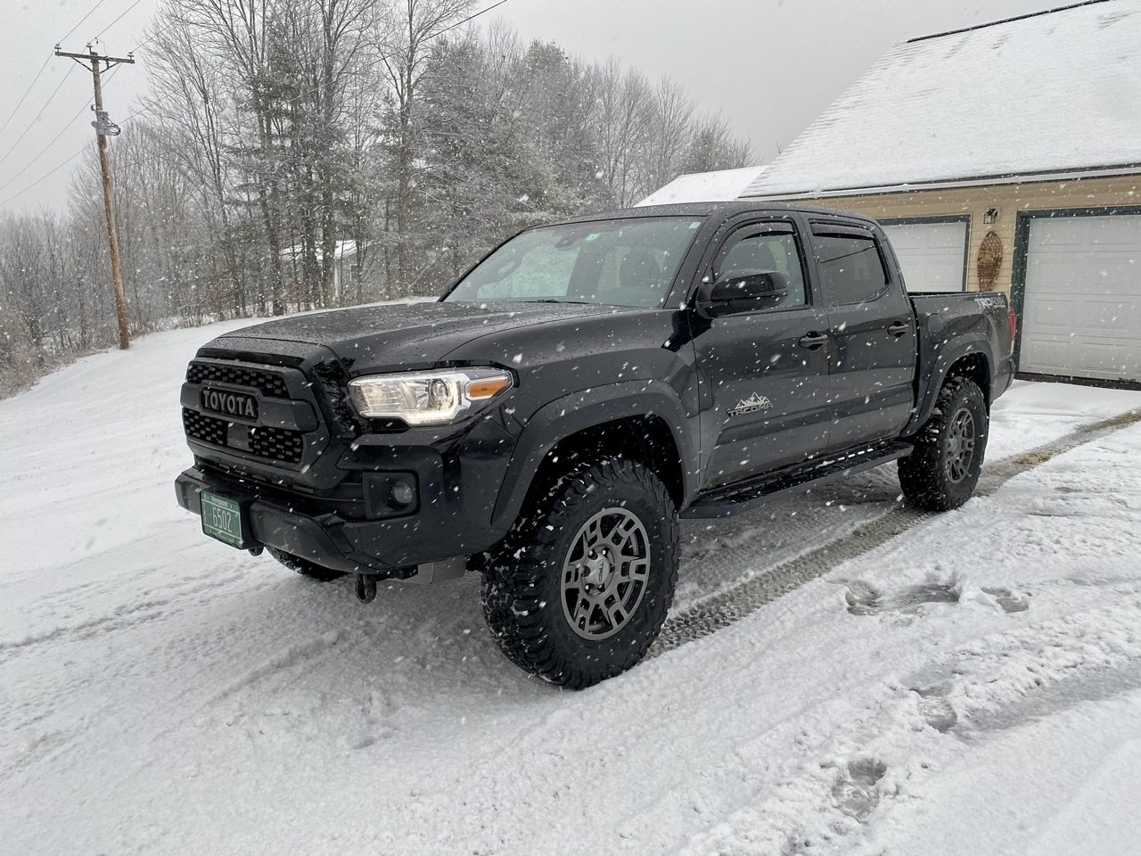

    I just joined the club! 285/70/17. Stock OR suspension with 1 inch front spacer (same a pro height) and not cutting. Doesn’t rub at all!

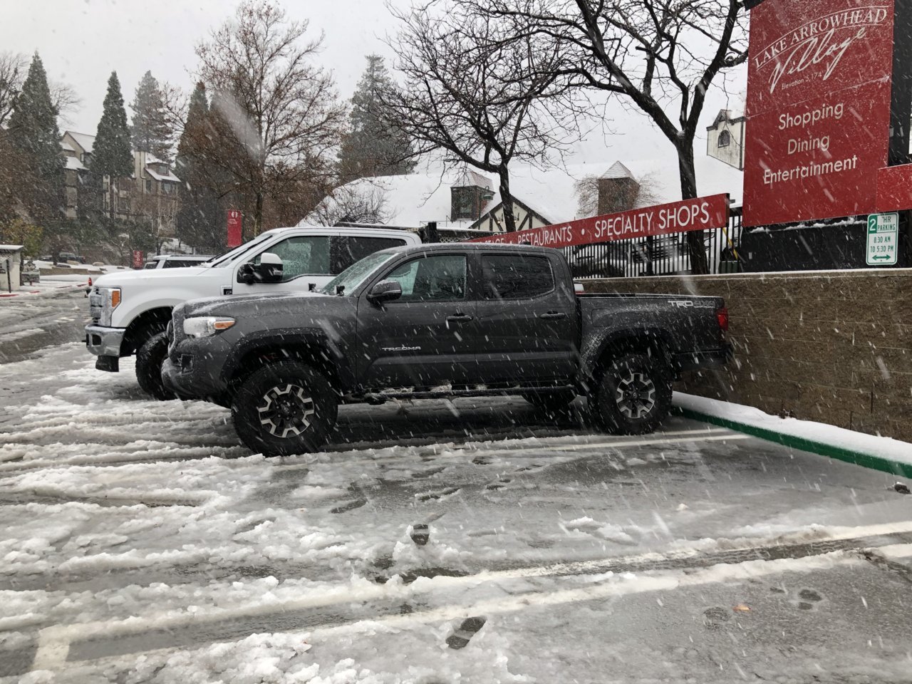

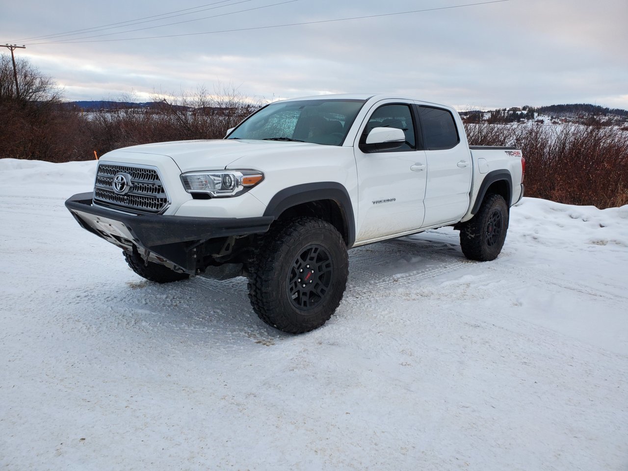

    83AF4909-E3E4-42D4-94AE-9132970139D3.jpg Currently running stock suspension in the front with a 2.5” spacer and then OME HD leafs and shocks in the back. 285/75/r16 no rub at all

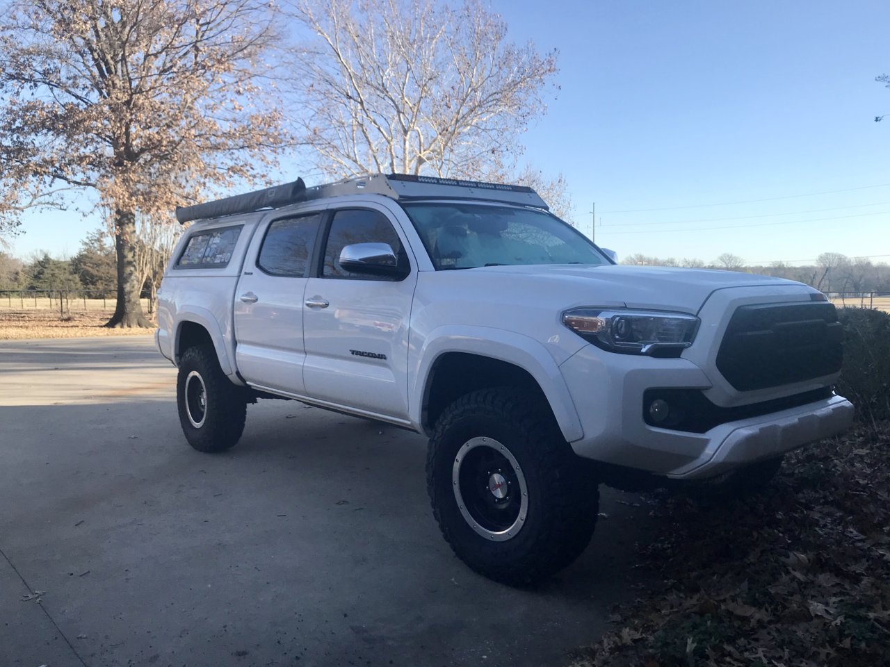

    285/75/16 falken wildpeak at3 on stock OR wheels. Not sure how you guys don’t rub with these size tires. I had to do a cmc, have 3 degrees of castor and my tires rub the inner fender in a few spots at full bump.

    wow, really? no rub? looks great.
