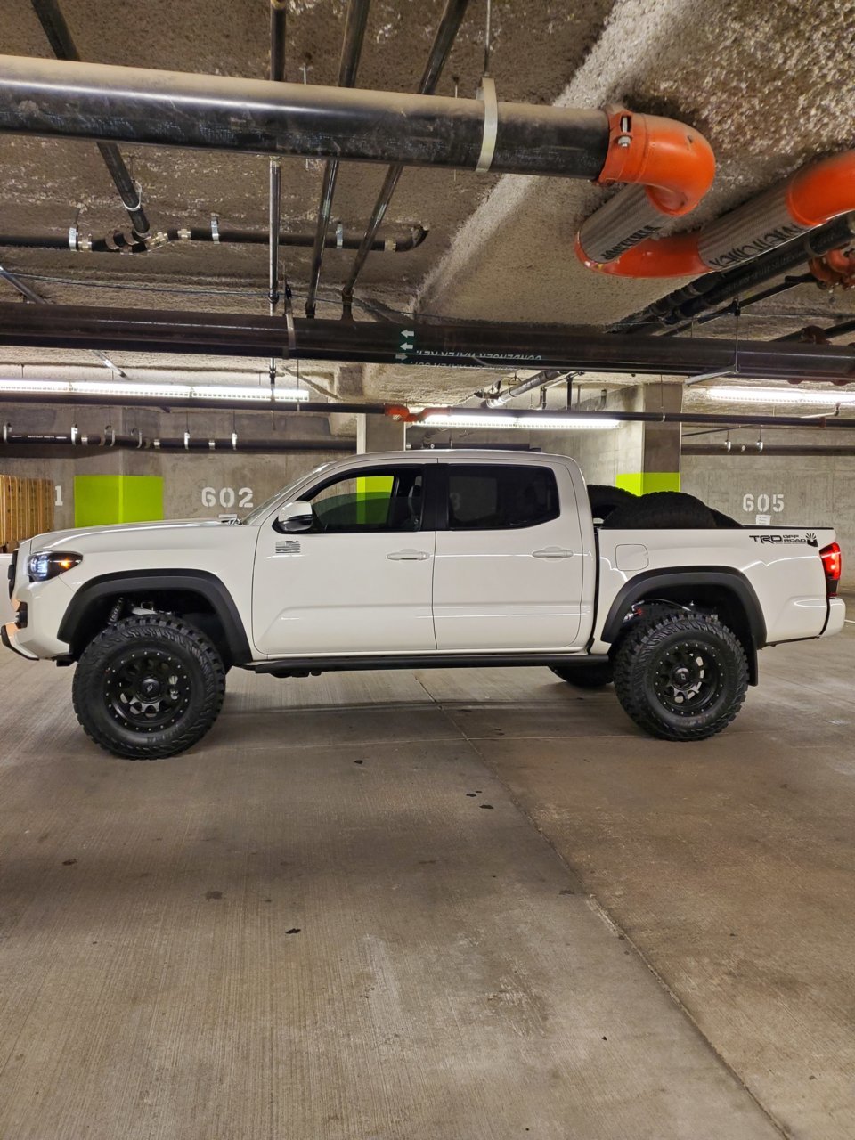

    tacochep
    tacochep Well-Known Member
    Apr 17, 2017
    #216462
    654
    Phoenix AZ
    2019 S White Taco DCSB TRD 4x4
    scs ray 10's, demello sliders, meso stuff

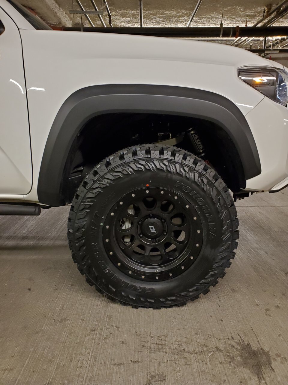

    285/70/17 Yokohama Geolander G003 MT
    ADS 2.5 lift with resis and clickers
    ICON RXT leaf pack on option 1
    ICON billet delta joint uppers
    yes rub on fender liner plastic, need to do some trimming, no offroad testing yet

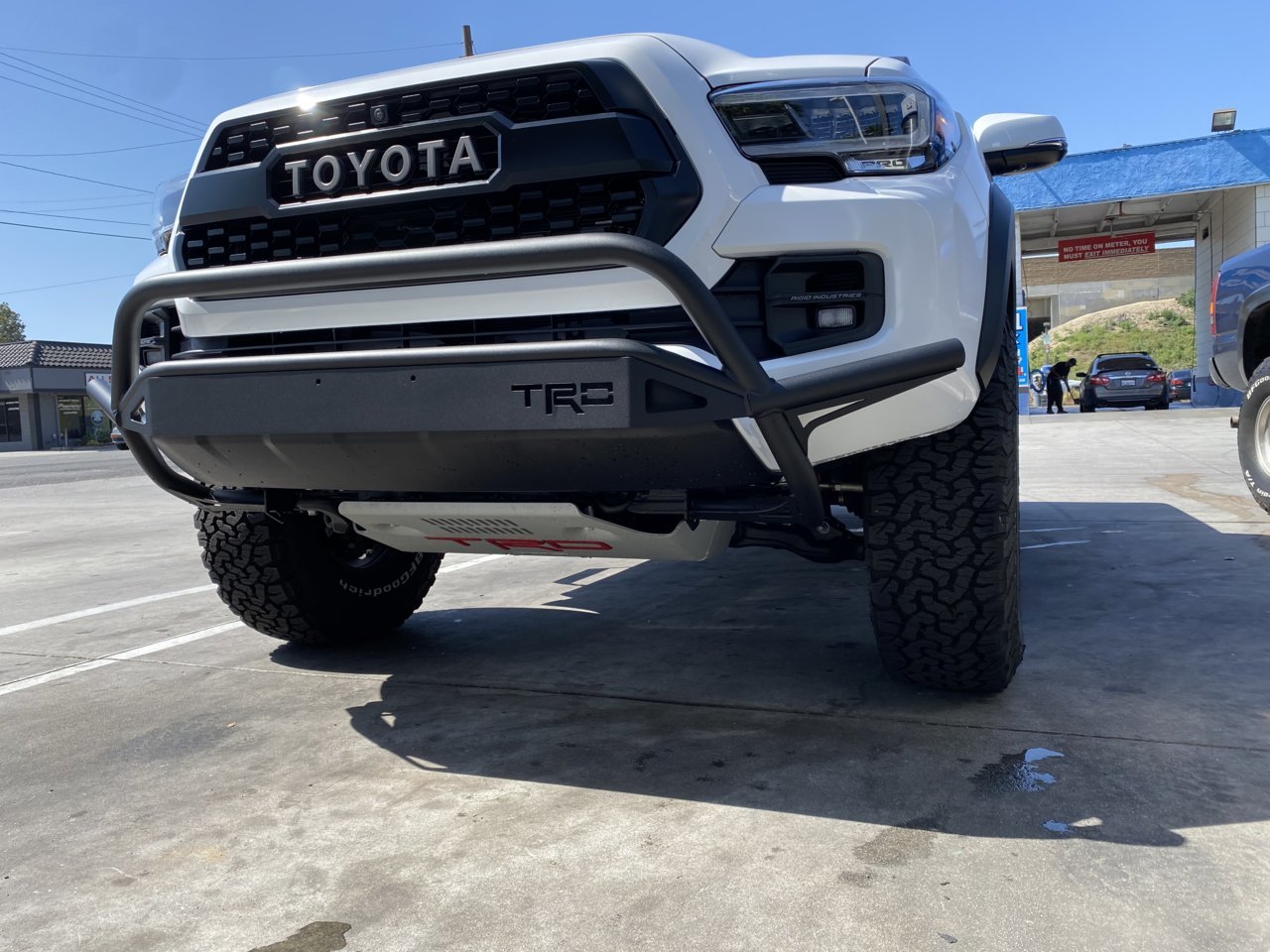

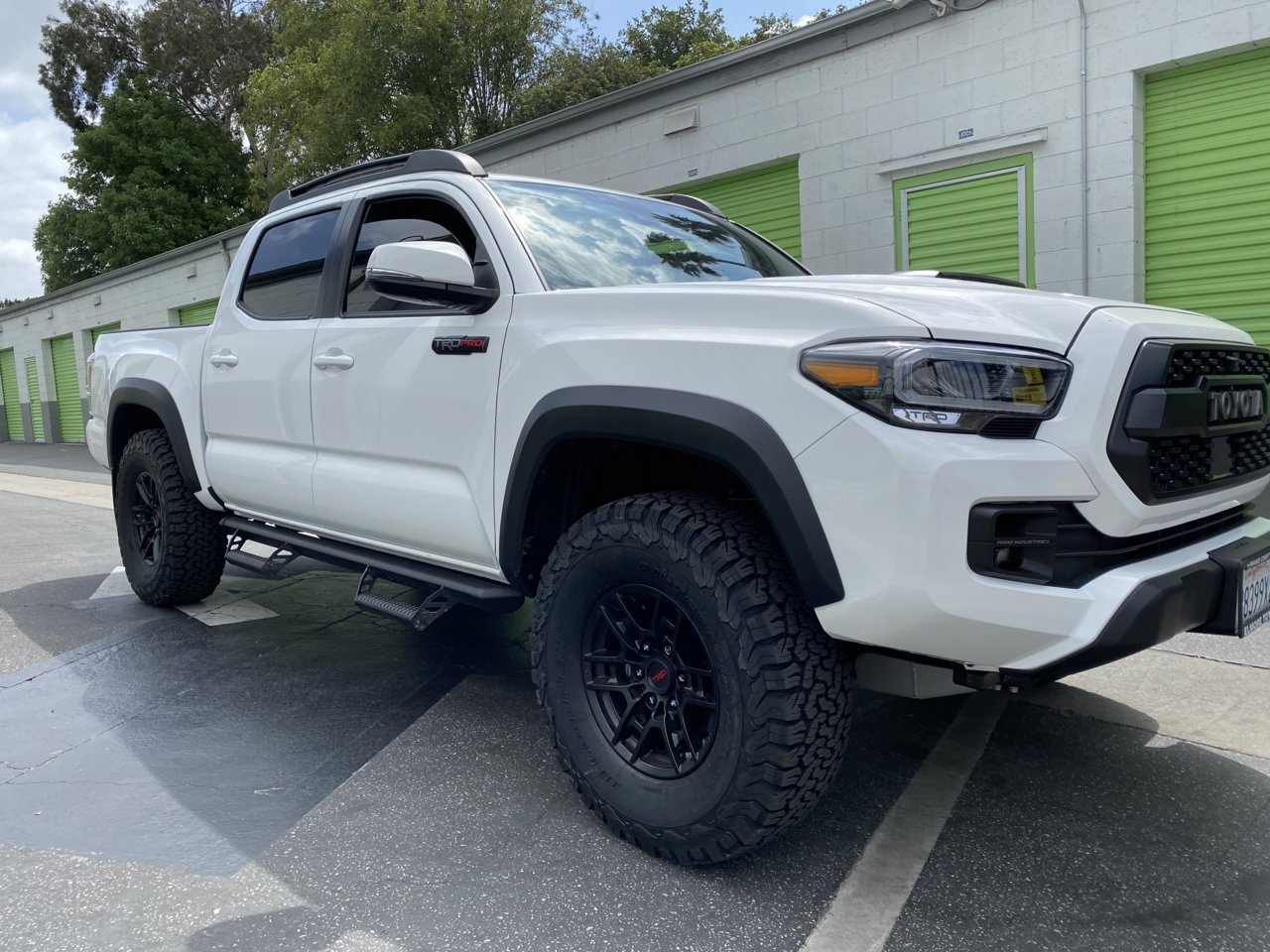

    BFG KO2 285/75/16

    Any rubbing?

    Very little almost nothing it rubs on the bottom of the flare only on driver side been wanting to dremel off but it doesn’t bother me that much.

    How are you liking those tires so far??

    Interesting. Is it rubbing the front or back part of the flare?

    Quiet for an MT. Little floaty on the highway need to adjust pressure and so far not so shitty gas mileage. Weight on them are 59lbs

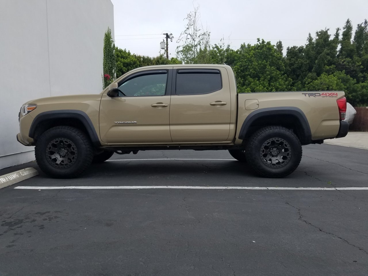

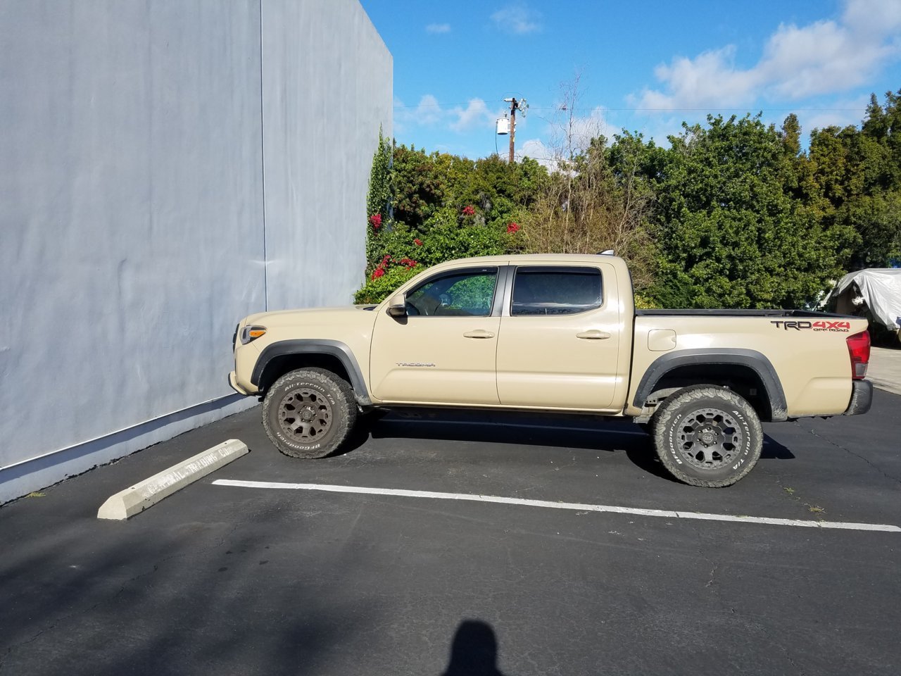

    From 265/70R17 KO2 C load to 285/70R17 Nitto Terra Grappler G2 E load. The tire is slightly heavier and the loss of power is minimal in comparision. The E load tires feel smoother to me which I attribute to difference in tread pattern. I had initial slight rubbing on the front fender liner which was corrected with some persuasion from a heat gun and a 2x4. The wheels are 17x9 Black Rhino warlords with -12 offset and I'm running a Dobinsons 2" lift front and rear.
    Before
    After

    Damn the 285s really make the truck look that much better, great looking truck nonetheless :thumbsup:

    I'm assuming you are running with no lift (i.e. stock Pro suspension). Correct? Considering the larger tire for my Pro but not interested in a lift right now.

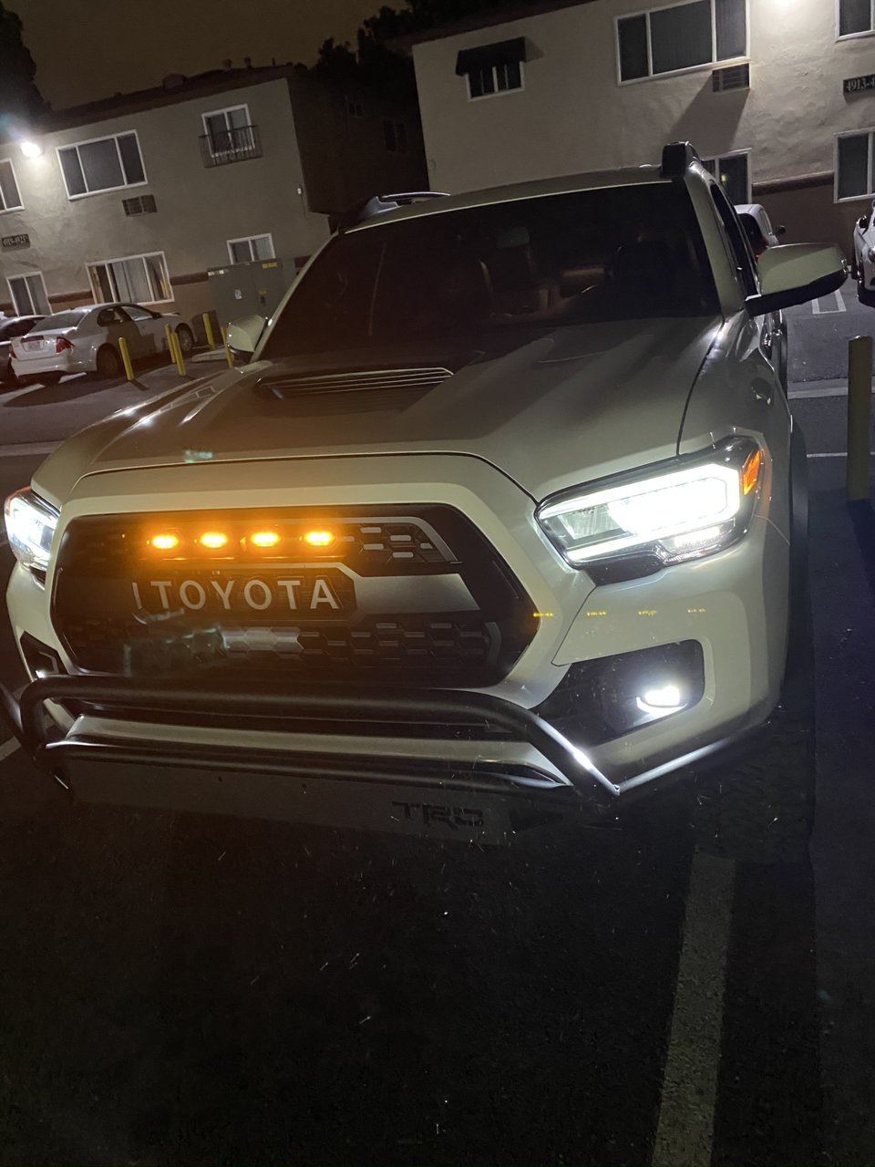

    285/75/16 2 inch lift in front suspension DRL Headlights New Grille (raptor style) Fog Lights
    -285/75/16 Toyo Open Country A/T II
    -Lifted 2 inches in the front with Supreme suspension
    - Had to do alignment to compensate for the rubbing initially
    Only rubs towards the Cab when it is in a full lock...otherwise drives perfect, no rubbing.PHOTO-2020-05-27-17-10-27.jpg

    Did you have any rubbing? I want to get this exact set up
