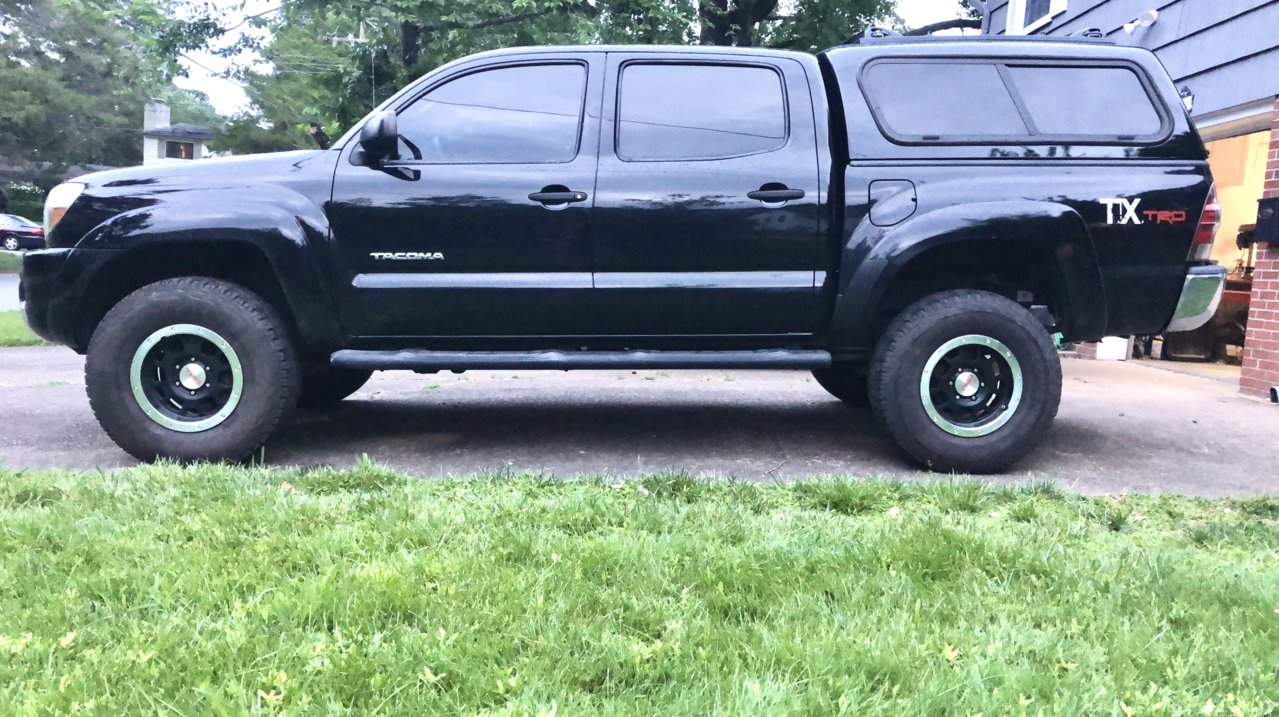

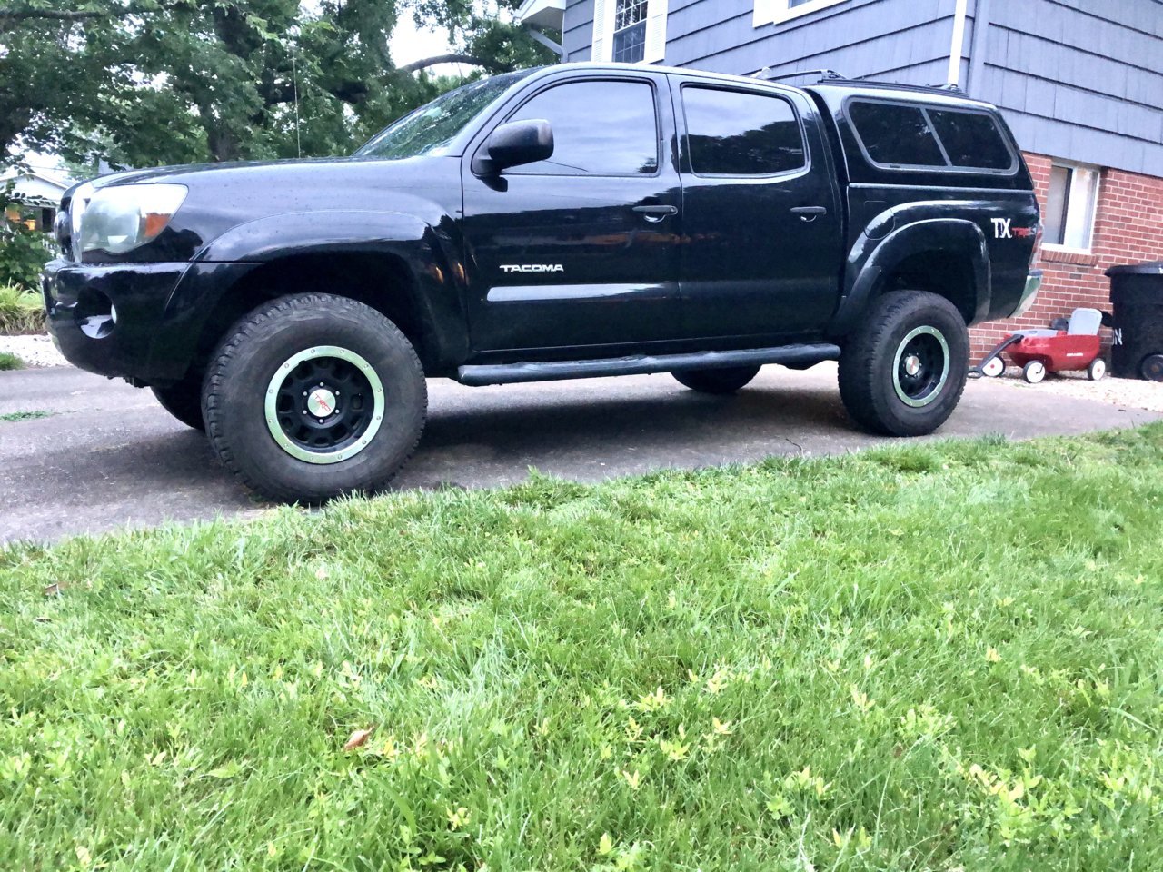

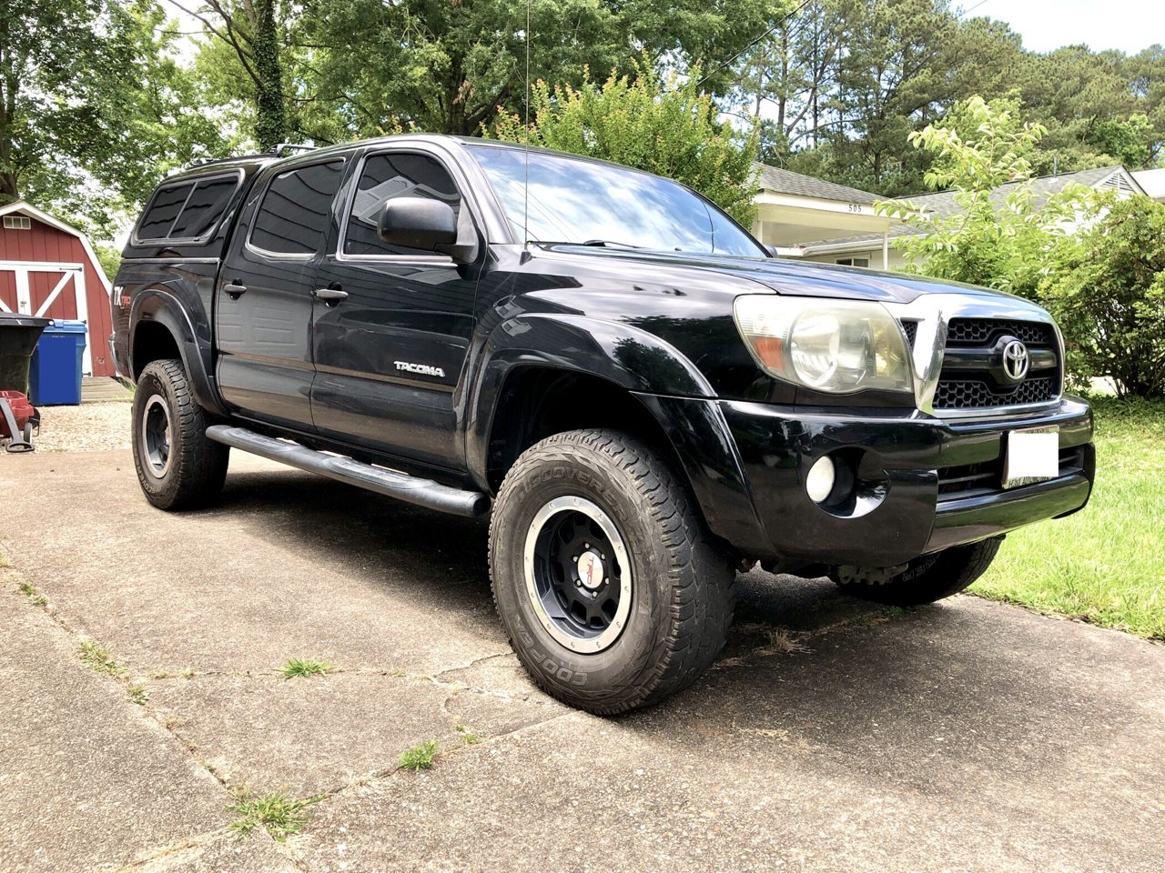

    New member here. After reading almost all 88 pages of this thread I was inspired to dip my toes into 285’s. Got a used set of 285/75/16 Cooper AT3’s and had them mounted on my TRD bead lock wheels. I bought used first because I was really worried about rubbing and ruining a new set. However, with +10 offset, they clear the cab mount, even at full lock, but I had to push the front fender splash guards forward. Please Excuse the kids toys in the background and the very dirty truck.

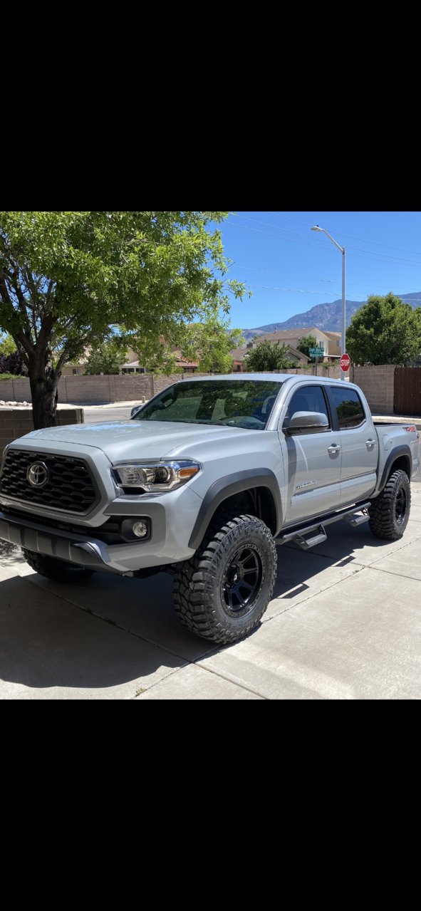

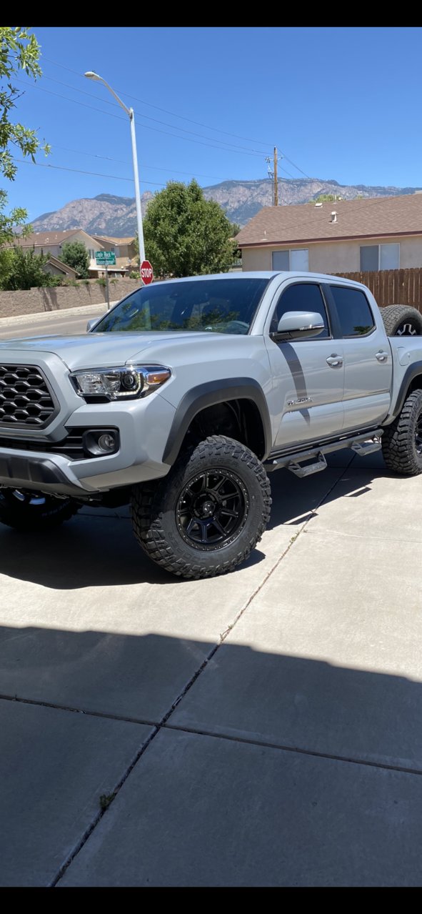

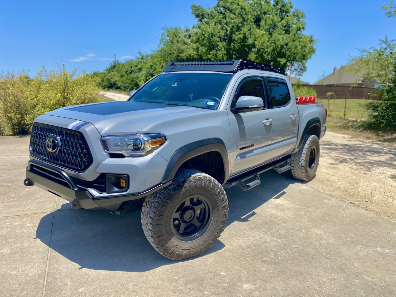

    BB915706-7E18-4E15-91D7-36832099DBD5.jpg 6AC77A8A-426F-4B79-A310-39803E27FA28.jpg
    I’ll be changing the hideous grille out tomorrow

    I’m actually a fan of the 2020 grills, as many others here are. You’d be able to sell the grill fairly easily once off, so win-win for you and someone who buys your grill.

    I have pretty noticeable power loss... probably bc I went full MT tire so they're a bit beefier than an AT tire.

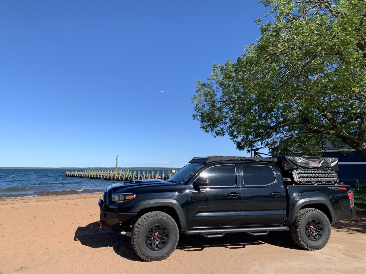

    BF Goodrich KO2 A/T 285/75/16 2 1/2" Lift Fox 2.5 Remote reservoirs CBI High Clearance Front Bumper (aluminum) CBI High Clearance Rear Bumper w/ Dual Swing Outs Prinsu Roof Rack w/ 42" Cali Raised LED Bar RCI 12" Bed Rack Roam Adventure Co. Vagabond Rooftop Tent Smittybuilt x20 10,000lb Winch Roam Adventure Co. 95l Rugged Box (2) OEM Audio+ Reference Series Speakers & Sub Viper Smart Start Cellular Remote Start
    BF Goodrich KO2 AT 285/75/16.... no lift, no modification. They fit with no on the road rubbing, but does rub a little once the suspension starts to flex off road!

    I love the beef of the MT; don't think I'll ever go back to AT

    Sooo happy to hear and see this. After a lot of thinking and researching, I will go all in the 285/75/16 KO2s. I already emailed Toyota to include that when they deliver my truck. I will lift my TRD Sport anyways in a few months at most.
    I was afraid of going this size, but prefer to go big on tires already then regretting going 265 and then having to work in selling them to get the 285's.

    I’d be careful as yours is a sport and his is a pro. They have different wheel offset and the pro is an inch higher in the front.
