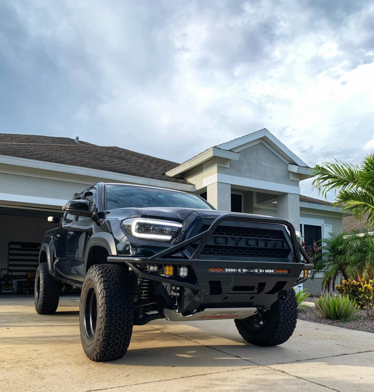

    285/70
    17x9 -38

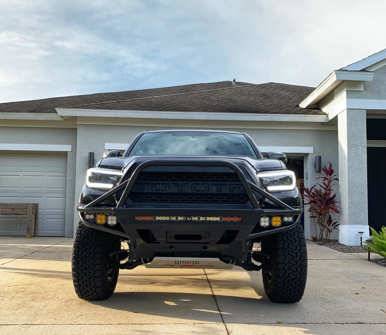

    How do you like the morimoto headlights? I have a black taco sport myself and am thinking of doing it...do you have any head on picss.... I am hesitate about how the cube lights look on our trucks...

    Extremely well made. They tie the front end together and complete the look in my opinion.

    SCS F5

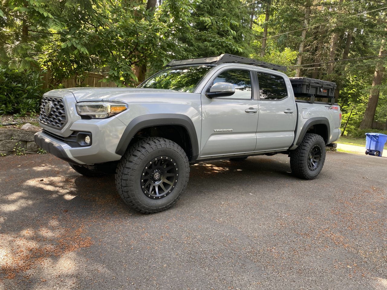

    285/70r17 dick Cepek trail country’s on Icon compression’s. Falcon shocks on leveling setting with Deaver AAL. Definitely had rubbing, but CMC solved that issue.

    did you have to cut out your fender wells for this tire and wheel combo to fit?

    I think its part lift, and part alignment setup, especially your caster. It seems the general consensus is that there is a bit of fender work needed to not have these rub, but some haven’t needed to do it.
    For me, I needed to remove the mud flaps, CMC, and a bit of fender work. I’m not sure how bad the rubbing was post-lift because the shop installed the lift and CMC at the same time. I had the wheels/tires installed just before the lift, and it was pretty bad in stock form.
