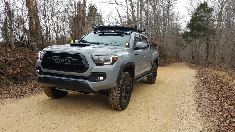

    Great looking truck. I've got a cement TRD Pro on order as of yesterday. Are you still on the stock suspension?

    Added a Toytec spacer up front and AAL and airbags / cradles in rear but stock otherwise. Running SPC UCA's as well.

    What are airbags/cradles?
    If you don't mind posting other shots of your truck I'd appreciate it.

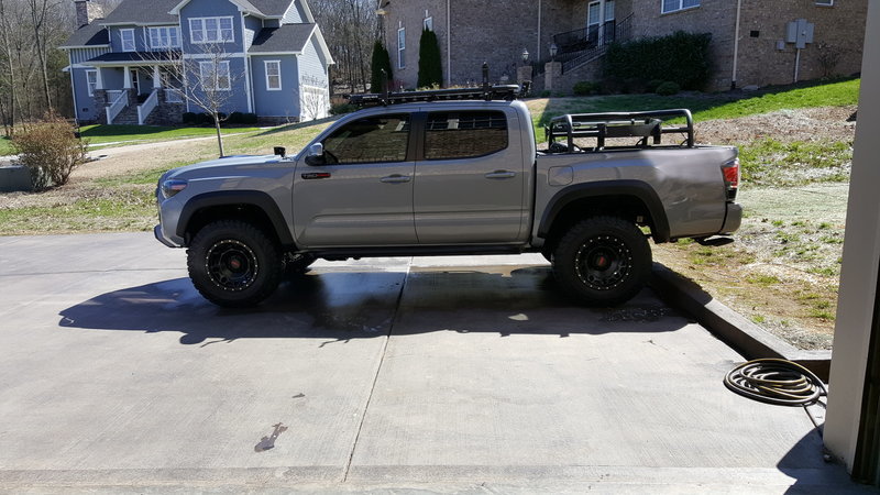

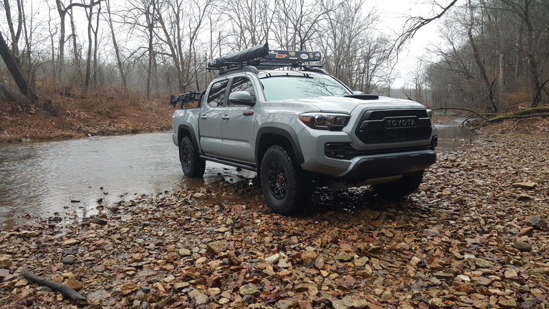

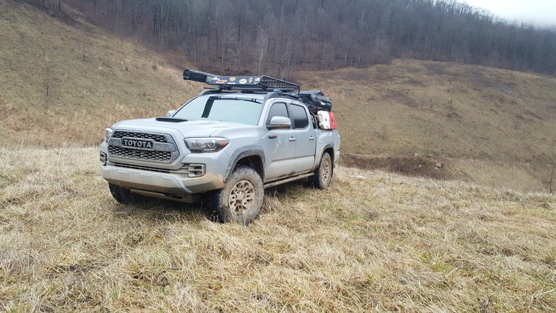

    Sure, it's the Firestone Ride Rite setup with Daystar cradles (bags aren't attached at the bottom, cradles are used instead so suspension is free to articulate). When the truck is fully loaded up with the RTT and camping gear, the bags really help maintain the same ride height and manage the weight.
    265-75-16 stock suspension, same setup fully loaded, 265's with spacer and AAL, no bags vs 285's with current setup.

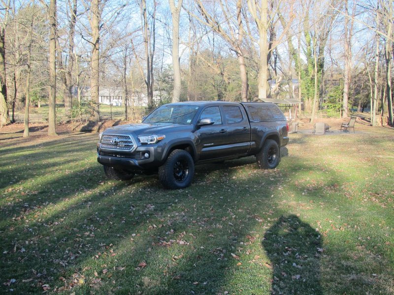

    285/75R17 Toyo AT2. 0 offset wheels. Factory suspension.
    Had a lot of rubbing, had to do a CMC and ground the pinch welds a little and reworked mudflaps and wheel wells. Love the way it drives now, but I am getting 4.88 gears put in Monday for more power.
