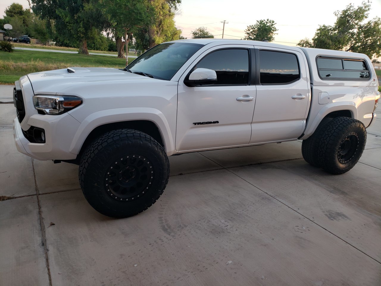

    I have a about 2-2.25 inches (ome887). Very skeptical about the 285s. I had fuel wheels from last truck and went ahead and had 285 ridge grapplers mounted on them . I have -12 backspacing and they have about 1 inch of clearance between rear fender as well as cab mount. Front of wheel well was a bit more. 0 rubbing so far . Only highway and city driving . No off-roading

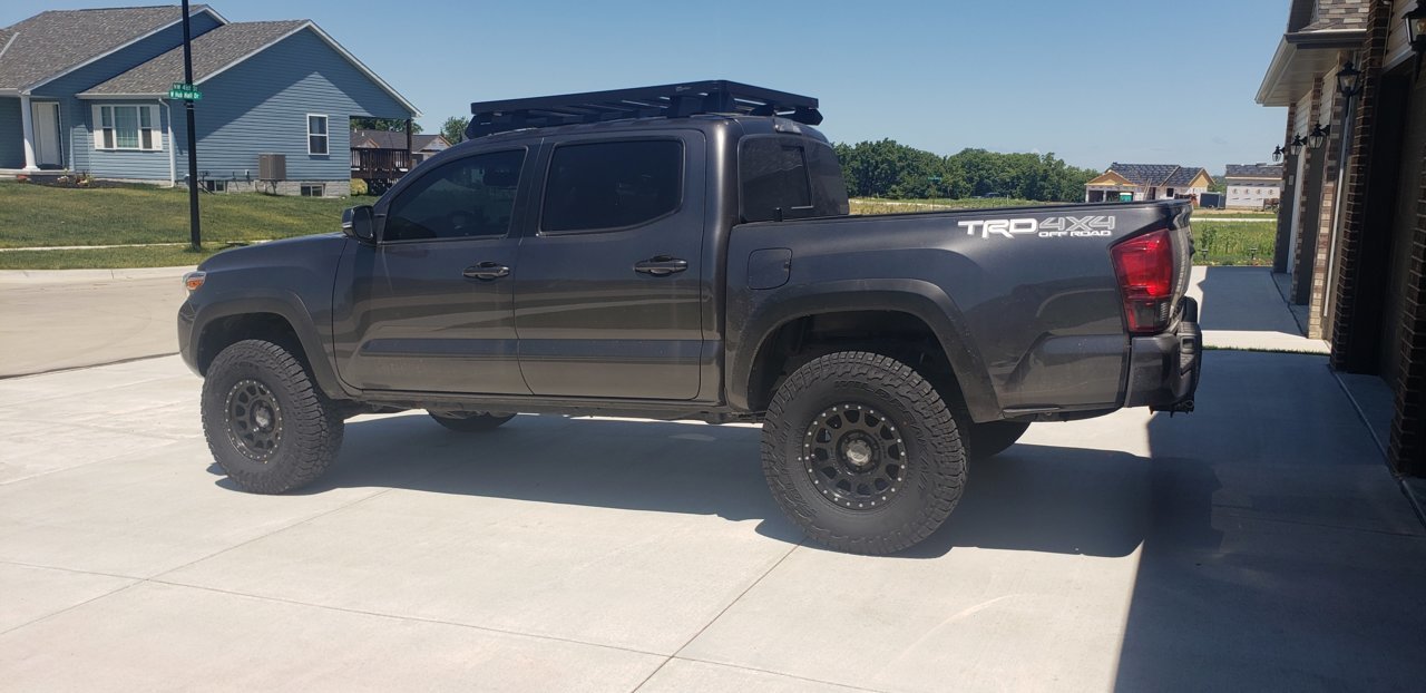

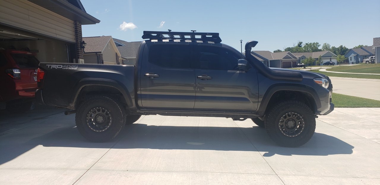

    285/70/17 Method 305 NV 0 Offset
    I have King Suspension (Extended mid-travel) & I still had to do the CMC even with the 2.5" of lift.

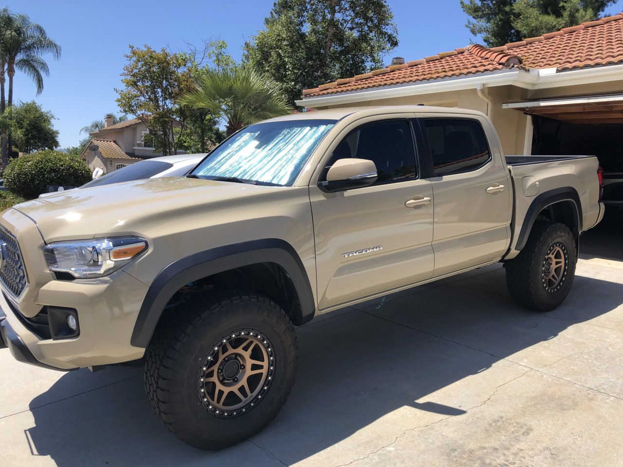

    interior lighting, ARB compressor, 17x8.5 0, 285/70 toyo A/T III, King susp, 74 weld uca's, 5.29 gears, MBRP axle dump exhaust

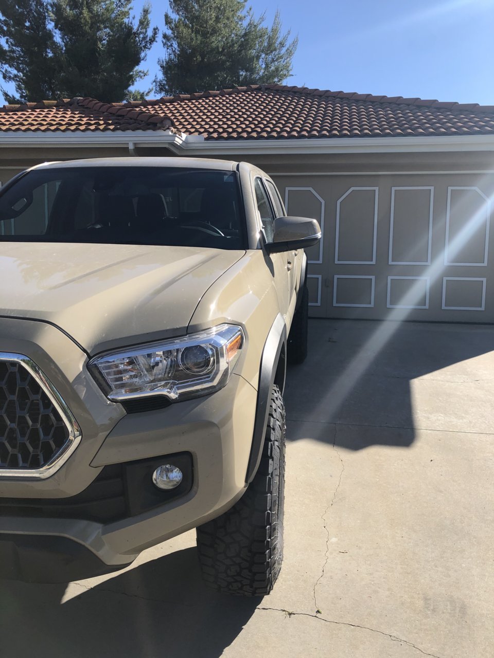

    5DC5BF4A-C2E9-4BA8-8B8F-445E8DC0BC86.jpg EB7F94E3-D812-4044-AAA2-032646CF7D66.jpg Method 312 17 x 8.5 0 off w/ Toyo a/t lll. I too had to do a cmc even with 2.5 lift.

    How are you liking those Toyos?

    Love em! They’re quiet and do well off road. Although I haven’t had any other tire to compare them to other than stock.

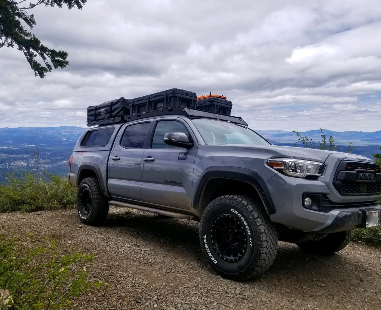

    Locked Offroad 2.5 SPC upper control arms 17” Konig Countersteer Type X 285/70/17 Falken Wildpeak AT3 PowerStop front and rear brakes

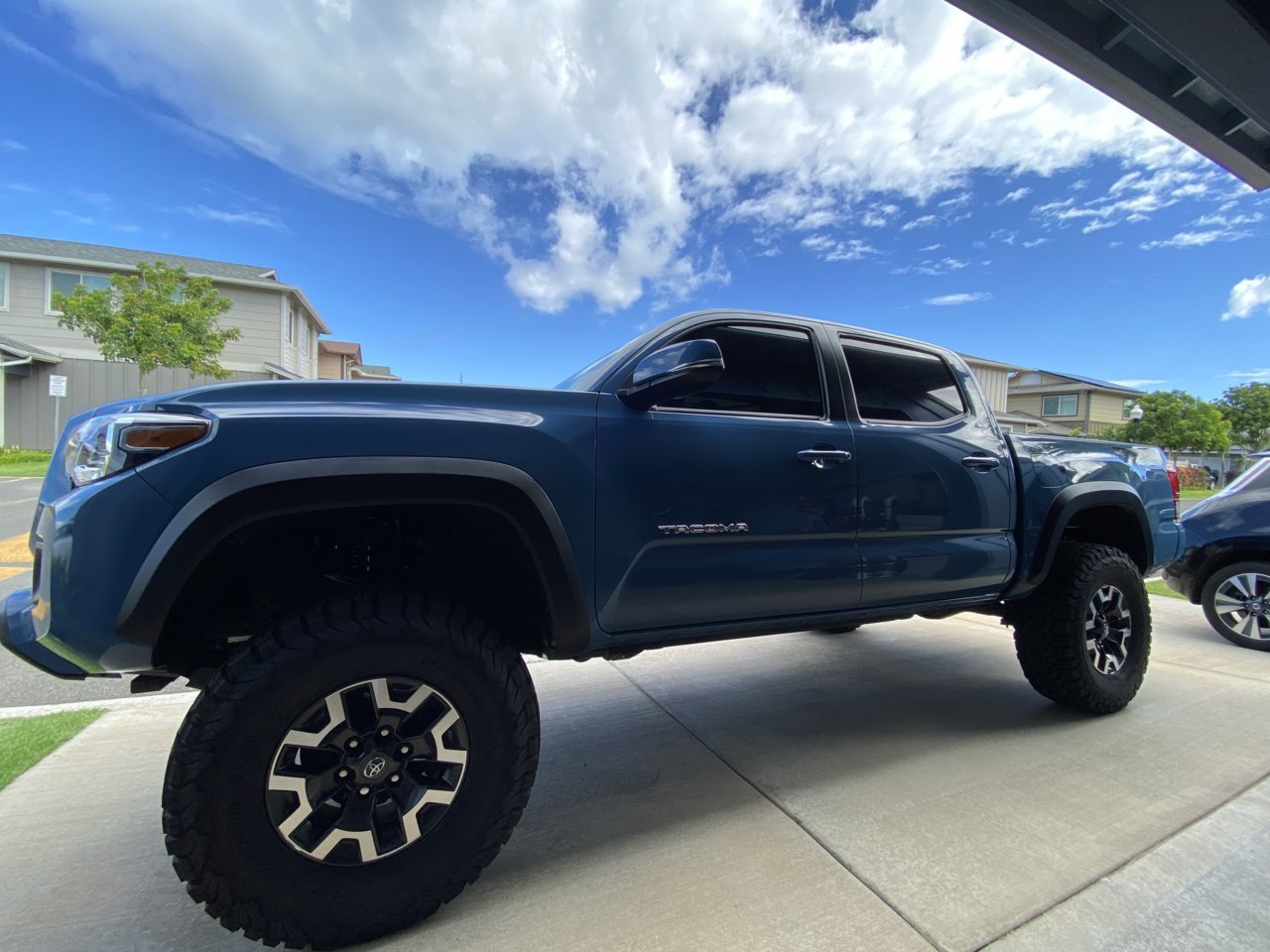

    285/75/16 lifted 3” front 2” back. 1.25” spacers, and Icon tubular UCA w/ delta joints. No rubbing or BMC.

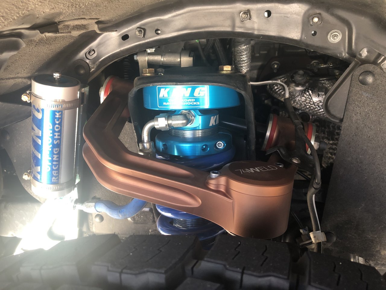

    No aftermarket UCA’s, just CMC? Any other clearance issues?

    I have 74 weld UCA’s. And correction, bmc65AB5BD2-E401-4130-9062-985EED2ABE94.jpg

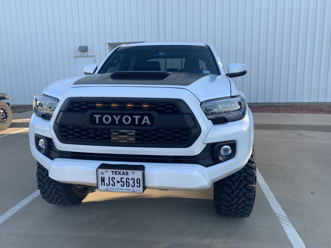

    33/12.50 - 17"
    Yokohama Geolander MT

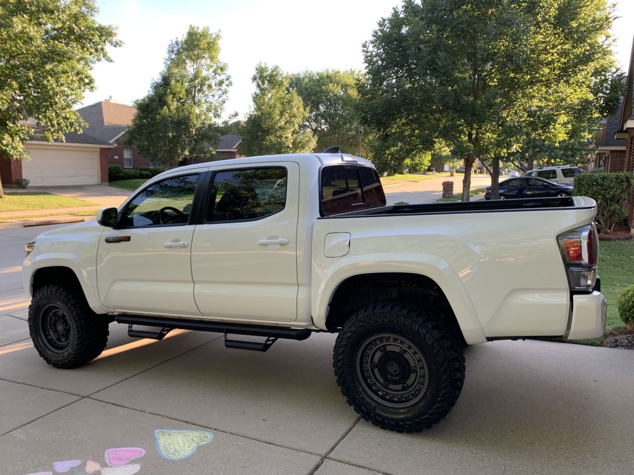

    I have 33/12.50-17 with a 9.5" wheel, 4.5 back space and -18mm offset, I have 3" level kit, barely rubbed some plastic which didn't have to be cut, just a hole relocated and inner fender tucked back. No CMC. Caster is moved to +1.5 to center the wheel.

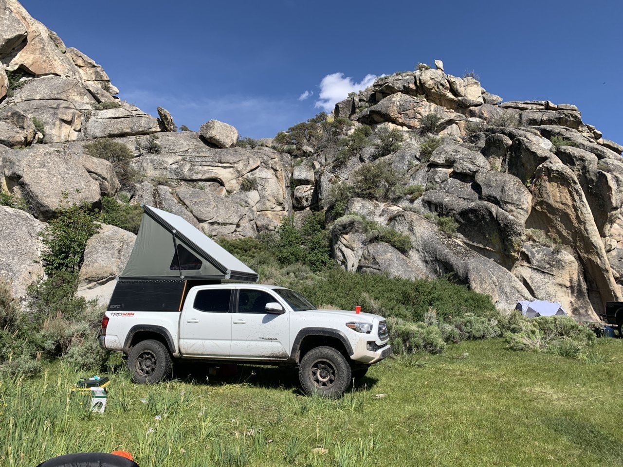

    New Falken Wildpeak AT3Ws in 285/75/16 installed today. Huge ride improvement over the STT Pros.
    Bilstein 5100
    Max setting up front
    1.5" blocks rear
    16x8 0 offset 4.5 BS Method NV
    No CMC, UCA, or rubbing

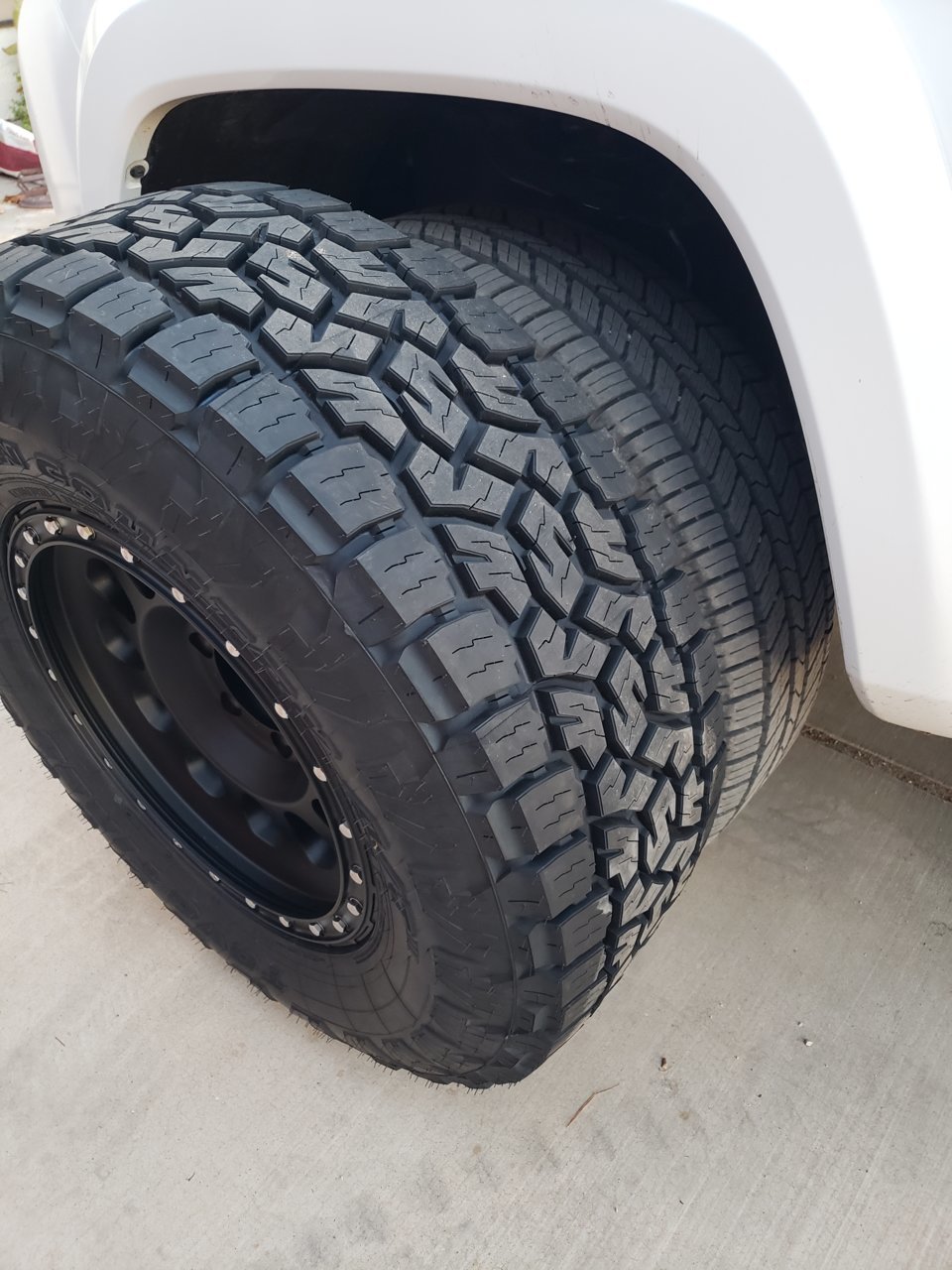

    Eibach Pro Lift - Toyo AT3's 285/70/17
    Installing after the weekend. Cant wait. 285-70-17 Toyo Open Country AT3. Will post video to my instagram.

    Nice looking truck bro!
