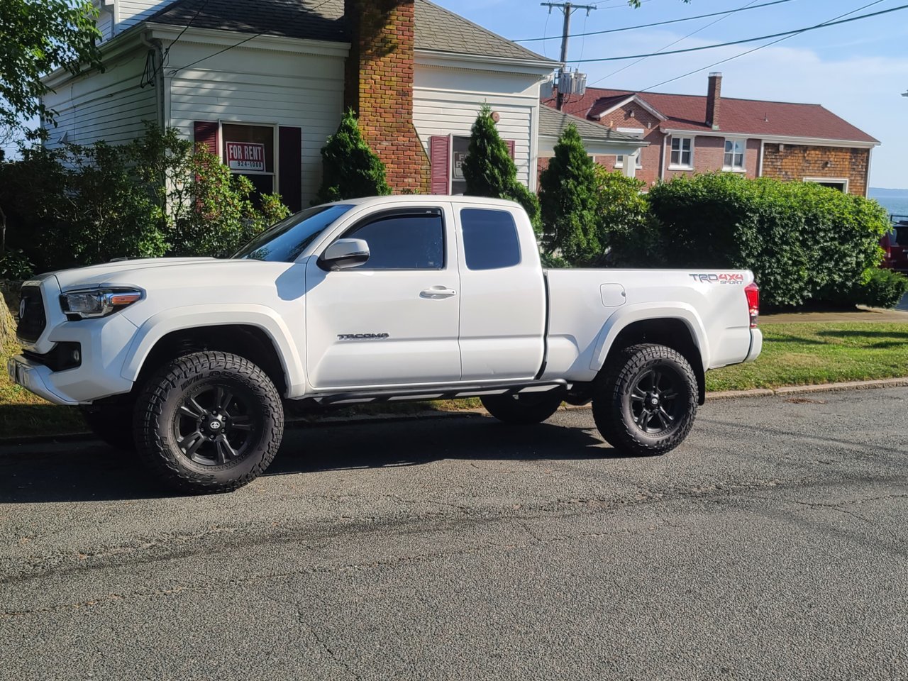

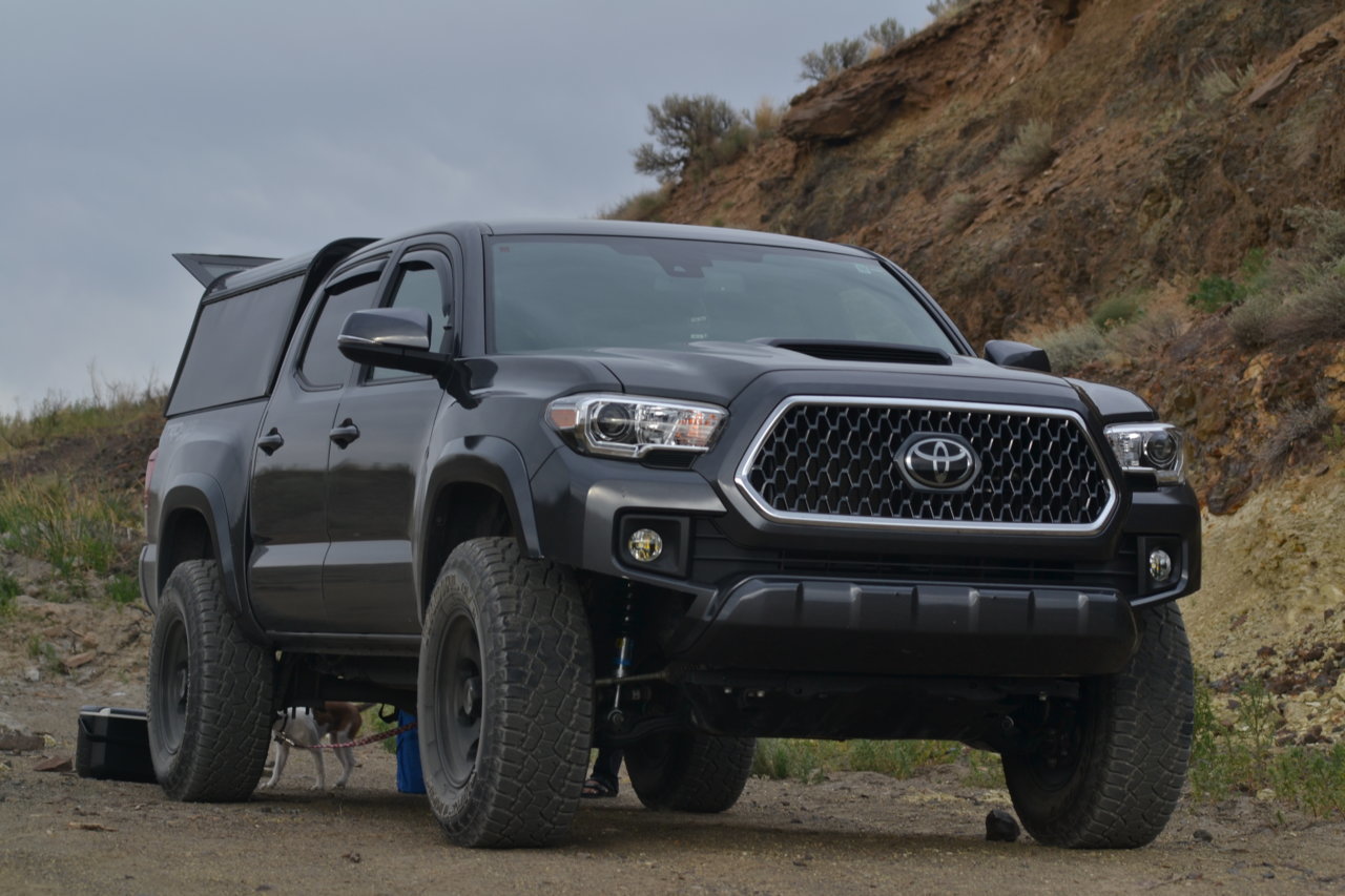

    Running 285/70/17 on bilstein 5100 / OME 885 matched with Rear on 2” block! I think the 885 settled to like 2-2.25”.

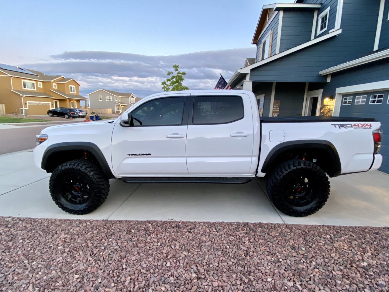

    Toytec 2 inch boss lift
    285/70R17 with Nitto Trail Grappler MT’s 67FBD025-72DD-4FAD-97BE-364B7B3442C9.jpg

    Damn just noticed your viper cut!

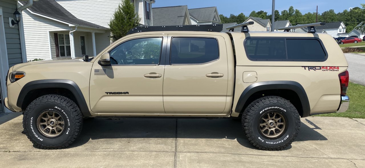

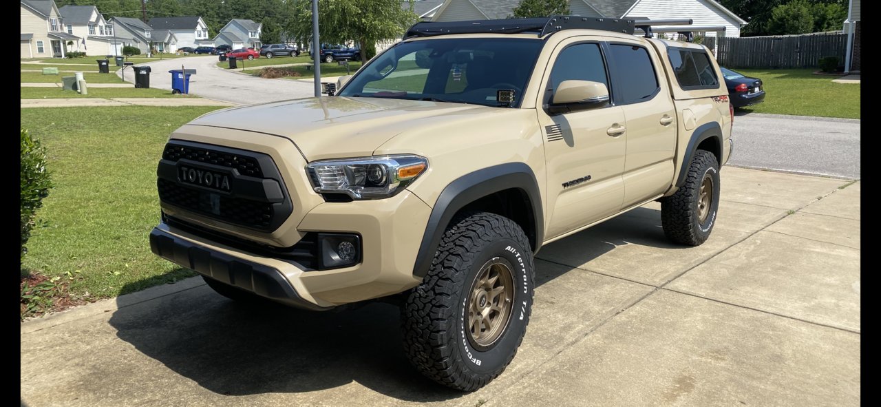

    285/75/16 BFG Ko2 on Bronze 16x8 -12 VTX Rogue wheels, 2019 TRD Pro suspension, Rubbing when fully locked, CMC coming soon!

    Nice looking truck!!
    How bad is the rubbing? Is it on your UCA or the fender? Would spacers prevent having to do the chop?

    Spacers push the wheels out and increase scrub radius, thus causing more rubbing.

    No rubbing on UCA with appropriate offset /(4in of backspacing), however like Beef Nachos said, my offset made the CMC necessary, I also had the pinch weld flattened for good measure if I ever wanna go larger. Most of my rubbing was on fender and the cab mount. I also trimmed plastic. I have no rubbing at all now.
