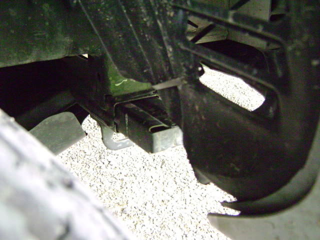

    In my build thread, which is at the bottom of my post, you can see the pictures of the plastic cutting that is required. I got it below, thought I had posted more pictures of what I cut.
    "I have also removed my front mud flaps and cut and zip tied my inner fenders to keep them from rubbing.

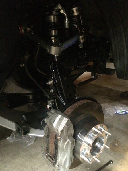

    I have to run spacers but not for the uca. The lca has a secondary shock mount that will hit the inside of the tire at full lock. This is per the mfg.

    this picture shows the tab I mentioned
    Bottom left of photo
