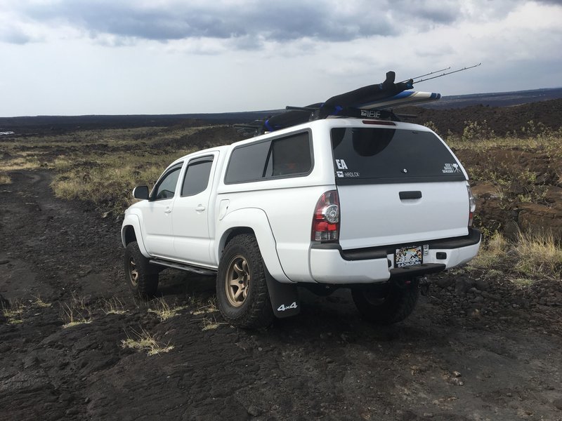

    cubiclesurfer
    cubiclesurfer Well-Known Member
    Aug 1, 2012
    #83894
    1,438
    Kailua-Kona, HI
    16x8 FN Countersteer (4.5" BS, 0 offset), 255/85 Cooper ST Maxx
    front - Icon's set to ~2.5", LR UCA's aligned with 3.8 degrees caster
    rear - Dakars (~3")
    no CMC, and rubs on the front fender liner a little on sharp uphill turns, or in reverse.
