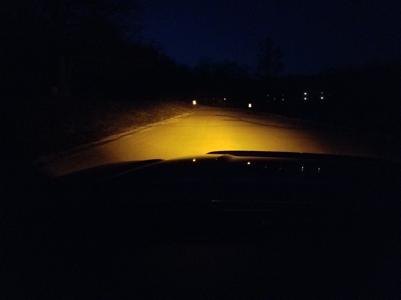

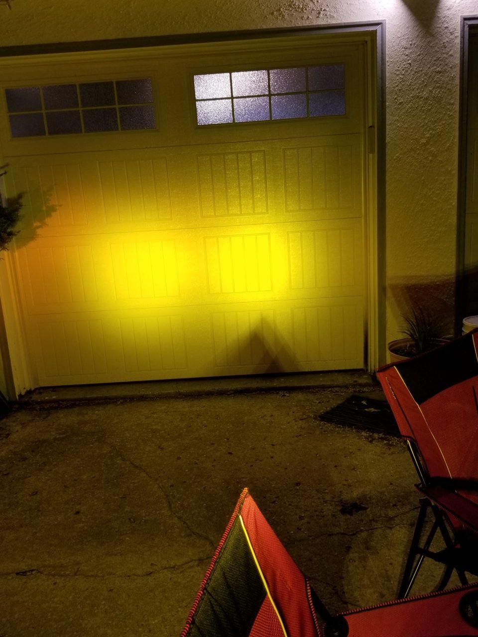

    This is going to be the next step in my lighting upgrade. This is the Black Oak amber flood at about 5 feet. The beam definitely opens up further out into a good flood when I shined it around the yard. I tried to upload a video comparing it to the fogs but it has the wrong extension. The color is a spot on match for the kc hilites amber fog with similar brightness. FYI, I assumed they were sold as pairs but are actually come as singles with a nice harness.

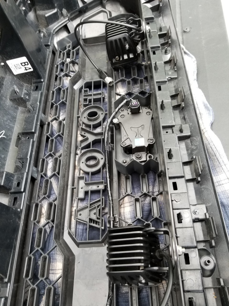

    I got my first big step in my lighting upgrade done today, a pair of Black Oak 12w amber floods. The wiring is just going to be on there for a couple of months until I upgrade to a light controller but Black Oak does seem to do a nice job with the universal harness. I'm actually surprised how well the install went. The hardest part was pulling wire through the grommet. I ended up using a piece of romex for a fish.I just mounted them on the back of the "valence" on the bottom of the grill surround. I think I'll end up Modifying a SDHQ setup down the road but it'll do for now. I'll start dropping some pics in case anyone wants to follow this up.

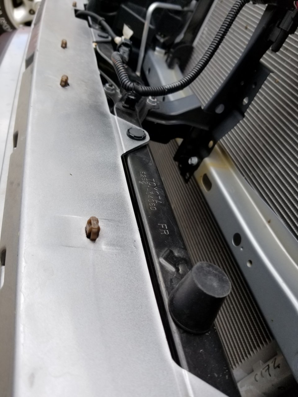

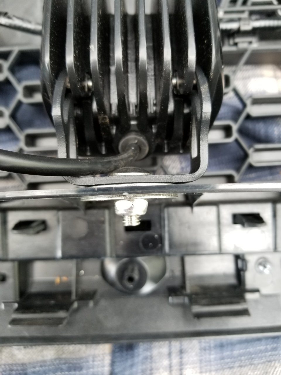

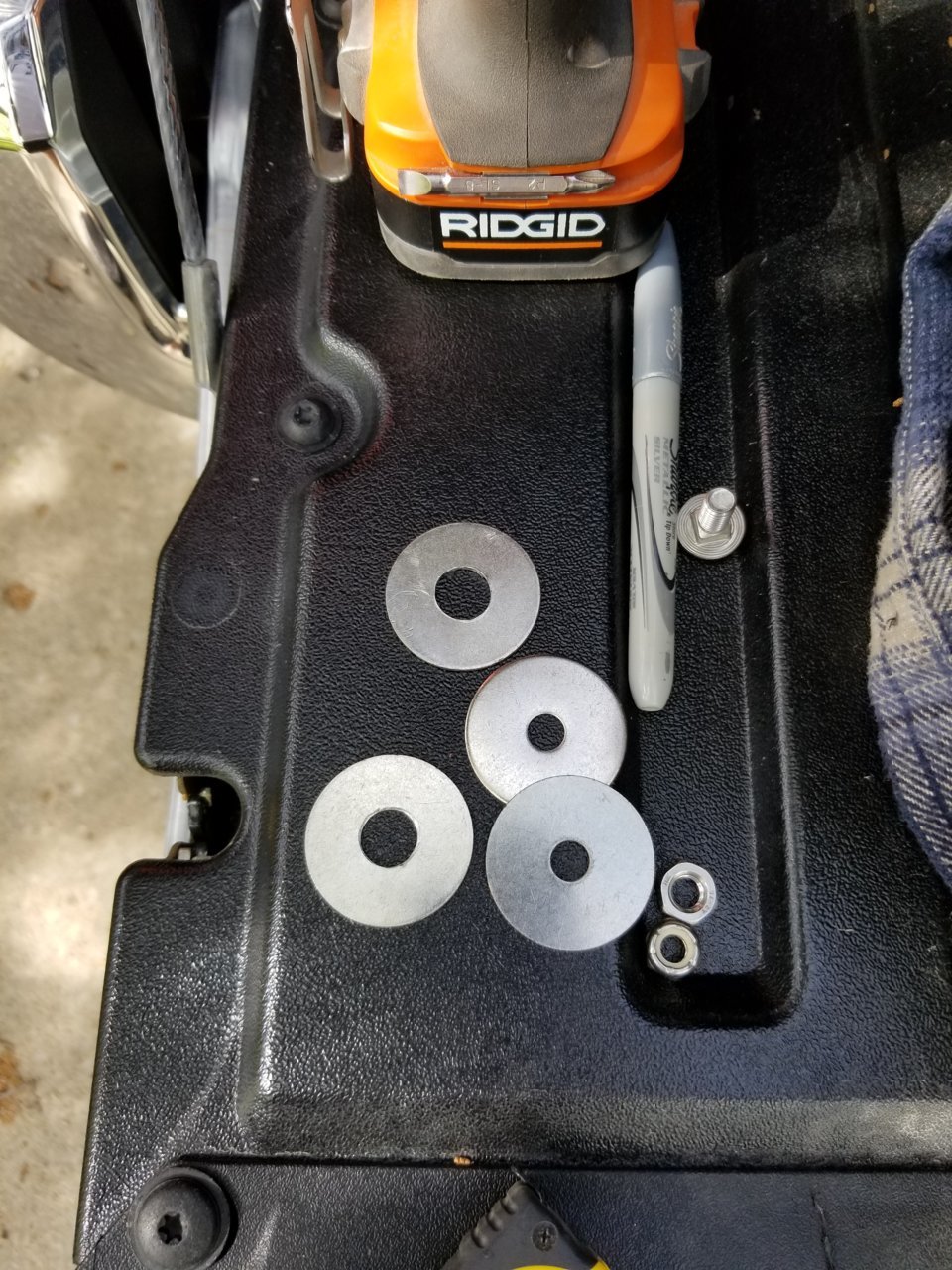

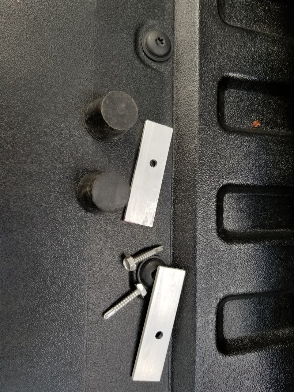

    I was looking under the hood for a spot to mount from but there is almost no metal fittings to work with however there is a stamped cross member that runs right behind the back of the grill. Its pretty flimsy but it has a couple of holes in it I thought I could use to beef up the plastic a bit. I ended up making 2 aluminum washers from 3/4" strap and using a self drilling screw and a couple of rubber stoppers to carry some of the load.20190418_160657.jpg 20190418_160854.jpg
    All installed. I think they were #4 stoppers. They are just a little short and I'll figure out some way to put some some load on them later. The stoppers are both 12" off the centerline so I drilled a couple of 5/16 holes 10" off center 1 1/4" from the back edge and used some fender washers to help spread the load out over a greater are because I hate using plastic to bear weight. The spots I drilled are between two small gussets so its about as strong as a can be where its at. I had to drill out the fender washers on the mount side bc the square part of the carriage bolts were longer than the supplied ones. Also I used shorter carriage bolts than came with the kit bc I wanted as much clearance over the fog light wiring as I could get.20190418_163525.jpg 20190418_164404.jpg 20190418_164409.jpg

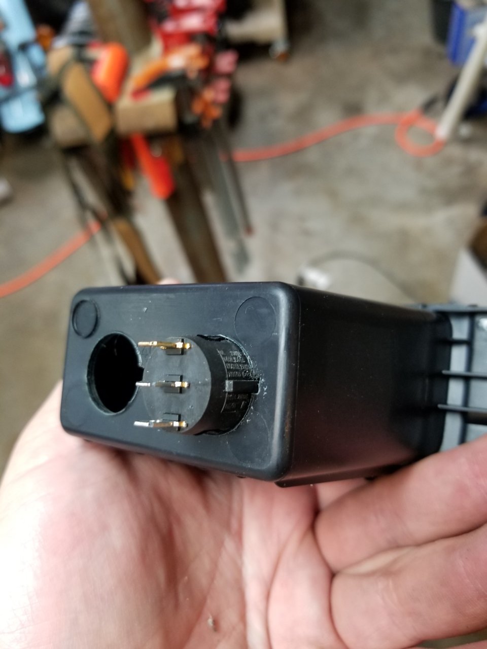

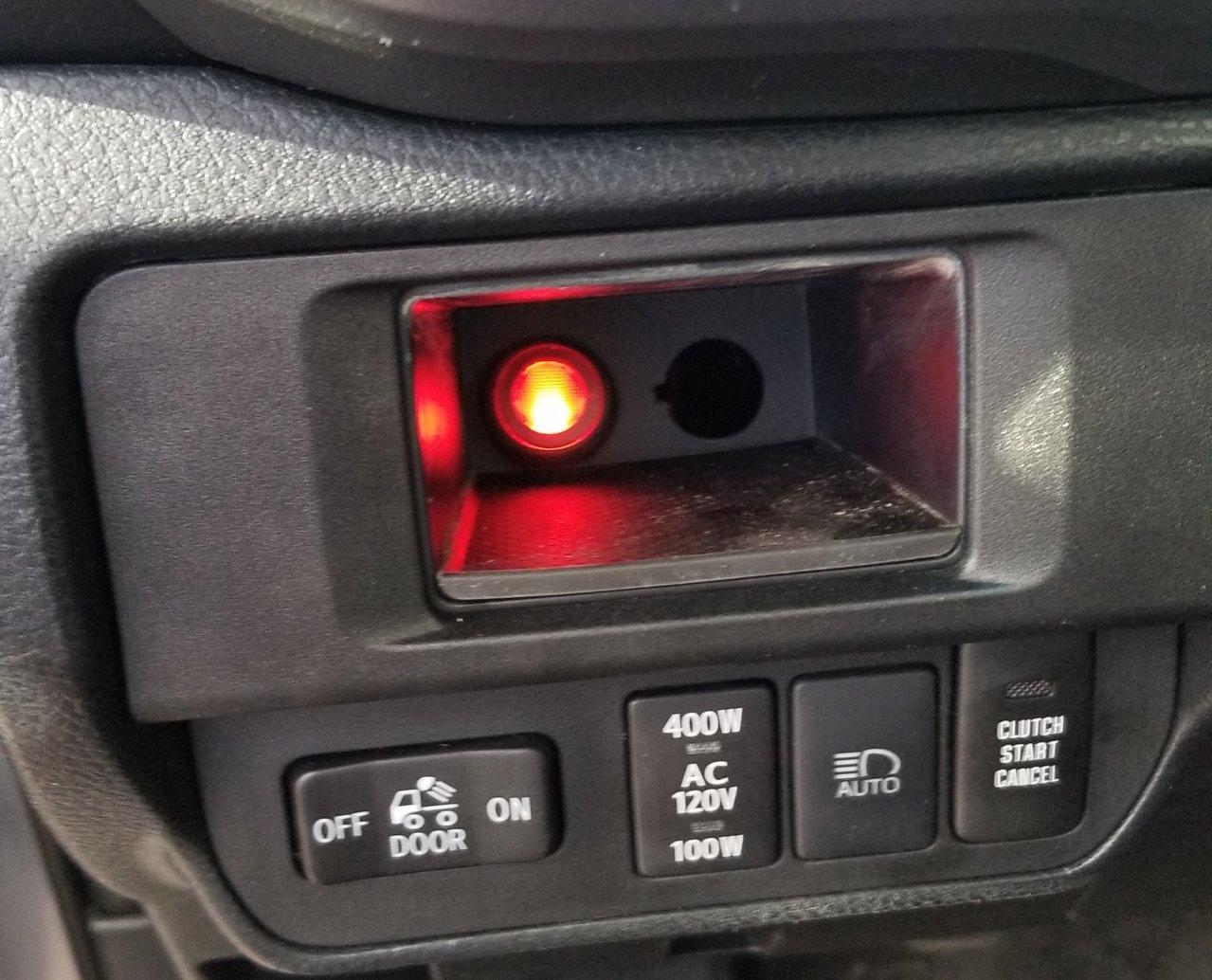

    All mounted up and ready to reinstall. I decided to hide the switch in the cubby so I took it out and fitted the switch in the back with a forstner and a file. I drilled a spare hole in case I add another circuit before I get a switch controller.

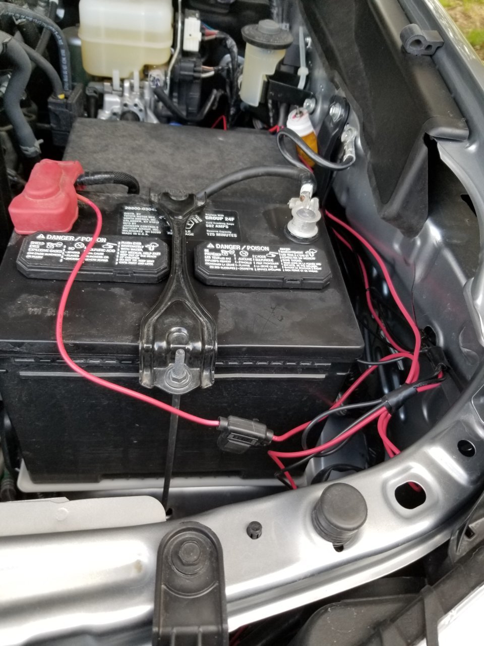

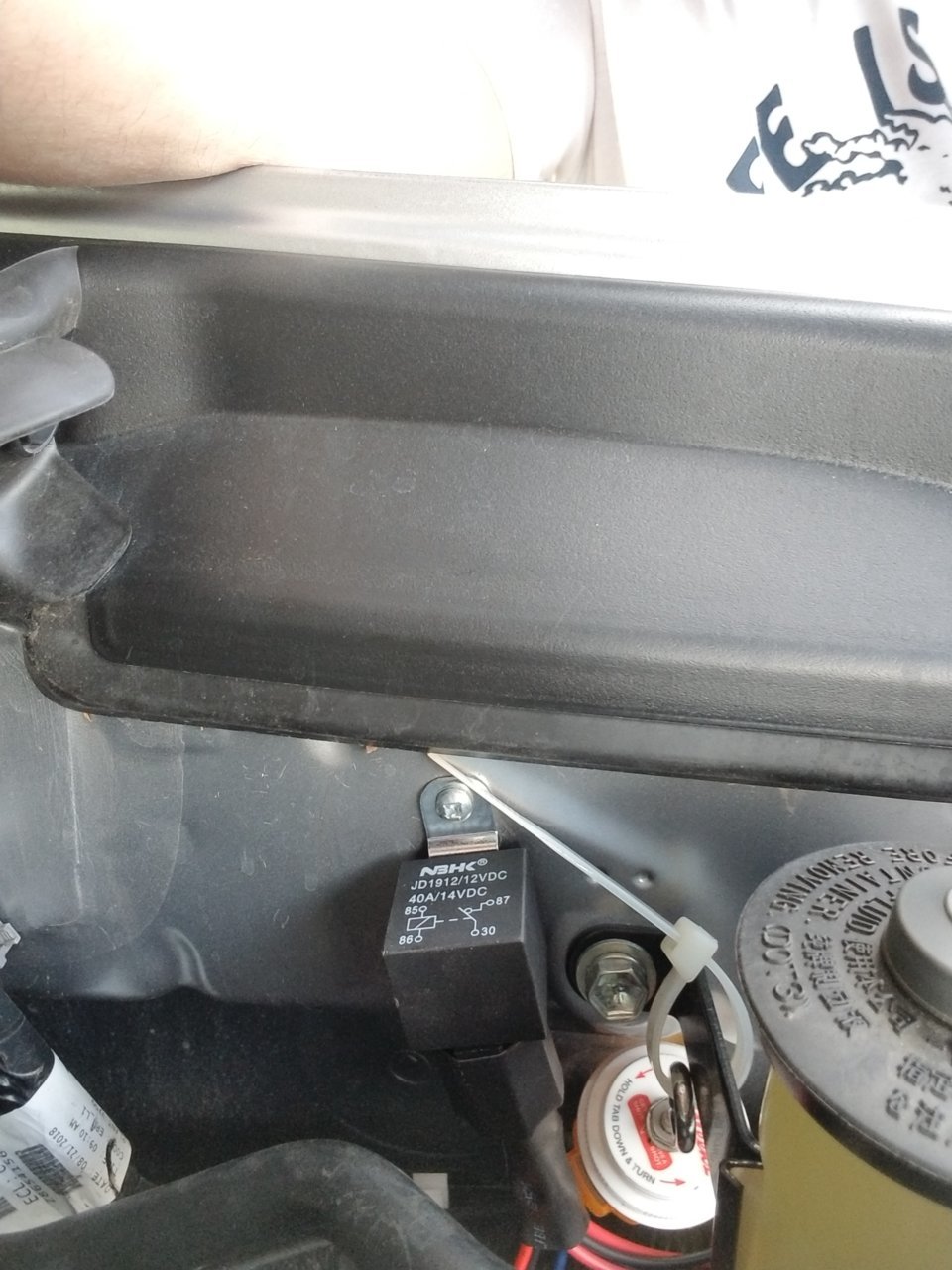

    all tucked away and hidden. Next was the wiring. not too difficult but getting through the grommet was tough for a first timer. The harness seems good quality but its definitely one size fits all.
    I tucked up the extra wiring as best I could and hooked it up.20190418_182949.jpg

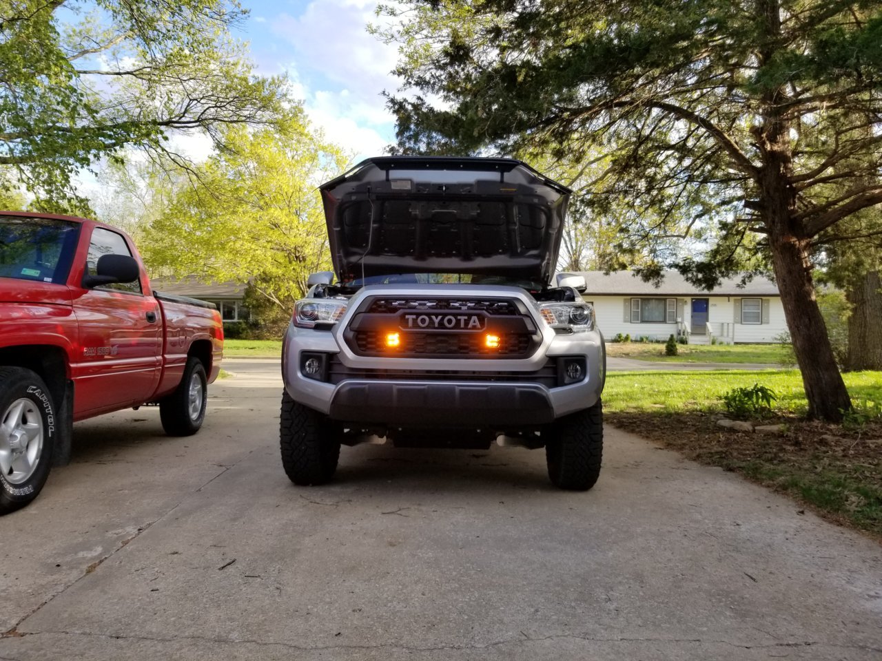

    Amber pods only.
    The lights seem to be of great quality and have the ip69 rating so hopefully they last a long time. They are only 12w lamps but they seem to give good light. My next set will be spot pattern and higher wattage, maybe a set of squadrons. I think if I go this route I would like to be able to match my headlights but in amber.

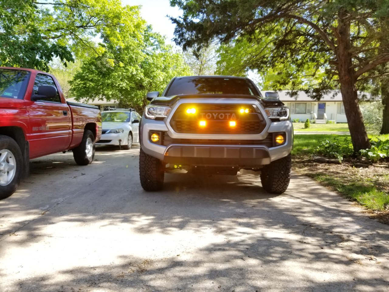

    20190503_210836.jpg 20190503_210632.jpg @OffroadAlliance your truck is the one that got me going this route. I've got a pair of KC flex that are the next upgrade.
    OffroadAlliance.com likes this.
  13. May 5, 2019 at 4:54 PM
    Lunchmeat79
    Lunchmeat79 [OP] Well-Known Member
    Sep 28, 2018
    #267750
    220
    Kansas
    '18 Off Road

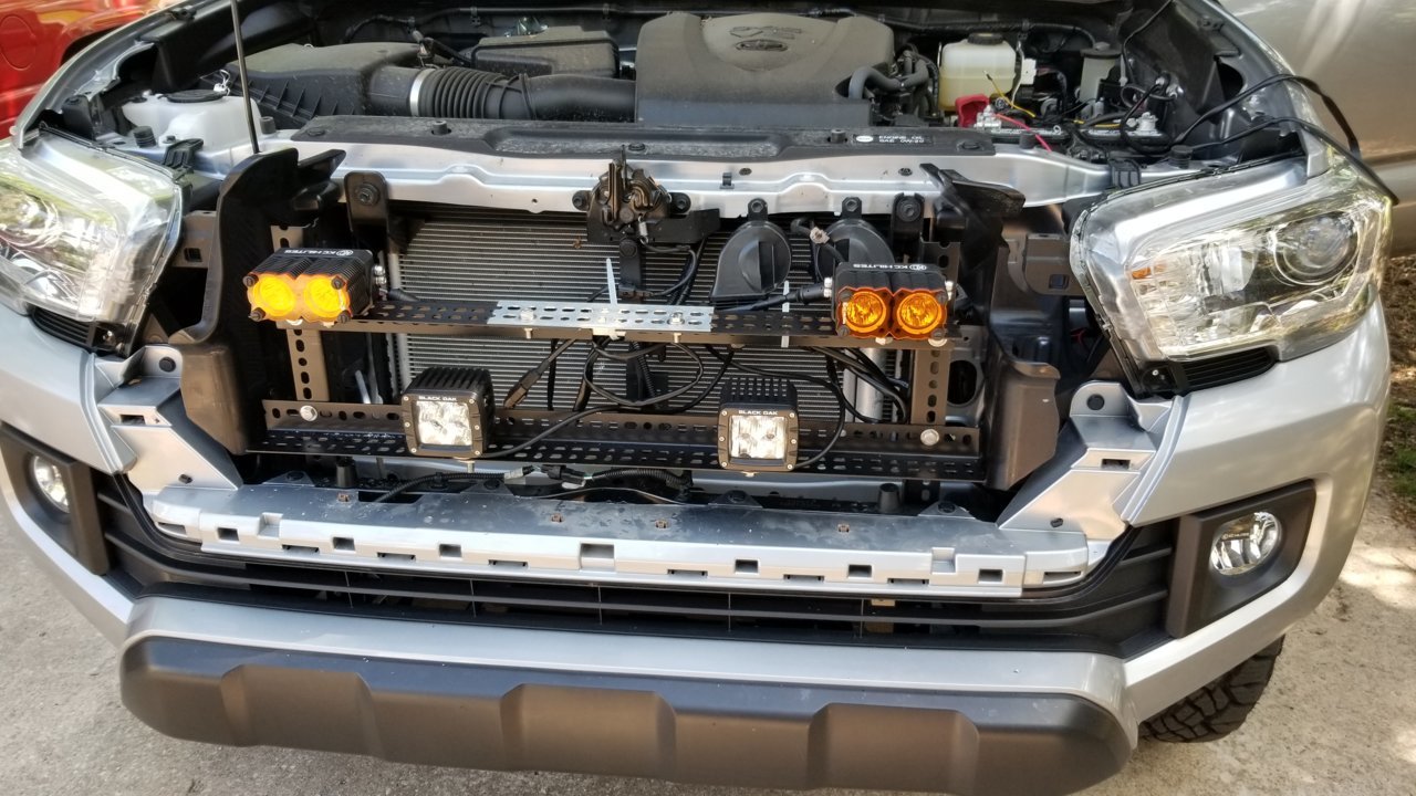

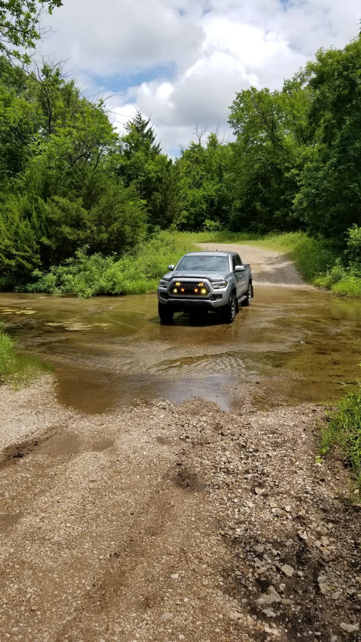

    20190505_165303.jpg 20190505_165303.jpg I upgraded my setup today. Made a frame out of perforated angle bar from the homesupply store. Bolted a together and mounted to the back of the aluminum bumper. I didn't get many pics of the install. Getting the mount started was kind of a p.i.t.a. Will add them next post. Right now running a pair of black oak 12w amber fllod pods and a pair of kc dual with much more room. Could probably get in 2 more pods and a 20" lightbar. Here are a couplepics of where I'm at.20190505_160845.jpg 20190505_160845.jpg

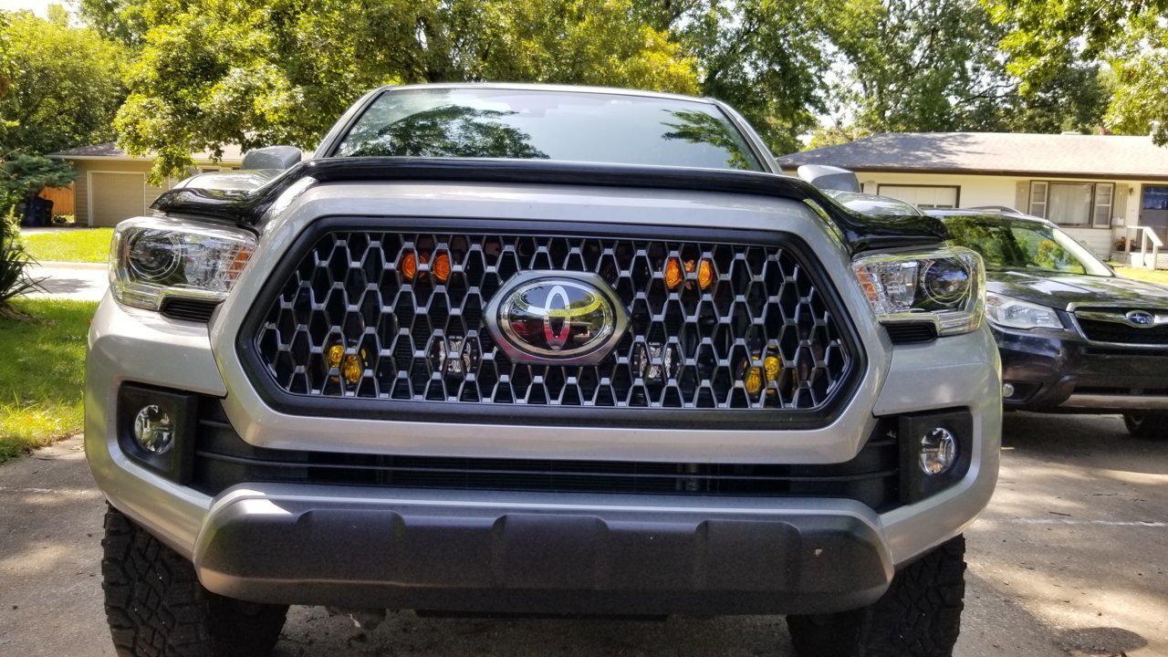

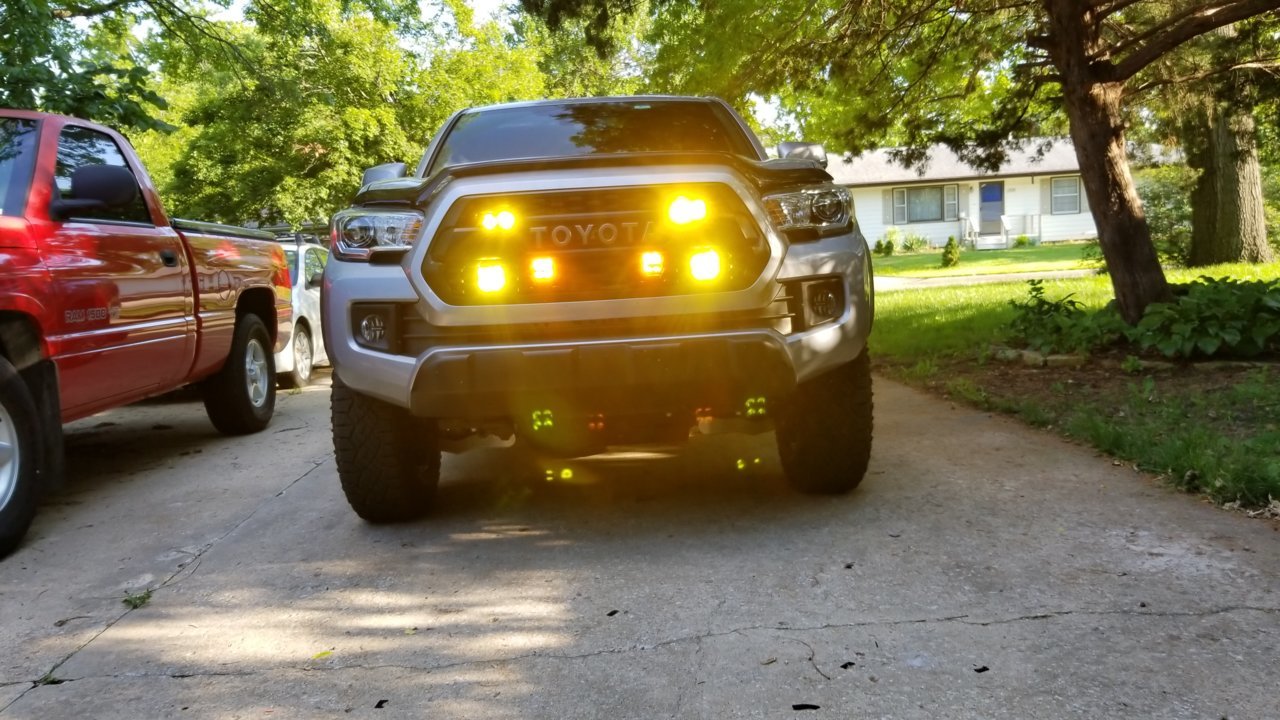

    Got my baja squadron sports mounted a few weeks ago. New to concentrate on my switch pro. Love the Amber's! So easy on the eyes. 20190619_142319.jpg 20190614_184156.jpg

    I know this thread is 4 years old but ... OP I'm looking to do something similar this weekend with the perforated angle bars. Do you have a picture of the mounting point on the bumper? I did some eyeballing and didn't see an existing bolt. Did you drill it out or am I blind and missing a mounting point? :fingerscrossed:
  17. Jan 20, 2023 at 5:44 PM
    Lunchmeat79
    Sep 28, 2018
    #267750
    220
    Kansas
    '18 Off Road
    I mounted them to the back side of the aluminum push bar. I drilled pilot holes and used big self tapping stainless screws. Still holding strong.

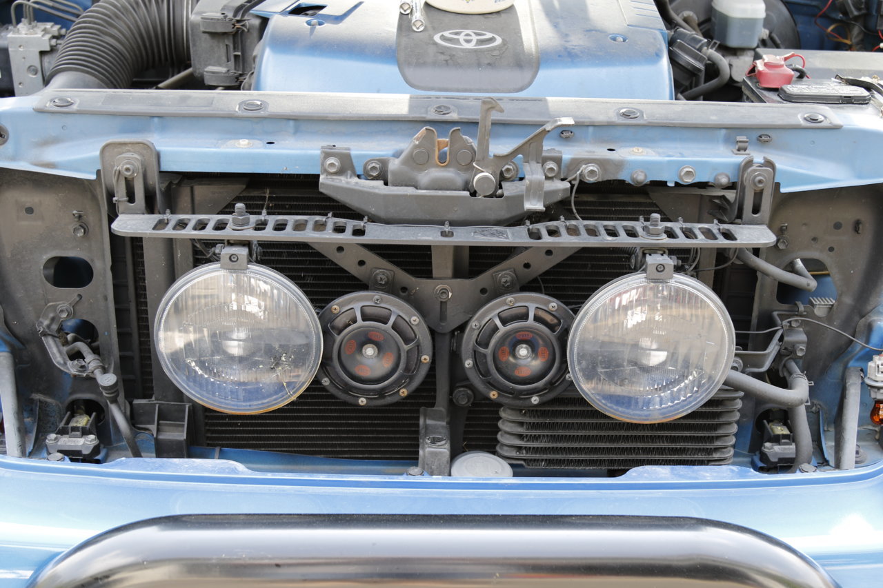

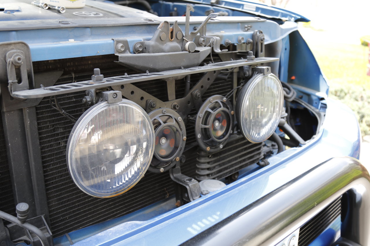

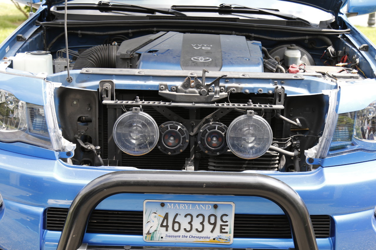

    Here's mine. The bracket was from a group buy here a very long time ago (2014???). The lights are Hella Black Magic. Those horns are gone and replaced with the 4-note GM "train" horns.
