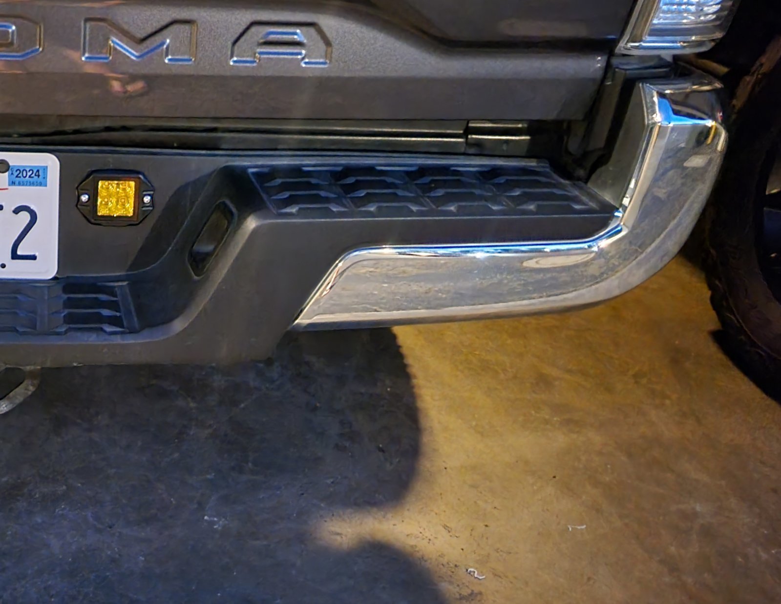

    Auxbeam 3.5" pod light, a 10 foot harness extension, and an oem looking foglight switch.
    I installed it using a Job One oscillating tool.
    Auxbeam 3.5 Inch Amber LED Pods Light, 40W Flush Mount Flood Offroad Driving Cube Lights Fog Yellow Reverse Light Backup Lights Motorcycle Taillights with Wiring Harness Kit - 2 Lead https://www.amazon.com/dp/B0CGWX5Z8K

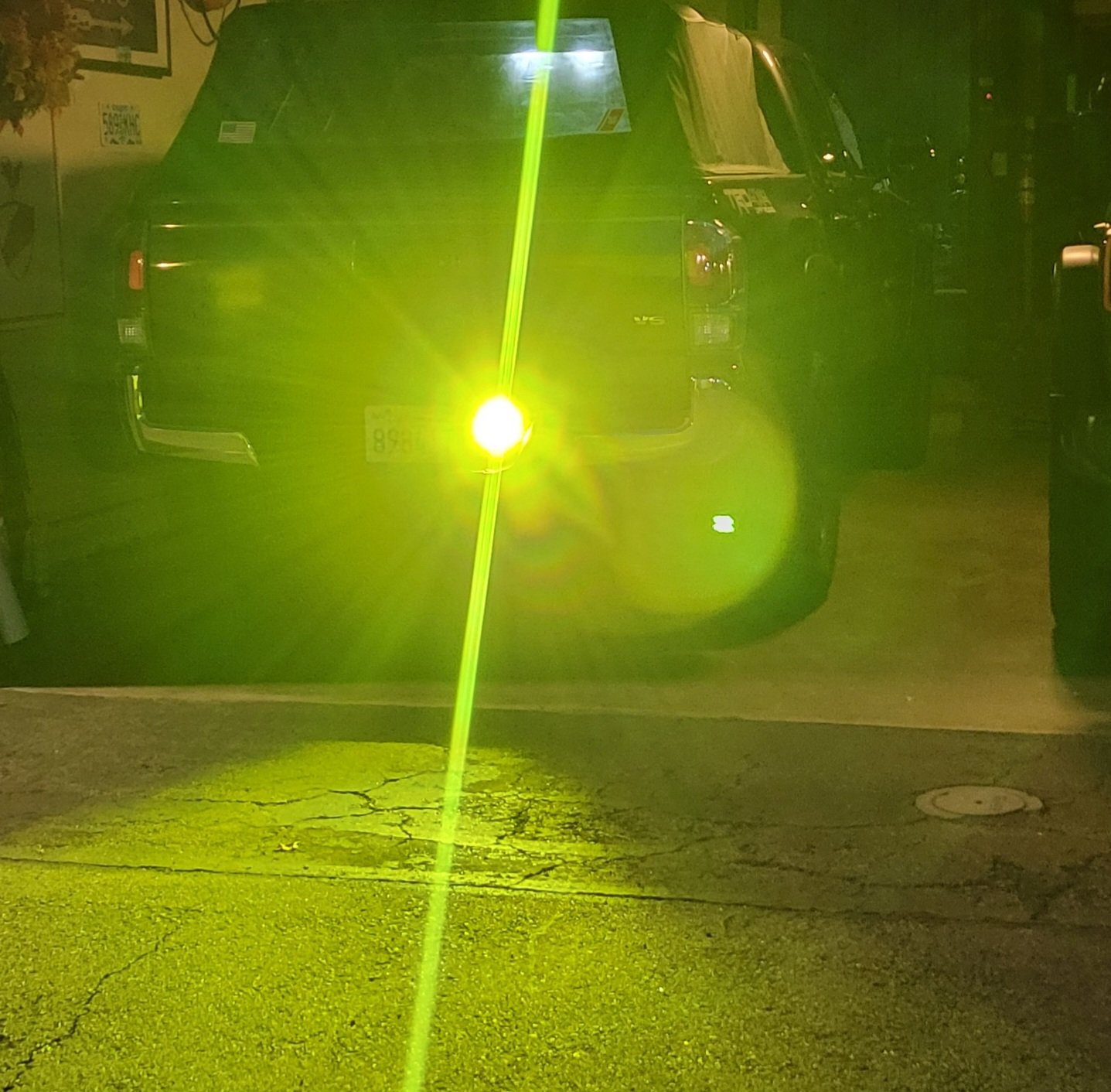

    not so much 'chase lights', as i'm about 25 hours from the nearest offroad race, but i did do backup lights so i can see behind me. i generally prefer to see things BEFORE i hit them...
    i used a set of 'side-shooter' lights. specifically, i needed a version that the outer lens is easily removable, with a steel base for welding, and preferred a version that was somewhat rectangular/narrow to keep it from dropping down too far.
    https://www.amazon.com/gp/product/B08DFVD72X/
    the whole reason for the removable lens is so that i could add a piece of lenticular film in front of the spot reflectors to further diffuse and spread the light behind the truck, because i'm more concerned with brightness within the first 10', and don't care about distance beyond that.
    i welded a longer 1/4-20 bolt to the mounting bracket, and then used a conduit spacer to drop it down just below the bumper to optimize the aim.
    it turned out very nice, with output exactly how i wanted-- from the rear tires back.

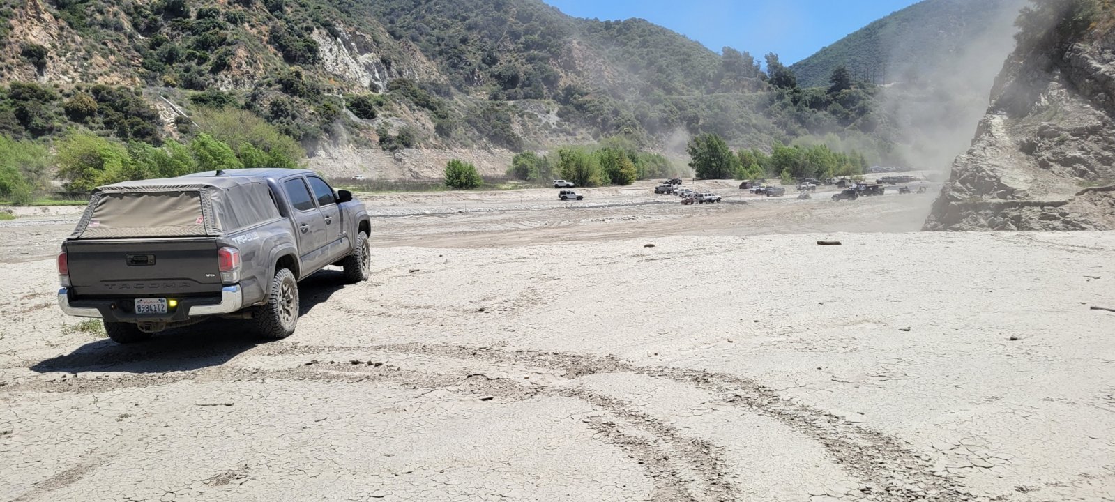

    Here is the Auxbeam coated in silt, and at an angle. My headlights are on, so you can see that my taillights are barely showing up as on.
    It did ok I think for the cost, but if you're spending all day in the silt (think Baja Peninsula), you probably want something that strobes, and is at the top of the vehicle. I saw a few Baja Designs S2 lights on trucks and they didn't do any better. So, my opinion is, if you are mounting a small light somewhere below the roof line of the truck, anything that is at least as bright as this Auxbeam will do, without spending big bucks on BD or even Diode Dynamics....

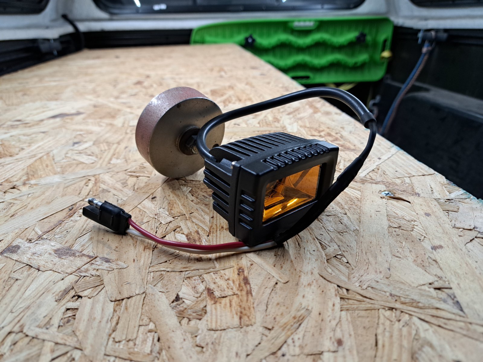

    I don't have any pictures, but I bought a pair of lights, wired one to a flat 2 connector (think trailer connector, but 2 wire). The first 2 wires on your flat 4 are ground and running (tail) lights. I then mounted it to a very strong magnet that I had, which would stick well to my aftermarket bumper. You could easily find a way to bolt it to something, I'm sure.

    I was wrong, I did have a picture:

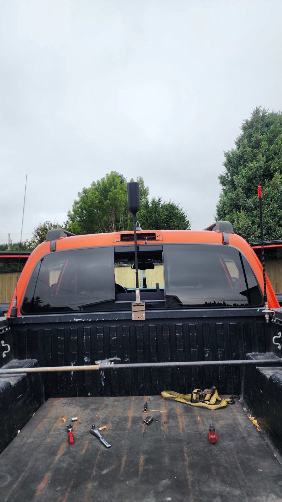

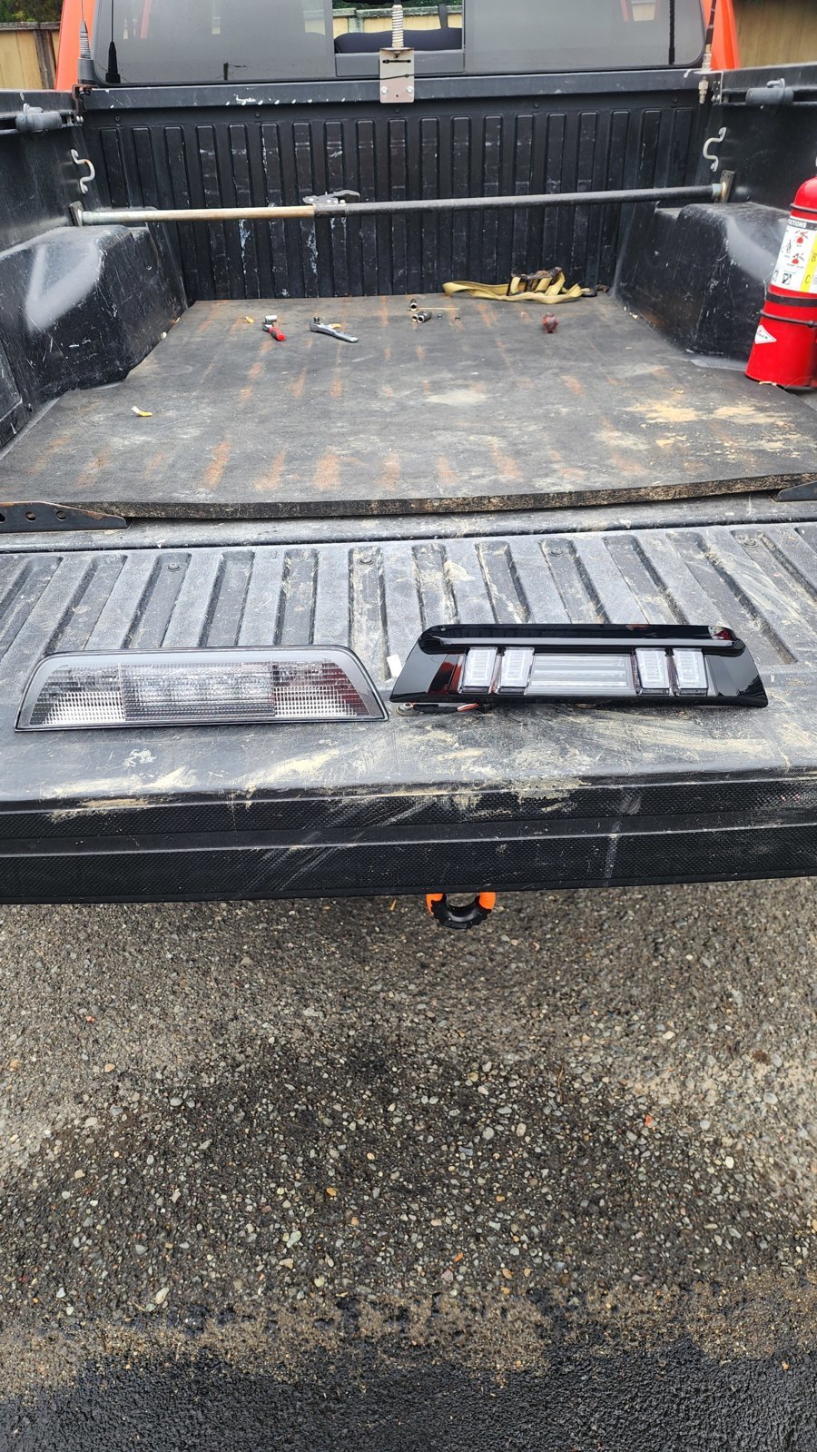

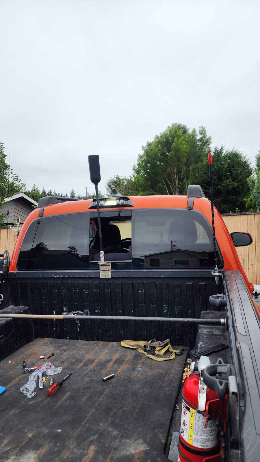

    Had this for couple years on the shelf just got around to install yesterday . Pretty easy besides getting 10mm nuts back on

    Did you have to drop the headliner to install that? ……big pita?
    Got a link?
