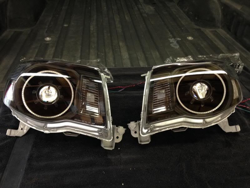

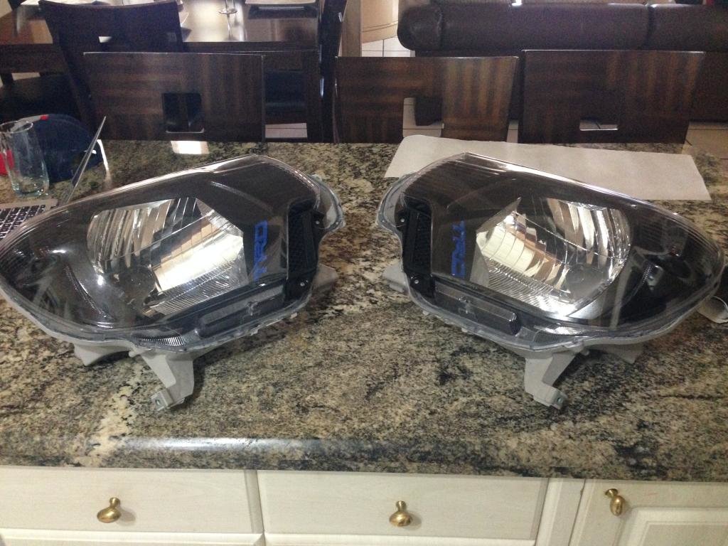

    Finished mine! Easier than I though just took my time.

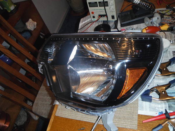

    Just a few LEDs...
    BHLM with a twist...

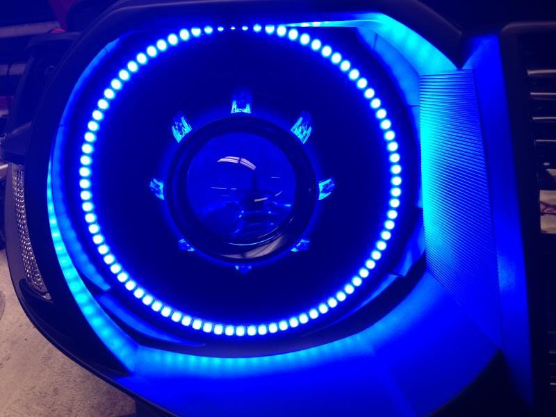

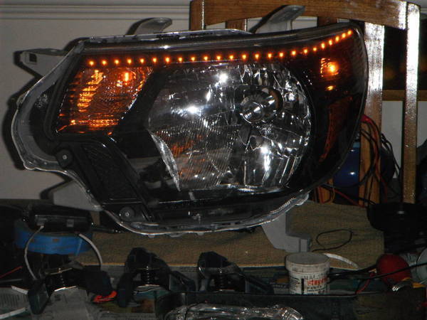

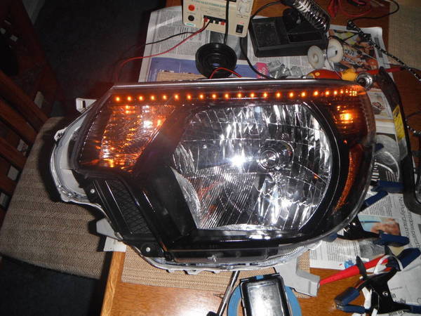

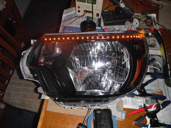

    I am currently running amber led strips behind the raised lip at the top of the headlight housings. I figured since I'm doing the BHLM, I might as well put a strip inside the housings. I can't wait until I get the other one done and get them installed. It's going to look wicked. :D

    HID's, LED Dash swap, LED reverse lights, 15"x10" 5 slot mags, sliding rear window, 20gal aux. DS fuel tank,

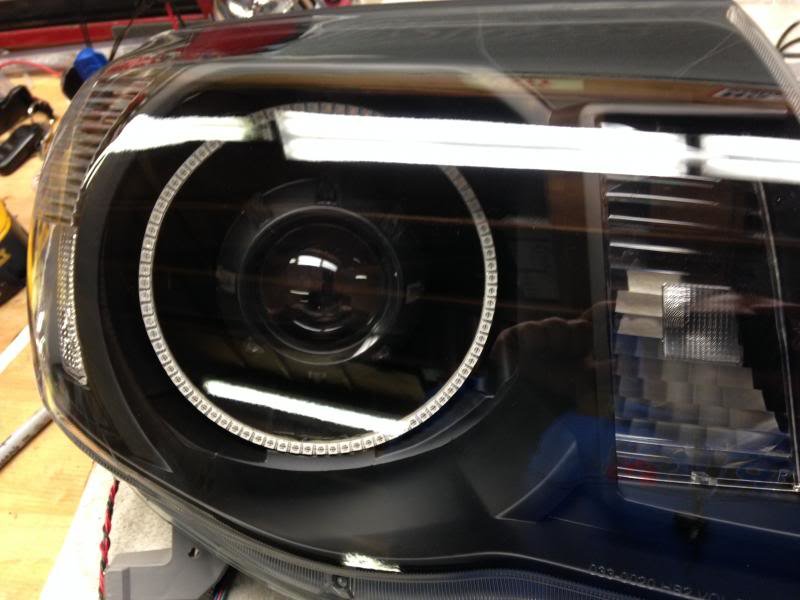

    This is what took a while, and a steady hand too. I installed the strips on the bezel then used a small paint brush to paint the area between each LED. I sprayed the paint into the top for the can and dipped the brush in it. After the paint on the strips was dry, I masked them with tape and spray painted the rest of the bezel.
    I'll probably take some step by step pictures when I finally get around to doing the passenger side.
