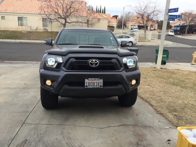

    Dr. Jekyll
    Dr. Jekyll Well-Known Member
    Aug 31, 2008
    #8899
    1,862
    Jimmy
    Honolulu, HI
    2015 Black DCSB Limited PreRunner
    Rechelon Aesthetics
    TRD Pro OEM Housings
    Smoked Orange Reflector
    Bi-Xenon Morimoto 3" FXR
    Apollo 1.0 Shroud
    35 watt Morimoto Ballasts
    XB35 Morimoto 550K Bulbs
    Smoked Passive Demon Eye

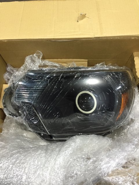

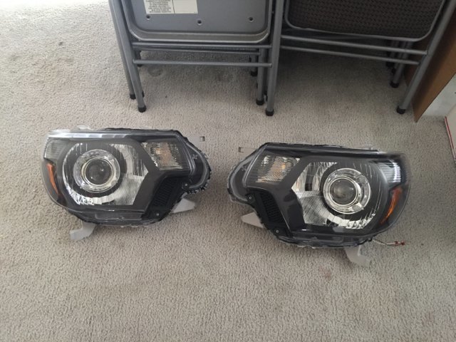

    Got these housings for fair price & have Morimoto D2S Elite kit with 35w ballasts and 5500k bulbs on the way. No halos, didn't really want any. Would've just not hooked the halos up if they did.
    More pics when on the truck..............

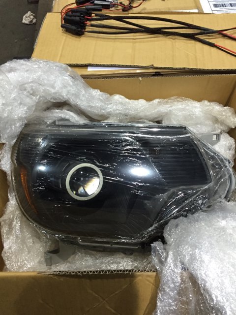

    New setup going on the truck this weekend!!
    I'll put up more pics when installed
    A7xschecter6661, did this setup for me he does great work!
