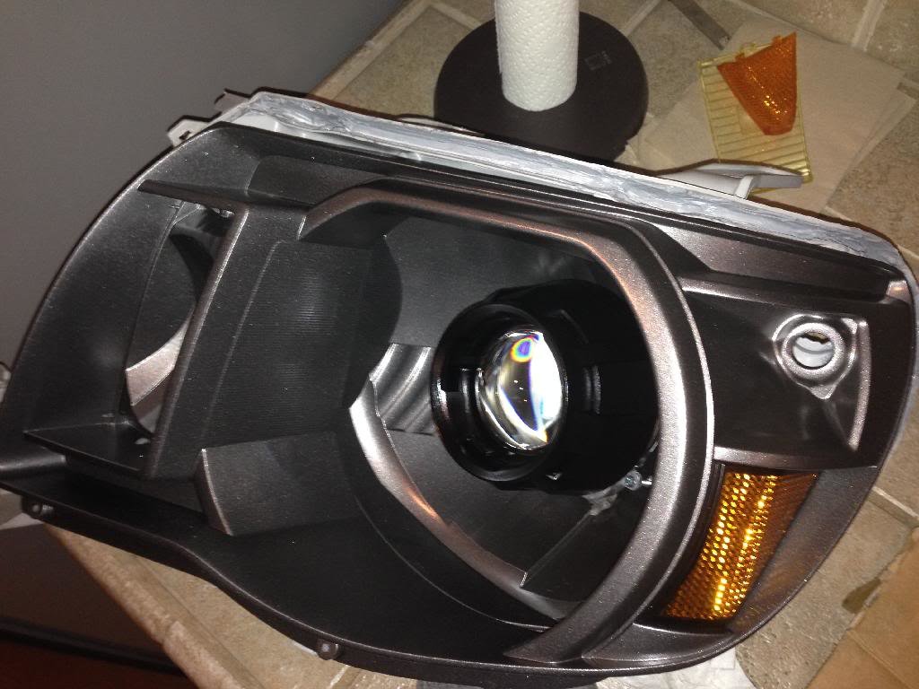

    tacodane The Slow But Getting Somewhere Build
    May 25, 2013
    #104898
    4,902
    Dane
    2013 Tacoma Prerunner SR5
    Led Interior Lights AFE CAI Stage II, Aero Turbine 2525 Muffler Snugtop Cab-Hi shell TRS Retrofitted Headlights
    Exactly what I did. Blacked out my entire housing6u6yzadu_4f6f444414dbbe88c44b2e13bf226ae805221419.jpg hesetyty_b3656eb8e08ef93ee5cca1be3079cae0f3f4477d.jpg

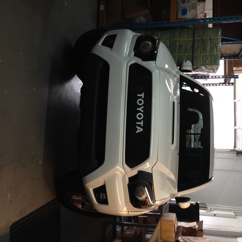

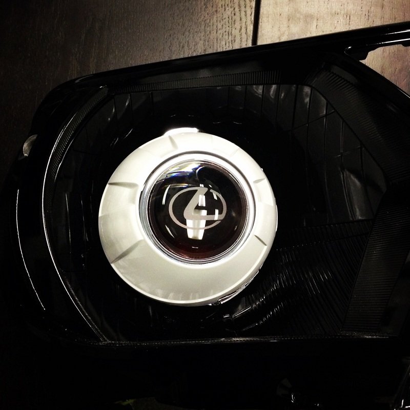

  15. Apr 4, 2014 at 11:34 AM
    #95
    TRSAndrew
    TRSAndrew Instagram: @apissues Vendor
    Jan 3, 2012
    #69858
    3,348
    ATL
    ‘22 4Runner, ‘14 F150, and I’ve had 4 Tacomas (‘12, ‘15, ‘16, ‘18), 2 FJs
    Headlights:
    - Piano Black Everything
    - Koito LED Amber Sidemarkers
    - Carclo 20mm Rippled LED Lenses for Sidemarkers
    - LS460R Set #43 - Matched 2007 model year
    - Osram CBI Bulbs
    - Morimoto 50w DSP
    - Morimoto MotoControl H4
    - Morimoto xB 5.0 Amber 100mm LED Rings (facing backward inside)
    - Etched Lenses (Lexus logo)
    - Body Colored LS460 Shrouds
    - Clear Lamin-X Protective Film on completed housings
    - VLEDs V3 Triton 5000K DRL/Turn Signals
    Fog Lights:
    - Morimoto xB LED Fogs (5000K)
